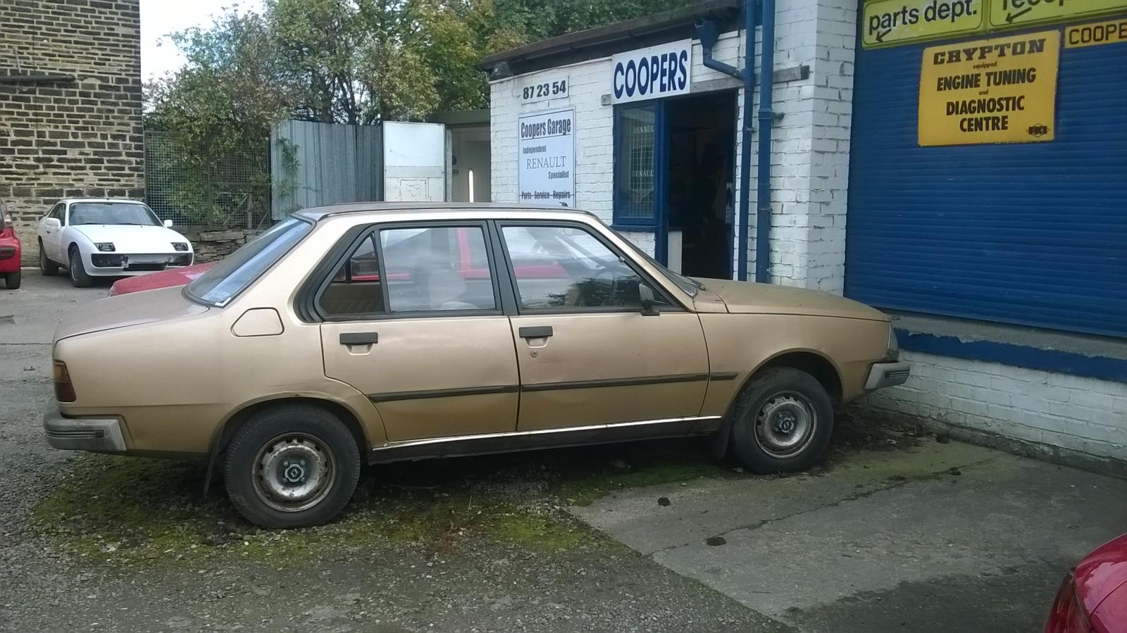

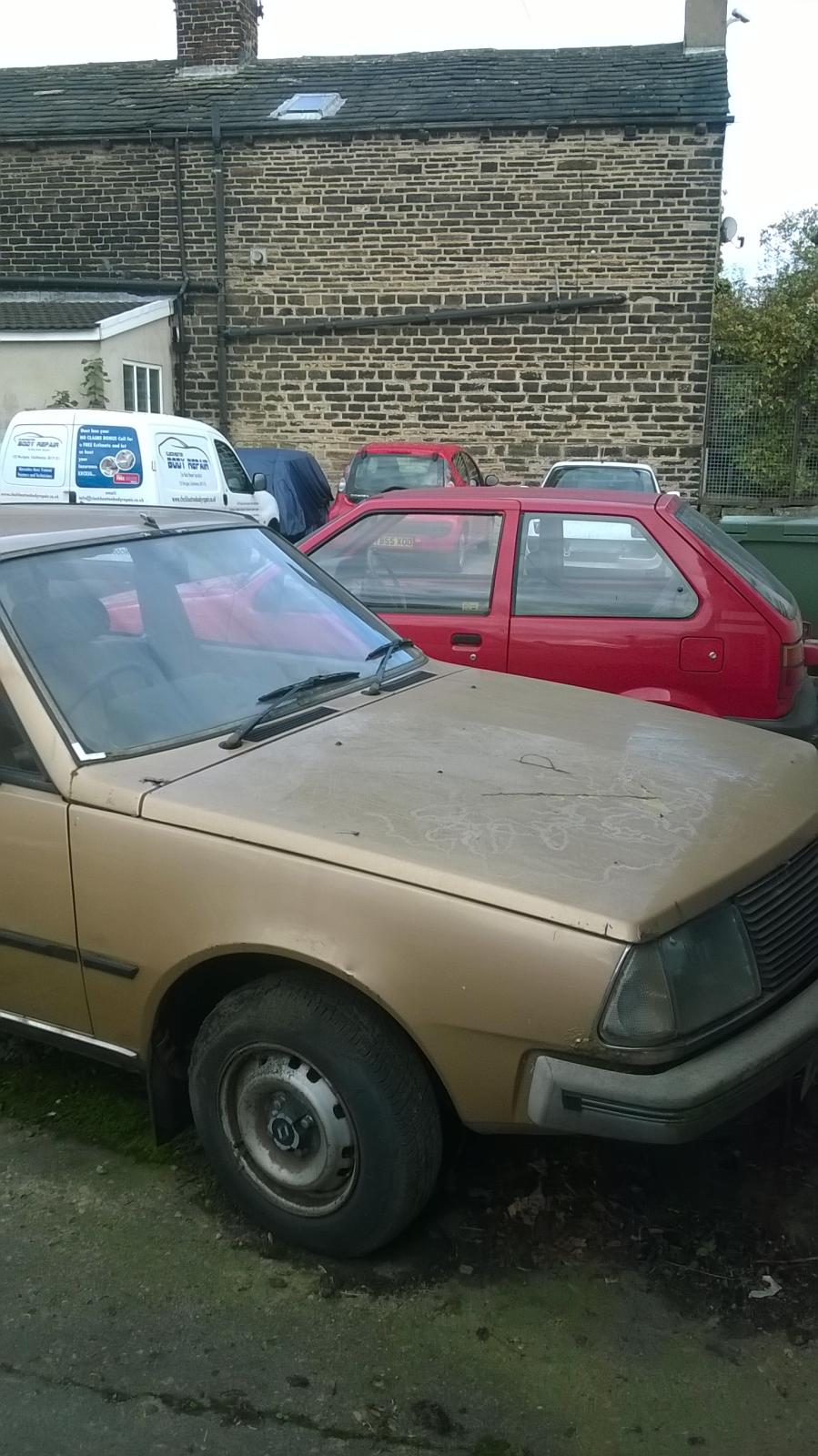

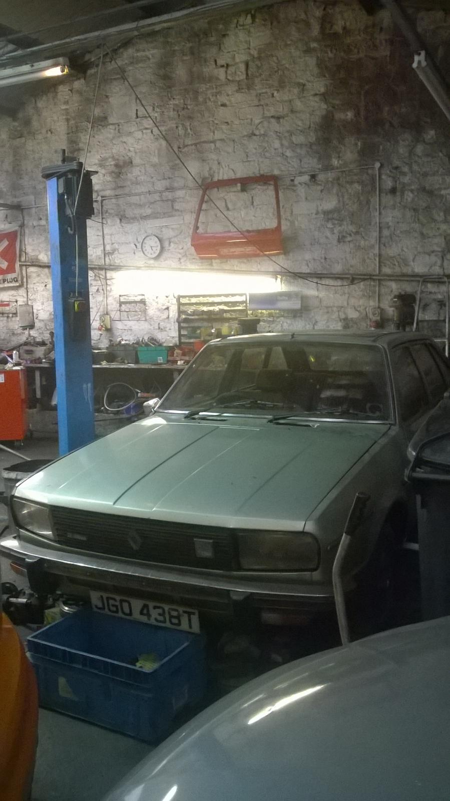

Interesting road trip today - I went to see a motor factor who still carries bits for all the 1970s generation of Renaults. He's an older gent, and says he is "Trying to retire!" He will be a great loss to any Renault nut if he ever does - he used to own a Renault dealership up to 1984, and what he doesn't know about Renaults clearly ain't worth knowing! Outside, it was reassuring to see a dead Renault 18TL!
He got this as an MOT failure around 10 years ago, and planned to do it up. But the back end got bashed in by something unknown one night, so it has sat there ever since. Happily, it has finally been sold 2 days ago to an 18 "American" owner in Brighton, but is likely to be broken for the axles.
He turned out not to have a 20 wiper motor, however he did have a very similar one for a Fuego, which we worked out would fit, as the mechanism on my car is still 100% ok! Considering the cheapest I have found so far on the net was £140, I was pleased to take a chance at just £10!
