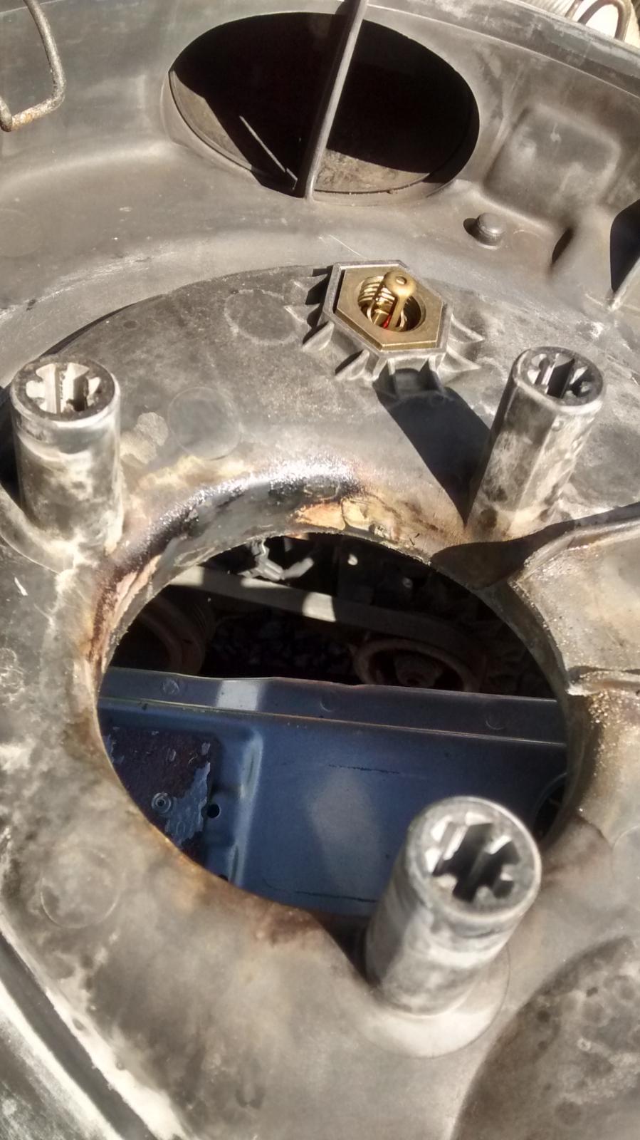

The tank has new bolts so it shouldn't be hard to take off and it needs a new sender unit anyway. I don't think we did fit a filter and we was going to do the carb and i even spent £40 on a repair kit and then my dad managed to lose the bloody thing so never done it! I was planning on putting it on a rolling roll but as i lost interest in the car i didn't want to spent any more money on it.

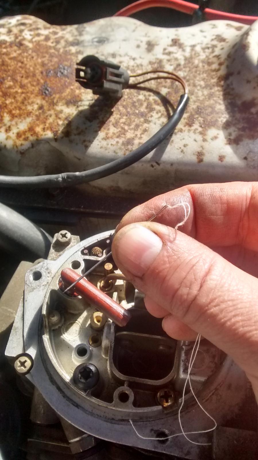

It was a lovely sunny morning so I popped the bonnet for a tinker,
A quick check of the air filter shows its not that dirty so looks like its fairly recent.
There is a burn coating on the filter housing so could be spit back,

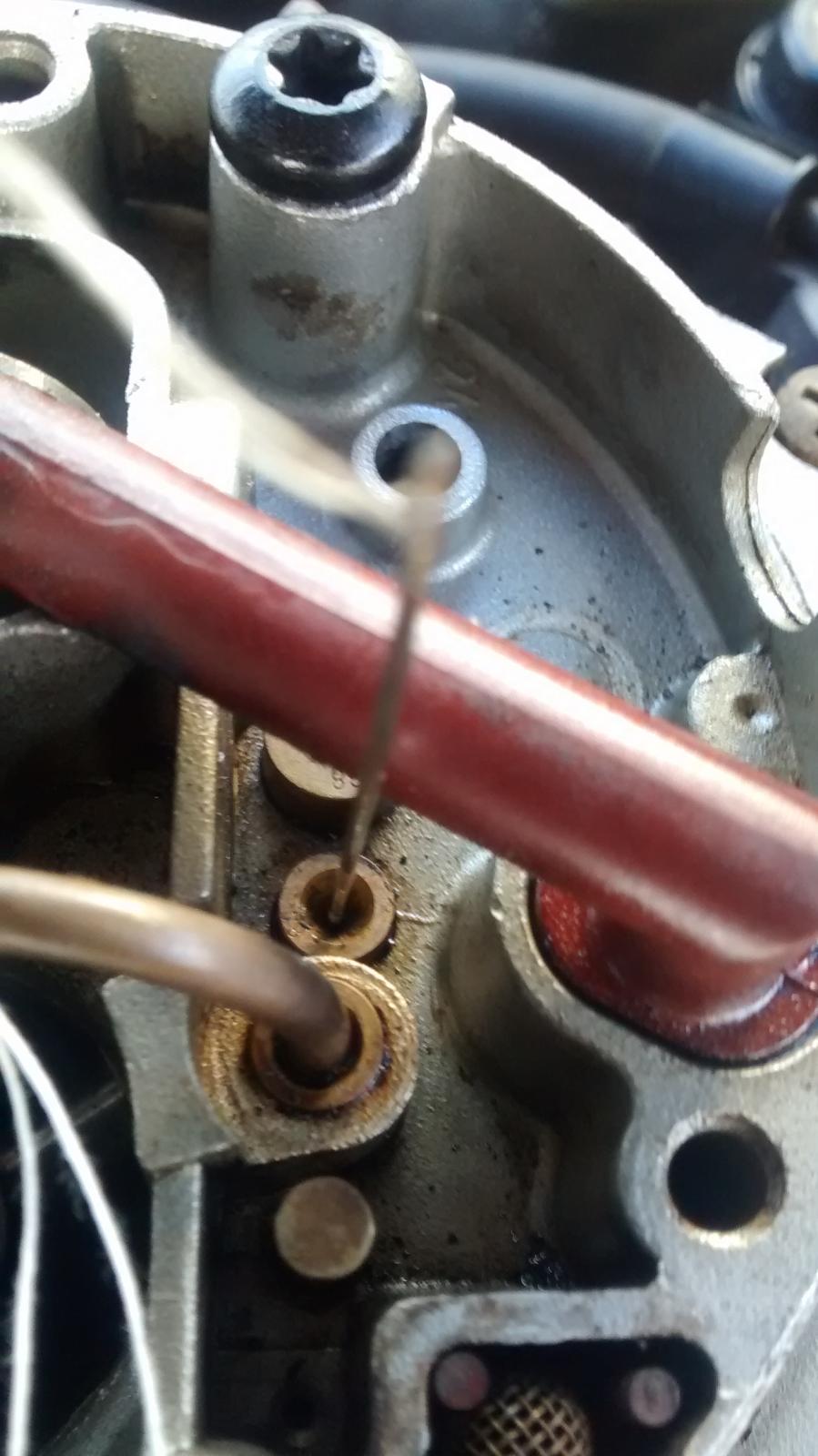

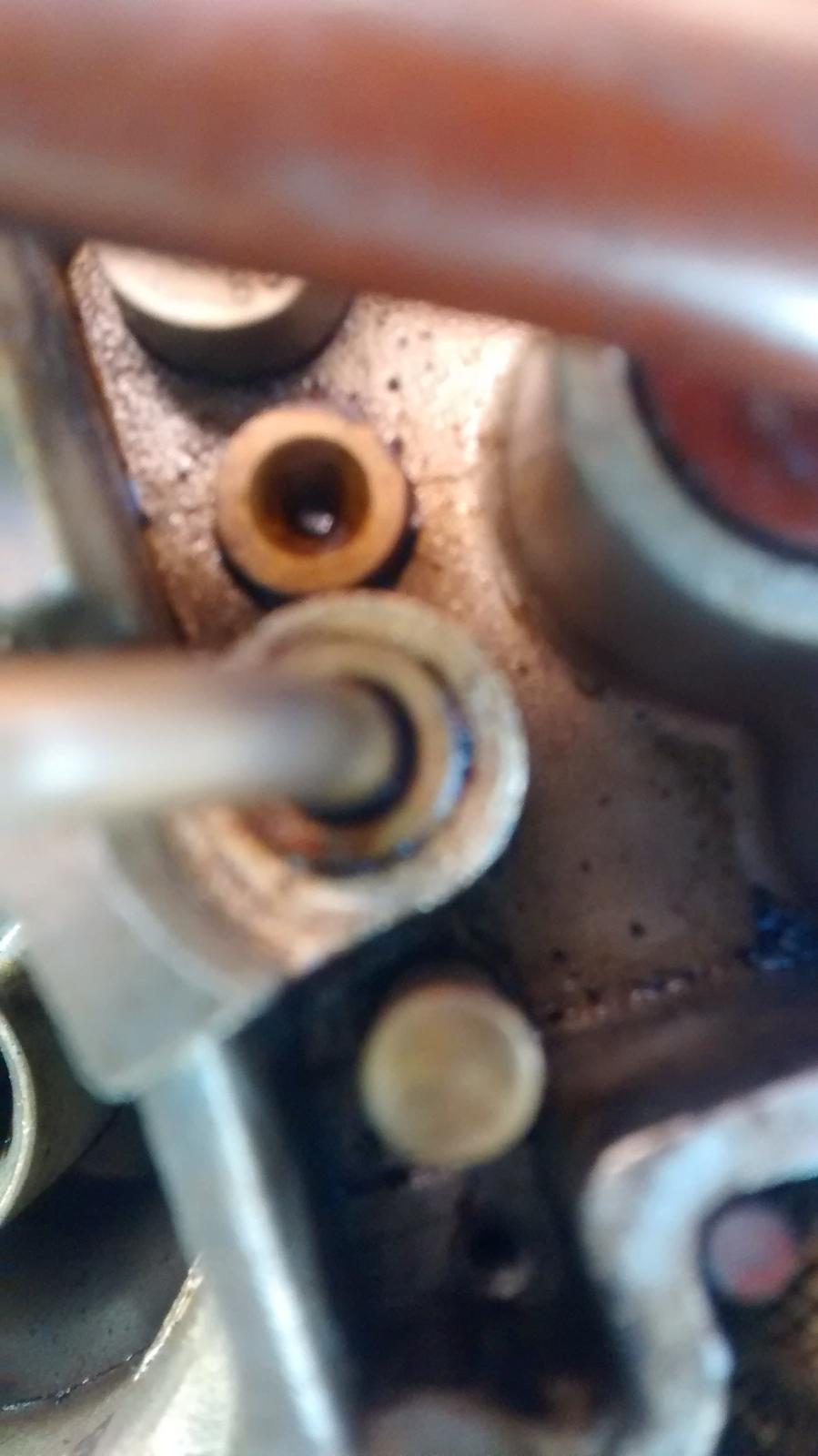

After a quick look around and check all pipework is connected I see these three jets,these two look very clean and the old mouthpiece airline blows through them with ease,
This one can clearly be seen full of baked resin and no amount of blowing can clean it out, even a scoot of brake cleaner failed to remove it.
Aha I thought this is the perfect opportunity to put my middle school sewing class skills to good use, thank you Mrs smith, a bit of camouflage face paint had me ready for a quick dawn raid of the wifeys toolbox where a mid range needle was raided for the cause.Here is said needle doing some sewing type stuff,
After a bit of scraping to remove the solid gunge I could then blow through the jet, after this success I chucked it all back together and fired up the powerhouse where it idled like it did beforehand, since a few blips of the throttle showed no difference I took it for a hurle round the block,
Fook knows what those jets are for but the car definitely accelerates much better now,
I still want more power though but then I knew that even before I started tinkering with it.
I cleared up and headed over to do some work on the scrote and yes the sierra does actually pull much better and even managed to top its previous best of 70,
