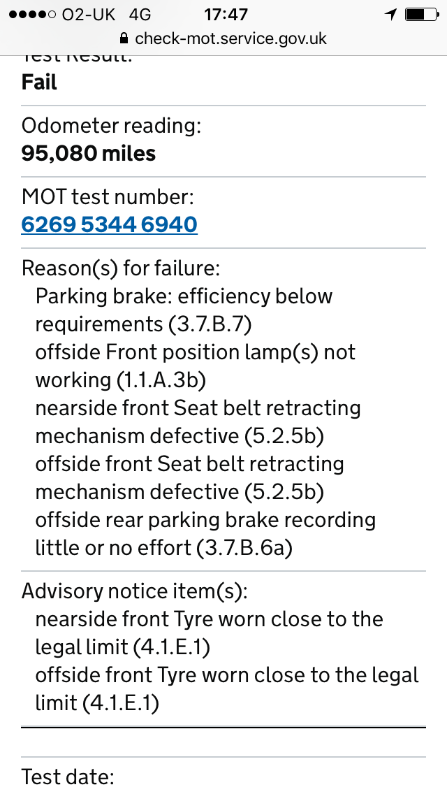

Split_Pin Posted August 12, 2016 Author Posted August 12, 2016 A good and bad day today for the Corsa but mainly good. It's now running loads better since I fitted the new MAF, the management light just requires turning off. The bad is it failed its MOT but the good is its all very minor. The seat belt thing is my fault as I didn't angle the upper mounts properly when fitting the roll cage. A simple slacken and readjust should sort it. Brand new tyres were in the boot ( good riddance to the Wanli ditchfinders) and they always say the handbrake is shite. In operation it works fine, much better than the Astra which always passes with no advisories. The other bad is that the garage have cocked up AGAIN. They didn't put my booking, made a month ago, in their diary. They are currently mega busy and I have a list of things requiring done to the car, all of which were disclosed at the time of the booking. Looks like they will have the car until at least Wednesday, although going on past experience, this is likely to become protracted. egg and Rusty_Rocket 2
