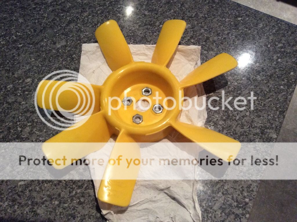

danthecapriman Posted June 17, 2017 Author Posted June 17, 2017 Did some more cleaning today. It's bloody hot outside today though so I've given it a rest until later this evening before I do any more. Both manifolds are off, again nothing gave any trouble. Even the exhaust manifold undid with barely any effort. IMG_0479 by Dan Clark, on Flickr IMG_0480 by Dan Clark, on Flickr IMG_0481 by Dan Clark, on Flickr Box of bits that came off. Some of it will just be cleaned up and reused, some is going to be blasted and reused, and there's a few bits I'll need to replace. The thermostat housing is likely going to need changing as it's very corroded. IMG_0482 by Dan Clark, on Flickr All the dirt and grime is now off the block and head so I'll just give the gasket surfaces a further clean up with emery paper then I'll start refitting the new waterpump and cambelt.I'll get a local company to do the blasting next week. By then hopefully the engine paints and gasket sets will have turned up so I can start painting everything and reassembly. eddyramrod, DeeJay, Sigmund Fraud and 2 others 5
TripleRich Posted June 17, 2017 Posted June 17, 2017 That fan has come up very well! I've cleaned various and they are a pain. The red fan on later engines is the hardest one I've come across to clean so far. Always though the Pinto looked best in blue rather than the later black. danthecapriman 1
danthecapriman Posted June 17, 2017 Author Posted June 17, 2017 That fan has come up very well! I've cleaned various and they are a pain. The red fan on later engines is the hardest one I've come across to clean so far. Always though the Pinto looked best in blue rather than the later black.Yeah I like the early blue Pinto's. It looks nicer when you open the bonnet I think. You can buy new fans, in an orangey colour but for a bit of effort you can save yourself buying one if there's only a bit of dirt to get rid of. I did wonder about the heat in the dishwasher but in hindsight it could have easily taken an even hotter wash I think.

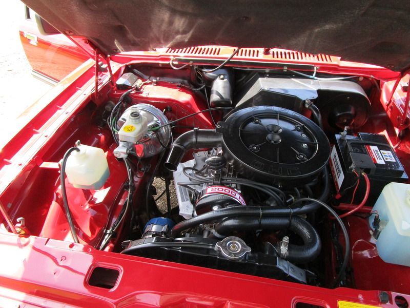

oldford Posted June 17, 2017 Posted June 17, 2017 I like the Pinto, nice simple engine, mine came with some shiny bits. I had a nightmare painting the exhaust manifold on mine, what I found to work was brush on Barbecue paint, the much more expensive Halfords high temperature spray paint flaked off after 10 miles. JeeExEll, BorniteIdentity, cort16 and 5 others 8
danthecapriman Posted June 17, 2017 Author Posted June 17, 2017 That's a mighty nice engine bay you've got there. It's spotless! I was going to ask about the exhaust manifold. I'm going to have mine blasted clean but wasn't sure what to paint it with afterwards.Great idea on the barbecue paint. Never would have thought of that.
oldford Posted June 17, 2017 Posted June 17, 2017 It's attention to detail, I recently re wrapped the wiring loom, got some Motorcraft stickers for the old Banner battery, new washer tubing, cleaned the plastic tanks - all the little things which add up. To reproduce the wide tape on the wiring loom, I used normal black shiny duct tape which I dulled down with some abrasive paper. The cloth loom tape is good at finishing things off. A Google search of engine bay pictures should give you a good idea of what they were like when they left the factory. The Moog, Vince70, danthecapriman and 1 other 4
