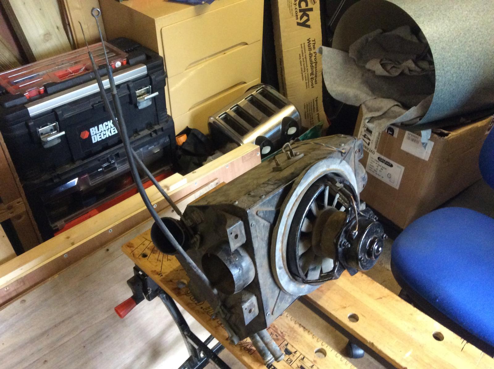

Instead I found the heater box and started on that.
Similar story here as a lot of the other bits on this car, it’s a mk1 unit and not the same as later cars.
It’s a U.K. built Smiths unit, none of that kraut tosh here!
Of course this also means there’s fuck all available to rebuild it with so I’ll see what happens with this...
This is the built up heater box as it came out of the car two and a bit years ago.a quality British item!
Straight away one thing that’s wrong is the shorter control cable was broken. It should have a little coil at both ends to attach to the heater flap arm and heater control switch on the dash. Mines lost one end so I’ll need to replace or repair that. It works ok though, I think this has been damaged for some time as the heater has always blown hot only. Reason being the damaged cable controls a flap inside the heater box that shuts off airflow to the matrix - hence hot only!
Opening it up is a simple matter of removing shit loads of tiny screws and two clips on the flap hinges. Then the whole end of the box lifts off revealing the flaps, and matrix.
There was loads of old dry leaves and other shit inside, loads of disinterested foam from the insulation material too. Ive emptied it all out and brushed the dust away and everything looks fine bar a bit of surface rust inside the matrix compartment. There was also a huge disgusting spider living inside! I hate spiders so I left it outside for him to run off on his own!
I’ve rubbed the rust down and painted it with rust converter, once dry I’ll give it a blast of black paint.

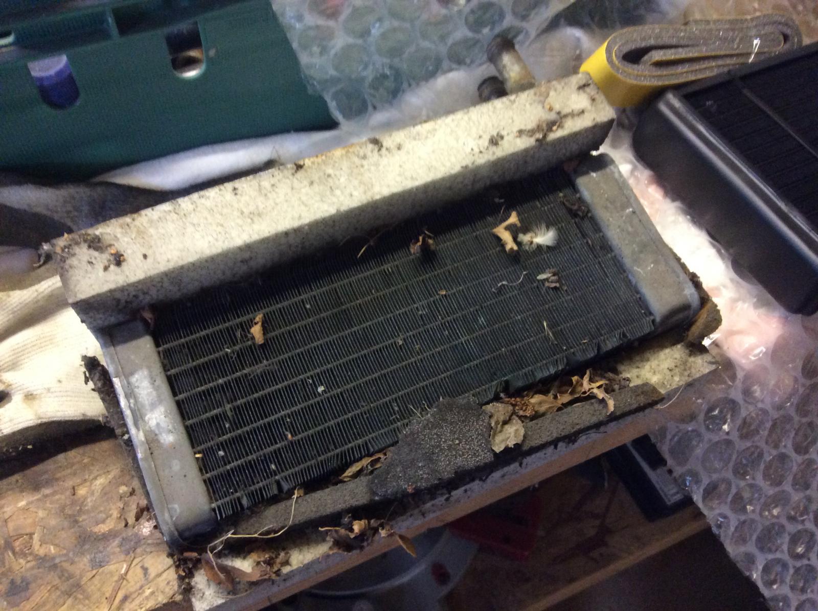

Pulling out of the box and it’s a bit grubby but in surprisingly good condition. I’ve brushed the dust off it and removed the original foam and polystyrene insulation and it is in good nik. It’s also tiny compared to the new one.
I’ve trial fitted the new one (all metal British made!) and it does fit in the space available. The out and in pipes are in the same place but the radiator is quite a bit bigger, almost filling the matrix compartment.
The pipes do foul the heater box as they’re a slightly different shape but that just requires me to open out the holes on the box a bit more which should be fine. The new one comes with a strip of self adhesive foam insulation to wrap around it before sliding it into position and closing the box up so I’m 99% sure it’ll work perfectly fine. It is also listed as suitable for all Capri’s regardless of which year. Maybe the original small matrix were found to be a bit shit so were enlarged on later cars and replacement parts?
I’ll try it and see I suppose.
Worse comes to worse I’ll clean, backflush and reuse to original matrix if I have to. Maybe even fill it with cheap coke overnight to dislodge any shit inside. Lucky that it’s in good nik really.

I’ve offered up the new big matrix and it will definitely fit and work so I’ve opened out the in/out tube holes in the box to fit the slightly different positions of the new matrix. Slide the matrix in and it fits very well.
Only issue is that it’s a bit of a loose fit being narrower than the original.
Here’s the new one about to go into place. I’ve wrapped it with the self adhesive foam insulation that came with it. It’s better but would still rattle around so I’ve found some more self adhesive foam that’s thicker and denser which seems perfect.
I might still need to use one of the original polystyrene spacers on this but it’s worked well so far.
