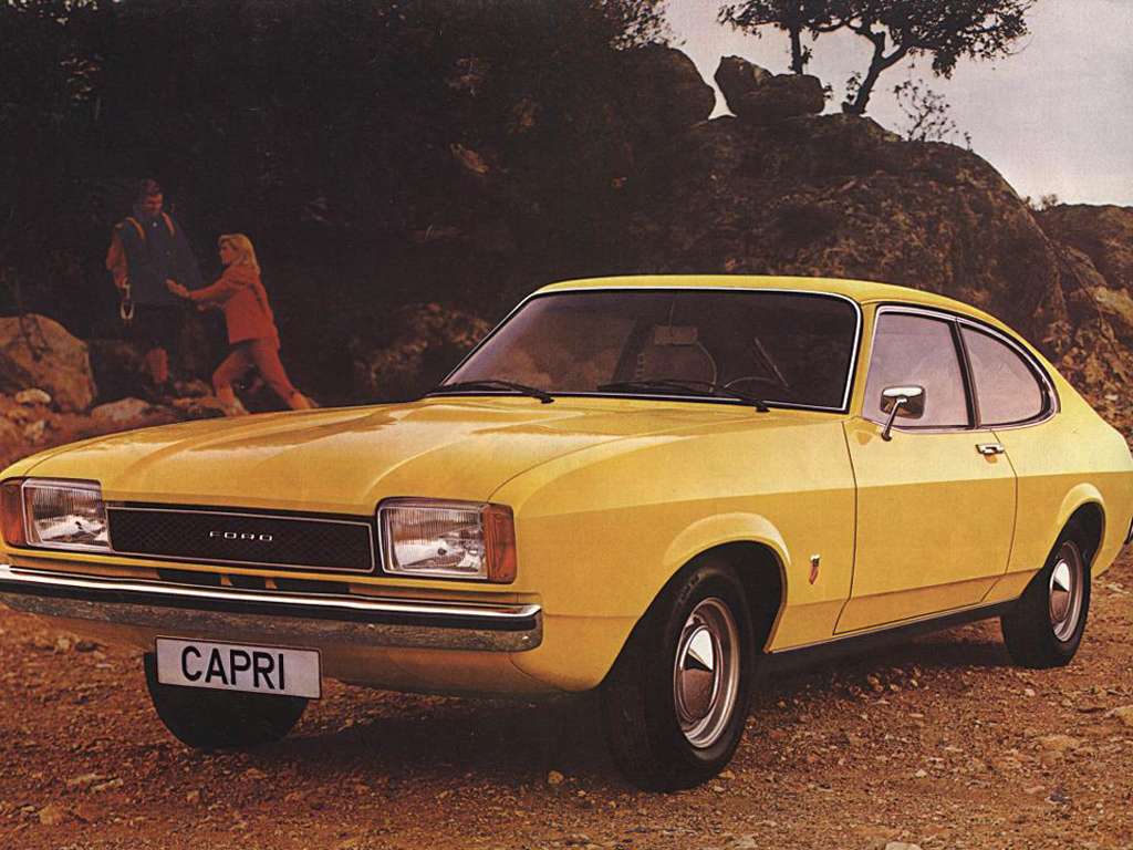

By the way, if anyone’s wondering what mirrors I’m on about, these ones.
Similar but not the same as mk1 mirrors.
It’s actually not that easy to even find pics of them. Most 74 cars are now wearing post 74 style mirrors instead for whatever reason or aftermarket ones.
Nice green one here wearing those mirrors. https://goo.gl/images/w5urWG
