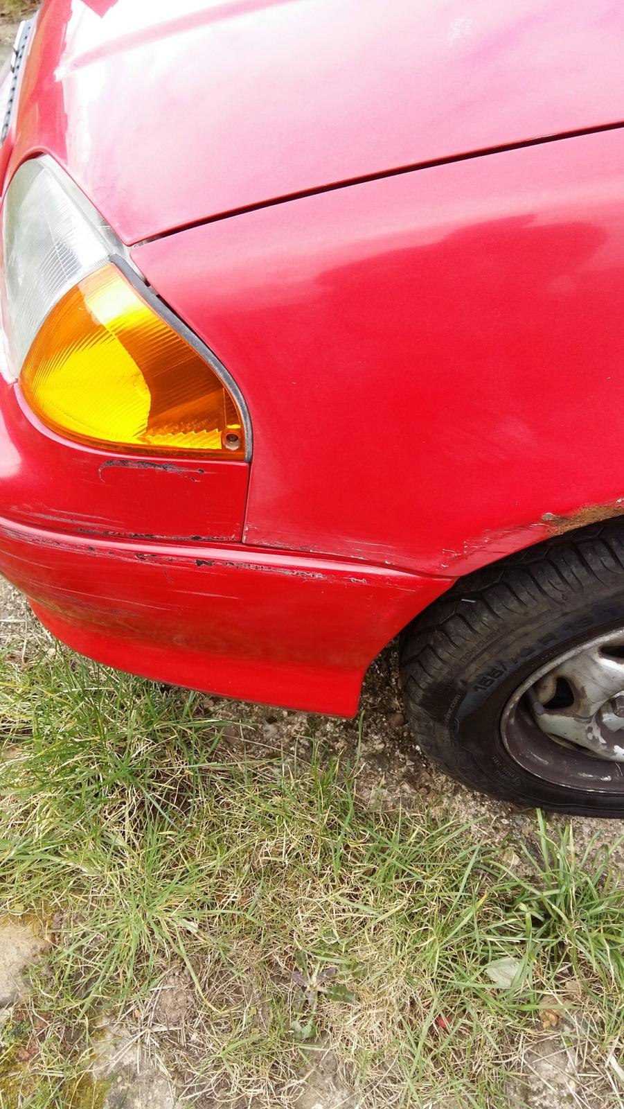

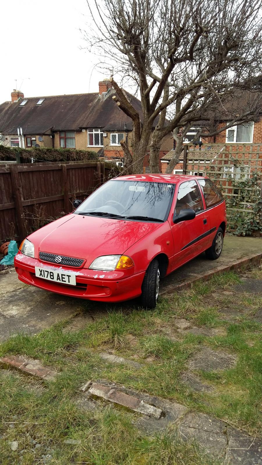

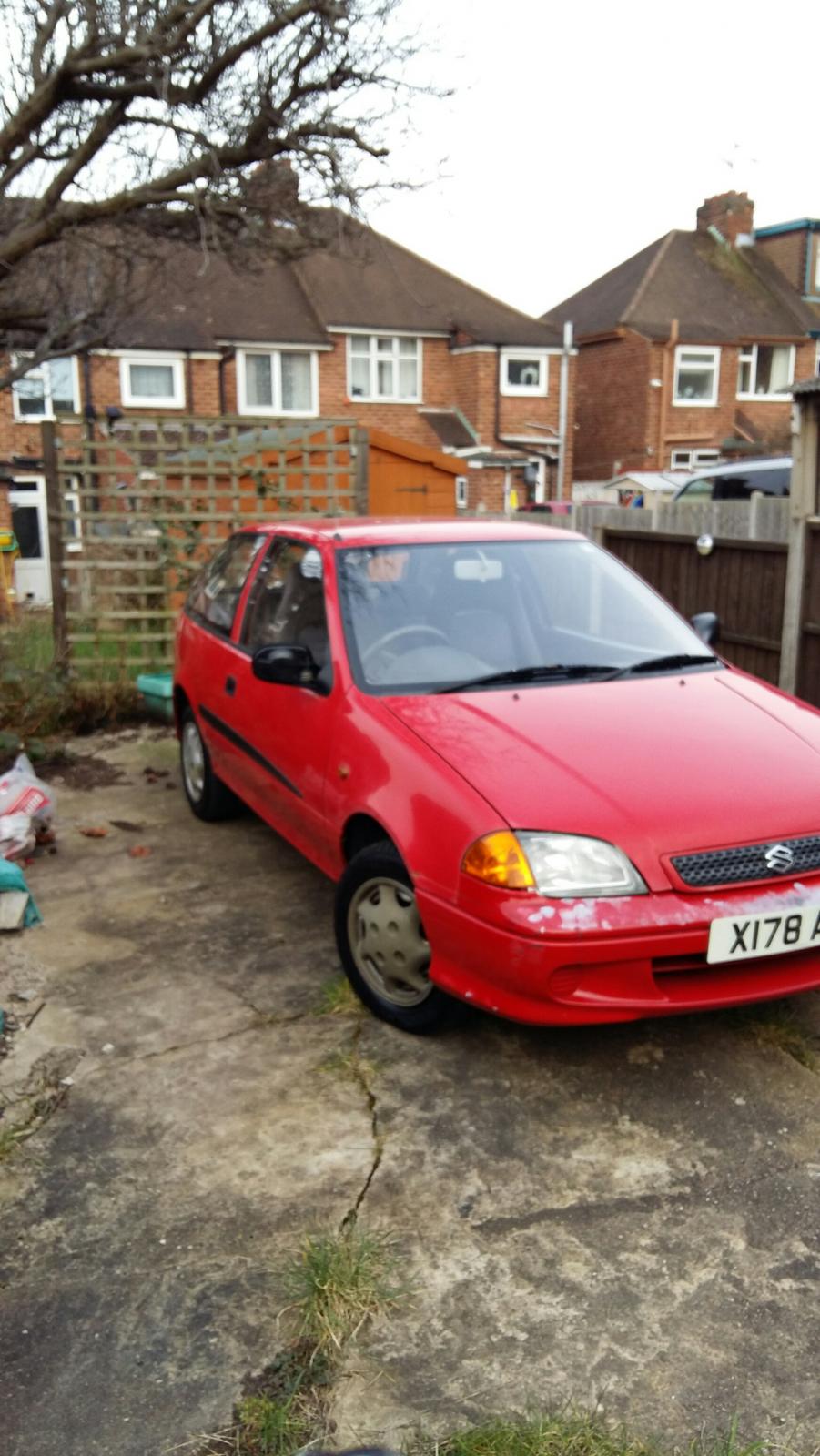

Picked this up today for the grand sum of £250. 38 Thousand miles from new with every old mot from new to back it up. Its in genuine Pogweasel Pink, and the bumpers have some nice flaking paint. Few little scrapes, but not bad for a 3 owner from new vehicle. Main floors and sills are like the day they came out the factory, under the bonnet is exactly what you expect a 15 year old car to look, grimy. No oil leaks or rust there though. Boot floor is a little surface rusty underneath and needs a wire brushing and treating. Missing mirror cover on the offside, and the nearside mirror has a stick on glass in totally the wrong shape! Exhaust, although new'ish has a rattle against something at tickover. Four matching Uniroyal tyres with good tread. Drives great with that revvy little 3 pot. Plans are to rip the bumpers off and rattle can them, touch up the few scrapes, might be easier to try and obtain a replacement front wing, will see if I can find one on Ebay. Then borrow my mates polishing mop and get it shining again. Wonder if I'll be able to get it on classic insurance?
Have some pictures

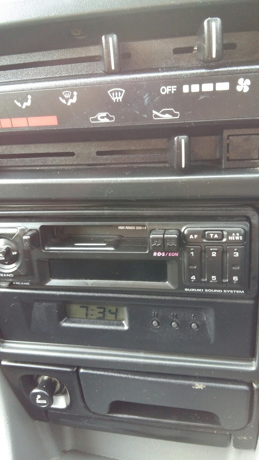

next it was try and work out how to turn down the volume on the original high quality* Suzuki radio cassette, various attempts made....but failed dismally. Think I might get one of those cheap radio/usb/mp3 players of ebay unless I can find a cheap cd player locally. Have a picture of it in its whole OEM glory.

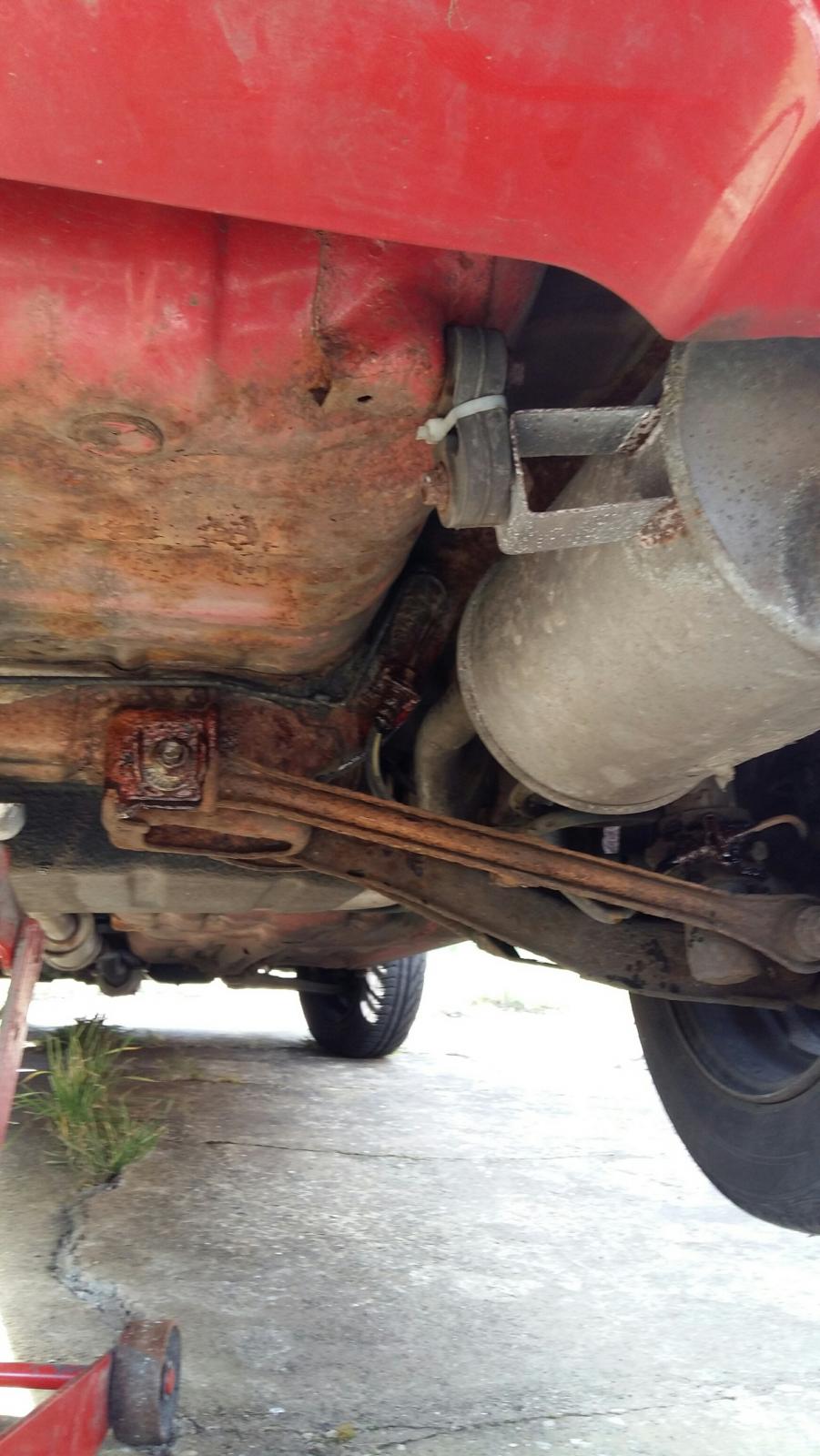

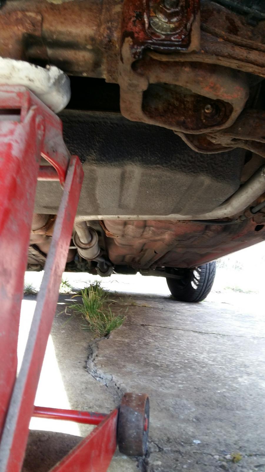

So a quick look underneath revealed a new'ish exhaust bar the front pipe which is original. Nice modifications to the exhaust rubbers involving tie wraps, they might get replaced too at some point. The boot floor looks worse than it is, but will get cleaned up, treated and painted. rear suspension looks a mess but its all solid, just surface rust. Will wire brush and spray it in black wax.

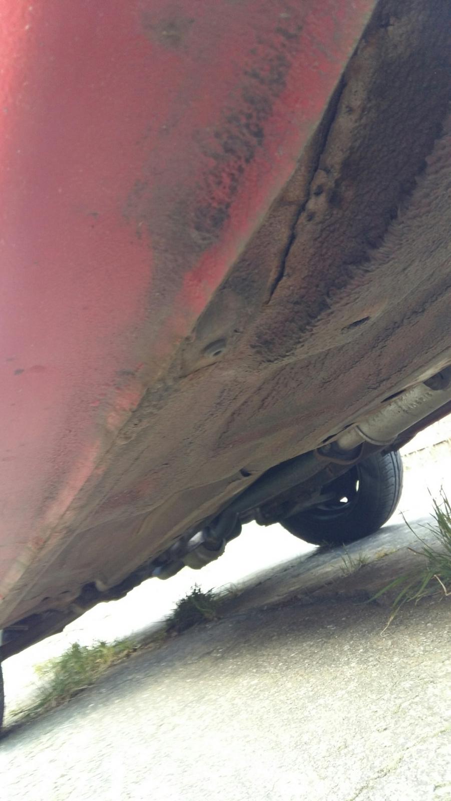

A look at the floors revealed them to be solid, with just a few peeling areas of underseal to deal with. Will get it up in the air and rust treat and repaint these areas as soon as it gets a bit warmer.
A few brake pipes were cleaned up, and the ferrels on the flexy's but all good underneath. Front wheels off showed nothing of concern, all joints seem ok, no split gaiters, discs with no lips on them, front brake pads are getting low so a new set will be purchased.

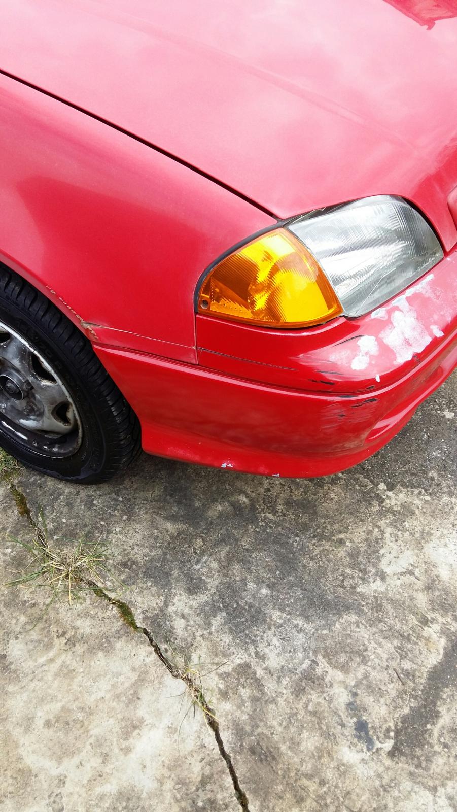

So a quick look at the giffer damage, scrapes on 3 corners, most of its on the bumpers which need repainting anyway due to flaking paint. The bumpers look like they are two seperate pieces, upper and lower, a bit of sanding and filler work will have them back in fine fettle, no splits or cracks thankfully. Both front wings have light scrapes, should be easy enough to sort out, little bit of surface rust on the nearside one but still solid.

Suzuki's from this period seem to have whatever radio was cheapest at the time. Both my Swifts both had different CD players, my 03 plated Alto had a tape deck but your Swift has a Suzuki branded tape deck. Yours has a different oil cap for some reason too.
i'm guessing the volume is the up/down on the "joystick" and radio tune is left/right
Yes thats what you'd think, but all I've managed to do is turn it up to full volume and no amount of fiddling will turn it down again! I think its caput, but will keep it safe somewhere just incase.

Finally managed to get the radio turned down to an acceptable volume, so vowed not to touch it again to I get a replacement.

Looking at the bumpers it would appear that they were originally black plastic and someone has body coloured them with poor prep work. Wonder if it was done by the supplying dealer to make them more attractive for sale? Think I might keep my eyes open for some on ebay at a sensible price and repaint them.
I read all your advice on rust treatments.......and ignored it all and ordered some stuff that got a five star review in Land Rover Monthly. After all everyone knows Land Rovers came with factory installed rust, at least all my previous ones were.

That 'rusty dogbone' under the middle of the boot floor (where the rear seat hinges forward, looking inside) is a bugger!! It is spot welded to the floor skin and rusts like F**K. My floor looked like two brownie waffles right where the welding spots are.
