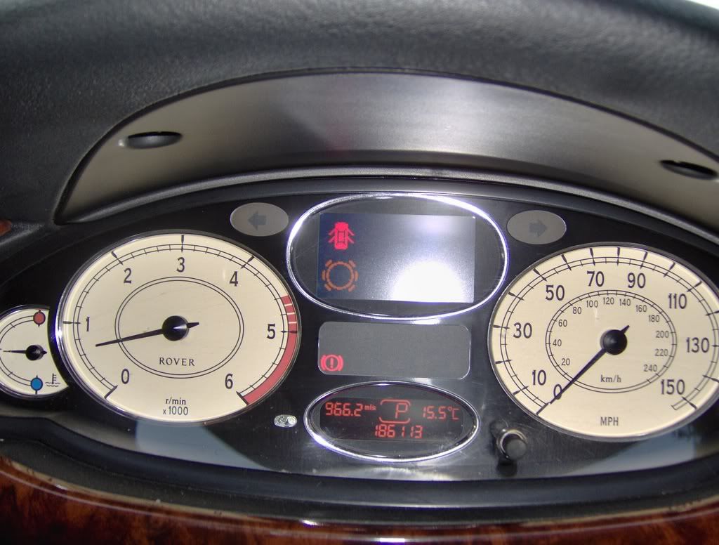

Heres mine,I have spent money on it yes ie servicable items. The only money I spent was for rear shocks. They are reliable cars and lovely to drive too the glide down the road effortlessly especially on 15" alloys like mine.
This was upto POL and and back averaged on brim to brim 39.3mpg not bad for a 2.5v6 auto

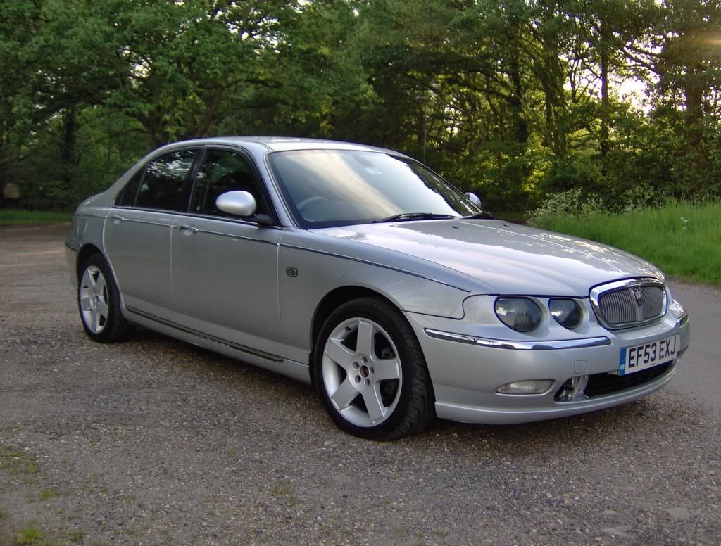

Had a 2003 diesel tourer from 2008 till 2013 and replaced it with 2005 diesel MG ZT. Great cars with lots of plus points! Not without faults though! Suspension has been my main grumble. Clutch was done on my old tourer as well. Didn't cost the earth but didn't replace MDF.
Despite everything still the best cars I've had. Usual mpg with the diesel manual is around 45 - 50 for me and the 160 upgrade makes them fast enough if needed.
P.S. after owning the 2005 car I would go for as early pre 2001 or as late as possible. Some of project drive was reversed near the end of production and things like the stupid plastic carpet retainers were improved.
