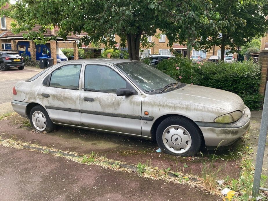

K plate spotted in the wild today!
K28 UBJ - is it on the survival list? Registered 28th April 1993
Apologies for the potato cam quality, my phone always seems to take the best pictures when you haven't got numerous people in a Tesco car park giving you funny looks while scrabbling to get your phone out of your pocket to excitedly photograph a 30 year old Mondeo... 🤣
Looks like an LX, I was trying to work out if it was another bASe but then saw the badge on the wing. And of course the alloys. They can't be factory fit?
I spotted this again on Friday coming the other way on the M25 :) nice to see it's still going

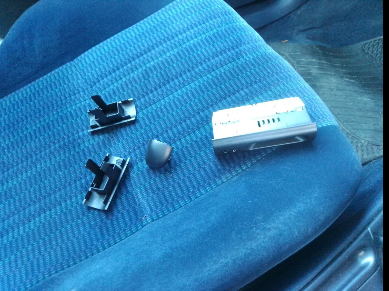

Bulb has gone in the clock, with some fiddling got the clock out and removed the bulb, now what is it?!
  • egg changed the title to '93 Mondy thread - what's this light bulb?
The inner bulb will pull out of that holder and be tiny itself. (and maybe cheaper but possibly not vs with the holder) Their the same as a 1980's Hoover Turbopower headlamp bulb.
I fitted 2 of those (genuine too) to the ex's meriva numberplate lights 🤣 Outlasted the car...
I've probably got one around *somewhere* just need to remember what that somewhere is, I think I've got a spare clock in the loft, so maybe just swap over.
As Beko said, it is probably a tiny little wedge bulb that pulls out of the holder.
I replaced a couple in the automatic gear selector on Mum’s Camry, they had little green condoms over them to colour the light.

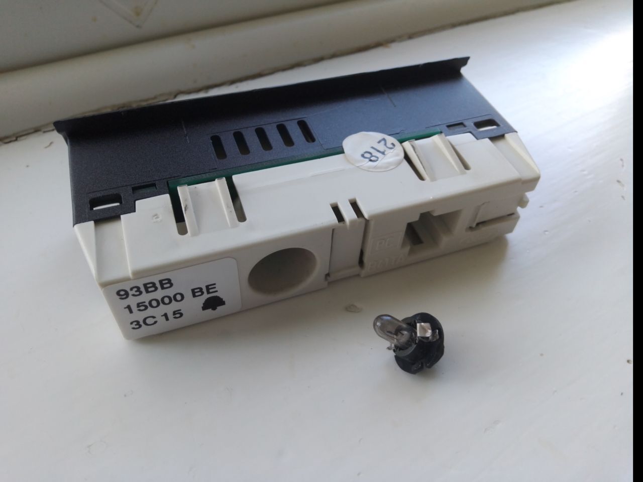

Depends how much of  pain it is. I remember reading on the xm forum how it's best practise.To just replace every bulb with a new one even if only one has gone, but mostly because of how much of an arse stripping the dash down is 😂
Your clock looks easy enough to bung a used one in, but if you've spent 3 hours stripping something down I'd stick new ones in (then keep all the old working ones...)
  • Agree 2
Another job I never had to do on any of mine. I'm pretty sure I had that bulb fail on a couple of mine but as the taxi data heads had a clock it wasn't a job a driver would whinge about.
Definitely the first time I've had to look at it in the 9 years I've had it. Think it's a 509t now, but will check in the loft before getting one.
I had hassle getting one of these for my Mondeo. The bulb is not replaceable on its own as it is soldered into the holder, which makes it much more expensive. I ordered part number 6732417 which was supposed to fit a Mk 1 Mondeo clock. It looks correct but doesn't fit. I told the supplier and they said I actually needed part number 7358627 which I ordered. This did fit but only lasted about a week before it blew so I gave up.
  • Sad 2
I got this Halfords bulb to fit with some messing around with adjusting the contacts, £1.99, see how long it lasts. 509t
  • Like 11
  • egg changed the title to '93 Mondy thread - clock bulb fixed (the little things)

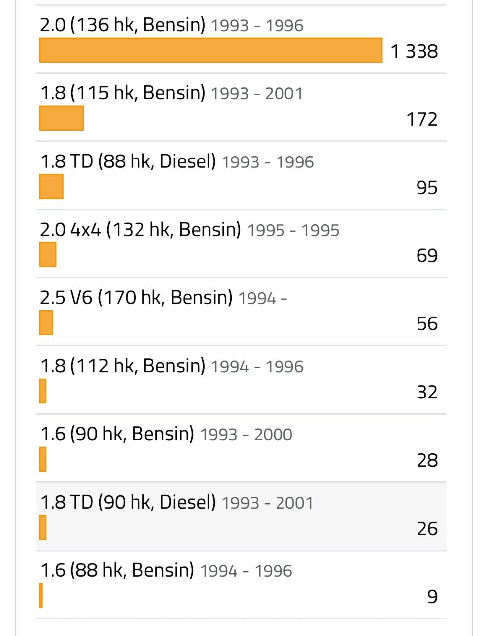

Latest HowManyLeft analysis.
- Down to 360 taxed MK1 (from 430 last year)
- Number SORN also fallen slightly, about 3000 still - but wonder how many actually exist.
- Base models remain the same at 7 taxed
- Down to 54 taxed 1993 models (K and L reg) - 71 last year
These are the stats for mk1 Mondeo in Sweden
A lot of them are probably laid up behind barns, but it is quite interesting since only a fraction were sold here compared to the UK.
In 1995 it was the 8th best seller with 5,466 units.
We’re a country of hoarders.

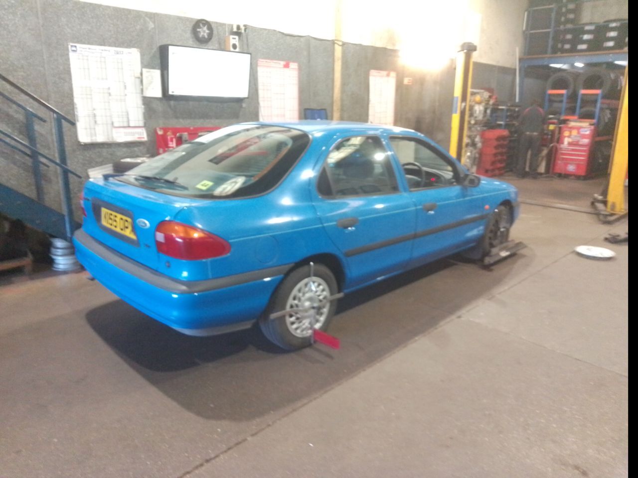

  • egg changed the title to '93 Mondy thread - Alignment
Since the lower arms were done , clearly the alignment is now out (way out m8 they said). Now sorted.
