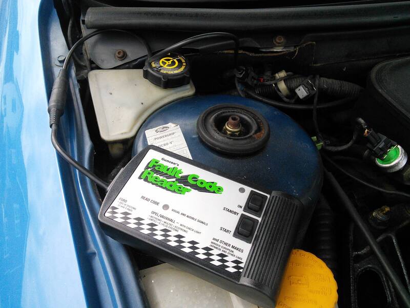

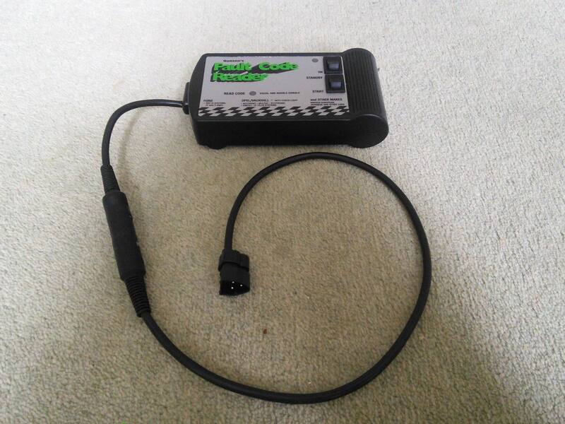

I have a Gunsons 4127 code reader bought used on eBay by cheque(!) appropriately enough last year.
You have to unscrew it and put a 9v battery in. Luckily, there wasn't an old one festering away
After that you need the right adaptor for a Ford, that is in the kit
Then removing a cover on the car you can connect...
I have only done ignition off checks so far....when you switch on the reader, the fan briefly whirrs, like it does with an OBD2 system.
And I got the following result
111 111 1 111 111
This is the all clear sign. The 1 in the middle differentiates between current codes and historic codes in the Keep Alive Memory (KAM).
Ignition on/engine running later...

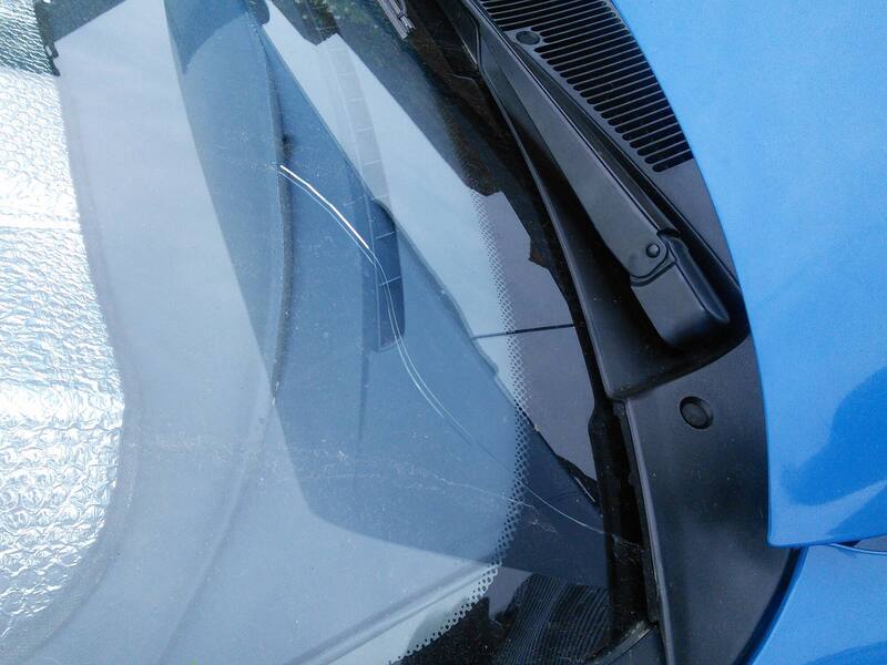

Fuck it the windscreen has cracked for no apparent reason, previously replaced by Autoglass :(
Edit: I'm wondering it was something I did during pollen filter change - but the crack is not near any of the fasteners....but I still feel guilty. Could be a heat thing.

I did the engine running tests. Only two codes
521 and 538 which mean (a) power steering pressure switch was not activated during self-test and (b) operating error during self-test procedure - which in both cases suggest I need to 'repeat self-test procedure'
Not sure why as the test seemed to proceed as expected - I had to turn the wheel, press and release the brake, engine speed goes up - you then depress and release the throttle completely and the codes come through.
I also proceeded to the 'power balance test' where the engine cuts power to each cylinder in turn to test for errors - that definitely happened - I got a '9' code for that - which is the all clear :-)

That screens cracked because when you’ve put the screws in on the plastic scuttle you’ve nipped them up too tight in the plastic plugs. Ask me how I know!
I fear that may be the case. If so, pissed off with myself. Although it hasn't actually cracked where the bulkhead is under tension from the plug.
£75 paid and booked in for 18th June. Last replaced 21/6/17 - so it lasted 3 years.
What I hate is how I fiddle around with pennies here and there to make all ends meet etc, and then potentially make an expensive cock-up like that.
Only other thing in my defence, is I always felt this screen had a slight warp in it after fitting - evidence for this is that the driver's wiper blade tends to leave a trail sometimes as though it doesn't sit fully flush and also, there was a bit of distortion when looking at the passenger side of the window from the driver's window. Sounds like being wise after the event, but it's all true ,your honour.
Anyway, what's done is done, and I'm off to cry like a girl at my misfortune. Well, just be a bit grumpy anyway...

Anyway, I'm relatively pleased with the code reader today, not because I thought there were any pressing faults, but it does mean if something shows up, I might be able to work out what it is myself.
I have various other connectors in the kit including Vauxhall, PSA, VAG, most Japanese makes. So happy to lend the kit to any shiter I come into socially distanced contact with.
