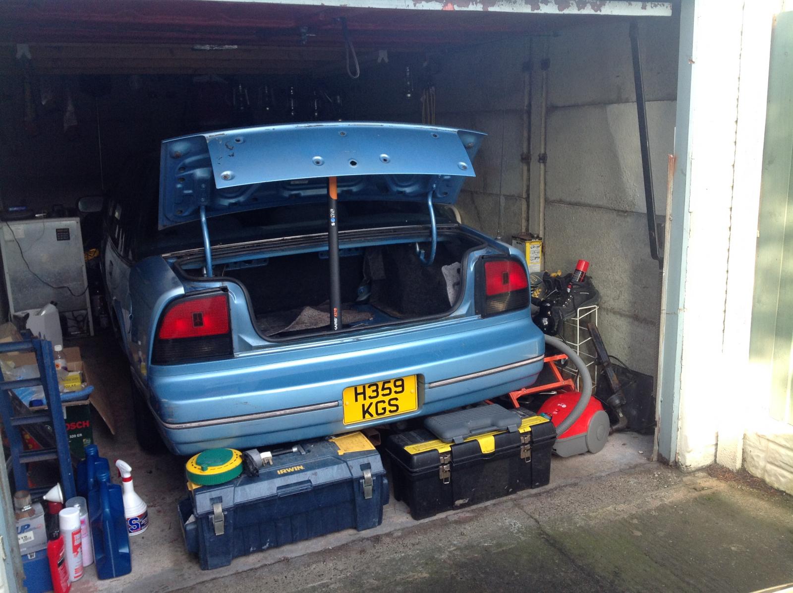

A snug fit! Will need to be driven, or rather pushed, out and in again to do any work.

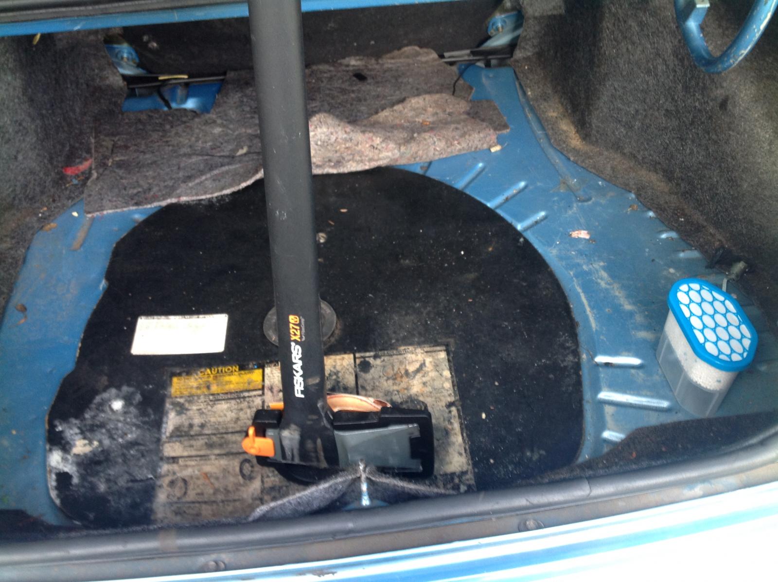

The boot actually open! Propped up by an axe because it was the right length and the spring gubbins that should hold the lid open is missing. How and why is a mystery.

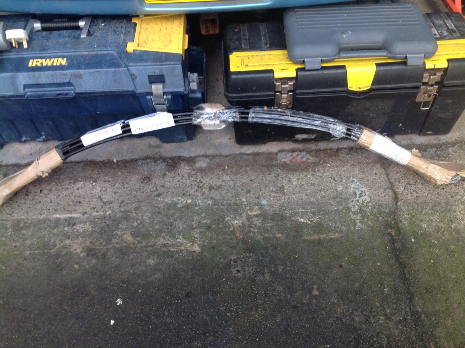

The (expensive) replacement spring shipped in from Canada. The fibreglass composite original type is now unobtanium so this one is steel and HEAVY.

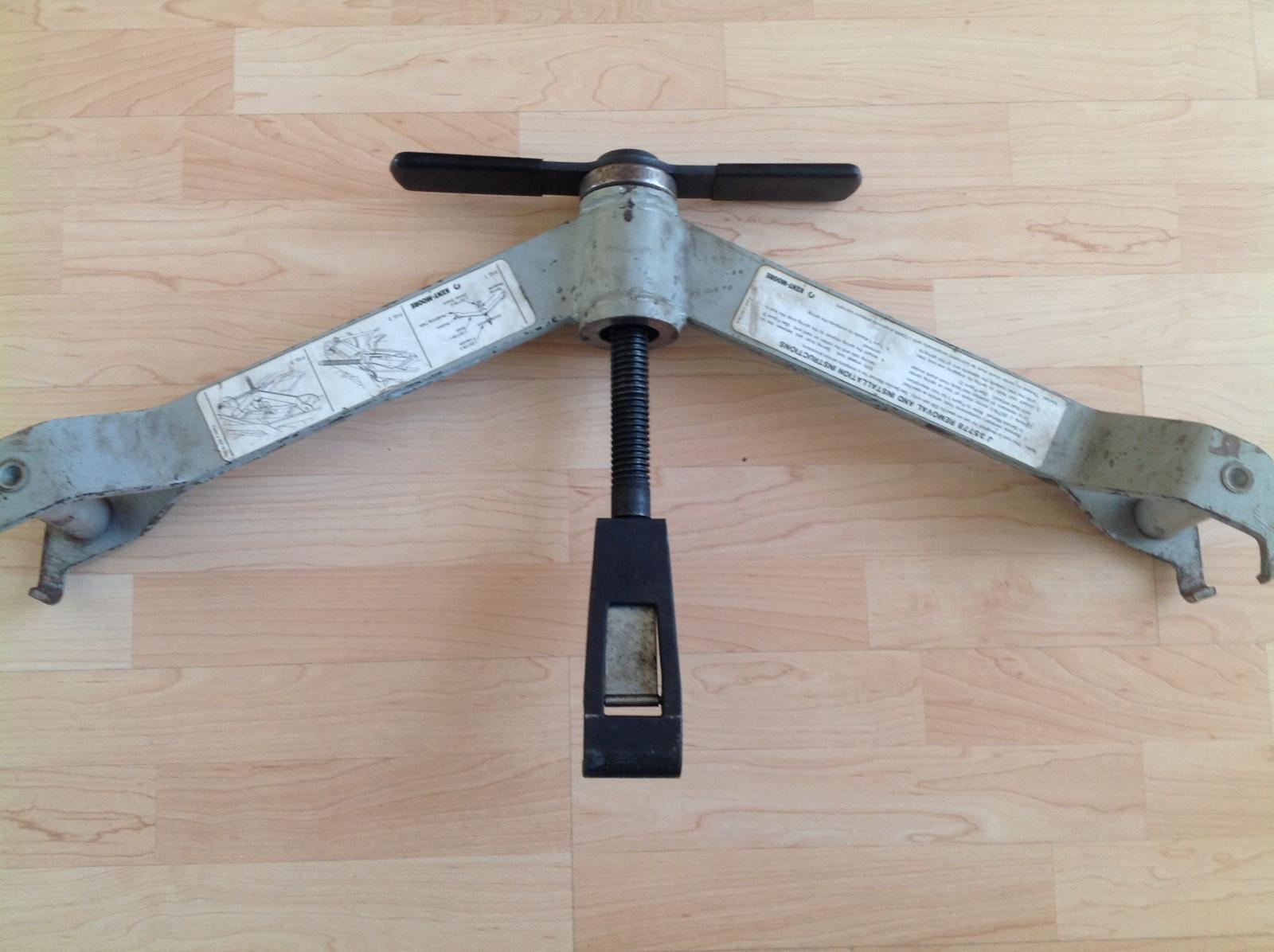

Which contained this. The tool to compress the spring for removal/installation. Impossible to do without this apparantly. Sourced from Beaver Creek, Ohio. Lovely name.
Rare. Apparantly these cost $900! This second hand one was £150 including shipping etc. Massive and very well made. Bit difficult to gauge on the pic, but is about four feet long!
That tools a hefty old thing. Shame you've got to have one really as you'll probably only use it once!
I wonder if the old fibreglass springs are unavailable for a reason? And the new ones in steel are a modified design?

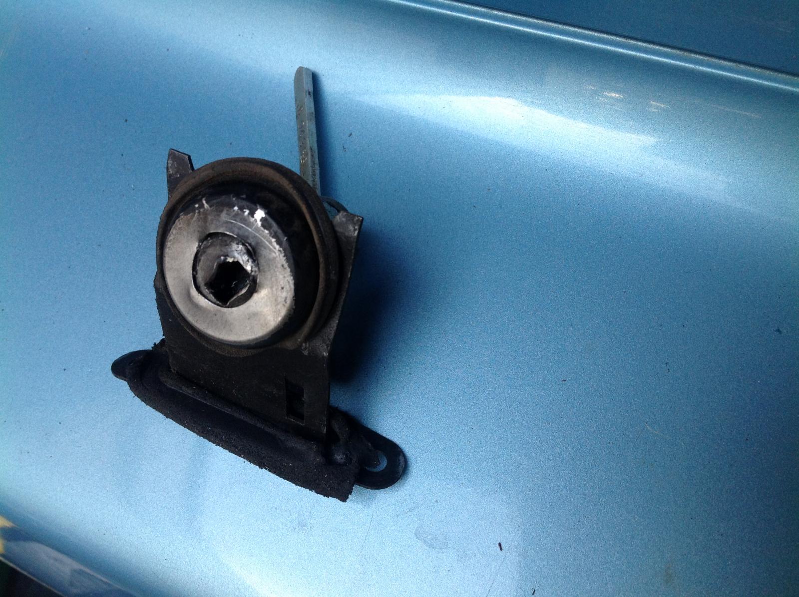

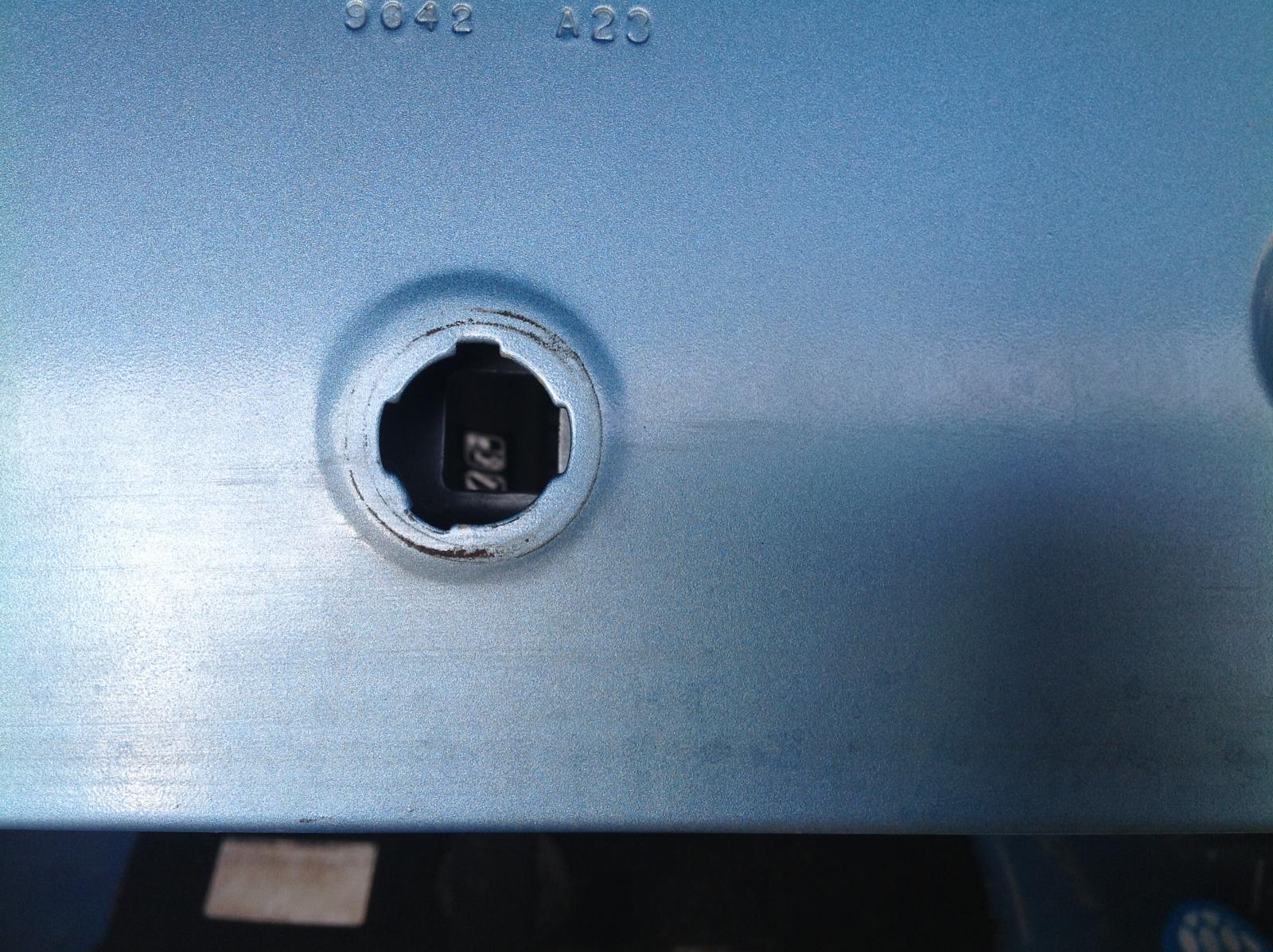

Have removed the mashed boot lock.
Replacement lock cylinder and fittings are available from RockAuto for around $8 plus shipping. Ordered.

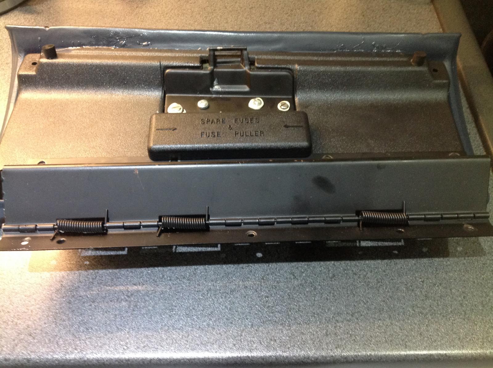

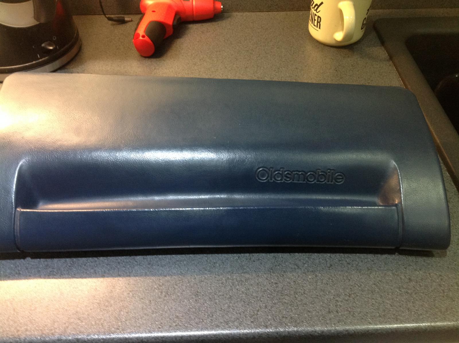

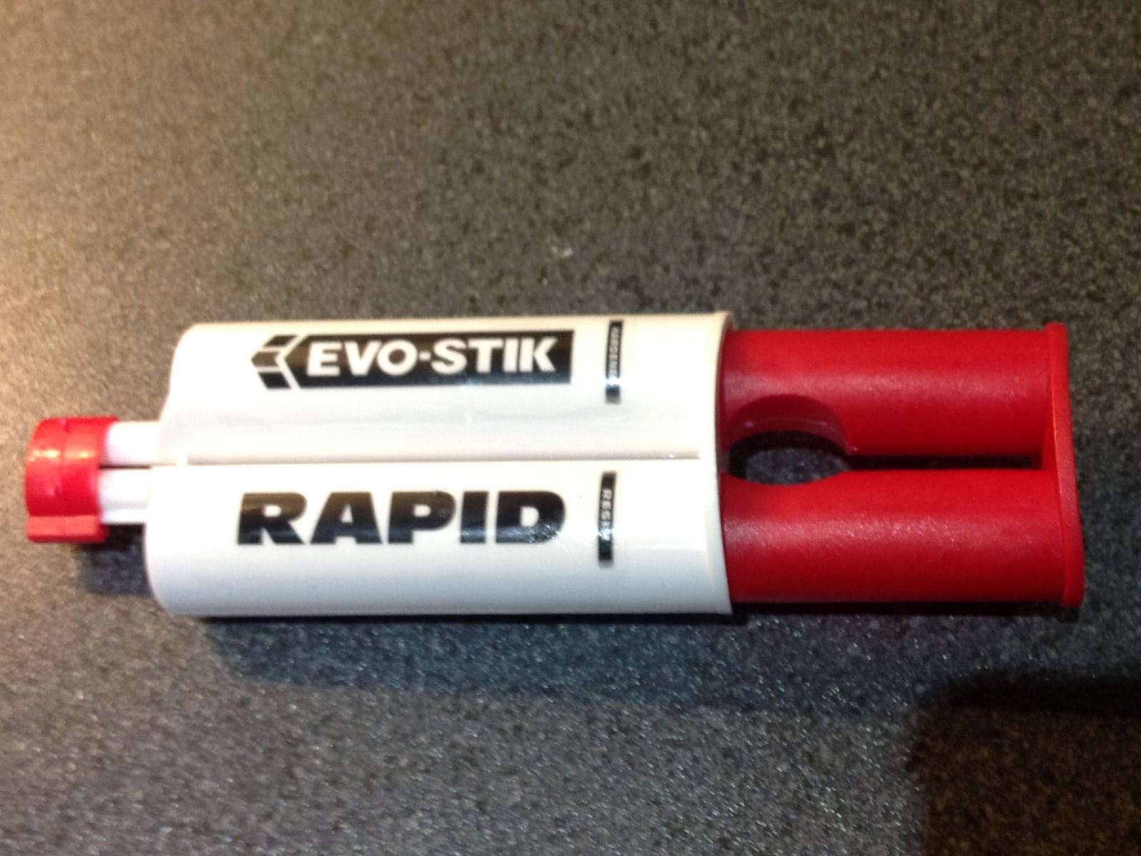

Removed the glove box lid for repair, as the hinge and frame section had come adrift from the lid.
Plus a lot of
Resulted in
Back in one piece and ready to go back in the car.

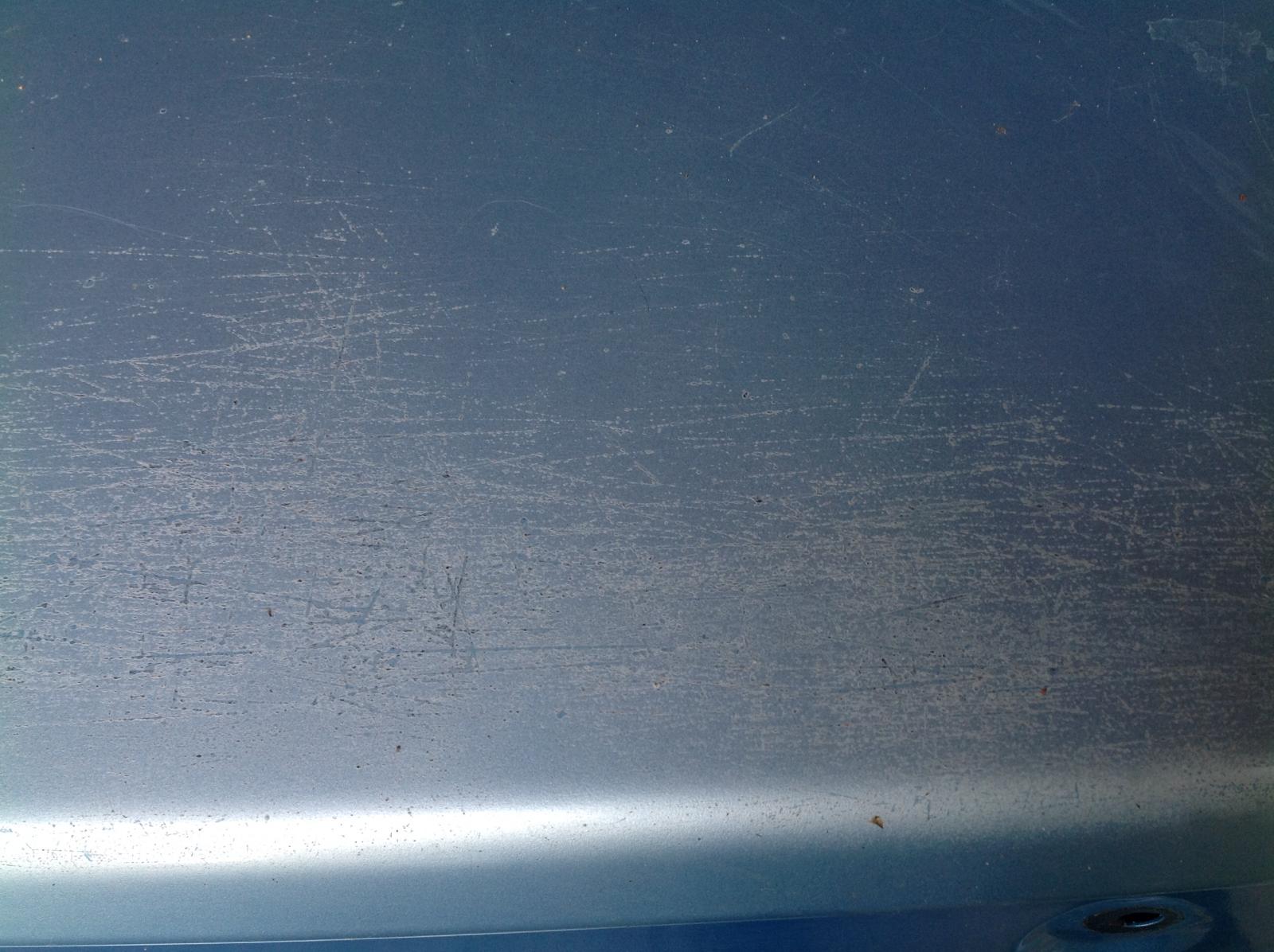

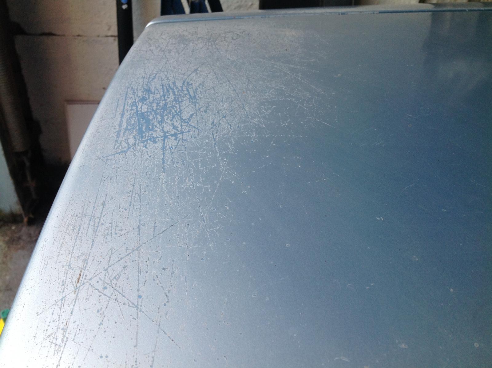

Ah, the well documented General Motors paint issues from the late '80s early '90s.
This car is a good example of the issues! The boot lid, roof and part of the bonnet look like this!
Yes, shame I had to buy one, but the spring transplant would be almost, if not totally, impossible without it. Not to mention dangerous!
I think the fibreglass composite springs were absolutely fine AFAIK. Saved a lot of weight and did the job well. It was lack of maintenance that killed them on the cars. They were fitted with rubber isolator pads to stop the ends rubbing on the metal housings. Once the pads wore/disintegrated the damage started. A nasty squeak eventually followed by a broken composite spring. Quite well documented on USA forums.
The composite springs may well be still available as a dealer part from GM, possibly, but at huge expense.
Too specialised for aftermarket manufacture I guess, hence the steel ones. Although only one company (Canadian) appears to make them. Still need fitting with isolator pads, so a pair of polypropylene type ones have been purchased for $ notmuch.

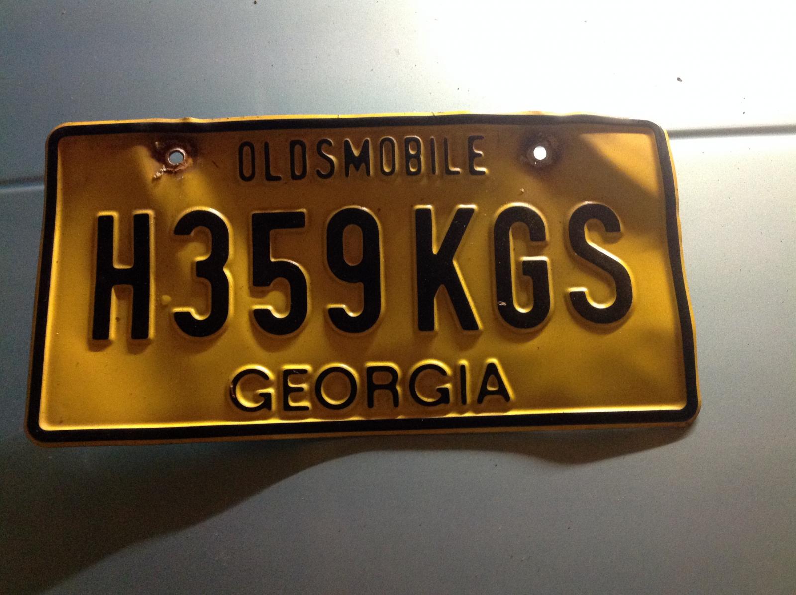

I have also replaced these fine items. Now garage ornaments.

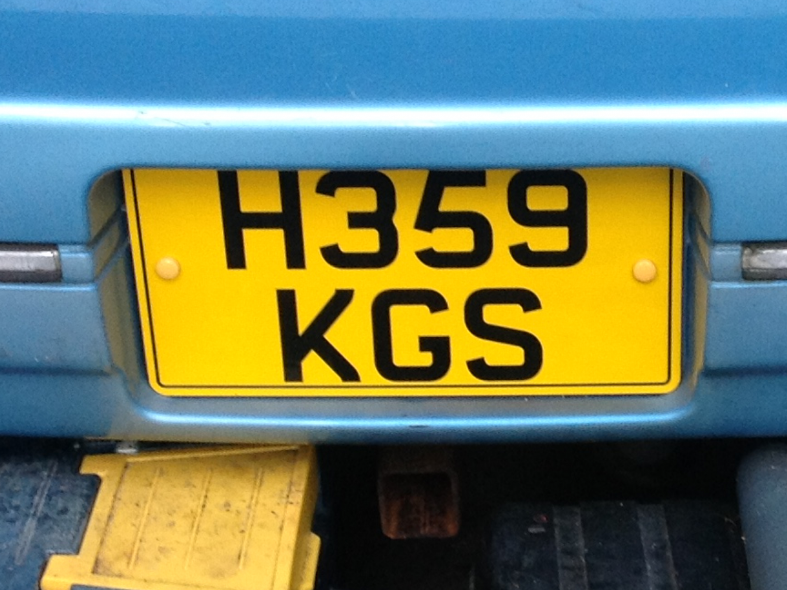

With this style of UK plate. I love American cars, but am not in America so changed them. Front and rear. The front one is white obv..

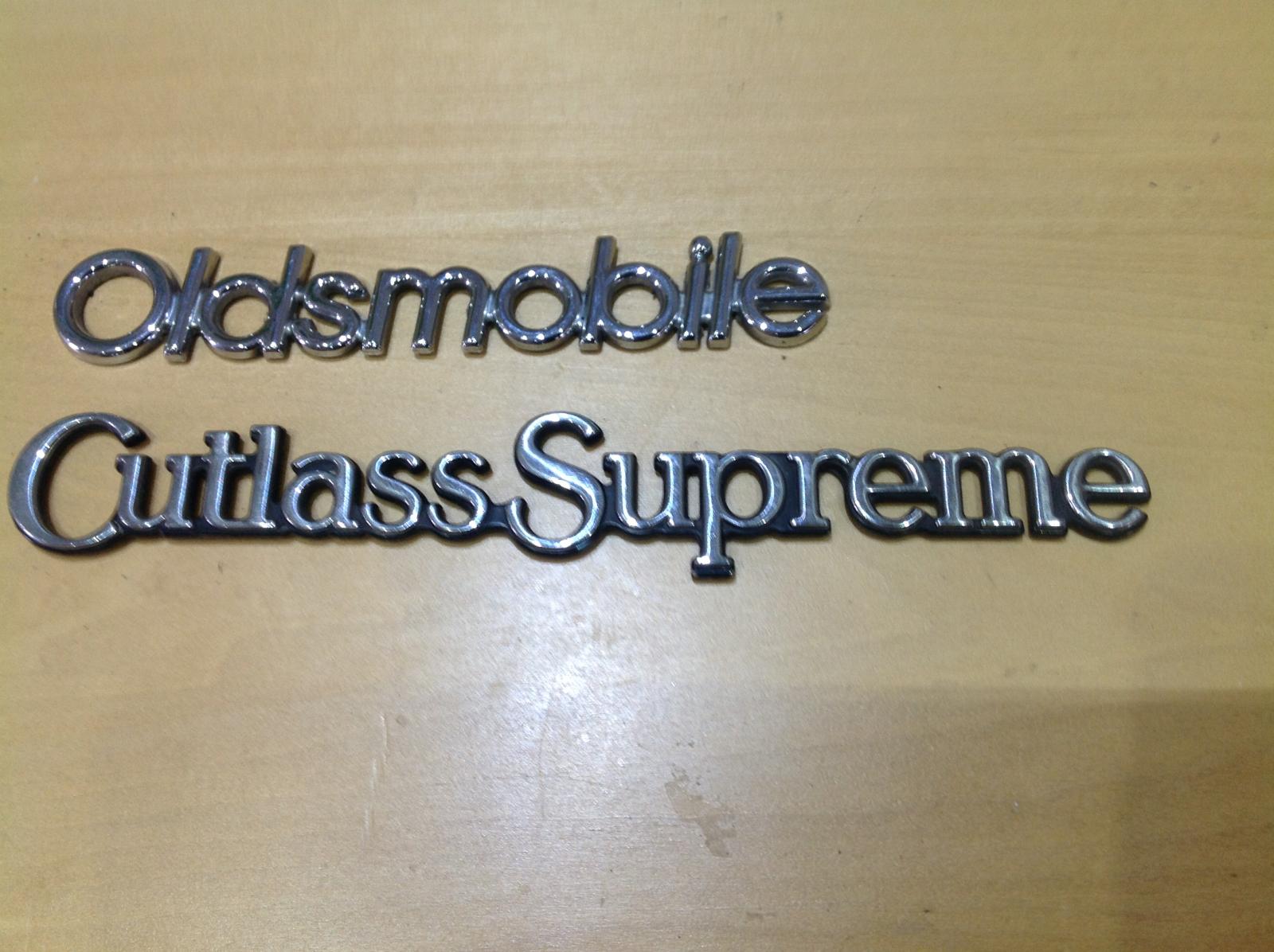

New badges arrived so the car will actually know what it is.
Rather than just
As it said previously!
Although am tempted to re stick this on the rear. Because it is....
