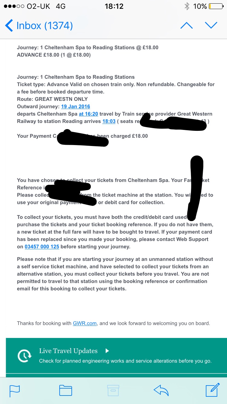

Obligatory train shot
Thought I was going to miss the train thanks to the self service machine not playing ball and perhaps the most unhelpful ticket kiosk guy I've ever met who spent the ticking time showing me how to clean my card to make it work with the machine rather than just processing the collection!!
