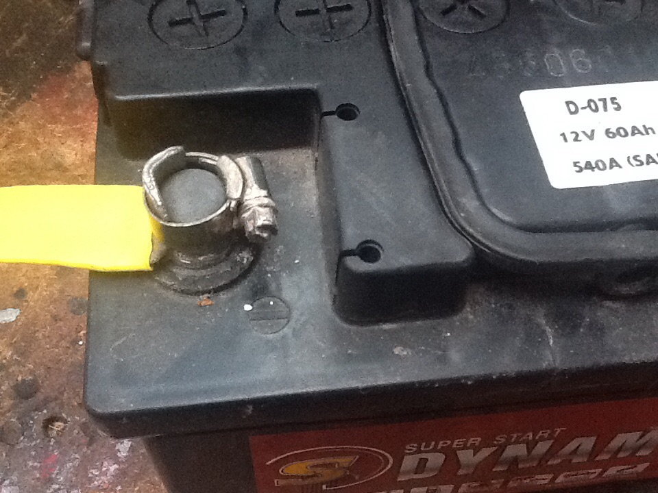

Does it have screw-on terminals? They are 100% certified shite.
It does have shite screw on terminals.  With plastic screw knobs.

Those screw on battery (not) connectors are not to be trusted even when new, warm and clean.
Hose clips are good in an emergencypost-17481-0-12051500-1452868193_thumb.jpg
