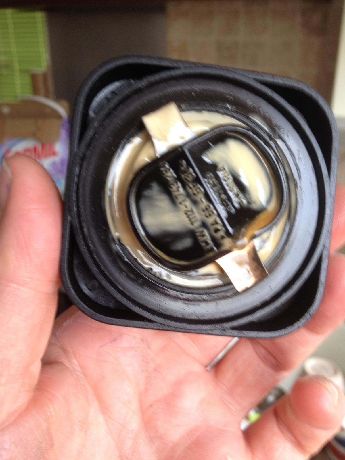

Have I got a K series BMW with a kippered head gasket
I checked the oil and water etc on the car last week and when removed the oil filler cap it was covered in a coffee coloured goo so I cleaned it up and forgot about it for a week and this weekend I found this when I rechecked it.
The engine in the car is an M44 1.9 which isn't known to be a problem like the M43 and I've checked the coolant and I doesnt seem to be using any and it's still a crystal clear blue colour and there's no antifreeze smell in the oil but I did only change the oil about 1500 miles ago so I'm a bit concerned but I'm only doing a mile and a half each way to the station in the morning in the car and the heater is on from the second I jump in just to clear the condensation in the mornings..
But today I nearly did about a 10 mile round trip to the tip and the car got up to temperature for a change and I expected it to dry any condensation out the engine but it looks worse than ever..
The thing is the car drives really well but only since I put a new PCV valve on the engine as that was blocked up and the revs would stick but it was the original one from 1997.
But before I bought it six months ago it had been standing for a couple of years and is quite low mileage at 56000 plus I have the same engine in my Z3 and that gets even less use and is around the same mileage but the oil never looks like that.
Sounds like condensation from lots of short journeys, while 10 miles will get rid of condensation it wouldn't burn of the mayo/coffee stuff.
^^ What Craig said.
My Dad's Micra was exactly the same from pensioner short journeys. I borrowed it for a day trip and it was clean as a whistle afterwards.
I've got to admit I rarely Rev the engine and it does most of its journeys around town at about 20 mph or stuck in traffic
 Hi, it's the short journeys that have started it. The longer journey will warm the engine up better and start to boil the water off but it can't all get out and just condenses again. I think you need to take it on a much longer journey and get it really hot. Can't you just walk to the station in the morning?

Ding ding ding ding... what they all said.
My 2.8 Z does it badly enough to get in the dipstick tube as well. Come spring every year it vanishes. 320 merc I had was probably even worse. As everyone else says, no problem.
I thought it was a Jaguar AJ6 peculiarity because of the external oil filler - but obviously not!
Petrol produces an enormous volume of water as it burns in the engine - which doesn't evaporate off when the engine never gets hot. It isn't just the exhaust which gets filled with water - some has condensed out here on your filler cap. As said, a decent run should cure it.

As above. Just drive it for a couple of hours.

Had this first many years ago in a (then almost new) Solara, panic panic OMGHGF. Got one of the mechanics at work to look at it :oops:
Use it man!!
I know BMW's suffer with this if they are not driven for 1000 miles every time you use them during the winter months.

As others have said, condensation. Clean cap and rag the car for a while :)
