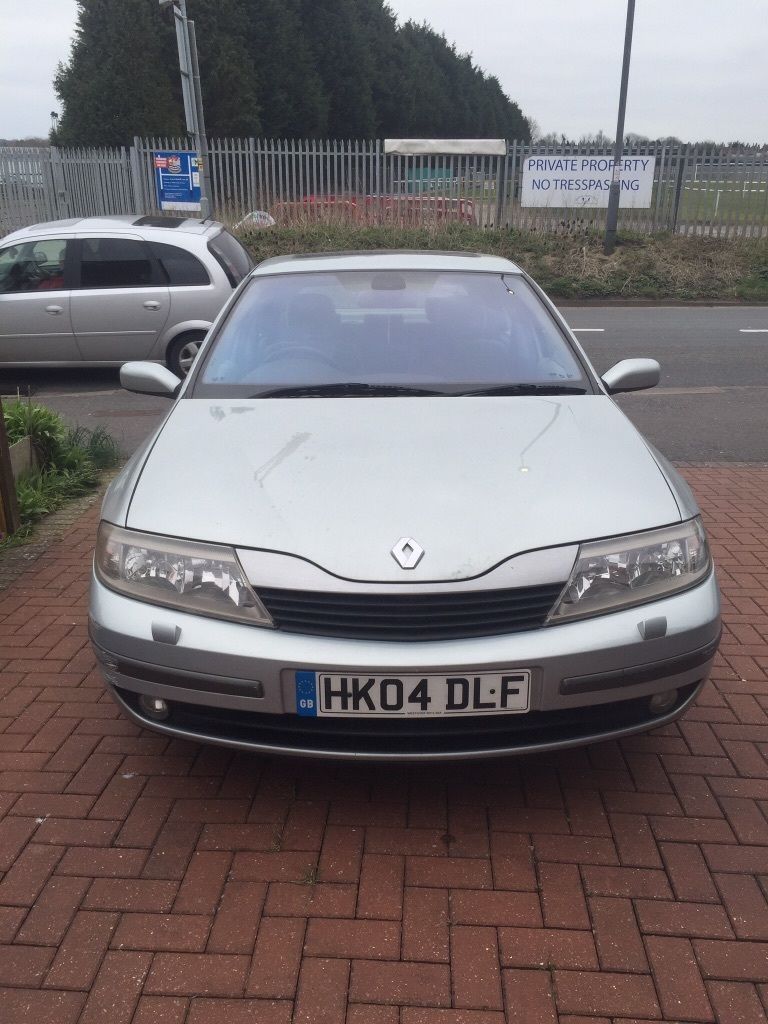

https://www.gumtree.com/p/renault/renault-laguna-2004-auto-2.00-litre-petrol-repair-or-spares-turbo-needs-replacing-/1160571592
AutoData reckons 5.1 hours to change its turbo.
When the Renault Service manual says this, you know it could be a bit of a fight:
NOTE: to slacken the turbocharger mounting nuts more easily on the exhaust manifold, it is useful to spray a releasing agent on the nuts when they are still hot, just before removal.
I do wonder if its just a split vacuum hose, wastegate rod loose or something like that though. He gives no further details on the fault unfortunately.
