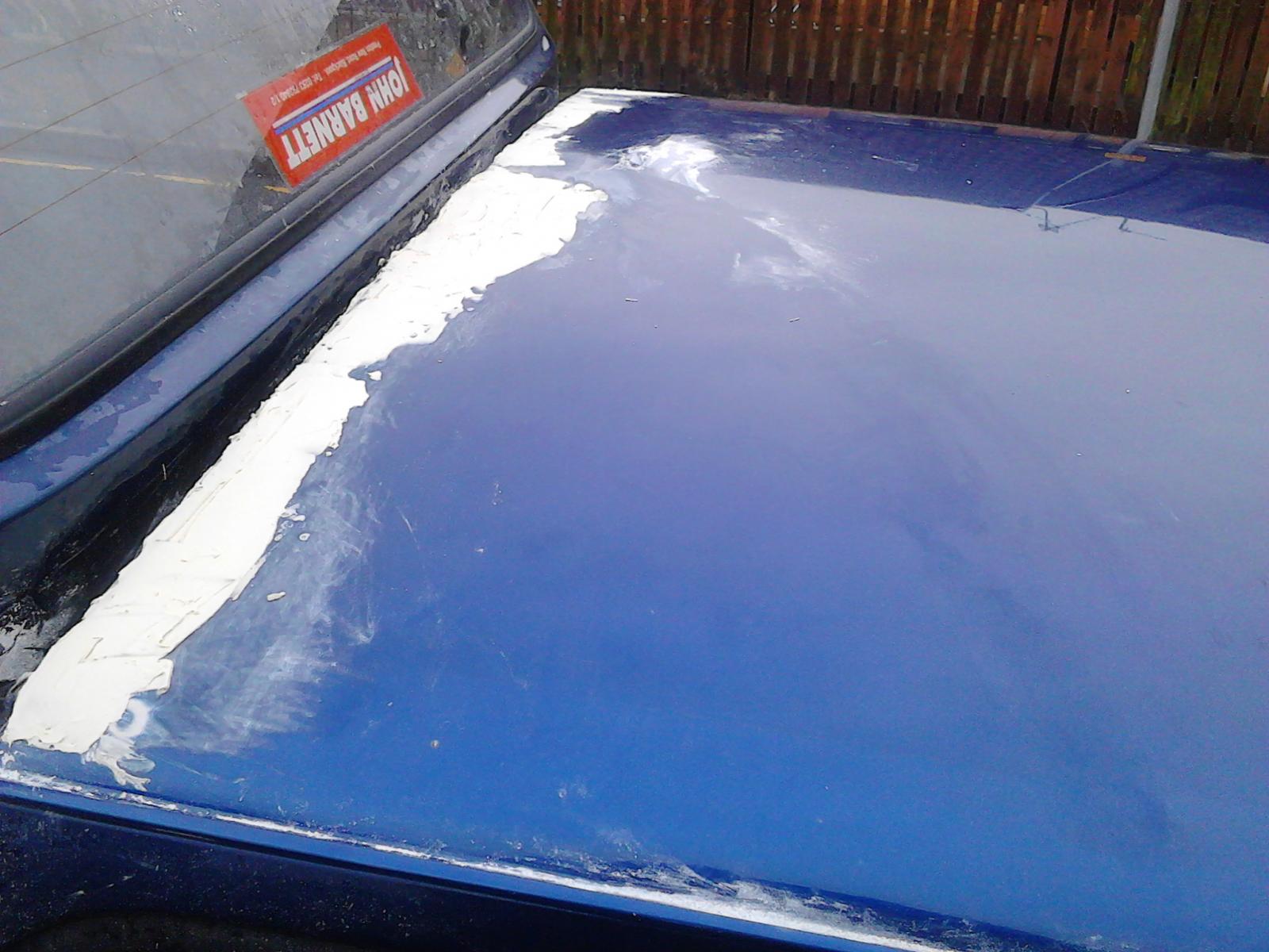

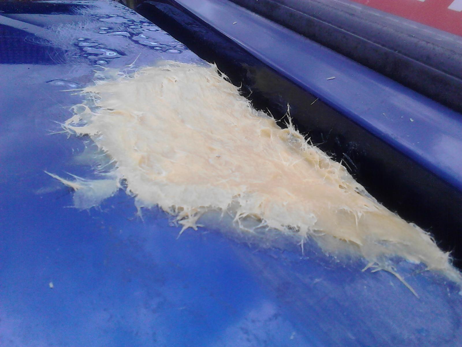

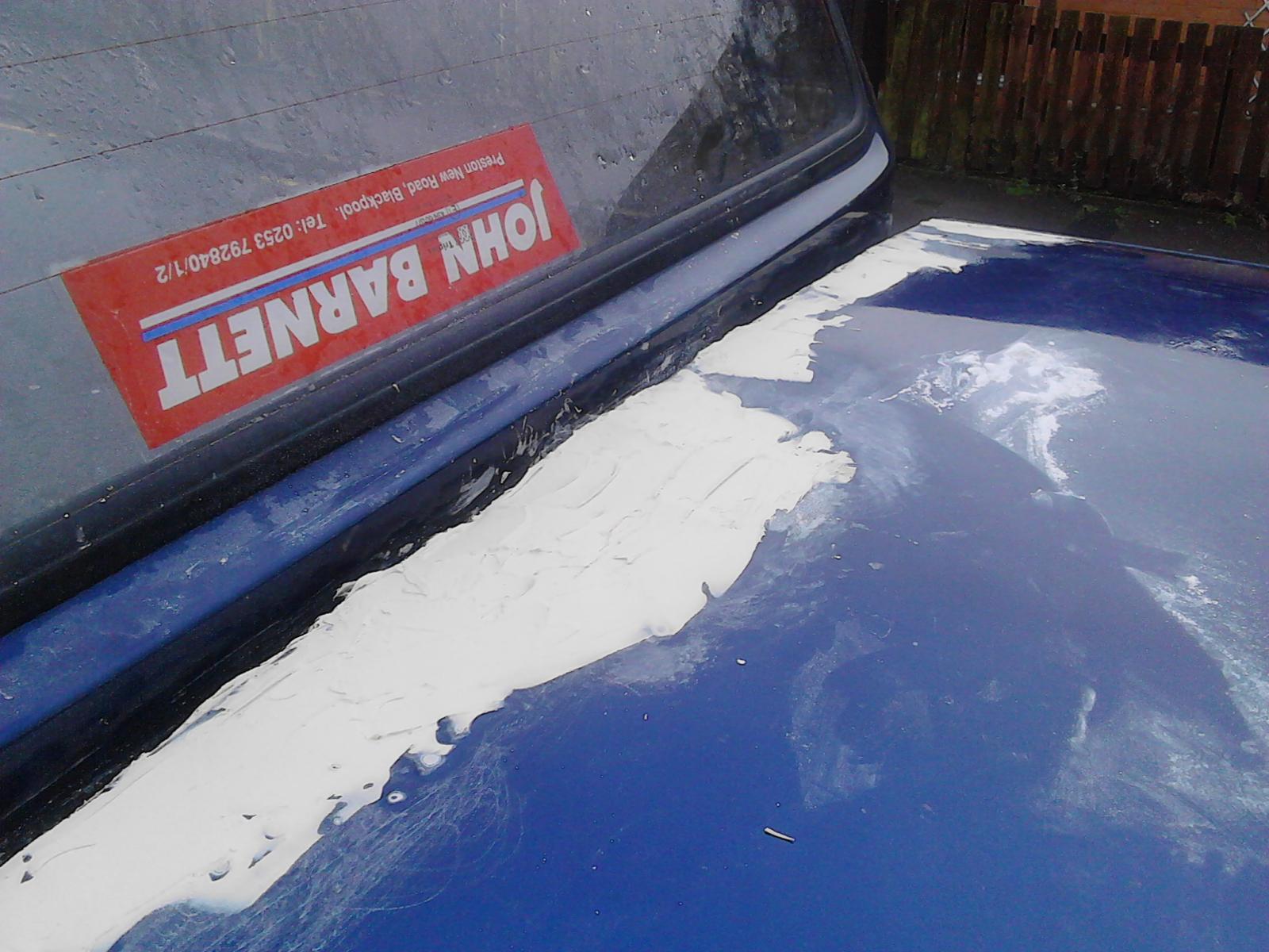

right cold out,fibreglass now appliedl little longer to set,coming along ok,2 new pictures,more to do...
Fook me I haven't seen repairs like that since 1984 nice to see you are staying true to the spirit of the car keep up the good work

A vinyl roof effect can be had cheaply with a rattle can of stone chip black (giving the orange peel effect) and a couple of lengths of adhesive window draft excluder to mimic the seams.

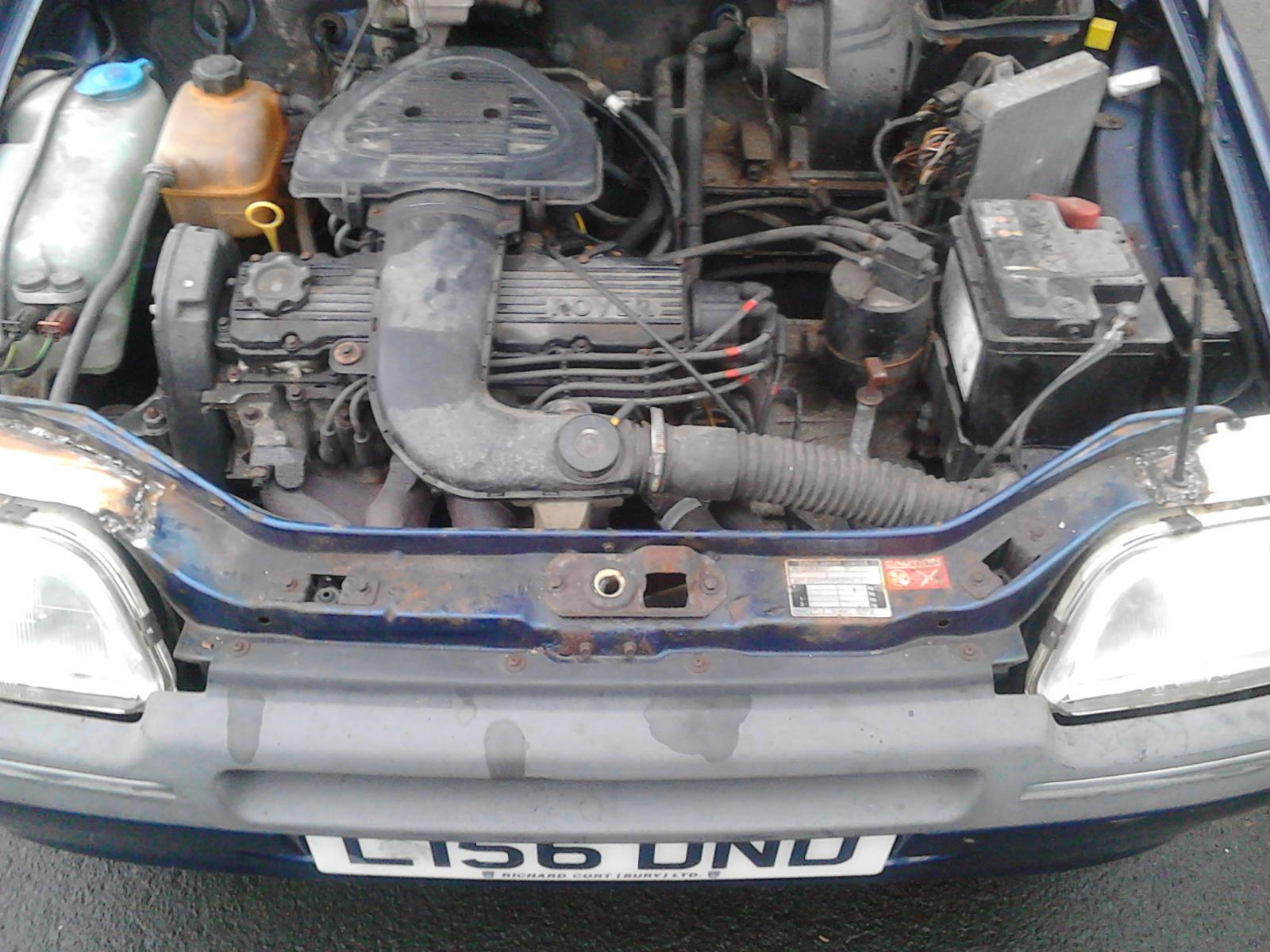

looks like are going for vinyl black,white chess board look,once i get measure done,will get some filler on next week to finish of,still need to sort slam panel,if it needs welding are not,are just cut some metal from washer are freezer cut to shape pop rivit in place....not frozen but bloody cold wind blowing about,next to mill...

we used to use metal bin lids,in 70s in belfast, 8) have sent a email to one firm to see if they have slam panel,otherwise seems hard to get,even rimmer bros do not stock...have spied a black fridge freezer,side panels look good... :shock:

I hope you're painting straight on top of that P40 without sanding it back. Snap off the really sharp bits, pick a non-metallic blue close enough to the current colour, don't mask, spray, job done.
Jesus, got to be honest I think I'd rather drive round in a massive flashing LED-covered horse fanny, but hopefully when you get the slam panel riveted or arc welded it should be a lot better.

due to go to tool station tomorrow,for big boy body filler,should improve rover finest.. 8) slam panel still holey,but soon..changed fuel filter,still had 22 year one on,been up on ramps,not a bit rust underneath,still in good nick.more pictures soon,sump had some light rust,sprayed it silver,left over from exhaust paint,its heat resisent...

I wonder what caused the roof to go like that?
it came from blackpool,and i think it has stood for abit,,how may left says theyre is only six left of this model..i think the last owner has passed away,so know chance of find out,still got the old style logbook,before the new one..
well good weather today filled abit more on the roof,got to sand it down yet,than borrowed mig welder,clarkes,got some scraps of metal,removed head lights,yet to clean up and seal,its getting there,see pictures,

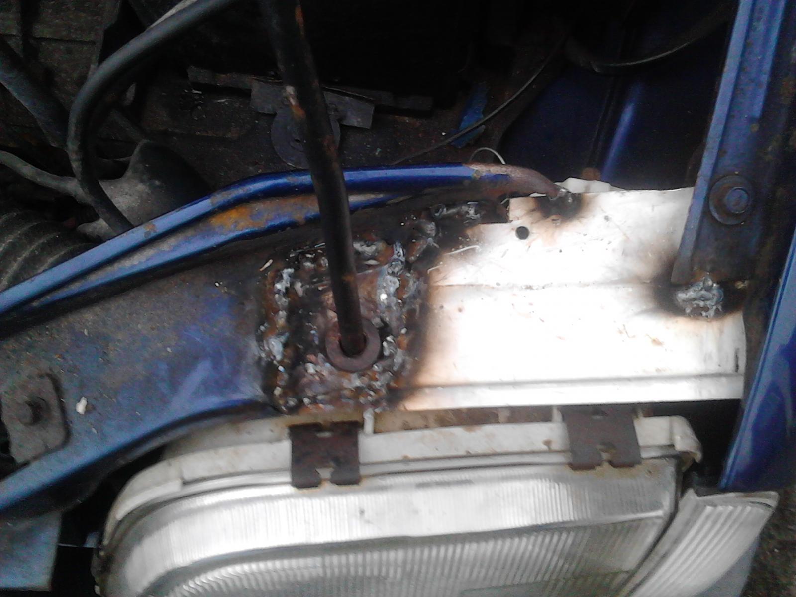

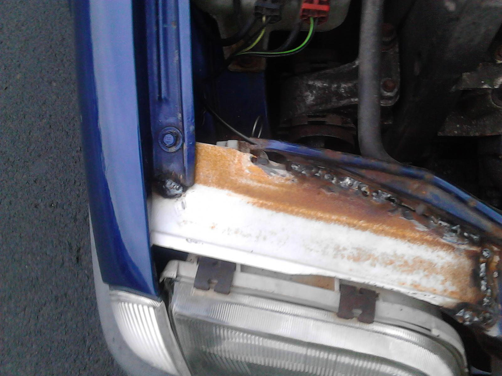

the cvt box was from volvo,few more bodges has to change os lower balljoint,was going to change whole arm,but the front bolt would not play ball and was going to snap,had to grind of lower rivets,bolt on balljoint,than to get big chassis bolt back to tighten up,had to cut into front chassis leg,hold the bolt with chisel from turning,than torque up bolt,thank god it did not snap,than mig weld chassis,!,will get picture tomorrow,..will paint on some zinc 182 grey primer,as used on the roof,looking slightly better.....done the oil filter change,screwdriver in filter that shifted it.put euros finest filter on £1.10 crosland,
