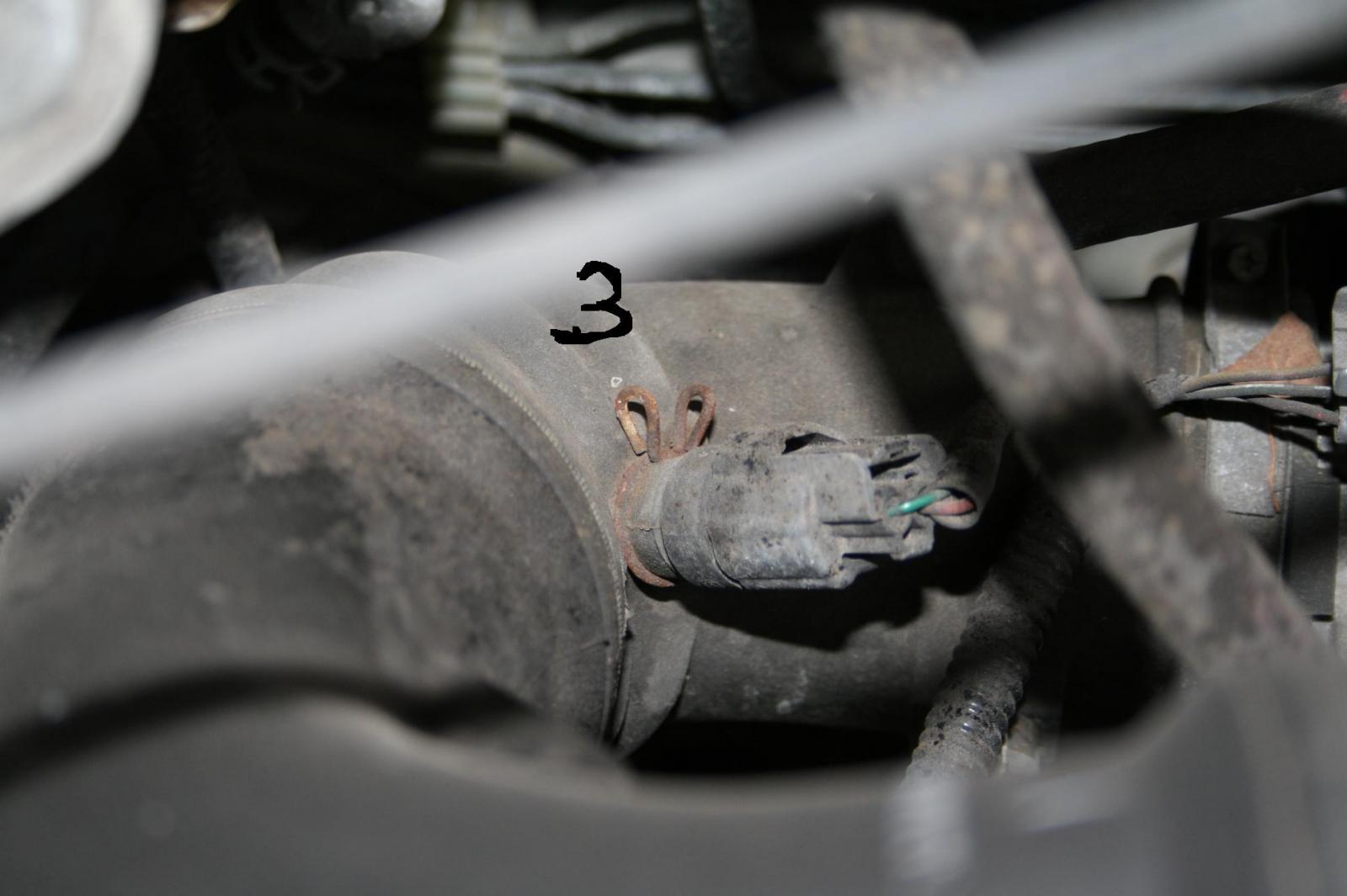

Christine Posted December 5, 2015 Posted December 5, 2015 This Honda HRV vetec you lot said would be great...since i've had it , its had no low down grunt ..utterly hate driving it . 4000pm and up to 7000 it goes like a rocket , so i assume its vetecing ok . I'm reading about Maf and map sensors needing a clean.. Come to a hill and i'm struggling , flooring it makes no difference you have to drop a gear or two and rev the bollocks off it , fuel consumption is heavy . What bits might need cleaning?What have i got map or maf? Engine is D16 W5..What are these bits ?

Honey Badger Posted December 5, 2015 Posted December 5, 2015 This is the Vtec solenoid as far as I know, they are always at the rear left of the cam cover Could the rear diff fluid need changing, it can cause a bit of transmission winding if the fluid goes bad? http://www.coxmotorparts.co.uk/genuine-honda-crv-rear-differential-flushing-kit-p-1204.html No 2 looks like the MAF to me, it's certainly in a similar position on my throttle body, twosmoke will be the man who knows. Christine 1

Eddie Honda Posted December 6, 2015 Posted December 6, 2015 What are these bits ? #1, 36162-P75-A11 Valve, Purge Control Solenoid: #2, 37830-PAA-S00 MAP sensor: #3, 37880-P2A-004 Air temperature sensor: #4, 15810-P2M-A01 Valve assembly, spool: http://www.lingshondaparts.com/honda_car_parts_selection.php?block_01=17S2H01&block_02=B__0100&block_03=19328 http://www.lingshondaparts.com/honda_car_parts_selection.php?block_01=17S2H01&block_02=E__0101&block_03=19328 http://www.lingshondaparts.com/honda_car_parts_selection.php?block_01=17S2H01&block_02=E__1001&block_03=19328
