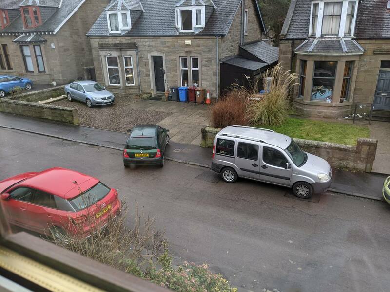

I managed to get a solution to the issue I had with the dash in the Clio, pictures of the solution below.
Yep a Gumtree ad with the fault listed got a sale within a couple of hours.
Been here 19 years so it can't be too bad.
Houses very rarely come up for sale in the Street.
