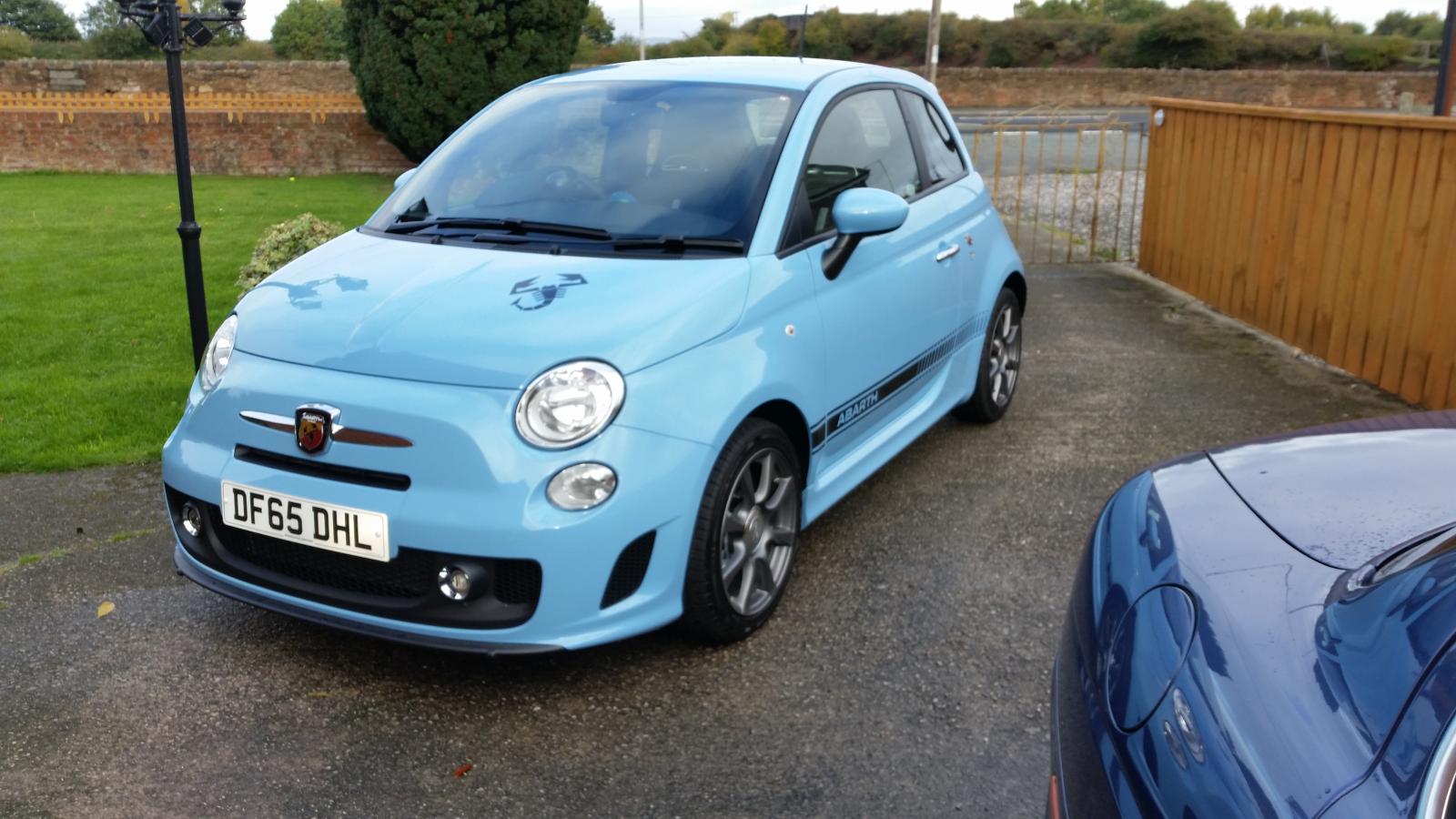

Oh, picked this up on Wednesday so hibernation enforced rather than wanted.
