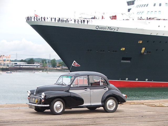

I did this to mine but some folk confuse it with primer -
