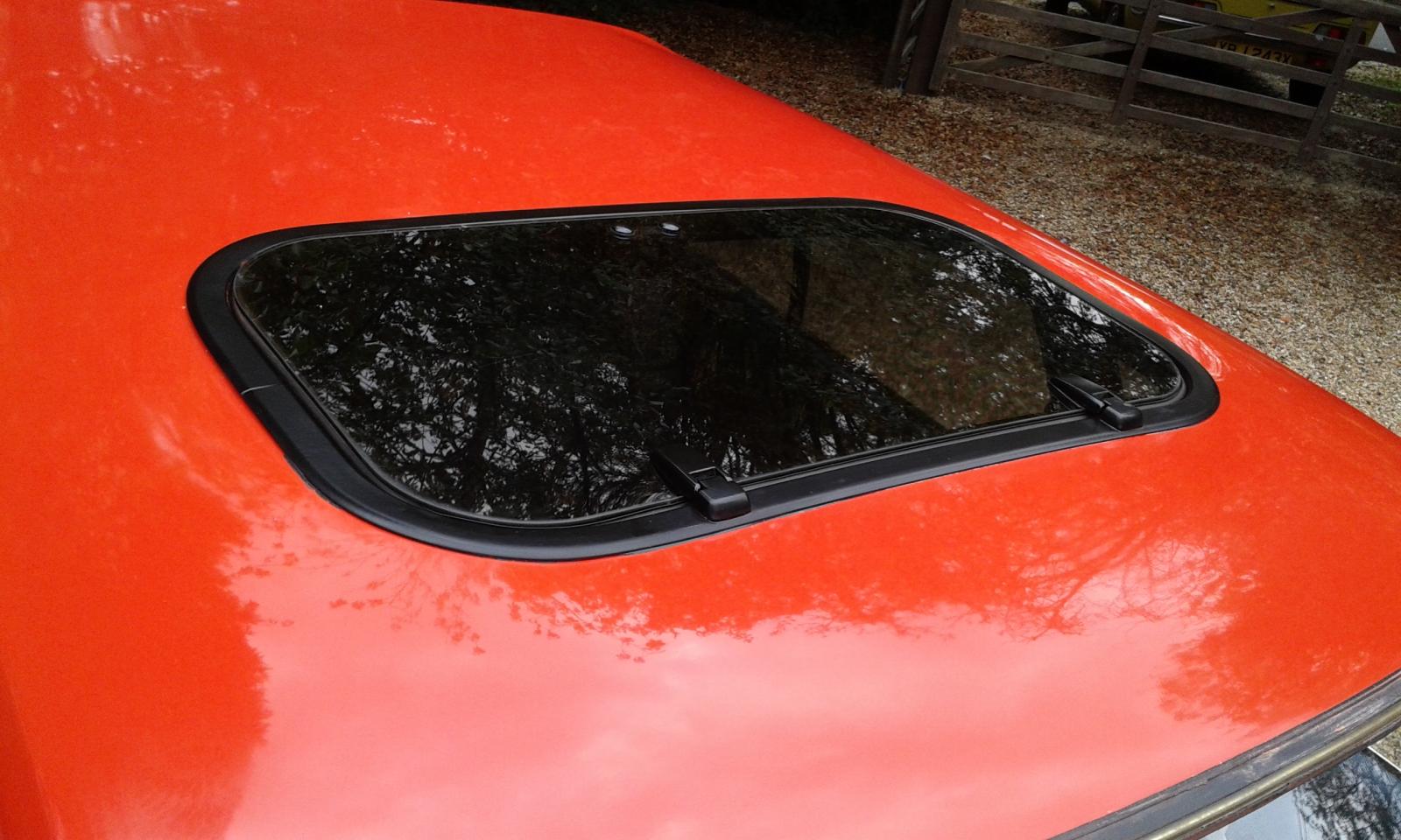

A bit of controversy over the sunroof, but as it is a genuine period Unipart optional extra and saved a lot of hassle welding a hole the roof, it's been kept.

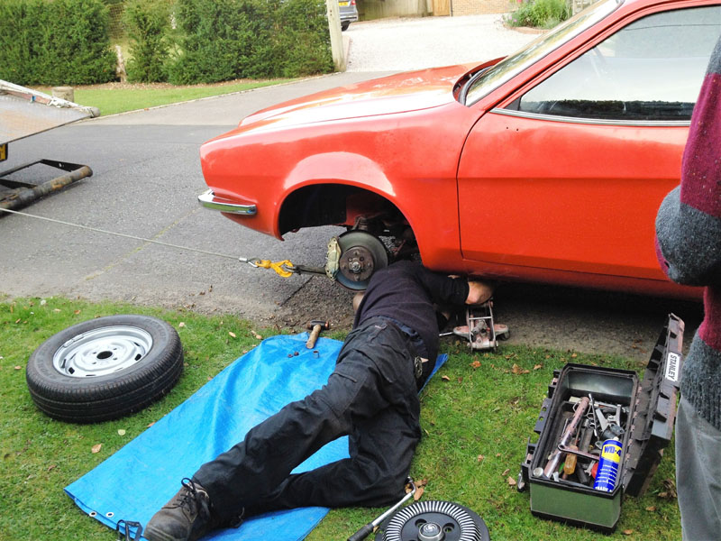

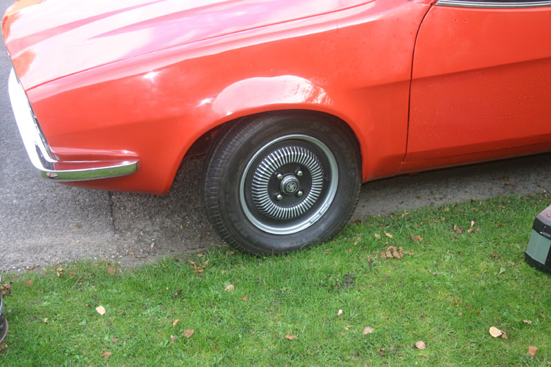

I thought I would take Maurice for another trip around our not-very-large-estate to check that things were OK for Friday's MoT. I had got up to the fastest speed it has done for 22 years, that is 30 mph and thought I ought to check that the brakes felt OK. They were stopping the car nicely when there was a big bang , a graunching noise and a bit of a smell of rubber. Any way the car stopped. I got out to have a look as I thought a displacer had gone pop but the car wasn't particularly down on one side but the front N/S wheel was at a wonky angle; indeed, only three wheels on my wagon..

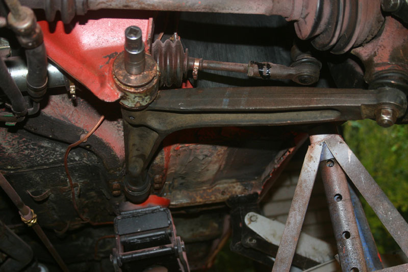

This did not look good. I tried moving forward but as you can see the wheel is tight up against the rear part of the wheel arch; it wasn't going anywhere. Sooo, I walked home (only about 800 yards) picked up a car full of tools and went back to see what I could do. My wife, bless her, also called my good friend Jeff to ask for assistance! He arrived in record time. It was immediately apparent what had happened in that the metal casing of the butterfly bush at the rear of the front lower wishbone had broken due to rust so the bush part with the wishbone had moved over to the centre of the car, thus allowing the wheel to contact the rear of the front wheel arch. When you look at the thickness of a new bush it is astounding that this one had rusted enough to give way and none of us had spotted it was feeble. My camera failed so I haven't got a picture of this as it needed to be put back on so I could get the car back home. We tried to take off the lower wishbone; it was easy splitting the lower ball joint and taking off the nut for the bottom of the drop arm, but could we bonk out the wishbone from the front bush; no, we bleeding couldn't.
The problem was we were unable to move the wishbone so that it was in line, i.e. the bush from inside the butterly bush was in line with its metal surround. All this by the side of the road remember albeit it is a very small, quiet estate road; more dog-walkers than cars. I decided, reluctantly, that we had to be recovered so we called the local brilliant garage who came out straight way with a low loader; we had to wait at least 5 minutes... The helpful driver (who I know because all my cars are MoT'd at that garage) said he would move the wishbone back into alignment using his winch which was a vey quick and impressive solution. He then said, to get the car mobile again he would turn the broken butterfly bush upside down so it was held into place; brilliant. Another 5 mintues doing that and re-assembling the lower ball joint and Bob's your uncle. Great lateral thinking and it may be an obvious solution to you engineers but I don't think I would ever have thought of that. Well I was impressed even if you aren't. So, I drove home slowly and tomorrow's job is to replace that wishbone (I'm sure I've got a spare one). I don't expect that to be straightforward and then we have the other side to replace...

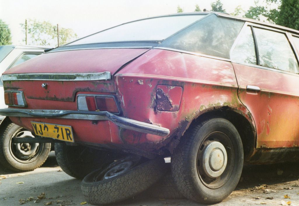

Reminds me of a Princess that was sitting in a garden near my parents house (Dacre hill) to locals, maybe fellow forum members Station or Warren have pictures... let me investigate !

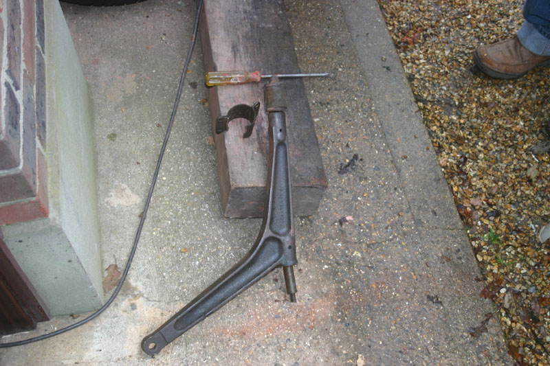

Well it's all been repaired now and a new lower arm and bushes were fitted. You can see in the first photo the broken bush case that gave way during braking.

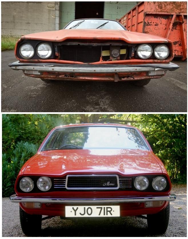

From beast to beauty in 12 months, and now with its first MoT for 22 years.
Front%20old%20a%20nd%20new_zpsf14kcabd.j
That looks like the start and end of the "Show me" sequence in Christine!
It is, very much so!  I remember seeing pics of this outside Sam Glover's hangar, and thinking, poor car, that's dead.  I'm so glad to be proved wrong!
