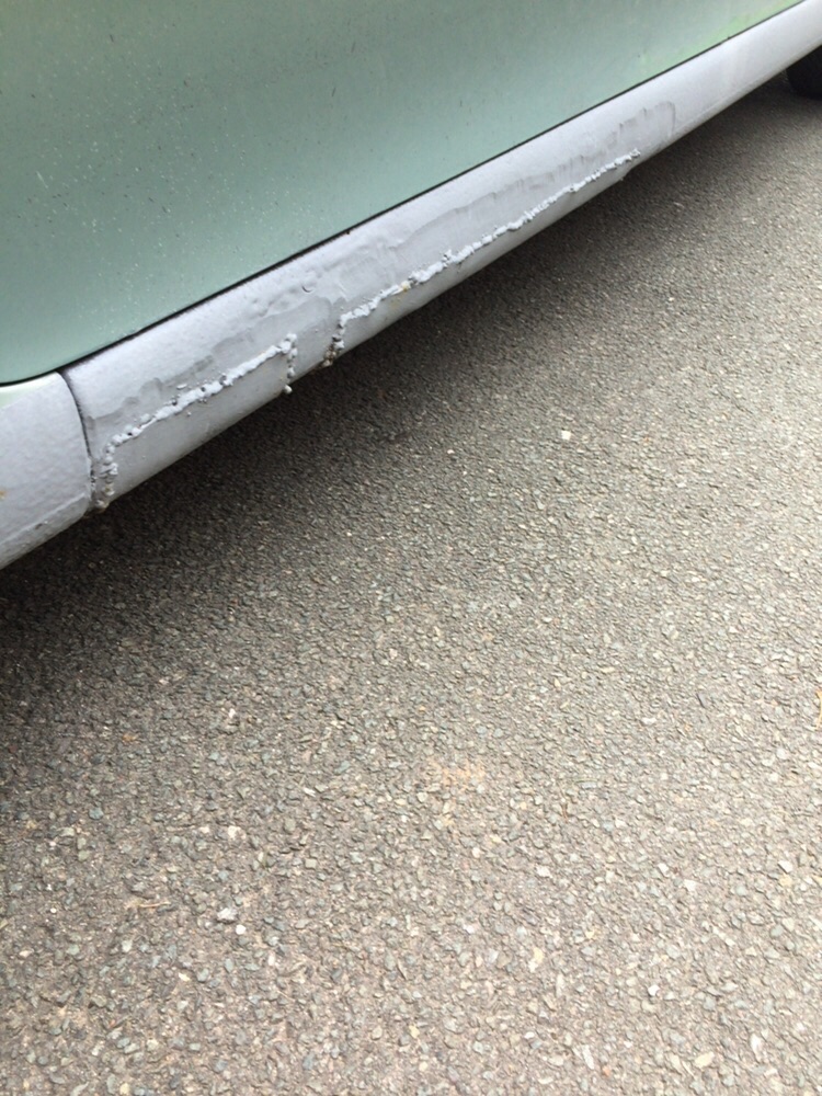

Feast your eyes on this -
This was a garage repair to a sill on my mate's father in laws xsara picasso.
It looks like its been done by a pigeon that has been on a diet of guiness and scotch eggs.

That is spectacularly shite, would that even pass an MOT? I'm sure I have seen fail sheets with 'unsatisfactory repair' or some such on them.
I think if you ground back the welds on that the plate would fall off. He must have just wanted to nurse it through the test. I for one wouldn't be happy with that job, it just looks a fucker.
It looks like some of the welding* I did when I was 18 and had hired hired a completely borked mig. Honestly I reckon they could've done a better job with Evo stick...
Grotty MX5 I had once almost got an advisory for "Dead bird in radiator", but the guy was too amazed that the brush-painted purple horror with dents all over was probably the best MX5 he'd seen underneath.
This is what I was thinking, stevey wonder can see that it isn't seam welded properly
It's a fucking Picasso. It can't look any worse than when it left the factory.
Should have been hammered flat & dragged over the bridge. lol.
Of course it would.
If the space between the 1 and the V is an inch too big on your numberplate, now that's a different story.
Honestly? What I can see in the photo would pass, but get an advise for being piss poor. Patches in panels need to be seam welded (unless rendered invisible with isopon) and that there only just meets the definition. If I could push the tip of the corrosion tool under the patch, or it was lifting or obviously not closed along an edge I could fail it. Having said that, I can't see the bit where it meets the floor edge and that's usually where the problems really are.
I know "garages" that do work like that.
Also, I had to fail a transit that someone had "restored" because there wasn't a single repair done well, and he'd missed a load of structural rot too. He wasn't a happy chap.
Christ, that looks like I welded it.
I know may mate had his series 1 RS Turbo escort fail an MOT because a freshly welded repair had just been tacked in the corners. Again, by a garage.
My first and only attempt at welding a car was given a clean bill of health by the MOT tester. Earlier that day he had rejected three attempts at one repair from an unnamed local garage. Unnamed until another tester, I think it was Barry Cade of this parish, named it- and it was the one I would have guessed.
Most local garages seem to think buying a £150 clarke MIG and waving the gun at some metal means they can offer welding services. 95% of them need castrating before they breed.
