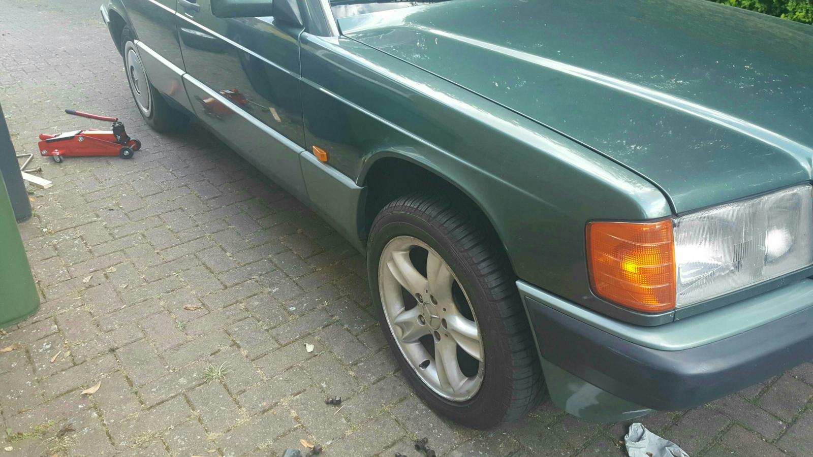

In other news, I got a full set of CLK wheels given to me today. I was so hopefully that they'd look good on the 190 and freshen it up without being bling. Sadly, I failed. Trying to a buyer now.
