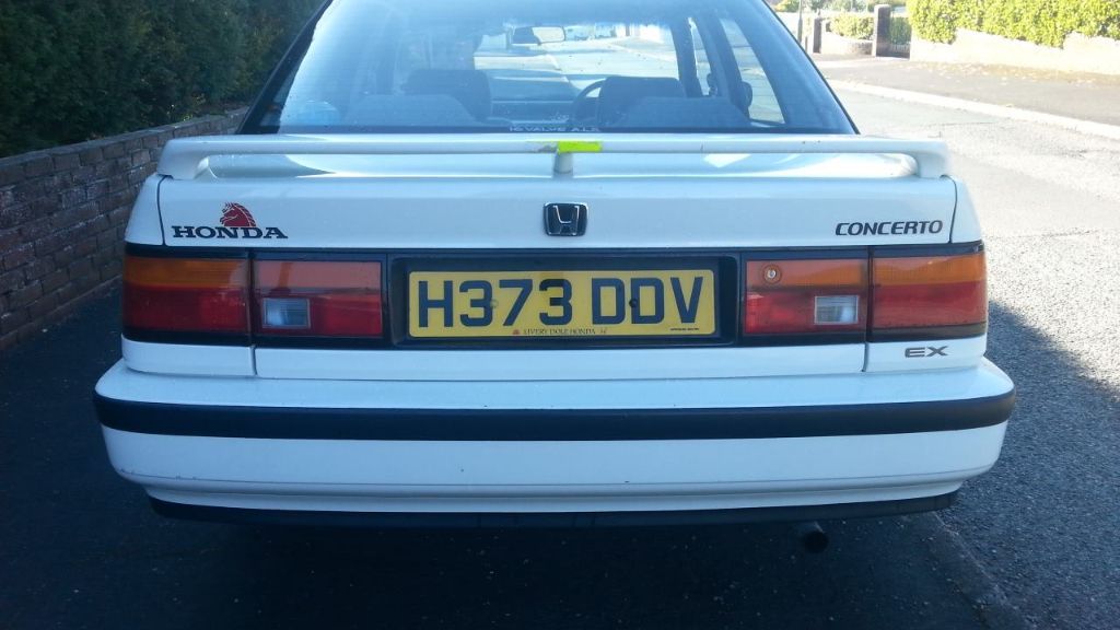

Putting aside the cool headlights idea for now, I put into practice the other parts swapping idea I had, namely a Concerto rear light set.  In theory it should be a case of swapping the rear lights and under light trims over and in practice, it turns out that's exactly the case for the lights, at least.
The bolts line up exactly with the Rover ones and the entire light cluster hole is covered in exactly the same way so even without the trims underneath you can swap the light units and not worry about water ingress.  The wiring is different though, the Concerto corner lights only have indicator, brake and reflector in them.
The profile of the cluster is slightly different to that on the Rover too but since you need the centre panel for the full compliment of lights that's not really a problem (although none of the Concerto centre panels seem to have the manual lock in the same location, which is a bit irritating).
The side profile is identical.  Note that I haven't fully tightened the nuts on this light cluster in the photograph but it does sit flush properly as it ought and the boot lid opens and closes as it should too.
I can get a matching light for the other side and the centre piece no problem.  The issue is the trim at the bottom which is going to be difficult to find, I've already called the guy breaking the white Concerto on eBay and both the under light trims and the centre panel are gone already.  It's a simple enough shape, I can likely make it up out of metal or fibreglass or whatever if push really comes to shove.  For now I'll keep to the stock rear end until I have all the parts for converting to the Concerto rear which is now definitely going to happen.

Just a thought.  Need to figure out how if it's possible to remove the Concerto script, of course.
Three rear ends then.  Newest has the lock where it is on the Rover.
I've bought the oldest one so I don't have to modify the bumper and it was easiest to get hold of.
As far as I can tell the Concerto script is moulded in so you can't undo it.
