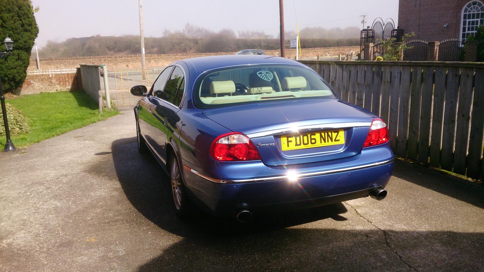

When I bought my S type jag last year I got a fully stamped service book from the supplying dealer but no invoices.
I rang the dealership and explained I'd just bought the car and, to his credit, the guy there went through the whole history over the phone.
The original owner had put the car in for a service and mot every May from new and the invoices matched up with what the mot history on dvla said.
Added bonus was a year before I bought it it had 2 new turbos fitted at not quite the price I paid for the car!!!!

You have an S-Type R?
More info, pics and driving impressions, please.  In your own time.
My friend........
The S type R is supercharged.
I bought the very sensible 2.7 V6 diesel manual.
Got to say it's the best car I've owned!!
40+ mpg, fast, quiet and oh so comfortable.
