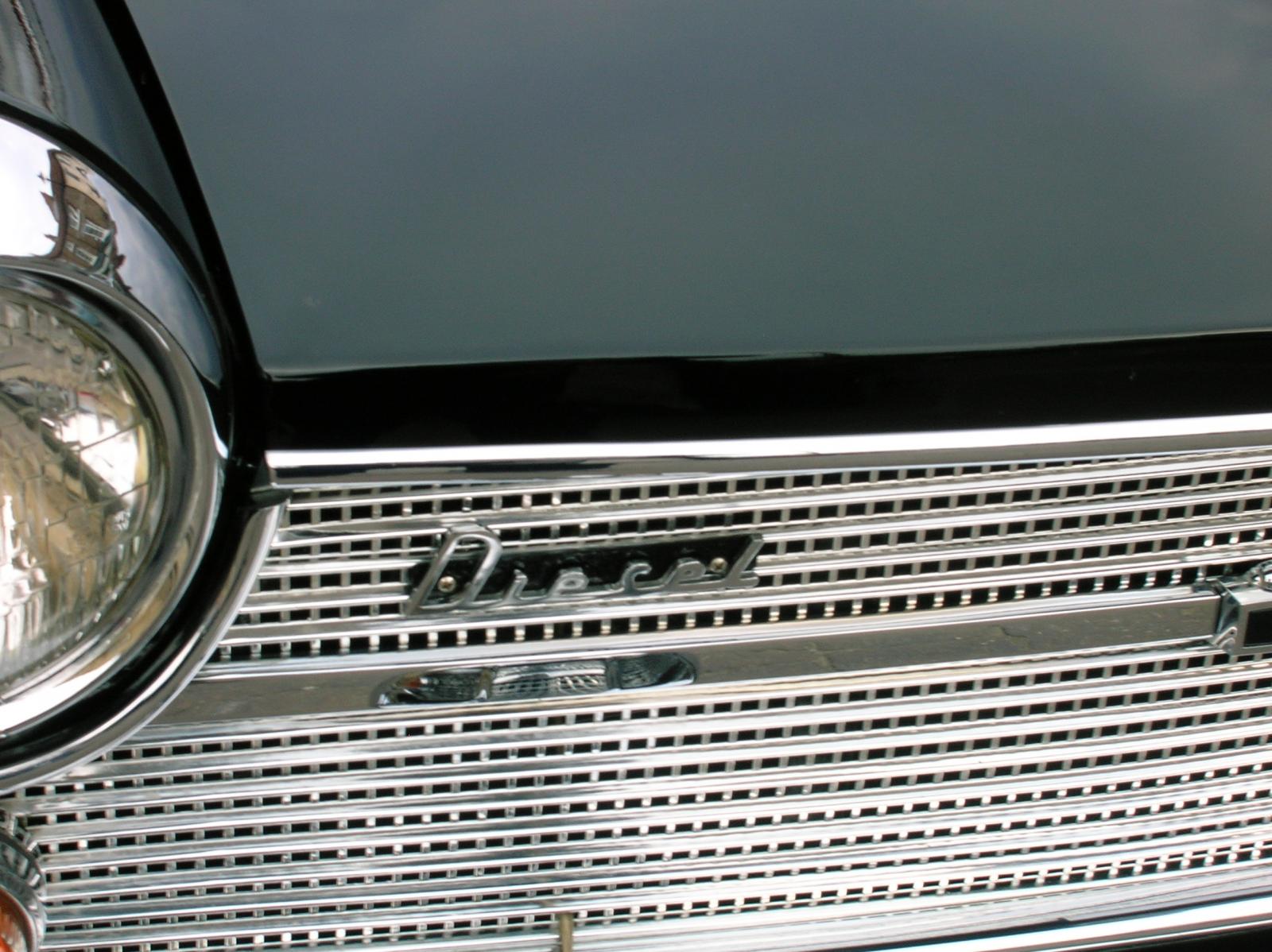

no at least one diesel cab survives!
we went off on a run over the moors last year, and it was with us.
it is a black austin cambridge, complete with taxi meter still fastened to the floor!
and yes, it is no ball of fire on the road..

I'm sort of glad one survives, but over the moon to know it isn't mine!
it was quiet comical at times, driving over the moors with the diesel cambridge up front.
we were travelling from Thirsk to Robin Hoods Bay via the proper back roads.
there are some proper steep climbs on the way, 1 in 4 type steep, we would all stop at or near the bottom of said hill while the austin climbed the hill in first gear.
