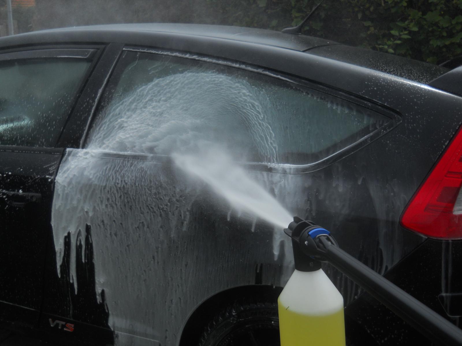

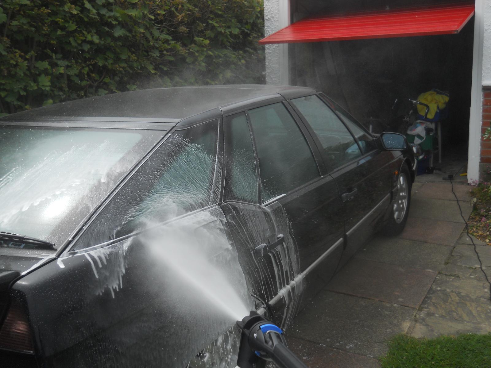

FakeConcern Posted June 20, 2015 Author Posted June 20, 2015 After all the recomendations on this, I bought a Nilfisk, which I tried out today, not sure if it was better than using the hose, but was much more fun! dave21478 1
Matt Posted June 20, 2015 Posted June 20, 2015 Does that bottle have a mixture control dial? That snow foam is thiiiiin. FakeConcern 1
FakeConcern Posted June 20, 2015 Author Posted June 20, 2015 No mixture control dial & not Snow Foam, just some cheap car wash stuff I already had! It all worked well though!
