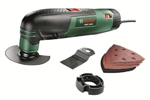

So yeasterday I took the old screen out, and did it without breaking it further**
I have one of these oscillating cutters...
Which I hadnt thought about previously. Turns out its ideal for the job and buzzed right through the glue on both sides and the top edge. The bottom is trickier as the dash is in the way cutting from the inside and there are metal lips in the way of the blade cutting from the outside so I did that with a gear cable liberated from my bicycle, sawing through the glue.
**I did then crack the screen as I lifted it off the car, but I wasnt particularly careful doing so and just lifted it by one end on my own so it cracked under its own weight.
