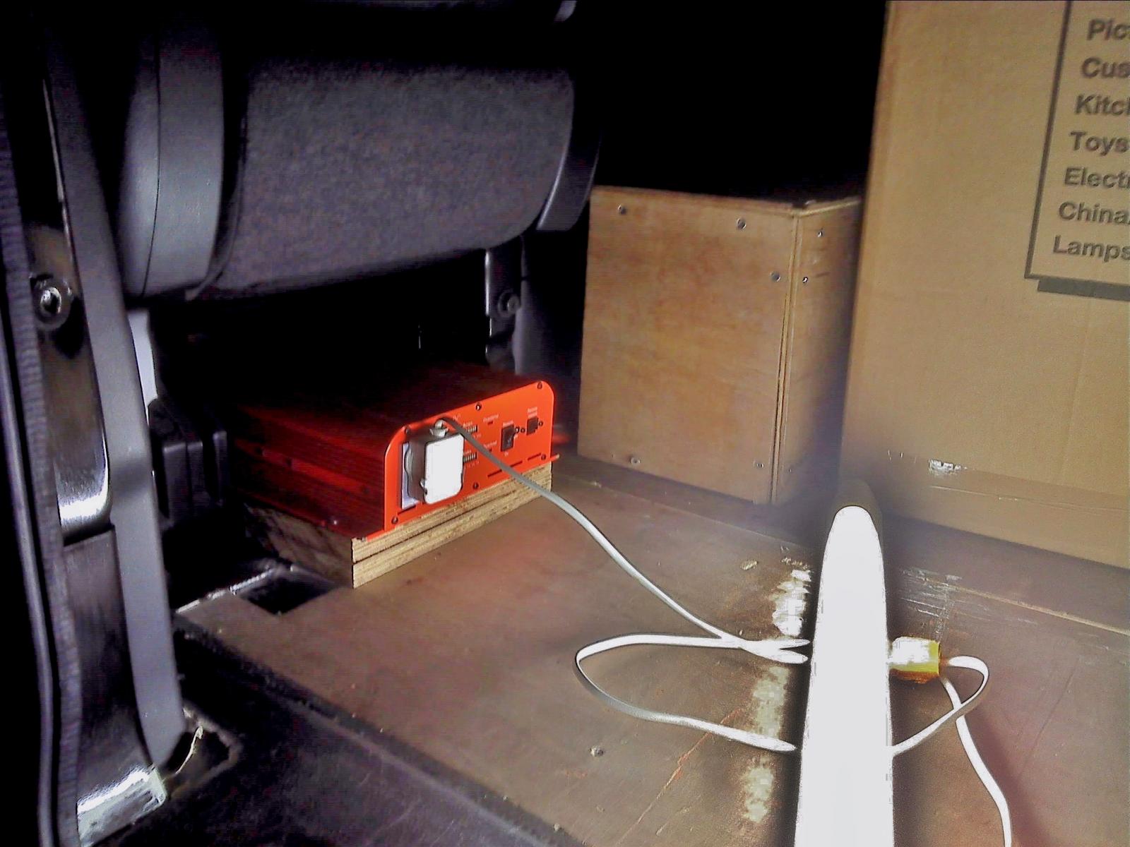

Asimo Posted February 19, 2015 Posted February 19, 2015 ^^^J4 van, truly a close relative of the MGB I once had to bale out of the back seat of a burning Beetle in Berkhamstead because Dad didn't put the battery cover back. Embarrassing, that sort of thing, to a ten year old. Be really thorough with clamping the battery down. I occasionally work with Landrovers fitted with a pair of extra 12v batteries for 240V inverters and this installation has been re-designed a couple of times because the batteries have broken free during off roading. Ideally the battery should sit in a fixed tray that stops it sliding around and be clamped down into that tray to stop it bouncing out or falling over. Vibration isolation of the inverter is a good idea as well, inverters are seldom that solidly built.
Alan_Green Posted February 20, 2015 Posted February 20, 2015 ......one will fit a battery and the other will fit my chunky mains inverter.So you're going to run an 240v inverter off the 2nd battery? In that case you need a "leisure battery" like this: http://www.ebay.co.uk/itm/110Ah-Leisure-Battery-Low-case-Fuller-Power-Leisure-Caravan-110-Low-Height-/161588648445?pt=LH_DefaultDomain_3&hash=item259f6f19fd You'll also need an intelligent split charge relay to stop the starter battery running down and I think you mentioned this. I can recommend this unit - http://www.ebay.co.uk/itm/DURITE-0-727-33-12V-140A-SPLIT-CHARGE-INTELLIGENT-RELAY-/201137399452?pt=UK_CarsParts_Vehicles_CarParts_SM&hash=item2ed4b9269cThe other popular unit is by a company called Amber Valley Developments, but in my experience the units only last 12 months. I phoned the sales manager after yet another one failed (at £80 each) and his attitude was very poor. Called me while driving, was dismissive, almost hostile, and basically said the product wasn't up to much. Said he would call back later but never did. I've never known a salesman slag off his products before or be so carefree about reputation. Meant to shame the firm on YouTube. Amber Valley Developments AVSPC12 Split Charge Relay Review. That was for the search engines.For years now I've operated mobile office vans. Basically two leisure batteries in a plywood box behind the drivers seat; a Durite inverter under the passenger seat and all linked to a Durite intelligent relay and a big fuse. In the early days I had an on board Numax "connect & forget" battery charger and a 240V mains hook up, but found that I never needed it. You can always run the engine if the batteries get low and idling an engine all day long seemed to use so little fuel (filling brim to brim) that I couldn't even measure it. cros 1
