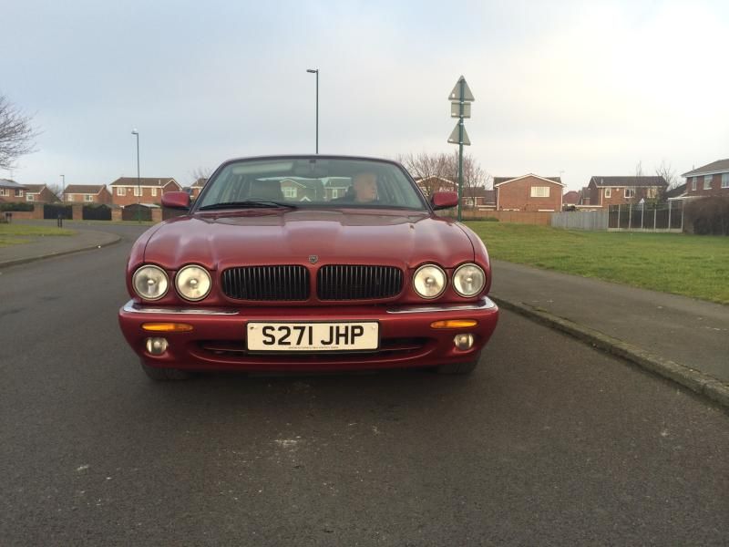

JohnK Posted February 15, 2015 Author Posted February 15, 2015 I've had two E39 528i's in the past, their engines were also well known for the Nikasil issue back in the day but both mine were fine (212k and 145k respectively). Thanks for the heads up folks, it's appreciated. With these things in mind I've identified a couple of other X308's either on route to or in the area of the original one, within budget, so I will look at all 3 and buy the best one. Leaving around 8am, hopefully I won't come back empty handed!

JohnK Posted February 15, 2015 Author Posted February 15, 2015 I've bought one.Not the one I originally went to see either. There's a tale of woe to go with this which I will write when I am home. If I get home ... brickwall, forddeliveryboy, fred and 1 other 4
JohnK Posted February 15, 2015 Author Posted February 15, 2015 It's home. Against my better judgement, we left this morning in 1 car, with the aim of bringing 2 back. Only 1 returned... Full story when I'm out of my rage (caused simply by my own stupidity) brickwall, dome, Magnificent Rustbucket and 4 others 7

JohnK Posted February 15, 2015 Author Posted February 15, 2015 Okay, so here is a brief overview of my day and Jaguar collection. It started at 2.30am. God only knows why, but on the one night my 5 month old son decides it would be a good idea to sleep right through, dickhead here is wide awake surfing the net on the iPad. By this point it should have been evident the day was not going to go well. I gave sleep up as a good idea at around 4am and ventured downstairs, watching episodes of Police Interceptors I have saved on the Sky Box, eating curry ready meals and drinking tea. To be quite honest, I should have gone to bed at 7am instead of planning anything else. But no, at 7am I was fully dressed, with cash in hand, perusing various car adverts. Now, the reason for venturing out today was down to me deciding I wanted another Jaguar. Basically, my mate is up shit creek without transport and starts a new job which he needs to drive to tomorrow. After a few drinks it was decided he would buy my Volvo 740 Estate. More on that later. But this space needed to be occupied after today - a good enough reason for any self respecting person to buy another car that they do not need.. I had identified 3 X308 Jag's in budget, that looked 'about right' to go and see. Now, any reasonable person with a Transit Beavertail would use that for travel/collection, but unfortunately it's with my mate, on a paid job the other side of the channel. Arses. Anyway, after going through the fleet of cars I own, a decision was made on what car would be our steed. Big JohnK was summoned for second driving duties and so was his Omega 2.2. I would drive to look at the Jags, once a purchase had been agreed we would swap over and he would drive his own car home. WCPGW? At this point, it seems an opportune moment to mention that this Omega has had a grumbling diff for the last fortnight and I made a conscious effort to kill it on Wednesday night (to no avail). But that's not important, right? We hadn't even made it out of Big JohnK's road, when I was greeted with the a-typical Vauxshite self destruct light So we went back, plugged it in and diagnosed a Lambda sensor. Not critical, we could continue the journey and put it on the list of things to do. Surely, at this point, it should have triggered in my head that maybe this wasn't a good idea? No, of course not. Now, there aren't many pictures of this bit for good reason. We got to West Yorkshire bright and early to look at the first XJ8. I spoke at length to the vendor yesterday and was assured it was 'perfection'. It was far from it and there are no pictures as Big JohnK has to physically restrain me from trying to punch the cocky little twat in the mouth. Moving on - Nottinghamshire - Jag no 2/3. What a machine! Okay so it was a 3.2 (I wanted a 4.0) but hey ho Nevermind. A deal was struck and we were on our way! So, the eagle eyed of you will notice that I'm in a motorway services. For good reason - it was VERY foggy. And it was at this point that I couldn't see anything in front of me I realised that the headlights didn't fucking work. So I waited... And I waited... Then when the fog went, so did I. I will mention at this point I had (conveniently) left the tools in the boot of the Volvo. You know the car I drove from my house to my dad's and it would have taken 2 seconds to swap them over? I will also point out, I don't have breakdown cover. I have a truck, why would I need it? Especially when it's in France... Regardless, I was back on the road and it was going well. I saw loads of interesting cars on the road but missed every opportunity to photo them. 30 miles later, I look in my rear view mirror (Big JK following to make sure I'm ok) to flashing headlights from him. I pulls into the next layby and a discussion ensued that the diff on the Omega was very loud. At fear of leaving a 70yr old pensioner in the motor, we agreed my dad would scoot off in the Jag and I would take the Omega, this time with the Jag following - first time that the new car has had to follow the car we went down in! The sensible person in me told me it was a good idea to flog said Omega up to excess speed on the private road* in lane 3 when, yep you guessed it, the diff gave way completely and locked up. After nursing onto hard shoulder I kicked the shit out of he car. Literally. I have no photos. I took my anger out on my iPhone and that's no longer working effectively. By this point I wanted my Sunday Dinner and a nice cold pint. A mate with a trailer thankfully was able to pick the Omega up and I resumed the helm of the Jag. What a lovely car. This has 142k on the clock with full history and is in excellent condition. My first V8 as well and it's a lovely engine. When I got it home I stripped the indicator stalk down and repaired the loose connection, which sorted the headlights out and are now fully functioning. To be fair, if that's the biggest fault I can find on a sub 1k Jag, I'm chuffed. The Omega is home and I will drop the diff this week and replace it with a second hand item I have since sourced. Moving back to the Volvo, I took it round to my mates this evening. He has a K reg E34 520i Touring which has full sport kit, nice alloys, full leather etc. It's been off the road 5 years and really needs sorting. Anyway I agreed he could borrow the Volvo (not buy) and instead and pump the money into getting the BMW on the road - he pays for parts and I will do the work (free labour - I will make a thread up when I come to re-commissioning it). End result? I didn't sell the Volvo so didn't need to buy the Jag replacement at all. Please feel free to laugh your arses off. Shep Shepherd, mrbenn, Bren and 11 others 14
320touring Posted February 15, 2015 Posted February 15, 2015 That sounds like wins all round. Raspberry metallic jaaags are for winnars! brickwall, Magnificent Rustbucket and dome 3
cort16 Posted February 15, 2015 Posted February 15, 2015 All sounds sensible to me. I like the colour. Are the wheels not off an x300?
EssDeeWon Posted February 15, 2015 Posted February 15, 2015 I enjoyed that read John, a collection fred with a twist or two. Just pretend you have sold the 740 to your mate, and everything is fine
Timewaster Posted February 15, 2015 Posted February 15, 2015 Lovely jag. Dumb question: what's the difference between an X300 and an X308? That looks like a 300 to my untrained eye.
JohnK Posted February 15, 2015 Author Posted February 15, 2015 As far as I'm aware, the X308 was a mid life revision of the X300 (post 1997), with V8 engines only. So whereas my mate had a P reg XJ6 (X300) with the 3.2 straight 6, this is the XJ8 with a 3.2 V8. I do believe the alloys on this are X300 but I've seen a few X308 Sports with them on. I like them though to be fair which is fine so they will stay
HMC Posted February 15, 2015 Posted February 15, 2015 Lovely looking thing, coventry- HP reg so maybe registered by jag themselves. Magnificent Rustbucket 1
