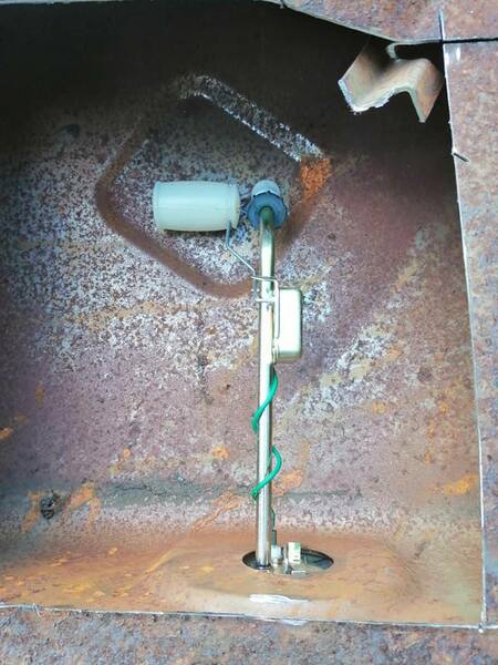

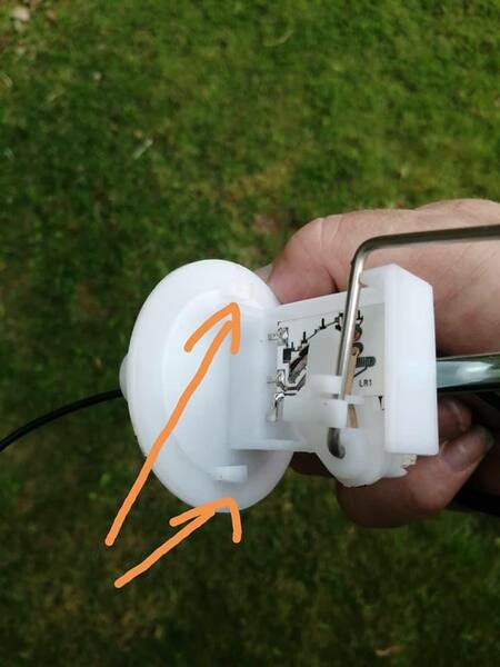

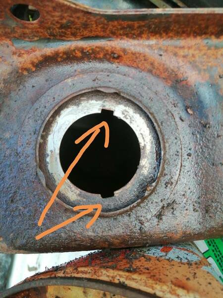

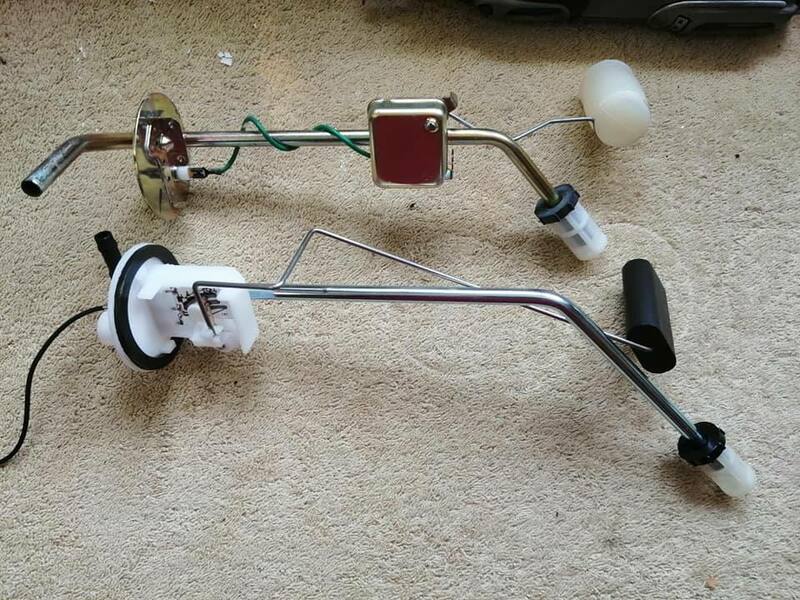

Six-cylinder Posted October 11, 2020 Author Posted October 11, 2020 5 minutes ago, Andyrew said: I had a look around and im surprised the sender isnt shared with anything else like the maxi etc. There is a Allegro club member who says the easiest/cheapest to alter is the MGB one. a Maxi is a bit different again.

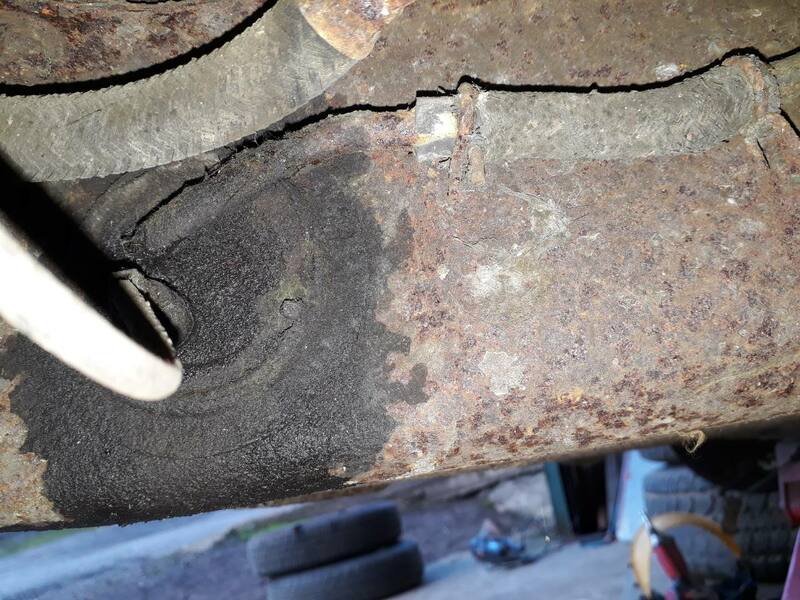

Andyrew Posted October 11, 2020 Posted October 11, 2020 9 minutes ago, Six-cylinder said: There is a Allegro club member who says the easiest/cheapest to alter is the MGB one. a Maxi is a bit different again. Did they mention what modification they require? Theres a definately leak around the sender. Its fairly damp but not dripping so id assume the seal has failed. I was going to drop the tank fpr welding but with the sender pipework looking a tad frilly i thought id open a whole new can of worms if i did. Ill have the car spun around and its arse in the air later on today ill try and nab a couple of pics.
Six-cylinder Posted October 11, 2020 Author Posted October 11, 2020 19 minutes ago, Andyrew said: Did they mention what modification they require? Theres a definately leak around the sender. Its fairly damp but not dripping so id assume the seal has failed. I was going to drop the tank fpr welding but with the sender pipework looking a tad frilly i thought id open a whole new can of worms if i did. Ill have the car spun around and its arse in the air later on today ill try and nab a couple of pics. "Some of you already know other versions can be modified to fit our cars, the most popular seems to be the MGB variety. They are plentiful, fairly cheap and they've recently developed an updated version which is said to be more reliable, although it is plastic. Some might prefer the metal version. This is how I did it... First remove the filter on the pick up arm and cut about 7cm (approx 2.75") off the end of the pipe and refit the filter. That's it. Well, ok, the float arm needs to be bent up slightly so the float is slightly above the pipe at it's lowest position and you need to make an earth connection. But yes, pretty easy. It fits in the same way as the original with the lugs lining up with the cutouts in the tank, to keep it upright. It is a bit fiddly to get into the tank but keep fiddling and it will go in. I found rotating it clockwise slightly (to about 1 o clock) and tipping the pipe up so that the float arm drops was the easiest way to do it." The MGB part number seems to be ADU3218. There is different detail some metal, some plastic but they should all be basically the same. Here's some pics...
SiC Posted October 11, 2020 Posted October 11, 2020 You'll need a rubber bumper MGB sender by the looks of it. Chrome bumper cars have the fuel pickup built into the tank. Rubber bumper cars have the pickup built into the sender.
Six-cylinder Posted October 11, 2020 Author Posted October 11, 2020 3 minutes ago, SiC said: You'll need a rubber bumper MGB sender by the looks of it. Chrome bumper cars have the fuel pickup built into the tank. Rubber bumper cars have the pickup built into the sender. pick up built into the sender is what I need.
Andyrew Posted October 11, 2020 Posted October 11, 2020 2 hours ago, Six-cylinder said: pick up built into the sender is what I need. Better get some Chicken wire, fibreglass and newspaper aswell. richardmorris and Six-cylinder 2
LightBulbFun Posted October 11, 2020 Posted October 11, 2020 18 minutes ago, Andyrew said: is it just me or does that looks like a Horribly deformed Unicorn LOL stonedagain, richardmorris, Six-cylinder and 2 others 3 2
wuvvum Posted October 11, 2020 Posted October 11, 2020 I thought it was a mummified kitten at first glance. richardmorris 1
Six-cylinder Posted October 11, 2020 Author Posted October 11, 2020 It looked like a baby Unicorn to me! richardmorris 1
Andyrew Posted October 11, 2020 Posted October 11, 2020 Tried to video it but it didnt work but i think the leak is from around the pipe where it goes through the flange on the sender. Theres a wee wiggle of play in there.
Six-cylinder Posted October 11, 2020 Author Posted October 11, 2020 2 minutes ago, Andyrew said: Tried to video it but it didnt work but i think the leak is from around the pipe where it goes through the flange on the sender. Theres a wee wiggle of play in there. Should I get the MGB one? https://www.ebay.co.uk/itm/MG-MGB-MGB-GT-FUEL-TANK-SENDER-UNIT-LOCKING-RING-SEAL-SEPT-1976-ON-ADU3218/312959492963?hash=item48ddd6e363:g:mbcAAOSw55peKDwW
Andyrew Posted October 11, 2020 Posted October 11, 2020 If thats the one people mod then might aswell. One less thing to worry about. I will be dropping the tank out, not a fan of welding near them and on something with a obvious leak may not end well.

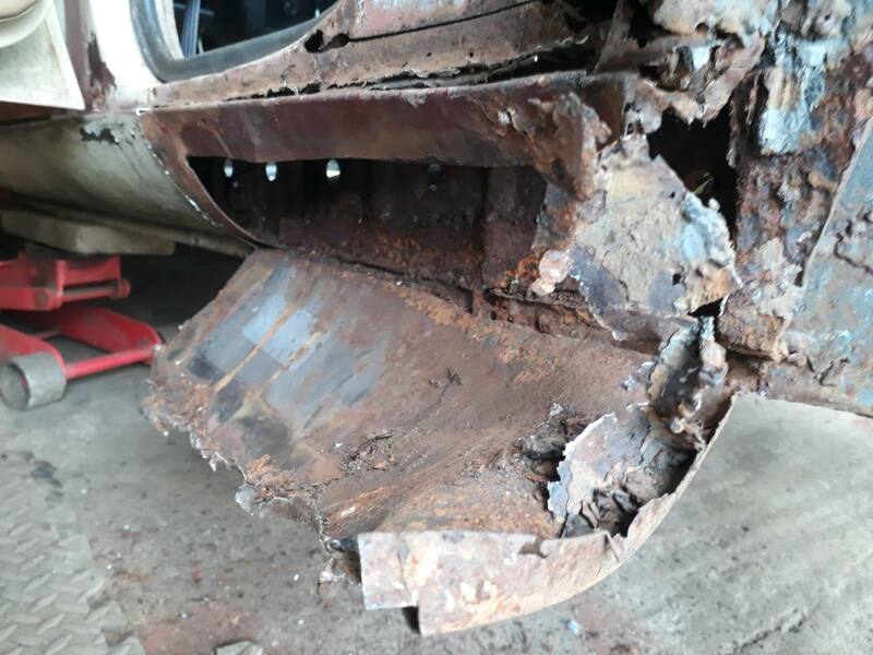

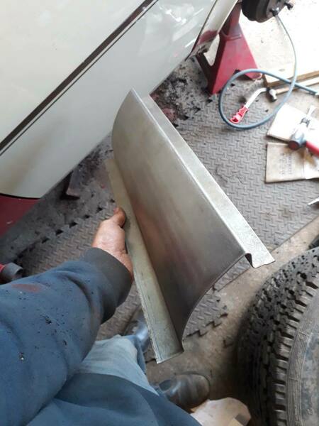

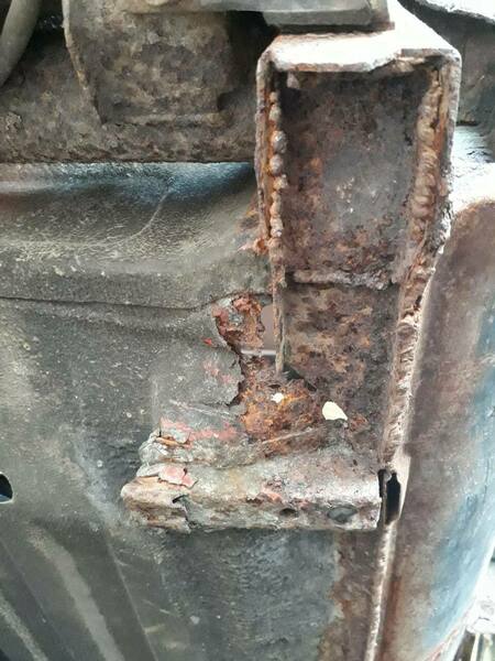

Andyrew Posted October 11, 2020 Posted October 11, 2020 With the cover sill panel off i had hoped to be able to clean it up and re use it but it was beyond help and gone wafer thin in places. The original sill is fairly about 1.3 mm iv only got 0.9 or 1.5 ish in stock. So thicker stuff it was. Curving this thickness is a bit tricky so i went for the gentle bends in stages approach. Came out good enough and will be covered up anyway. Dan_ZTT, Floatylight, Craig the Princess and 11 others 13 1

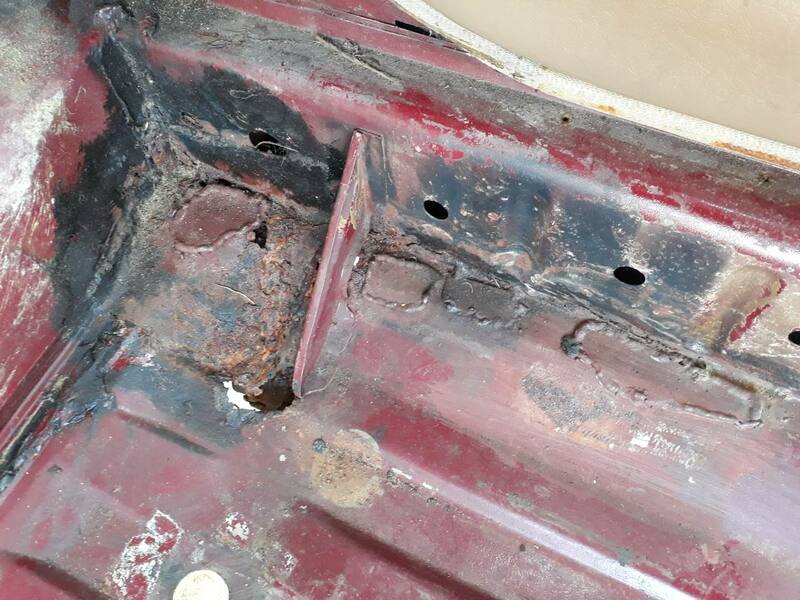

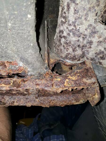

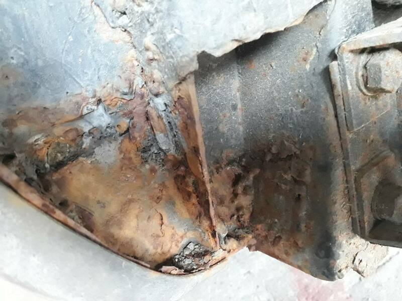

Andyrew Posted October 11, 2020 Posted October 11, 2020 With the VP fired up and spun round i got its bum up in the air on some axle stands. The main areas of grot are the rear floor pans and the O.S rear beam mount which was the concern of the garage and indeed its pretty shot but wasnt going to fail anytime soon. Some rather questionable welding has taken place over the years. But most of the patches have rotted away themselves or what they was welded over/ tacked to has dissolved. I decided ill start with the nearside which had Previously had sill panel welded over the top and some odd shaped wee patches elsewhere. Also the large blob of expanding foam. With the sill panel removed which was unfortunately unsalvagable , im left with the horrors that lurk beneath. The outer sill will be fixed first along with the axle mount. adw1977, Craig the Princess, Mrs6C and 7 others 8 1 1
SiC Posted October 11, 2020 Posted October 11, 2020 I reckon that won't look half as bad once it's been over with a wire wheel and then lightly with a flap disc. Wouldn't be surprised if that inner membrane patch will just pull off though!

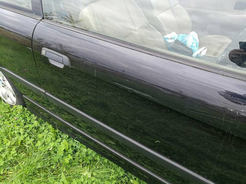

Six-cylinder Posted October 13, 2020 Author Posted October 13, 2020 8 hours ago, Zelandeth said: If my life ever calms down for five minutes, she need a clean, polish and wax any time? It seems it had been in contact with a green chair which has left light marks that have become more visible while it has been sitting. Also I am due to get the spoiler back tomorrow night and it would be nice to see that refitted. So yes, you are most welcome to take it, enjoy it and improve it.

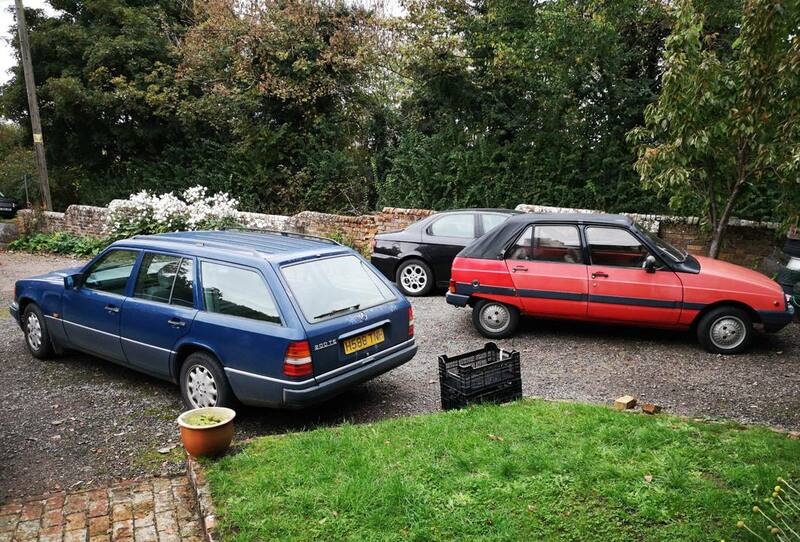

Six-cylinder Posted October 14, 2020 Author Posted October 14, 2020 We have had 4 Invacars visit the FoD but this is the first one at the house. Shite Ron, chaseracer, HarmonicCheeseburger and 7 others 10
LightBulbFun Posted October 14, 2020 Posted October 14, 2020 2 hours ago, Six-cylinder said: We have had 4 Invacars visit the FoD but this is the first one at the house. like the Autoshite version of weeping angels, every time you look away the closer and more numerous in number they get but on a more serious note, TPA looks well there, happy to see her in yet more different locations and I look forward to the day when Dolly is made road worthy and can be parked in the same spot Mrs6C and crad 2
Shite Ron Posted October 14, 2020 Posted October 14, 2020 42 minutes ago, Six-cylinder said: We have had 4 Invacars visit the FoD but this is the first one at the house. It is lowering the tone in your 20th century executive parking area 😀 egg, crad and Six-cylinder 3
Six-cylinder Posted October 14, 2020 Author Posted October 14, 2020 The rest of the 1970's from the drive has gone into storage today. Gamma and DS along with 1988 AX. I got out our other Alfa 156 to use but I don't like the feel of the brakes and they have long travel so it will need looking at.

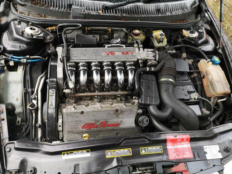

Six-cylinder Posted October 16, 2020 Author Posted October 16, 2020 Start with cars then move onto work! Opening the bonnet on the black Alfa 156 is such a pretty sight. I put it on charge this morning as it needed a jump and has only driven 6 miles since. I then checked the brake fluid as the brakes are horrid and sure enough the fluid was very low. I guess this means it is leaking somewhere and will need diagnosing and repair. Next job was to bring another car back from the FoD because they are parked on grass, but the Trevi would not start even with a jump. The Visa Cabriolet started on its own battery and is now on the drive at home waiting for more under cover storage to become available. I guess I better start work now.......... timolloyd, richardmorris and Shite Ron 3
