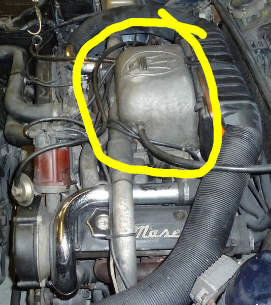

richardmorris Posted August 16, 2019 Posted August 16, 2019 21 hours ago, Six-cylinder said: There was a bit more tonight because Mr_Bollox talked about putting his Bi-turbo into storage reminded me ours needs to come out before anything goes wrong. Too late the fuel pump works so the puddle on the floor could grow! Looks like a simple fix as it is a piece of rubber fuel hose at fault. I think you’ve had your money’s worth out of that pipe. Sudsprint 1
Six-cylinder Posted August 16, 2019 Author Posted August 16, 2019 26 minutes ago, richardmorris said: I think you’ve had your money’s worth out of that. I think it is a warranty item if only I could find the supplier. When we bought the Maser 6 years ago we were warned that the rubber fuel line inside the the pressurised air box that contains the carburettor were subject to failure and you would not know until it was too late! Yes I had them replaced, but not the underside ones. The old pipe is close to the end and I have its replacement on my desk ready to fit. egg, Dick Cheeseburger, Mrs6C and 1 other 4

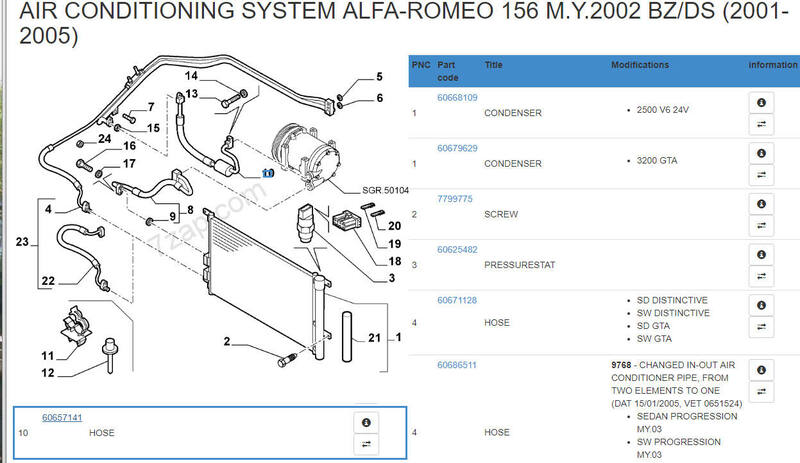

Six-cylinder Posted August 19, 2019 Author Posted August 19, 2019 I am trying to get the aircon fixed in my 2001 156 V6 manual saloon. I am told I need pipe 60657141 Compressor to condenser and beyond. They are dealer listed as unobtainable, any ideas or anybody have a used one they could sell me?
DSdriver Posted August 19, 2019 Posted August 19, 2019 I can't see it on the drawing. If it is just a flexible or rigid hose with standard connections a good hydraulic specialist should be able to make you up a new one or fit a new flexy onto your connectors. I know someone who is good at that sort of thing but he is in Ramsgate area so probably too far for you. I'll be back in England in a couple of days, if you need his details message me and I will find his address.
LightBulbFun Posted August 19, 2019 Posted August 19, 2019 http://dgs-autoteile.de/Baugruppen/Kuehlung-Heizung-Klima-Lueftung/Klimaleitung-ALFA-ROMEO-156-SPORTWAGON-932-2-5-V6-24V::200891.html is this what your looking for? sadly I cant read german so I cant tell if its just an old listing for an out of stock part, or if its something they have in stock
Six-cylinder Posted August 19, 2019 Author Posted August 19, 2019 I have found this place in Kettering who claim they can make any pipe. http://www.bee-cool-aircon.co.uk/services/ac-pipe-repairs/ Floatylight 1
Asimo Posted August 19, 2019 Posted August 19, 2019 The hose number 10 on the drawing looks like it has a something as part of the assembly. A restrictor or one way valve or something. Probably. If it is just the hose and not the widget, try the ever helpful Pirtek, they may be able to crimp on a new flexi bit.
richardmorris Posted August 19, 2019 Posted August 19, 2019 My air con guy John is coming tomorrow to refit the new compressor to the merc. If I see him ( he’s doing it at home when I’m in work) I shall ask him, he specialises in old systems. Six-cylinder 1
Six-cylinder Posted August 20, 2019 Author Posted August 20, 2019 Decision made, my Alfa specialist has found a new pipe so I discussed Bee-cool claim that they could make any A/C pipe at a large saving, recently another customer had one made and it cost more than the dealer part. I have now given the go ahead to buy and fit the new pipe and I should only be a week away from getting the car back. mat_the_cat 1

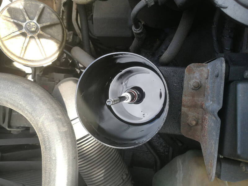

Six-cylinder Posted August 21, 2019 Author Posted August 21, 2019 A bit of further investigation by unbolting the PAS reservoir strainer shows the fluid in there is red and I thought Pentosin CHF 7.1 was green?
Tadhg Tiogar Posted August 21, 2019 Posted August 21, 2019 1 minute ago, Six-cylinder said: A bit of further investigation by unbolting the PAS reservoir strainer shows the fluid in there is red.... Aha! That might actually be not much different from Dexron III. Try this instead - this was the same stuff I put in my 635CSi all those years ago.

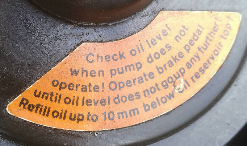

Crispian_J_Hotson Posted August 21, 2019 Posted August 21, 2019 All that label is telling you to do is pump the brakes with the engine off and the fluid will rise, when it stops rising top up to 10mm below the rim of the canister. Probably knew that anyway. Lots of exclamation marks tho... I've had all that gubbins apart back to the bare bones before.... bad thing to do as it physically doesn't fit back together, even with the strength of 10 bears!
Six-cylinder Posted August 21, 2019 Author Posted August 21, 2019 I am now confused as to what is in there, I can't remember putting any fluid in there but I guess somebody has in the 11 1/2 years we have had it. This is the fluid I have at home Total ATX, Carlube ATF-Q and Carlube Dexron II are red. What is the difference between Dexron II and Dexron III? I have read you can't drain the system so unless anybody has any bright ideas I guess it will be Total ATX as I have most of that?
Tadhg Tiogar Posted August 21, 2019 Posted August 21, 2019 17 minutes ago, Six-cylinder said: .....What is the difference between Dexron II and Dexron III? Dexron III is an updated version of Dexron II. I think it is supposed to be longer lasting and more universal in its use.
Asimo Posted August 22, 2019 Posted August 22, 2019 Should be green* hydraulic fluid. I have a tin of Audi green fluid which rather oddly says it is "not for use by the public" in Switzerland. Also says "not for automatic transmissions" I guess there has been a bit of history of muddling these fluids under the bonnet. **I wonder if it is just LHM? Neither VAG nor BMW would ever admit to using any thing French.......
Six-cylinder Posted August 22, 2019 Author Posted August 22, 2019 I had ordered some Pentosin CHF 7.1 and it arrived today and is in deed green. As what was in there is red I did not want to top up the reservoir with it so have used red Total ATX. I don't know what is in there or who put it in there and I don't remember paying anybody to work on the fluid part of the steering in the 11+ years we have had it. The battery is now charged and it starts without the jump pack although I have left it on over night because it has a 88 Ah capacity, also it got a wash today as it was very dusty. BorniteIdentity 1
