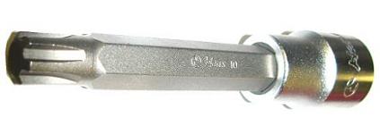

Splined bit sockets , what for ??
Found a set of these special bit sockets ... 10-12mm is the biggest . They're not torx or 3 square , the end is circular , i've not seen them before ? .. 1/2" drive , what manfacture uses them ? The guy had a Citroen...
That one looks to be a Ribe socket, found on Fiat/Alfa cylinder heads.
There is also a range called Torx+ which is slightly different again, they are found on the oil pickups of the PSA/Ford Explodium turbo diesels.
Well thats your answer then.
Citroen use bloody loads of hex fixings. T5 seems to be the most popular for internal trim and oor winders
I bought a set of hex bits and sockets for the meriva as vauxhall seem to love them! Zx uses loads of them too, so they get good use!
Having had to bum a big 3 square from a mate for my VW T4 balljoint job , i was excited when i found them ,nice having your own tools to hand , but on closer inspection they're no good to me... unless my Seicento has them holding the head on !
VW driveshaft? I've got a set and that's the only reason I can think I bought them. Maybe Polo cylinder head.
Smart Fortwo seat subframes.
Coupled with an 18v Snap-On impact gun, Halfords Professional bits can turn through almost 360°, before they inevitably sheer!
VW Polo driveshafts use an m8 splined bit, I had a nightmare trying to jam allen keys and torx bits in there before I found out what I needed.
