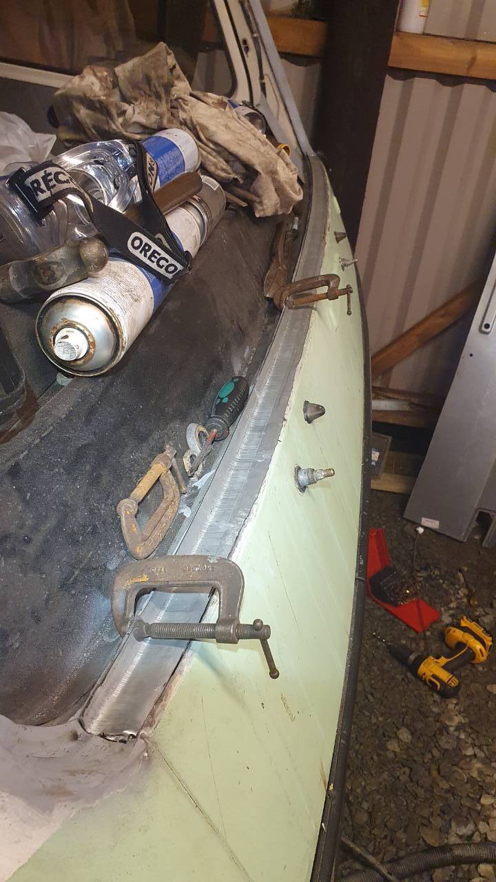

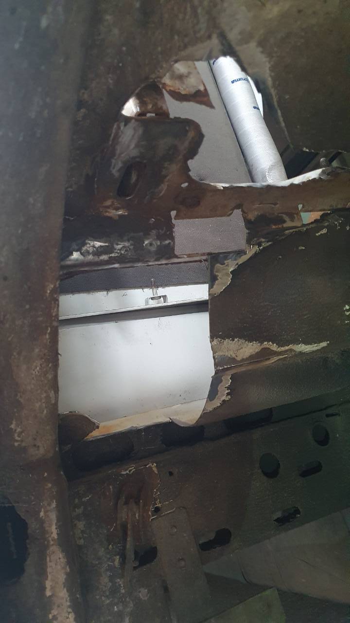

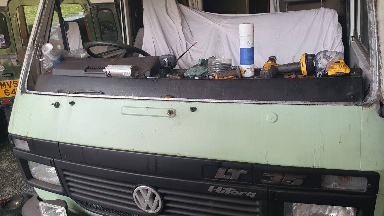

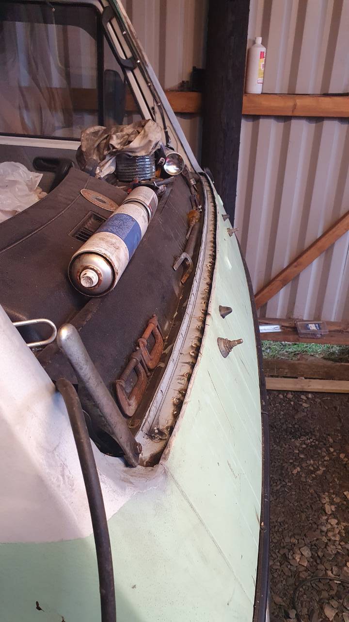

Before doing any welding whatsoever, I made an extra long lance from 3 originals joined together.
This is so I could arrange it in the correct position for optimum coverage, before putting the panel in position.
I used mini G clamps to hold the 3 layers together.
And here you can see how the holes in the outer panel are lined up with those in the middle layer, which I'd previously only tacked into position and ground back.
This meant I could create a decent plug weld, and tie all 3 layers together.
Once I'd done all the plug welds and tacked the front edge, I ground them all back ready for seam welding in stages.
I was trying to minimise the gap to make life easier for myself when it came to welding 1mm steel. I found that on a current sufficient to get good penetration on the first pulse, by the time I'd laid down 3 or 4 more pulses, the localised heat build up meant I was in danger of blowing through, so I just moved on to another location. And repeat...

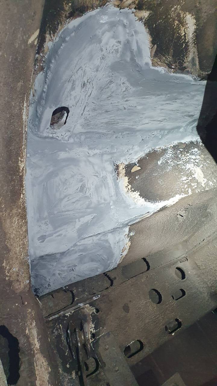

Finally, it was a case of taking the flap disc to it, followed by the power sander to flatten out any imperfections. This should still be under the seal, so I dont think I need to use filler.
Then a coat of etch primer to protect while I treat the surface rust which is around the rest of the frame.
Lastly I used my new lance to spray cavity wax on the rear of the weld, which did reveal two pinholes...easily dealt with though. Time for bed now!

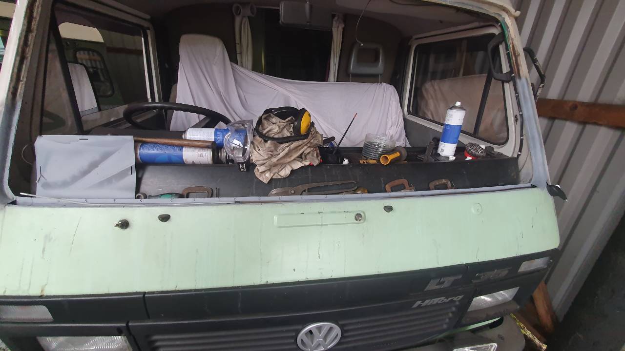

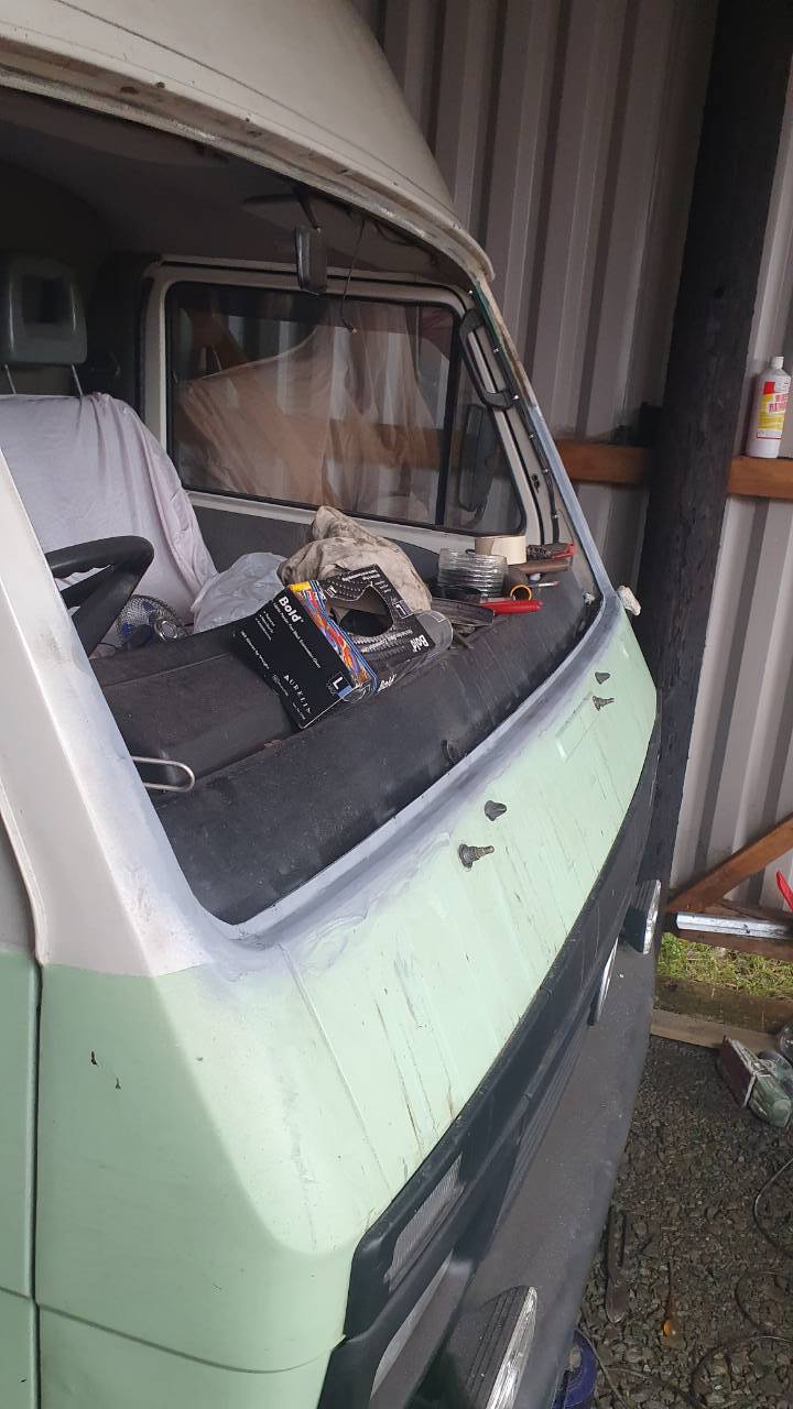

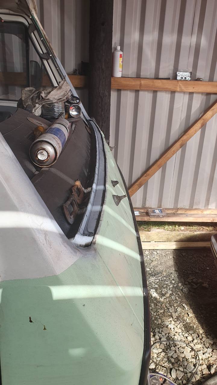

Minor update - both A pillars and (quite a few) rust spots on the upper lip have been cleaned up, phosphate treated and ready for masking and etch primer.
I'm hoping for some decent weather so I can bake the paint before the screen is fitted, but not massively optimistic. Thinking at least a week to harden.

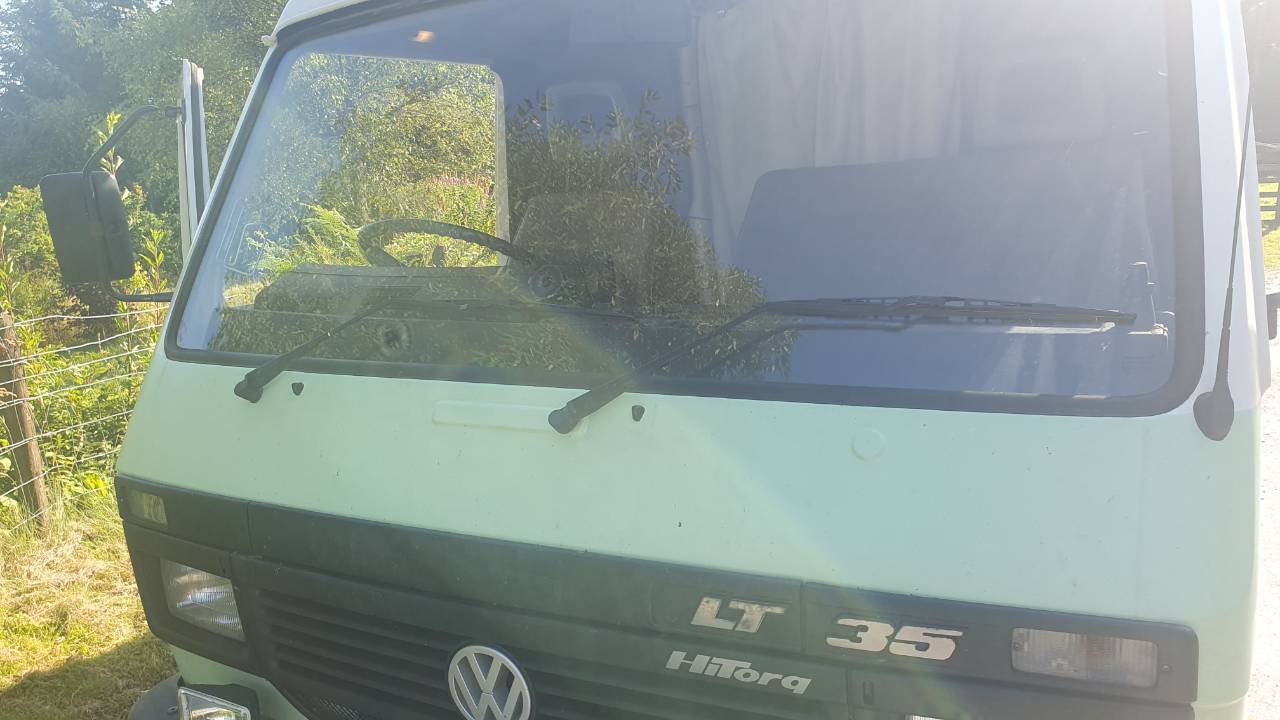

When I initially booked the windscreen replacement I was asked whether it mattered about having a tinted strip at the top. I said it didn't matter, I would take whatever is available and the last 4 have all been non-tinted. When the fitter came out to replace he told me that he didn't think tinted were still available.
So when I phoned them back last Monday I was surprised to be told they had cancelled my appointment because a tinted windscreen wasn't available! They could still get hold of a clear one, but needed to check with me beforehand whether it was OK!! FFS - why they couldn't establish that fact more than 24 hours before my appointment, and ask me before they had to cancel?
Anyway, it was rebooked and subsequently fitted. I don't know what it is about LT screens - the first fitter who came out back in 2007 gave up and left me with no windscreen, and the one who removed the screen this time round refused to go back and refit :lol: Obviously it must be a bit of a tricky job to refit, but all looks good now.

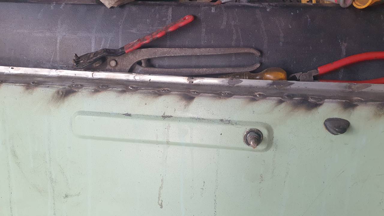

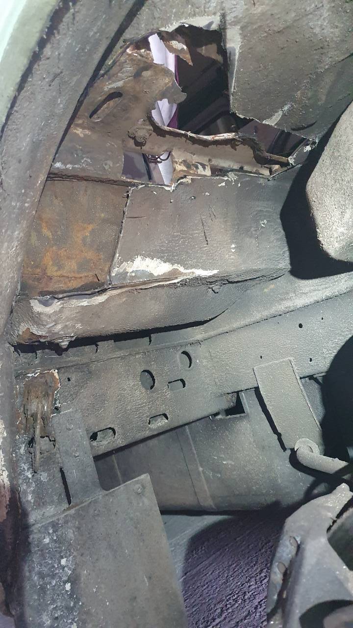

On Wednesday I realised that the MOT was almost due, so booked it in for Friday. And what better time to prod around the suspicious lifted underseal in the driver's wheel arch? Ah.
On RHD versions of these, the handbrake lever sits between the driver's seat and the door, and consequently in the line of spray from the wheel. It seems like water has found a way in, and been retained against the metal by the foam surrounding the air filter housing.

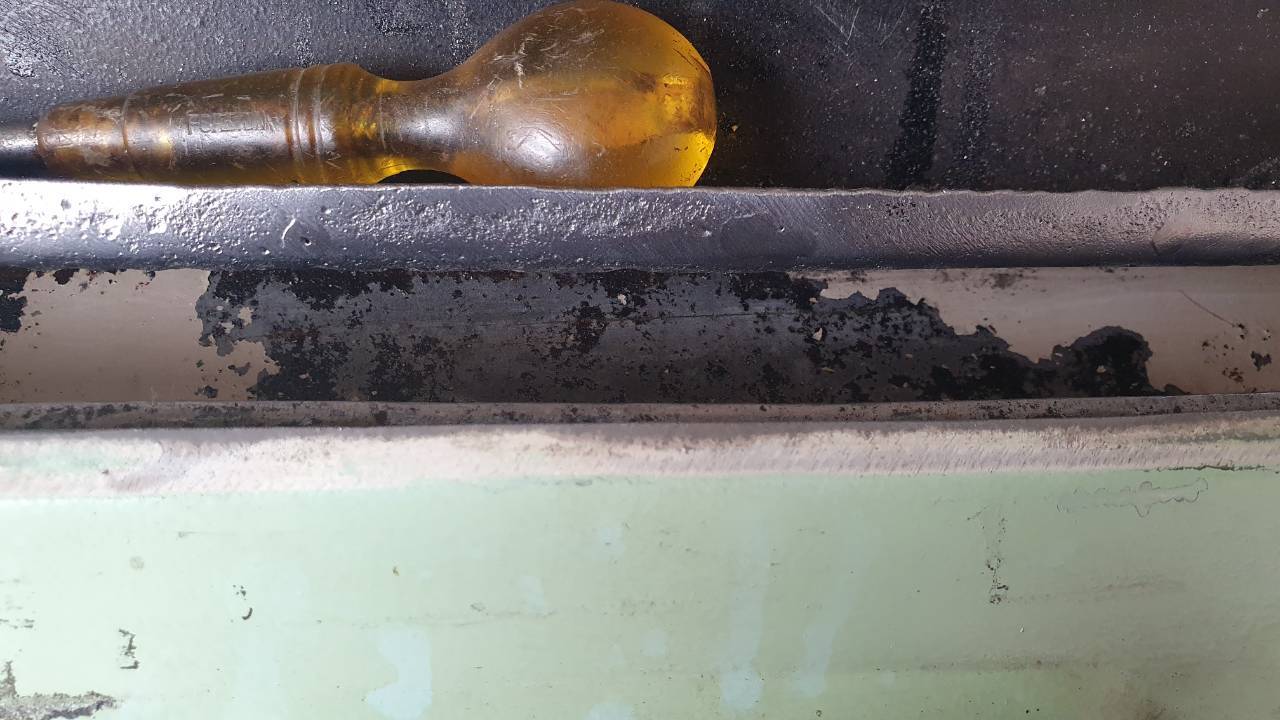

I deliberately left a small patch until last where the handbrake rod came through, so I could make a slotted hole before positioning it correctly, and trimming to size afterwards.
Coated with the last of my Zinga...
...and just a standard primer on the inside.
Covered in Bilt Hamber UB on the outside.

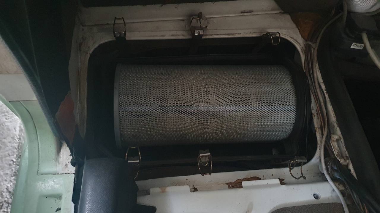

Then quickly plonk the air filter back in just in time for the MOT.

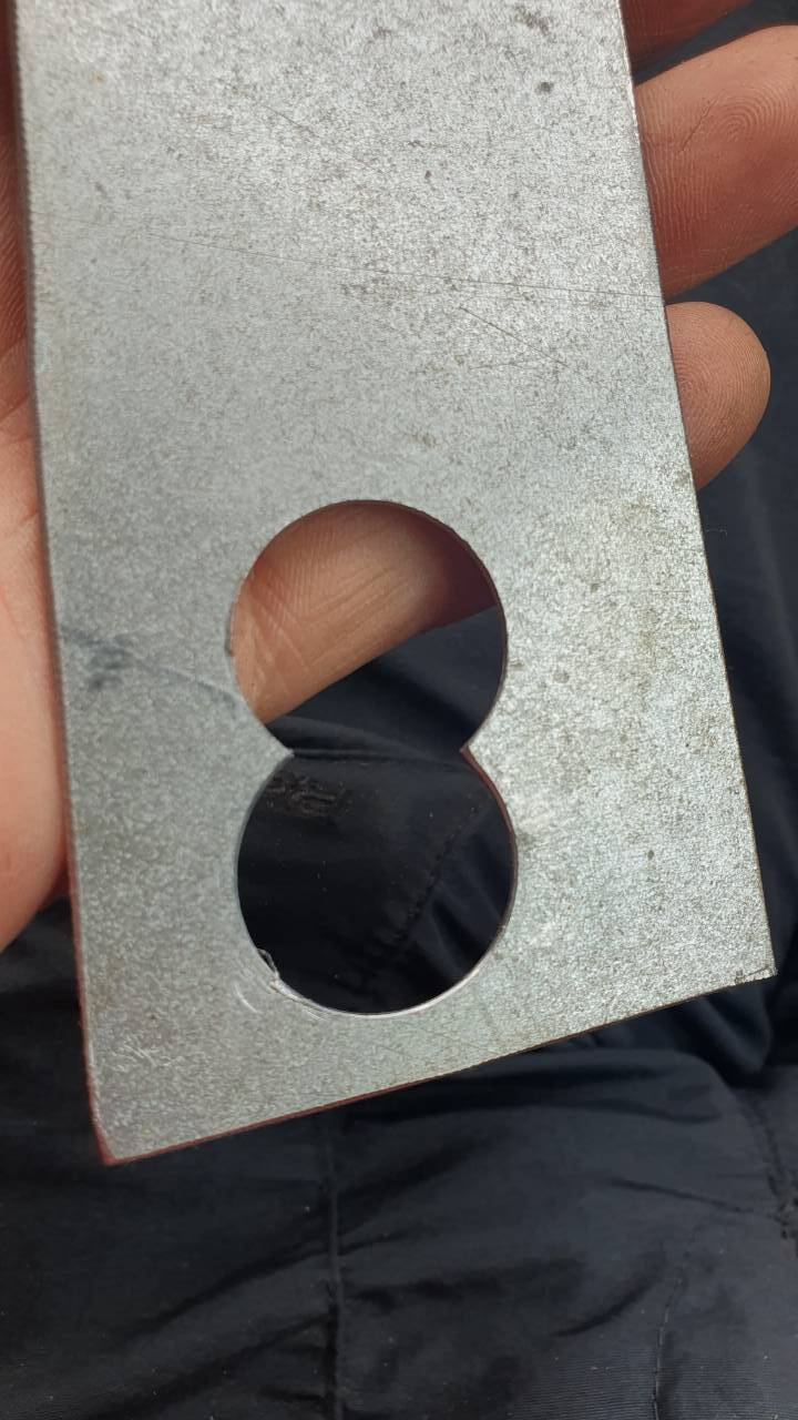

This developed a serious problem at the weekend, as the gear lever was able to rotate whilst changing gear. First thought was to replace it with something modern and reliable, but once I had got over that brief moment of insanity I set about investigating what was wrong.
I first thought the shaft must be unscrewing from the shift mechanism, but no. The lever pivots at its lower end, and the housing has a slotted hole in which a pin fits, in order to limit the up and down motion for the reverse gear gate. This had dropped out (and was fortunately found) and consequently nothing stopping the lever from rotating.

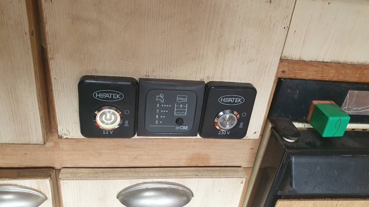

No pictures, sorry, but for the first time the van now has cold AND hot running water, after I installed a small water heater. It tucks away quite neatly in the otherwise unused space under the fridge, half of which is already taken up by the diesel heater. I may fit an access panel on the outside for ease of cleaning the diesel heater, and draining the water heater. I also took the opportunity to tidy up some wiring and plumbing whilst I was in there.
There was a bit of a deadline to the work as we are currently sailing to Ireland. After a misunderstanding of the ferry time we spent the last 40 minutes of the journey with my foot mashed to the floor (at a dizzying 65mph into a headwind, give or take 5mph due to gradients :lol: ). Grateful nothing broke, fell off or overheated and we arrived with 4 minutes to spare! Hopefully the trip is less stressful from now on...

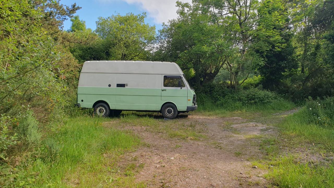

Found a tucked away spot in a forest last night.

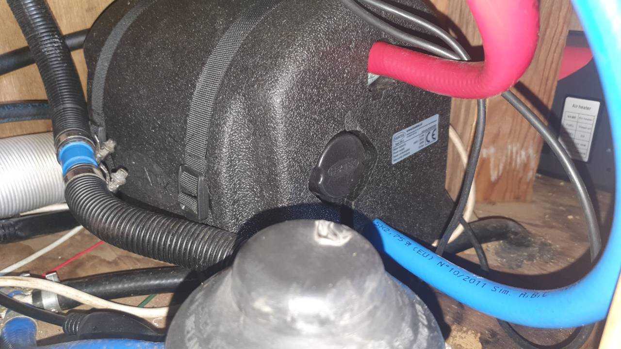

Water heater is working well and saves boiling the kettle to wash up. Just fits below the fridge, which was effectively wasted space anyway.

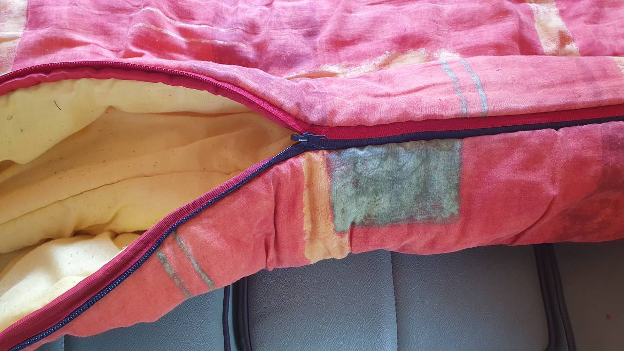

The other last minute thing before we set off was the sleeping bags. We've had them for over 20 years now, so we'll used. One of the zips had been chewed by a naughty dog a while back, and she'd made a couple of holes in the outer. I found someone local who could repair, and she's done a really neat job replacing the damaged part of the zip, which needed to match the zip on the other bag so we could zip them together.
I told her that a functional repair was all I wanted, and not to worry about trying to match the colours, and actually quite like what she's done with the patches.
Seeing as they originally had a patchwork pattern anyway! Probably would have been cheaper to replace with new, but have tried a couple of different bags and they've all ended up feeling clammy overnight.

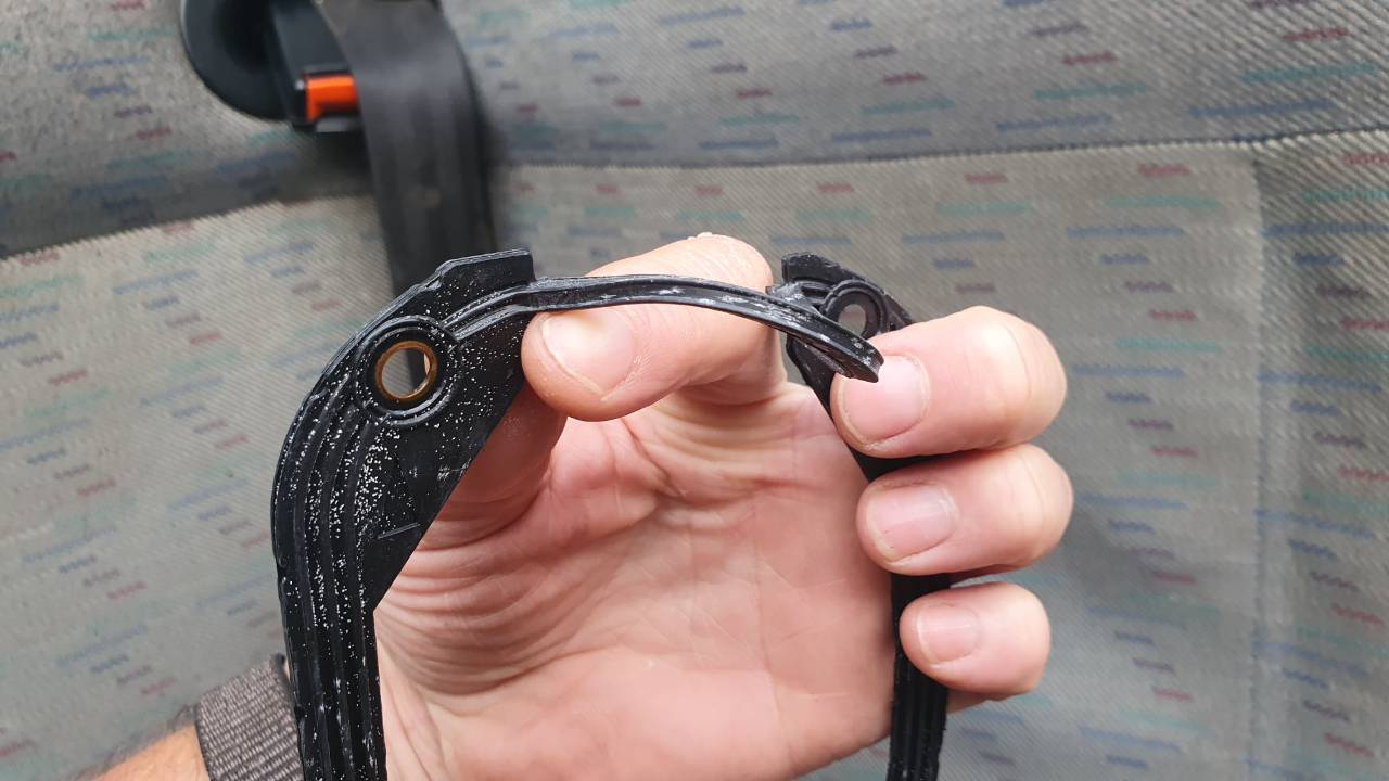

But we did have one mechanical problem - the gearknob split fairly early on. I think it's probably when I stressed it upon removal and refitting.
It's almost totally polished smooth at the top, and the embossing was almost worn away. Easily fixed with superglue, but didn't take a photo.

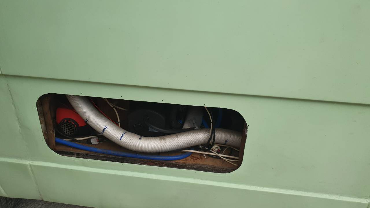

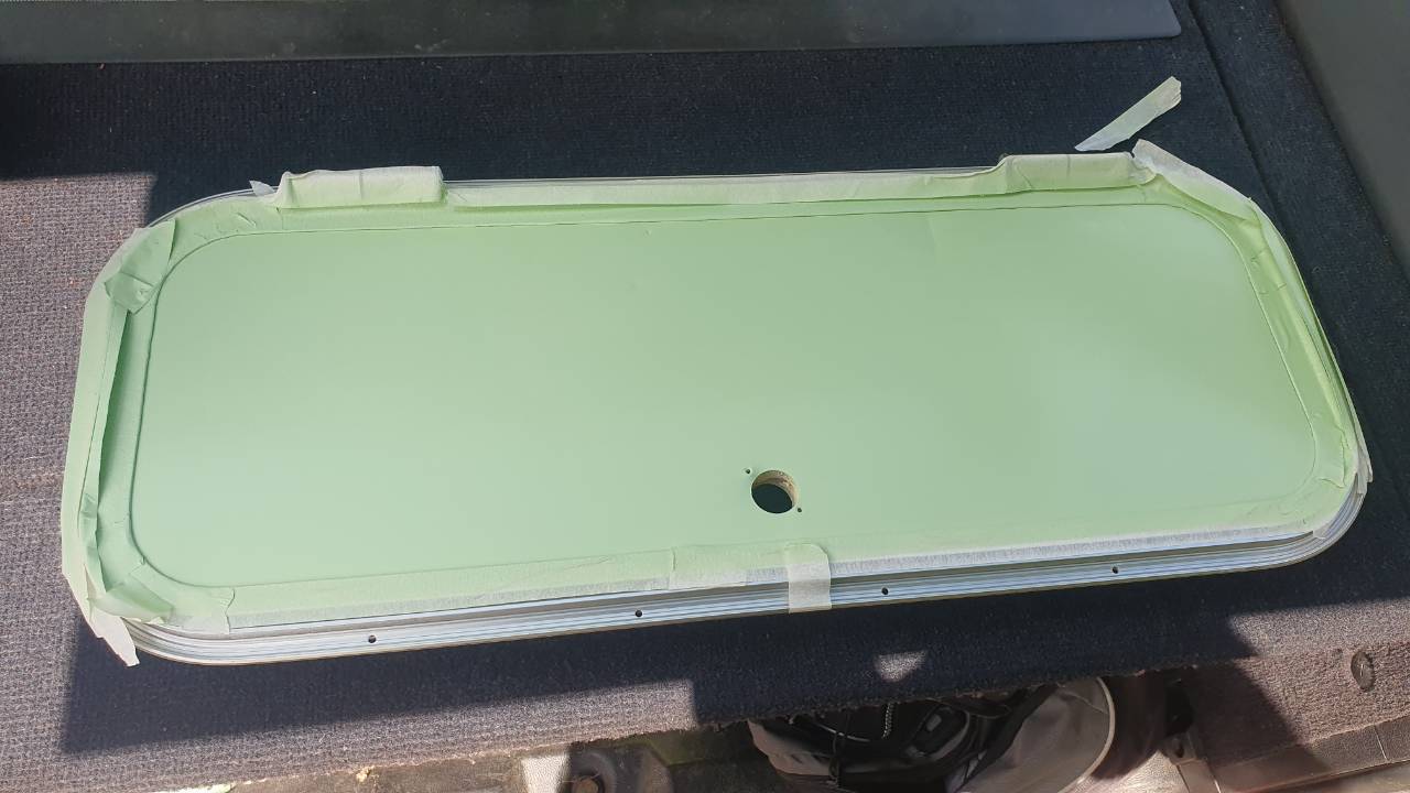

Back home now, and the next improvement. Currently to service the fridge I have to remove it totally, so TBH it doesn't get serviced every year like it ought. So I bought an access panel, cheap due to minor damage...
Here I've masked it up so I can spray it green. And painted!
Not yet marked out where to cut, so a little nervous!

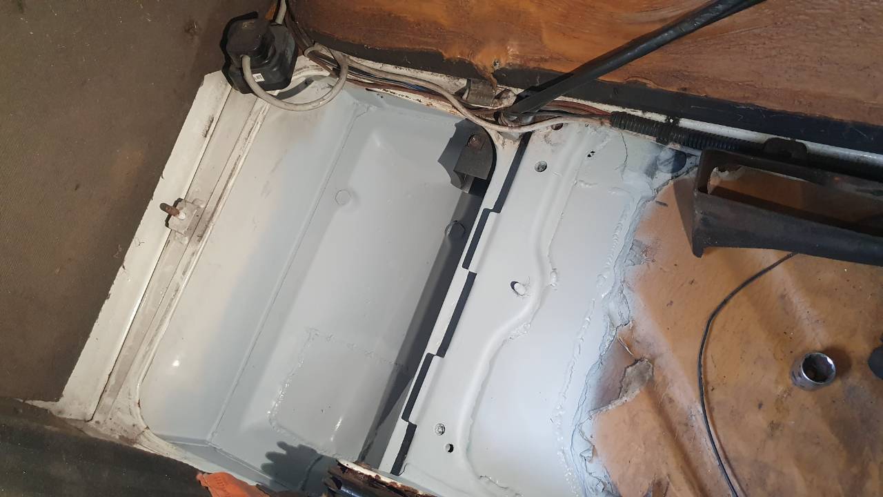

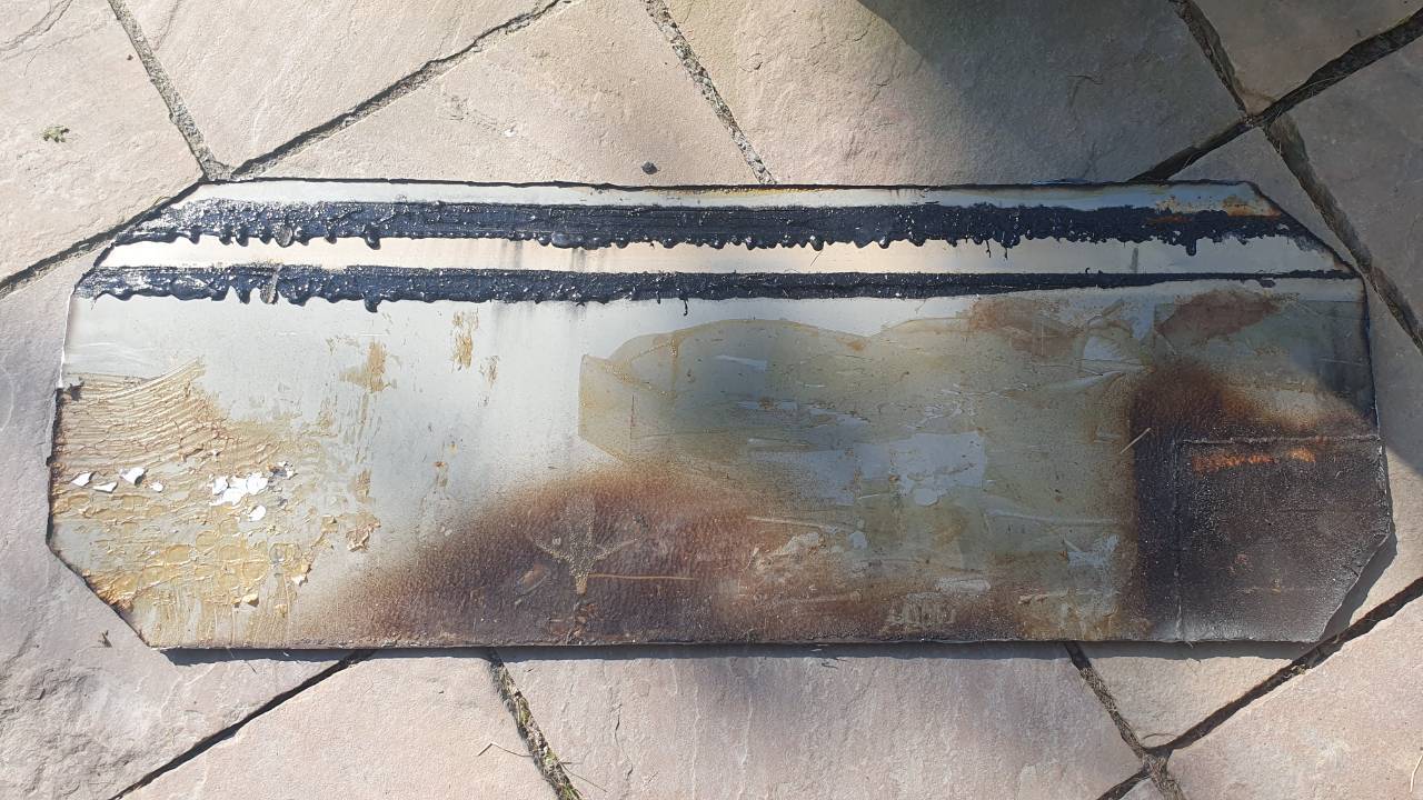

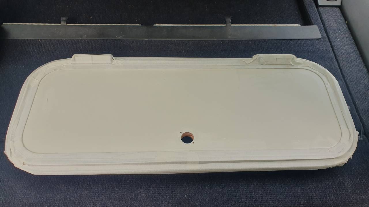

Whilst I'm capable of welding in new metal if I needed to, I always have the fear when cutting out a panel. Happily though, got the shape near enough.
As a bonus, the size and location meant I could cut out two dents, and a previous repair patch which had distorted slightly! The pipework and wiring could do with tidying now access is easier though.
The frame was bedded onto butyl mastic, and riveted into place. Annoyingly I had to drill out the rivets holding the hinges on, as access to the pre-drilled fixing holes behind was restricted.
The hinges were then re-riveted on, and just the trim strip to press into position afterwards.

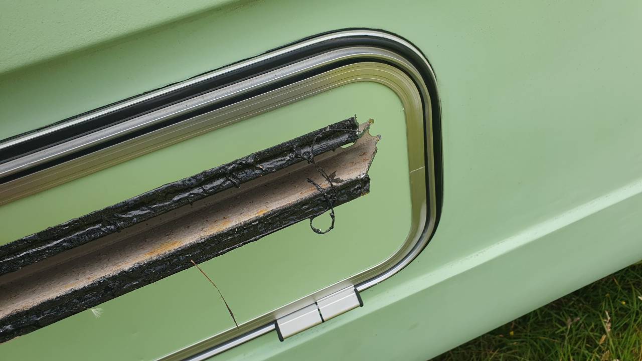

One slight issue with mounting the access hatch was that I had to remove a stiffening box section.
You can see where it was bonded to the rear of the panel here.

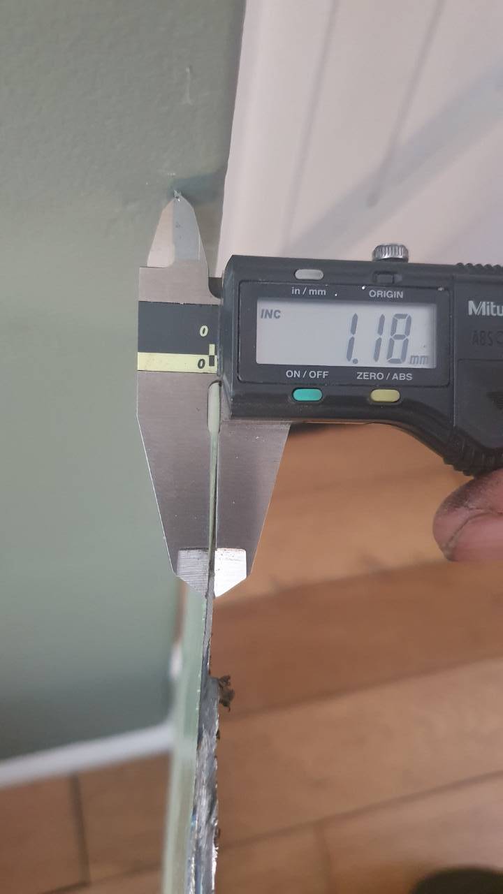

TBH, I think it was probably mainly only needed as something to strap items to, as it was perforated seemingly to be able to hook straps onto. But what I did was trim it to the edge of the hole, then rivet through the hatch frame into the remaining box section, so will make it all rigid again.
Although, I measured the thickness of the piece I'd cut out and it may be stiff enough anyway.
No wonder I haven't had too much trouble butt welding in new metal, and there I was thinking it was purely down to my welding skills :lol:

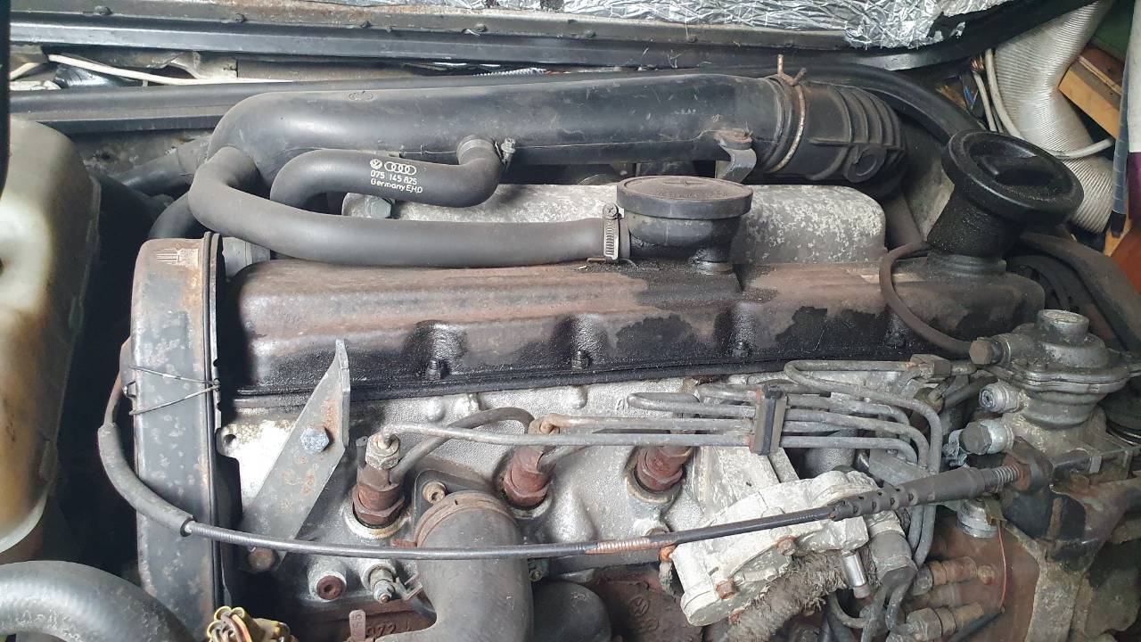

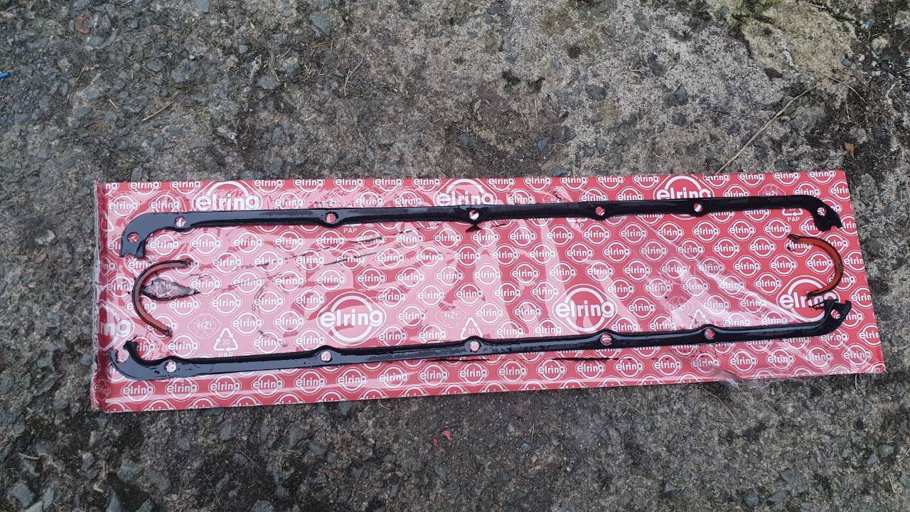

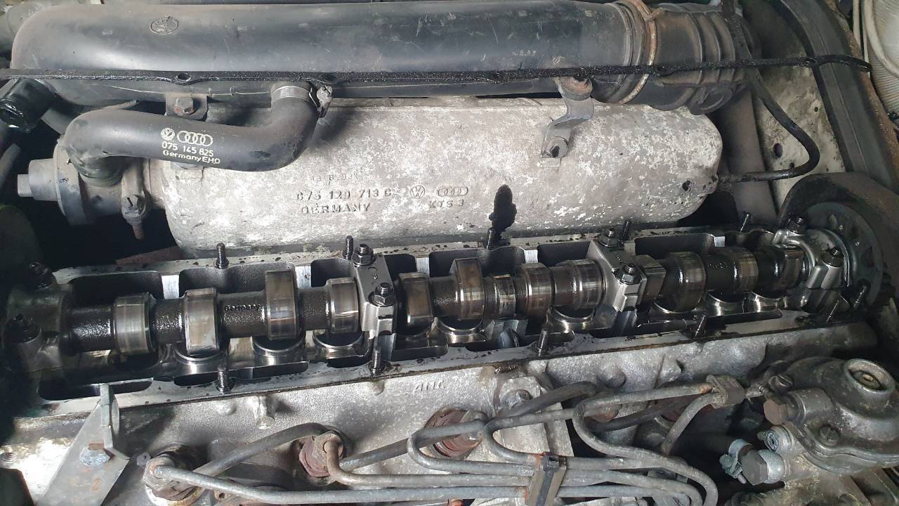

Something I've been meaning to do for a while is replace the cam cover gasket. It's been weeping for a while, and there is an improved design of gasket over the original 4 piece cork and rubber job.
Engine looks pretty clean with no sludge visible.
The new gasket is a continuous  section, with sleeves in it to prevent over-torquing....
...compared to the previous one:
Job done in about 15 minutes!

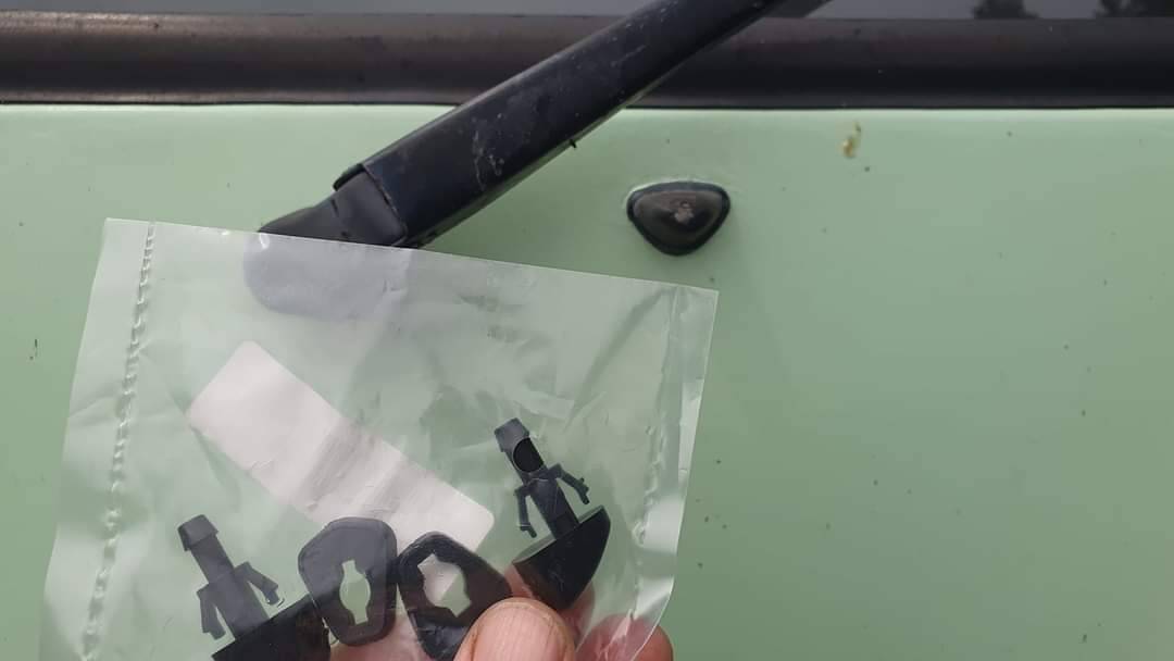

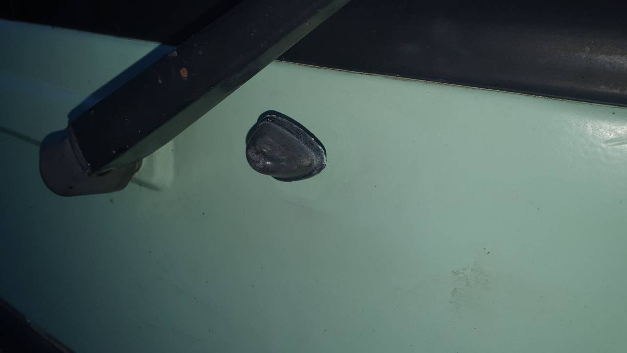

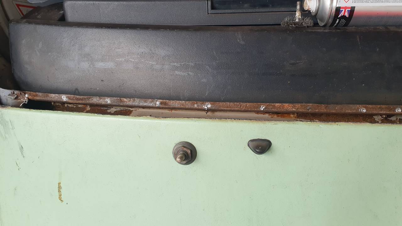

Onto the next, less important job of replacing the screenwash nozzles. The originals had a single jet which left large areas of the screen unwashed. To be replaced with triple jets to cover more of the glass.
Paint needed touching up underneath. The accepted wisdom is that it's impossible to remove them without breakage, but I managed OK. It helped that the weather is warm so they aren't too brittle.
Sanded, primed and painted:
Also injected BH S-50 into the rear of panel, before snapping them in place.
Just realised that I'd missed the 'money shot' with this job! There is about 1 degree difference between hitting the bottom of the screen or spurting over the roof, so adjustment took a while.
But eventually got there!
The downside is that it drains the already undersized reservoir more quickly - I actually used half a tank just doing the adjustments...
