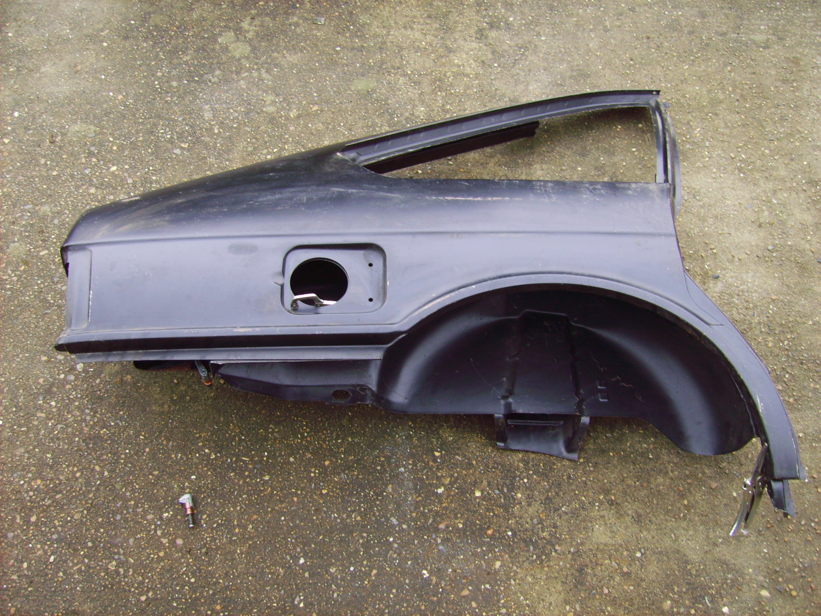

Simcat Posted March 14, 2015 Posted March 14, 2015 The Cinnamon car will donate this third hand, but solid quarter to the cause, or parts thereof, as it will be getting a nice NOS one in due course. SambaS, outlaw118, oldcars and 2 others 5
warren t claim Posted March 14, 2015 Posted March 14, 2015 Top bombing. Sadly, you stand a greater chance of finding a Sao Penza being driven by a happy Talk Talk broadband customer than any Nos Alpine repair panels. Dave_Q and Lacquer Peel 2
steve_earwig Posted March 14, 2015 Posted March 14, 2015 If they're anything like Avenger panels, the presses were broken up the moment production stopped. Are Grimes still turning up panels?
Simcat Posted March 15, 2015 Posted March 15, 2015 Secret stash in Czech Republic (of all places) In the communist era Chrysler 180s and then Chrysler/Talbot Alpines were allowed to be imported officially. Parts for both survive to this day out there, in the hands of an enthusiast who bought the lot. Grimes is long gone, but I saved about 3 tons of stuff when they were closing down. Some rescued from the skip! steve_earwig and 500tops 2

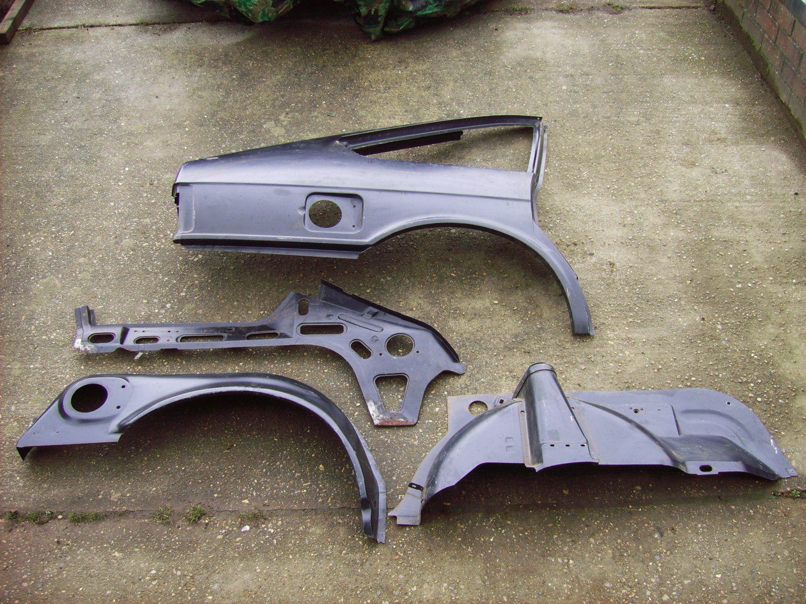

Simcat Posted March 15, 2015 Posted March 15, 2015 Here are the NOS genuine panels put aside for the cinnamon car, the two wheel house tub halves and the quarter came from Czech, the inner reinforcement from Switzerland! theorganist, Grundig, catsinthewelder and 12 others 15
Rusty Pelican Posted March 15, 2015 Posted March 15, 2015 Theres not a lot to beat the sight of NOS panels if your into old shite SambaS, Sudsprint and inconsistant 3
Simcat Posted March 15, 2015 Posted March 15, 2015 Then's there's that dilemma of actually fitting them to a car that may not survive in the longer term due to rust elsewhere, or other issues. Once parts like this are used up they are gone for ever... In this instance the cinnamon car is 100% rust free due to it's mere 2 years on the road, so no problem to commit them. It's very fortuitous that Edd stumbled across the car when he did, so providing the used sections to be used later on his LE. An all round win situation! holbeck, Talbotman, oldcars and 5 others 8
Simcat Posted March 15, 2015 Posted March 15, 2015 Got so excited I had to clamp them altogether to get a feel... steve_earwig, holbeck, laser wheels and 11 others 14
steve_earwig Posted March 15, 2015 Posted March 15, 2015 Two things, firstly I'm completely blown away by the fact that you can get panels like that for an Alipne, and secondly, I feel this board is severely limited by the fact that you can only like things just the once. tooSavvy, KruJoe, mat_the_cat and 2 others 5
Angrydicky Posted March 15, 2015 Posted March 15, 2015 There were plenty of those panels made, it's just a matter of finding those that survived the many years when the cars were absolutely worthless and dealers were skipping stuff en masse. Hence snapping up stuff all around the world! Unfortunately, there just isn't the interest or the money in the cars to warrant tooling up for new panels for them.
