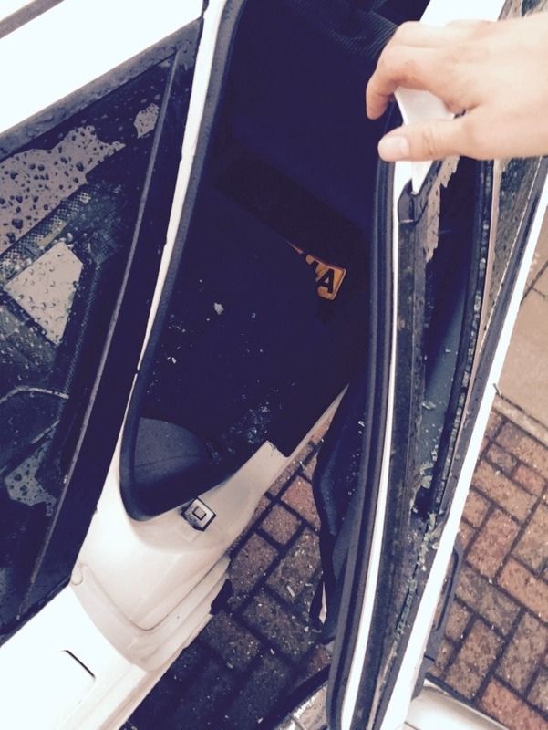

She's drives lovely and everything and I can see her staying for a period as a daily. However this evening, this happened
A2D460C9-FAA2-403F-B876-01EDDD927BFF_zps
I was moving cars around at home, I got everything sorted but just needed to move the wheelie bin. I did that and when I got back to the car, spastic French electronics had locked it... Running, with all my other keys in the car, including my 20 month old son.
Fortunately I had an Omega backbox in the garden that I hadn't yet disposed of and that did the deed, leaving me with this gap to crawl through to get to the drivers door and unlock everything (yes I'm stood on the bonnet of an E23!)
9C53B2C5-E1D8-4BD3-9245-83D4F4C8F60C_zps
So, it's role as daily is now defunct until I can get some new glass and I've put her up the garage as its pissing down.

Wouldn't it be better to smash a windy window, as generally much easier to replace and obtain intact from a scrappy on most cars? Plus bigger, more useful hole.
More glass on the son I would imagine.
I did think that, but with 2 kids sat in the back, either window will shower one of them with glass, and doing the front windows would render the car undriveable unless it's a nice day, windscreen would cost £75 and a massive blag to the insurance company and the boot window would be useless as too far away from any locks to pull.
Of course, my suggestion of just keeping the keys on her person as I've had it auto lock before if only the drivers door is open or summat got shouted down as 'never done that before' etc
Oh dear. BECAUSE FRENCH. The fault is probably one of the door switches I reckon. This has happened to be but fortunately, the central locking often does not lock the boot. So I was able to get in that way when it happened to me...
I must concede that it did test my faith a bit that incident (a year ago) so on long trips, I'd started to take both keys with me.
Has reminded me that the fuel flap lock doesn't work. Not a problem in rural Wales.
I think using quarter windows has been something historic on the basis that many cars never used to have bonded windows there.
I know when I locked the keys in the boot of my old MG ZS, I was able to remove the quarter light window with two screwdrivers to put my arm through, Pop the lock and open the door so I could open the boot with the release handle. Likewise when my Transit decided it would no longer like to unlock and the keys just turn in the barrel, removing the front quarter window meant I could put my arm through and open from the inside. Millions of thieves can't be wrong - they always seem to go for the quarter light 😆
Whilst replacing this glass could potentially be a sod with it being bonded, the quarter window was the smallest area I could use to minimise glass spread and also meant I was able to drive it to storage in the rain without the entire back of the car getting drenched.
I'm tempted to Perspex it up until I've got a replacement sorted as I'm like a kid at Christmas and want to get this onto the commute tomorrow. Must remember not to leave keys in the car until I've had a look at them electrics!
