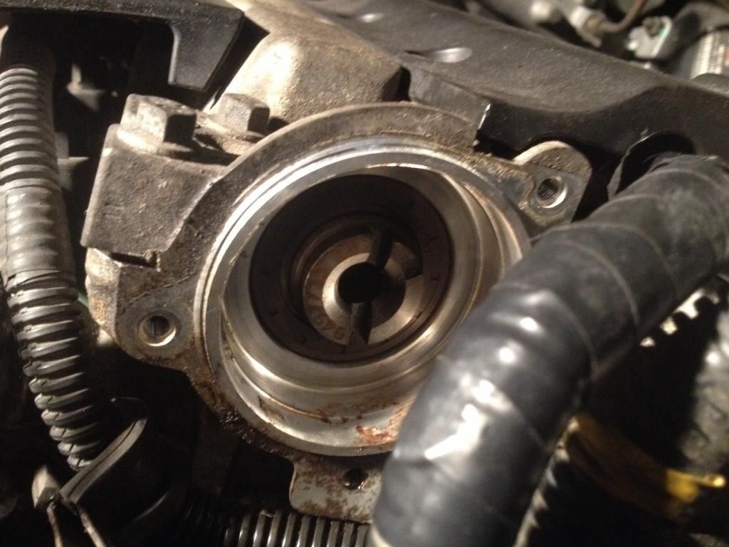

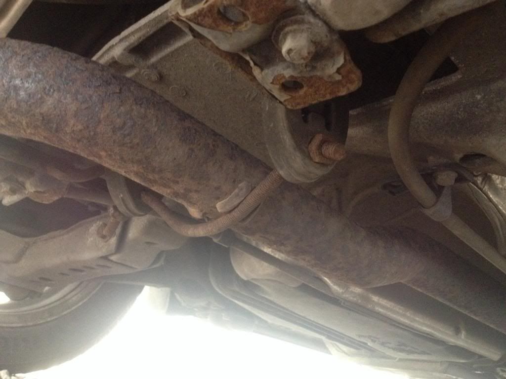

mat_the_cat Posted October 7, 2014 Posted October 7, 2014 I'd just splice in a new length of pipe, unless it's a pretty short length or the rest of it looks on the way out too. Chances are anything out of direct line of the wheel arch will be fine though. They_all_do_that_sir 1
DSdriver Posted October 7, 2014 Posted October 7, 2014 Check the breather pipes if the camshaft seal blew. I seem to recall being told that gunge blocked pipes can pressurise the engine. Carb cleaner for the win.Lovely car by the way. They_all_do_that_sir 1

They_all_do_that_sir Posted October 7, 2014 Author Posted October 7, 2014 Cheers guys it's amazing how much car you can buy for under a grand nowadays. In fact it's amazing how much car you can get for less than half that but there's another topic! I'll probably just splice the pipe in, limiting factor being the mega crap cheapo flare tool I have - it'll do a decent* flare in the shed on the vice, under the car might be more fun. Most of the breathing system requires removal of the inlet manifold to get at so I'll wait till post MOT for that (insert generic lazy reason here) Oh and Belfast was accidentally given to the scots after the referendum fell over. If you've ever been to Larne it's pretty much part of Scotland with a bit of water in the way anyway cms206 1

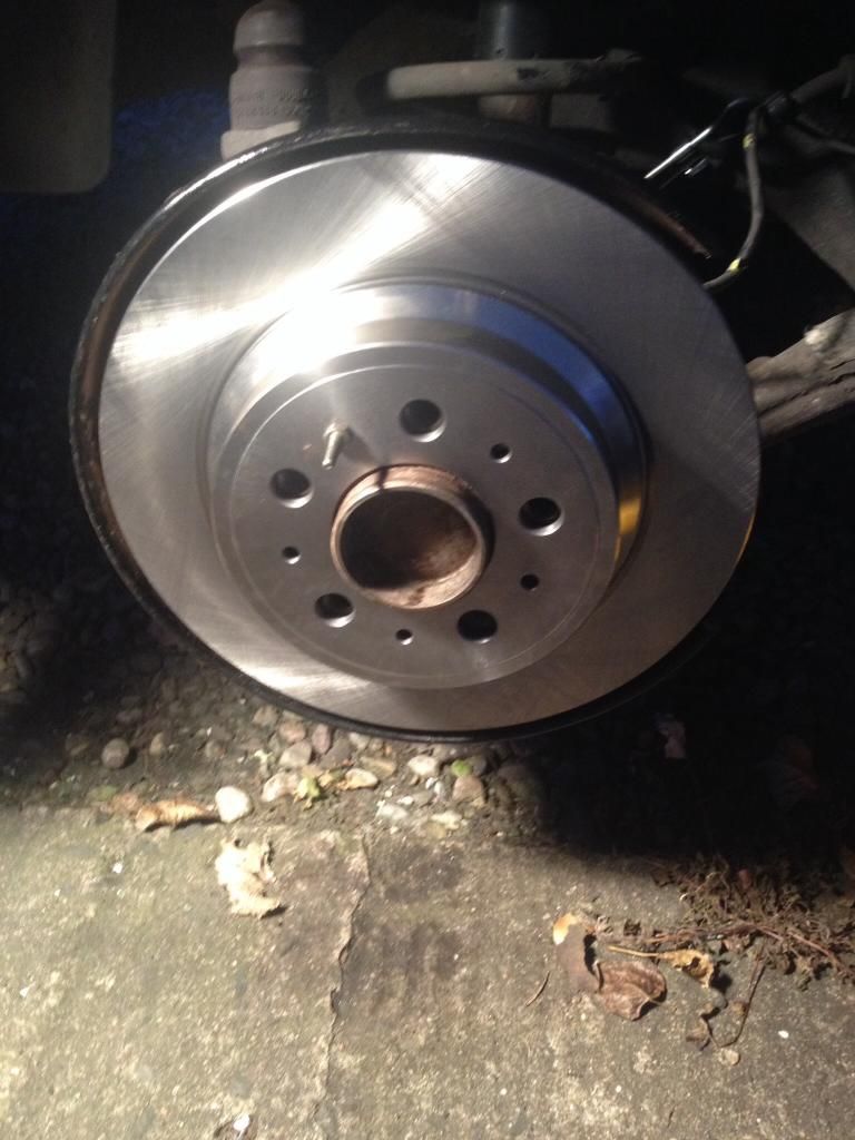

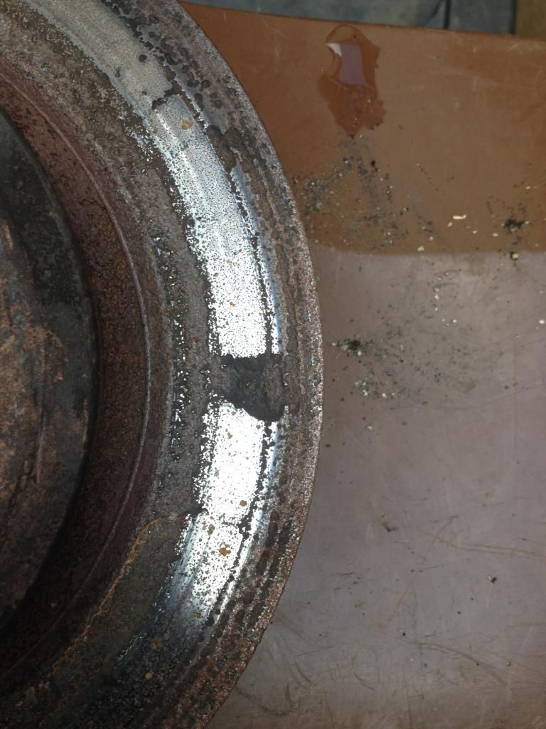

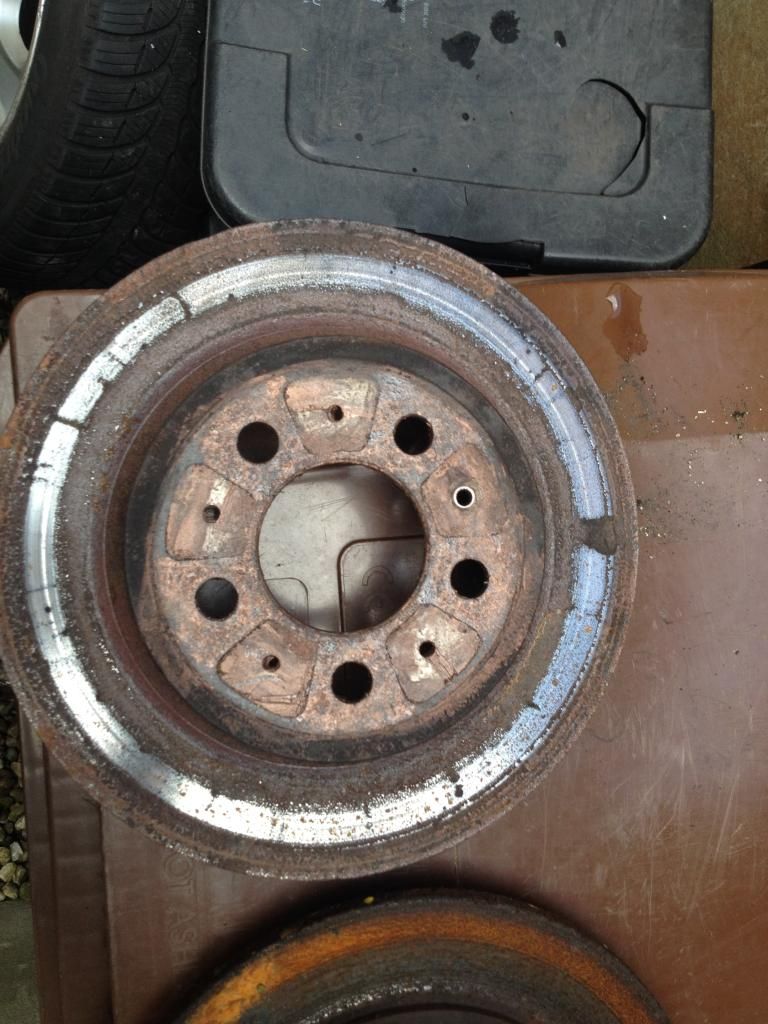

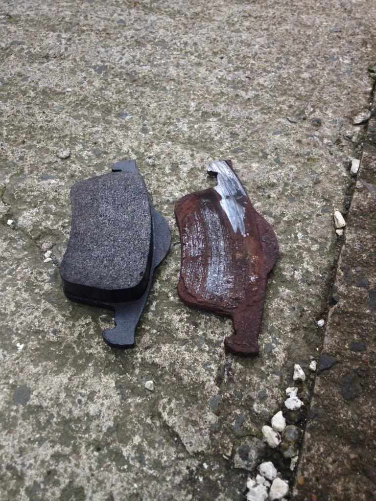

They_all_do_that_sir Posted October 11, 2014 Author Posted October 11, 2014 Time for a quick and dirty update. Firstly I found some pics of the ropey disc I took off the car: Annnnd here is the bit of brake pipe I mangled through ham-fistedness I cut a section off from behind the fuel tank, there's a nice straight run here so was easy to splice in to, I'll get a picture of the amazing* repair up soon. I even done that thing where you flare the pipe then notice you haven't slipped the union on first.....Good news for me was the standard pipes clearly aren't steel, they are easy to work with, easy to bend, cut and flare. Bad news is my flare tool is one of those mega cheap ones, the flares are ok and the joints aren't leaking under pressure but at some point id like to buy a decent flare tool and do them again. I'll get a picture of all this soon. I also found pics of the brake shoes I replaced when I done the discs: Think its fair to say this car hasn't had much love for a while. So I started bleeding the brakes, got all the air out of one rear caliper and just about to nip the bleed valve closed when bang! And the quality* pipe from the draper bleed kit split. This both sprayed brake fluid everywhere, but sucked a load of air back into the caliper. Yay! Started again with a new pipe and got one caliper done before calling it a day. I also emptied the old oil which looked like treacle before attempting to remove the filter cover. You can't get the access to use a normal strap wrench on it so I gave up and ordered the proper sized tool on ebay. 86mm 16 flat filter wrench if that sort of detail arouses you. This week then I'll do the following: Bleed the brakes properly (the one caliper I've done is the side I sorted the pipes for) Change the filter and add the new oil Once that's done its MOT time. It's booked for the 25th. Skizzer and Banger Kenny 2

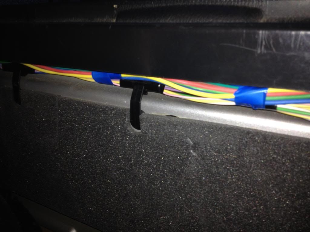

They_all_do_that_sir Posted October 25, 2014 Author Posted October 25, 2014 A small but OMGAMAZEBALLSYOLOROFL (great) Sooooooo I had last posted explaining how my full beam was on constantly. Turned out to be the switch at fault and I managed to fix this by stripping it, cleaning all the contacts with fine sand paper and contact cleaner before REASSEMBLY IS THE REVERSE OF DISSASSEMBLY. However during all this I temporarily became even more of a massive idiot than usual, which led to me unplugging the airbag wiring for the steering wheel with the battery attached. Bugger. This culminated in OHFORFUCKSSAKE as the airbag light was now on. Volvo themselves would have required vast piles of coinage just to diagnose this, and with MOT fast approaching it was with slight* panic I rang an acquaintance who happens to own a shite friendly garage - YES I CAN was his reply, and his payment terms were far more in keeping with my wallet: Thanks for fixing my car M8, now have some lung disease I think is the message there. So that was this morning, this is now and as of an hour ago I have had this: I'm well pleased, next to tax it and I think I'll try the Direct debit route this time, as a years tax on this is £230
