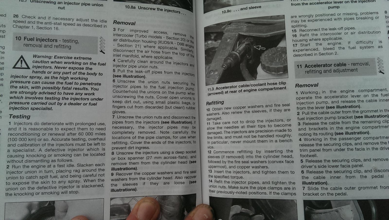

Found out that my accelerator cable is held together with 3, maybe 4 strands, so had a look in the Haynes manual for the job, and found this:
Cheers, I should be having a look at it sometime this week. I've decided to take the Carlton off the road and use this in it's place. The Carlton still doesn't have a heater blower so will be useless in the winter as trying to clear the screen will be difficult.
