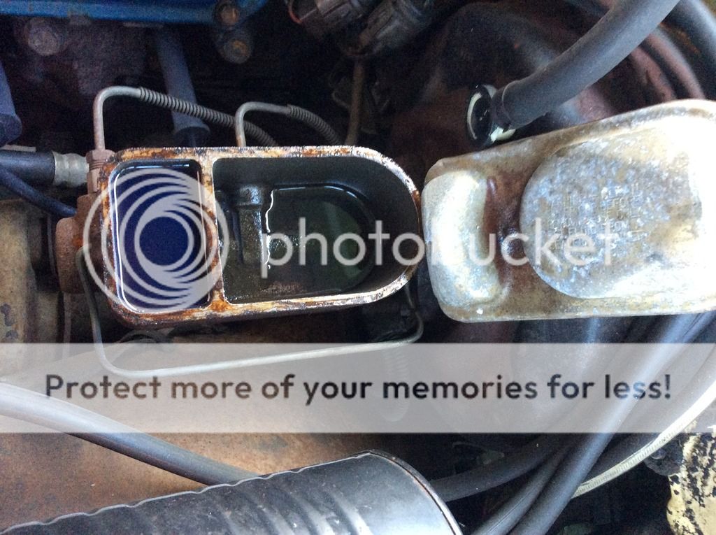

When checking it over I did notice a few small yellowish drips on the bottom of the steering linkage. On checking under the car there is a huge wet patch on the drive! Bollocks!
Hmm, the drips look a bit like brake fluid. Let's just take a look in the reservoir, Oh dear!
So much for my intention of giving it a quick oil and filter change then going for a blast up the road in it. Oh well, it's going to be another expensive month!
Definitely needs a new master cylinder, it's soaking wet with fluid underneath it and I think I'll get a few other bits at the same time.

Recommissioning can be a real pain. Seals n stuff that seem fine, often then wilt when asked to perform.
At least, once done , you'll know the brakes are hood for the season..

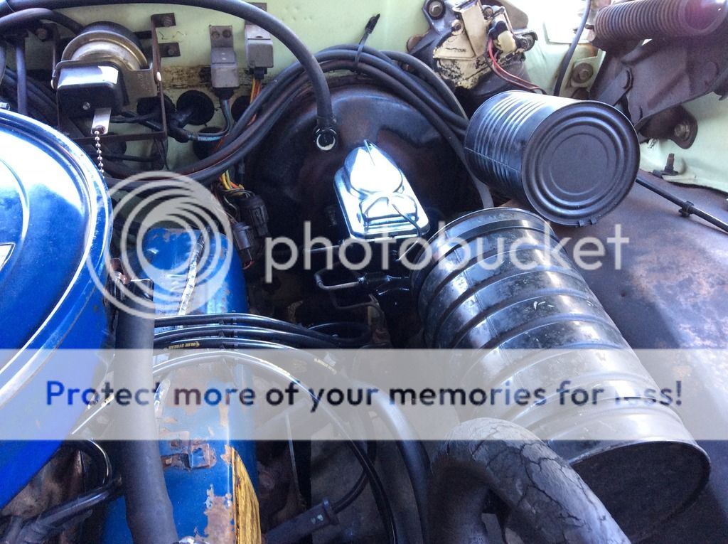

I've also got the master cylinder changed, old one was a twat to get off. The old unions were seized solid and took a fair bit of effort to undo without destroying the pipes. Managed in the end though. Reassembled with a blob of grease on the end of the push rod, mounting bolts to servo were cleaned up and greased too, so this should be an easy job should it ever need doing again!

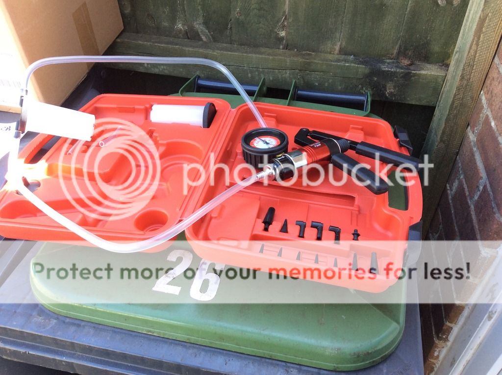

So today, I bled the brakes. I hate this job so bought this new tool. Does vac bleeding and also good for loads of other stuff too. No more needing an assistant to pump brakes and yelling instructions!
It works ok, though the bleed nipple adapters are a bit shit so I ended up just forcing the clear pipe straight onto the bleed nipples! Seemed to work ok though.
Peddle seems ok. Just needs a road test now. Hopefully tomorrow evening!
New master cylinder looks nice after I painted it satin black. Looks a lot nicer than bare steel and rust.

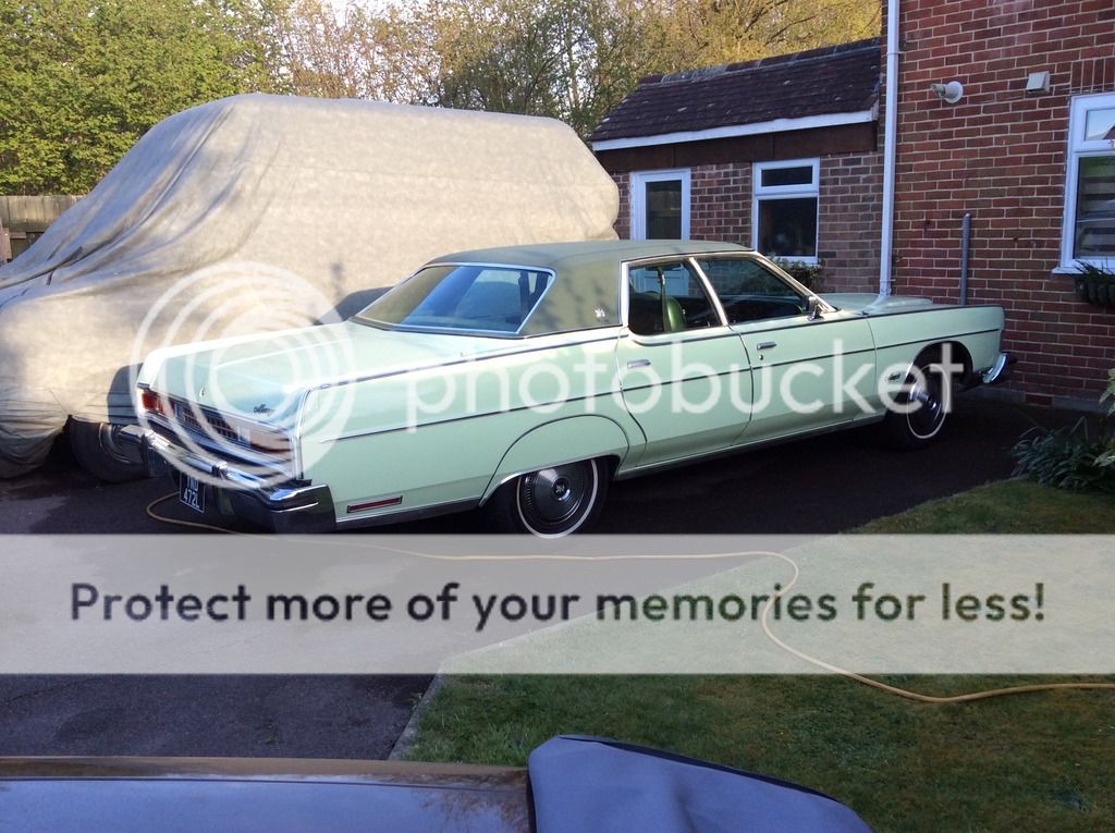

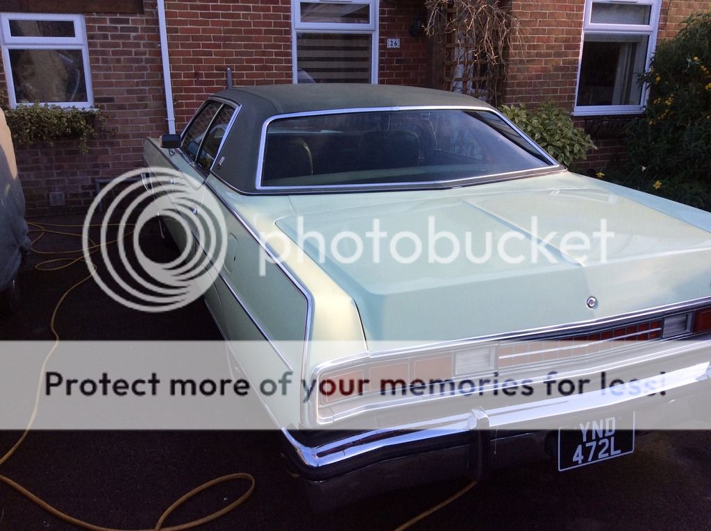

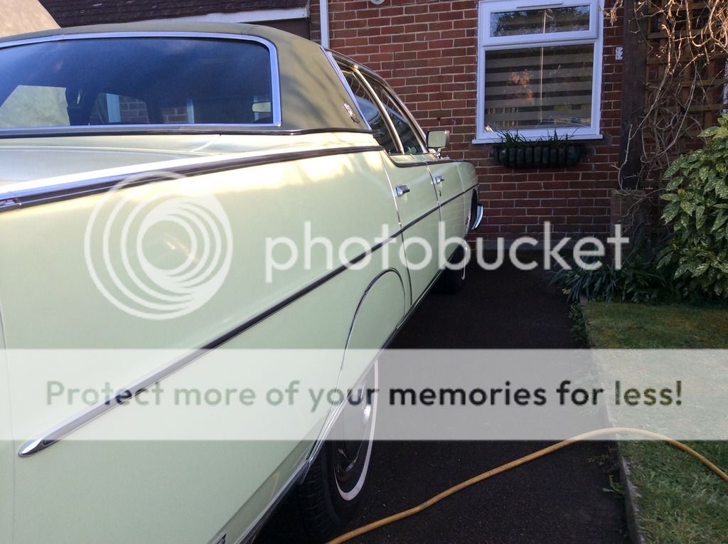

Nice day again today, so I gave the Mercury a much needed clean and polish.

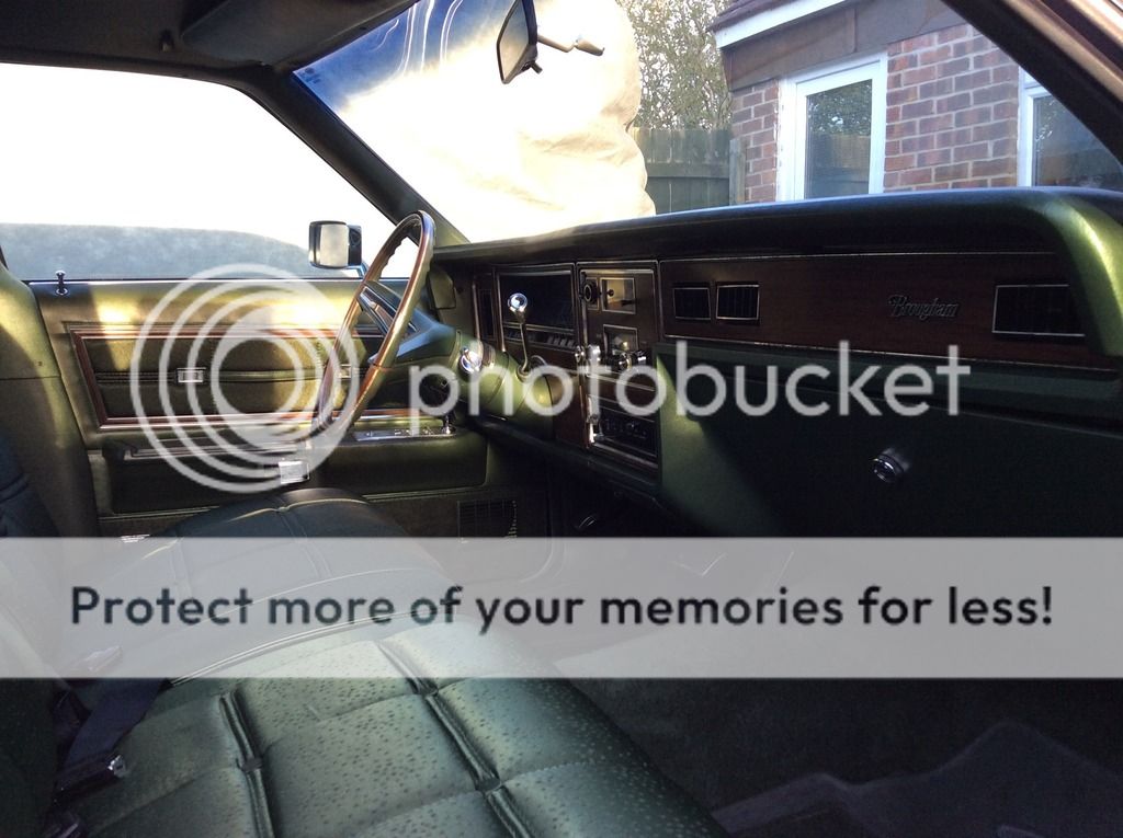

Hoovered and polished the interior which was very grubby from when it was shipped over. Then washed the body. It was still covered in grimey stains running down the sides though so something a bit tougher was required. Original T cut was used and buffed it right up, even managing a nice shine and reflection! This was followed by a good coat of wax. This was carnauba wax, whatever that is? I've heard it highly recommended though so gave it a go. It was hard work putting it on and buffing off again but it looks amazing now! And the paint should be well protected too.
I'm really happy with the way it looks now. I also found a full set of original Ford floor mats in the boot, so cleaned them up and refitted them.
Just need to give the chrome bumpers a good polish and I've got some vinyl cleaner and conditioner for the roof too. Just ran out of time today.

Epic polishing job! That original T Cut is good on proper paint but can be hard work.
I like T-cut, there appears to be millions of alternatives on the market these days and I always allow myself to be duped into them. And then end up slinging it and buying more T-cut.
Motor looks nice Dan,
Top work-I used to think an xj40 was a lot of cleaning-now i just shut up:)
Cheers for the comments!
I really rate T cut, it seems the best thing going for oxidised and dirty paint. Trouble with this car is the paint is original and very faded, it's thin now too so you have to be careful not to overdo it. All it needed was a light wipe and scrub, just to lift the grime away.
The carnauba wax is supposedly very good for protecting and buffing up paintwork and meant to be almost insoluble in water.
I really went to town with it too, rubbing it into all the edges and seams to get the best protection I can. It just needs the layers of it building up after a wash.
It's bloody hard work though! The wax looks like a tub of lard and spreads onto the car in a similar way. It's horrible stuff. It takes a lot of buffing to remove and shine up aswell. The car looks good afterwards though so it's worth the effort.

Huge*
Mercury Marquis: 5.8 * 2.0m
Ford Transit 14 seater: 5.8 * 2.0m
Huge*
The big covered thing parked next to it in the pics is my long wheel base mk2 Transit. Parked side by side the Mercury is significantly longer! It's bigger than my company van which is a LWB Sprinter, and about the same width.
