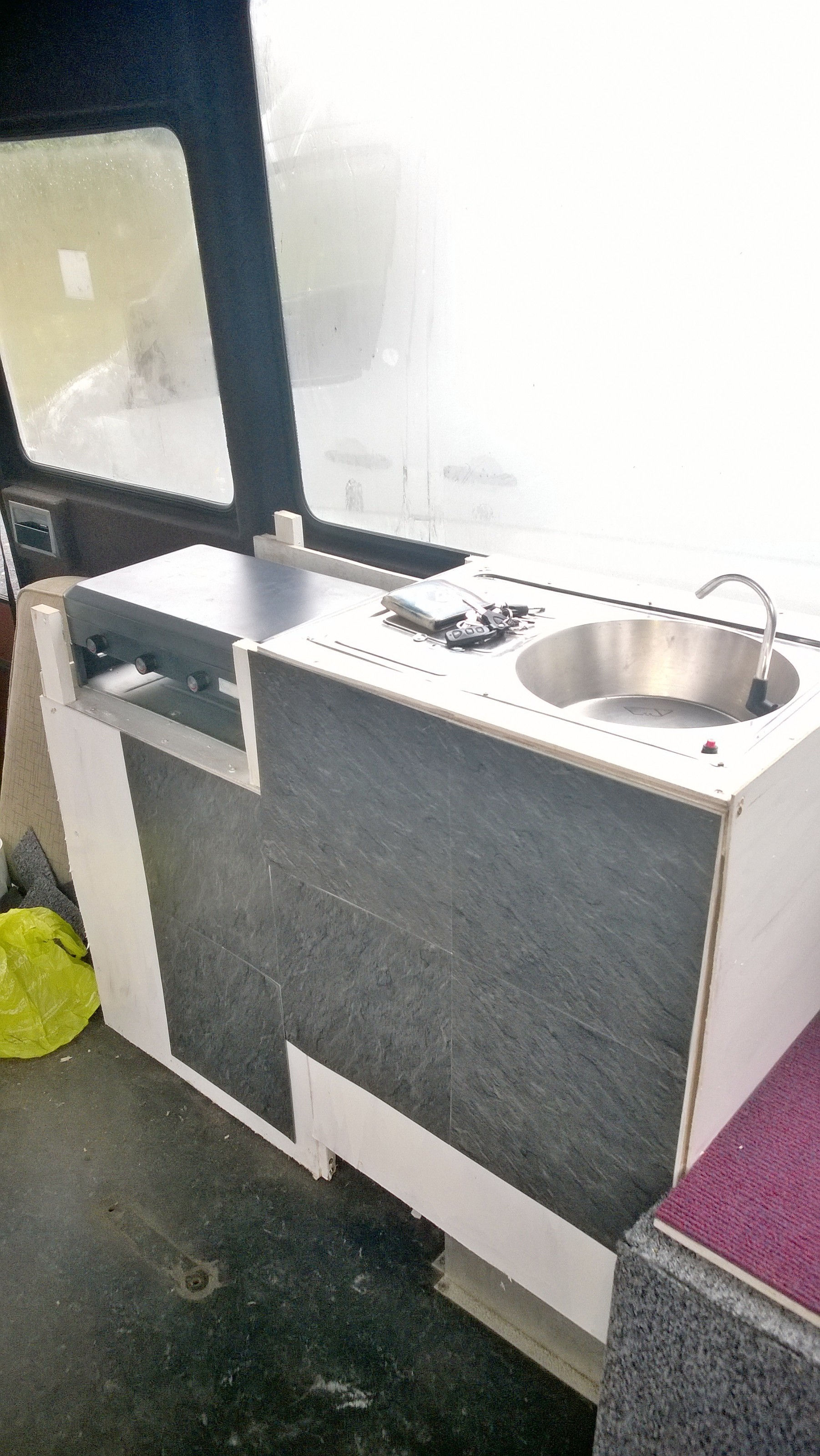

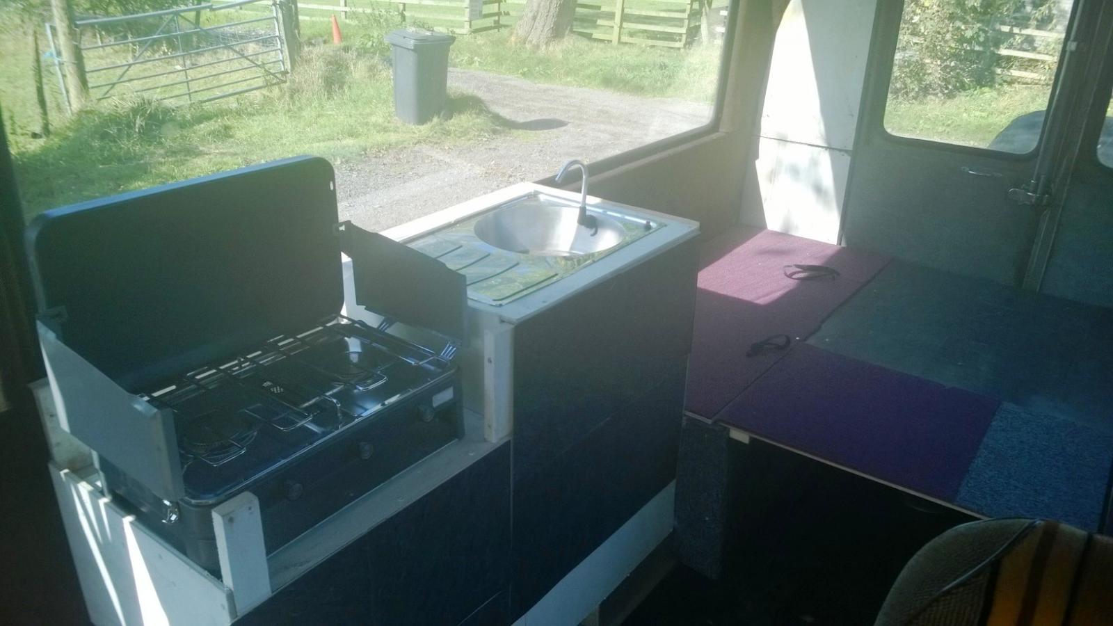

Sink and cooker unit built. It is progressing nicely.

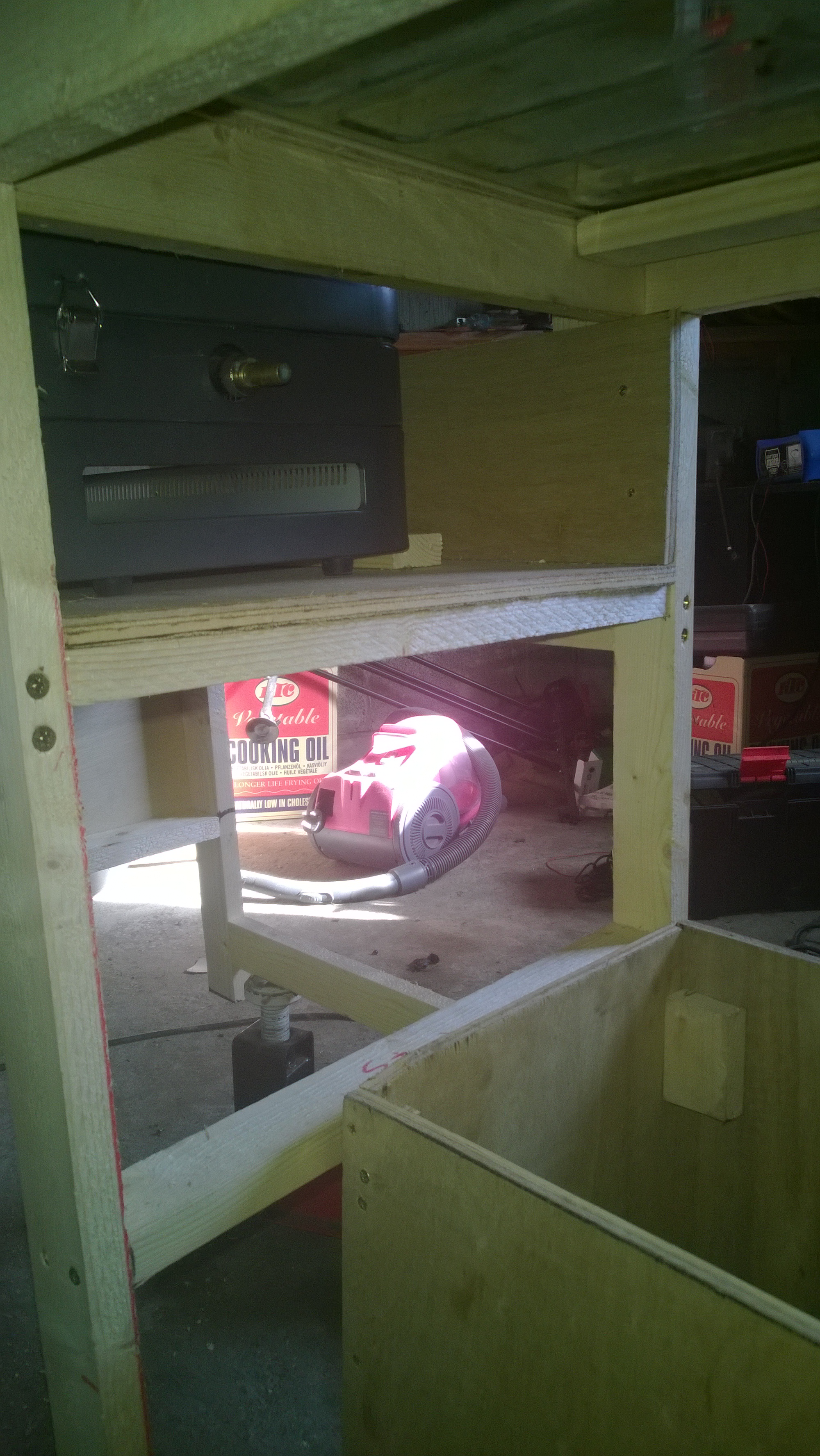

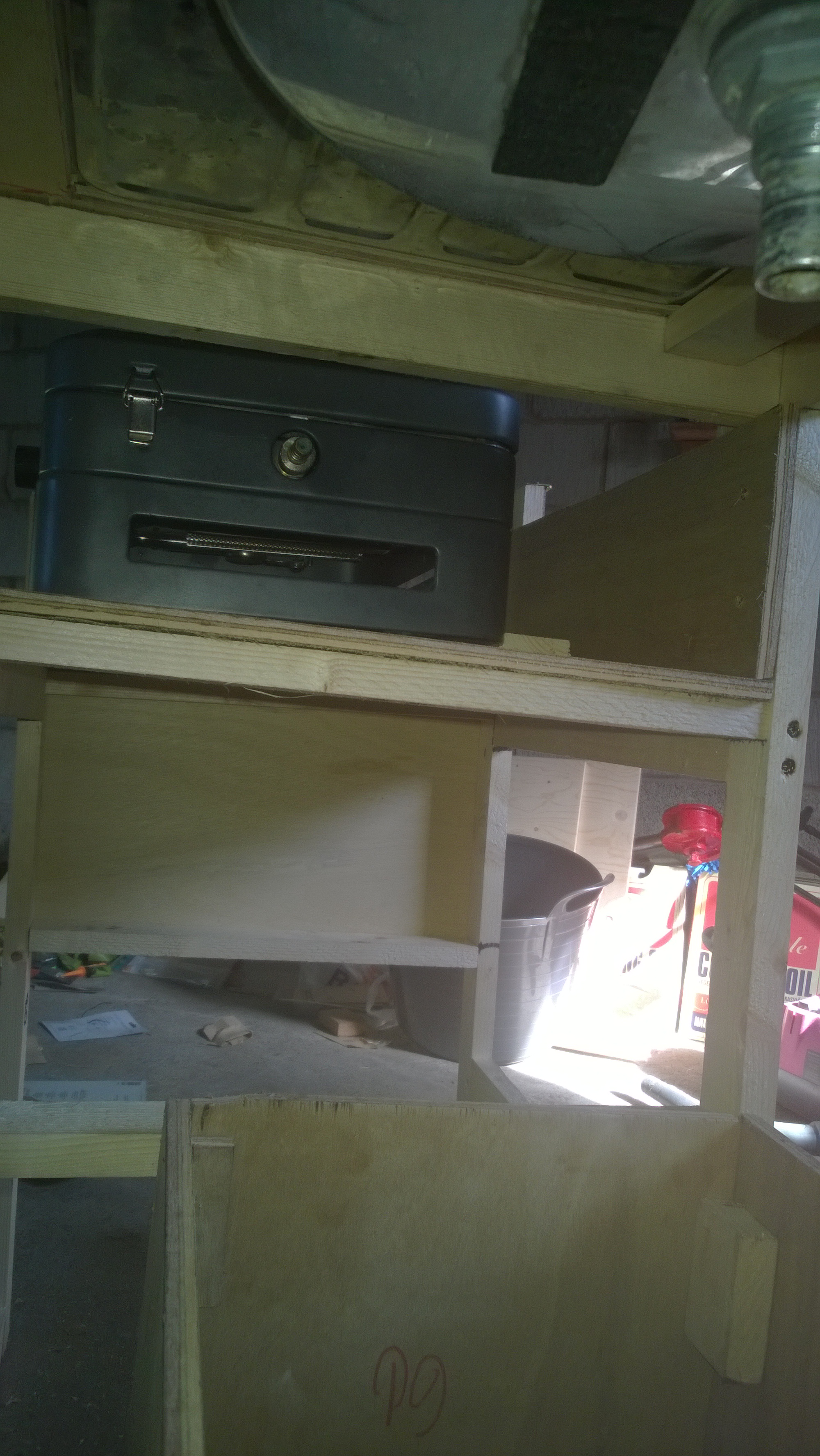

Today I built the gas box. But I need some help regarding the gas pipes. I have attached two photos of my sink/cooker combo. The top of my gas box is about 25cm from my cooker.
Can I use rubber hose for now?
From the research I have done you cant have more than 18inches of rubber hose, but also most people run copper hard lines. For the sake of a 1/3 of a metre I think this is going to complicate things for now.
I will put a fridge in at some point(probably next year) but I will take the time to take it all apart and do it proper with copper then.
Thoughts?
I'm not sure on the regs, but you state 18 inches is OK yet you have a distance of 25 cm. Mixed units? I've done all mine in copper to a fixed tank so no help, but wouldn't personally worry about a little extra length, especially if just a temporary solution.
Sorry about units. I will live with it for moment. Hopefully it will be finished to send off v5 this week.

I had tried painting it all white with cheap gloss but it looked proper shit. So came up with plan b when I saw tiles for £1.25 each in BM.
Got the boxes roughly covered with floor tiles from B M. Currently screwed on, once i have laid all insulation and doing final fit i will glue the tiles on.
Covered gaps under the sink and cooker with hardboard. I will go back and fit proper doors later on.
Gas box built and sprayed green.

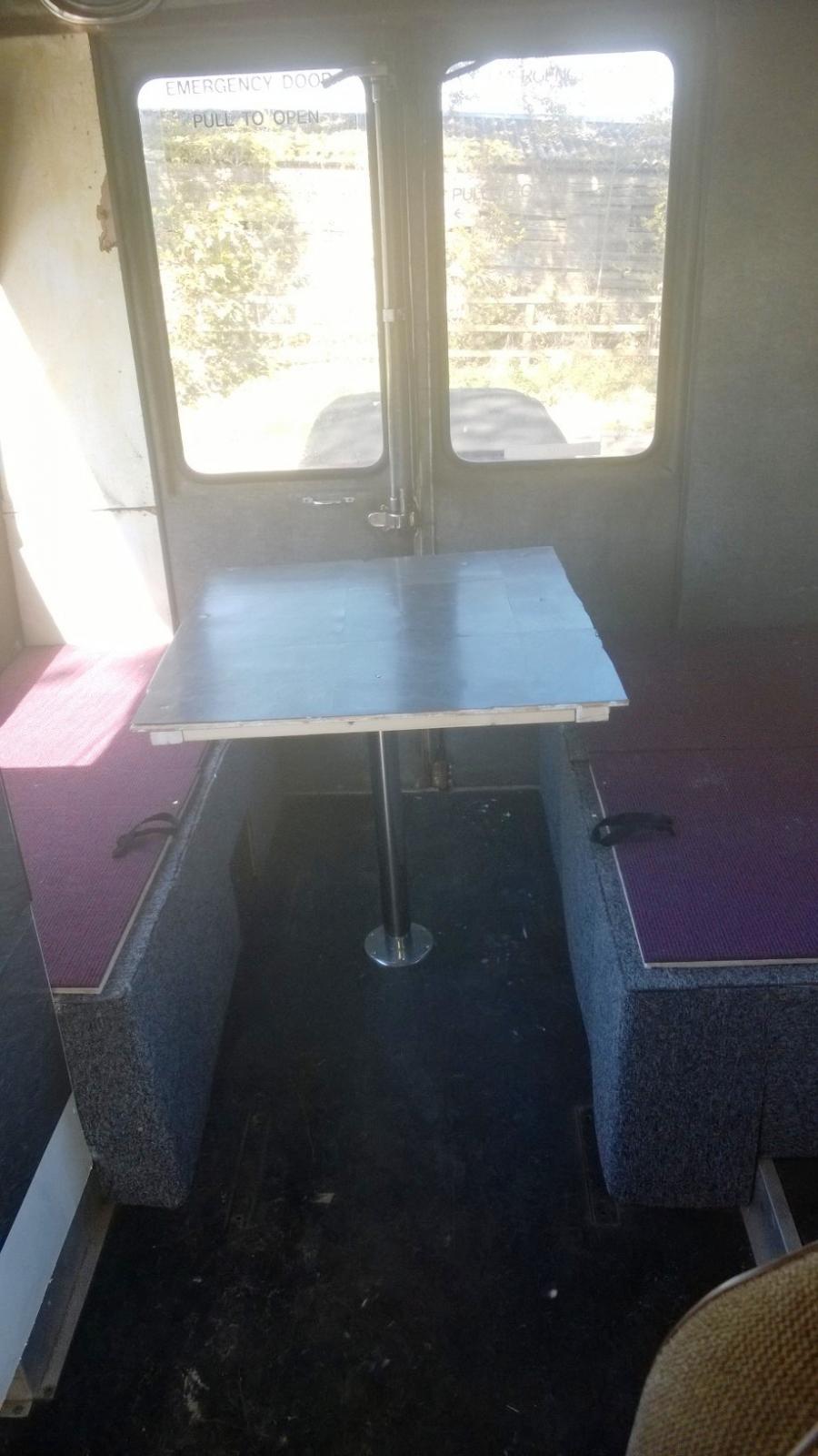

Trim table to fit width
Cover table surface

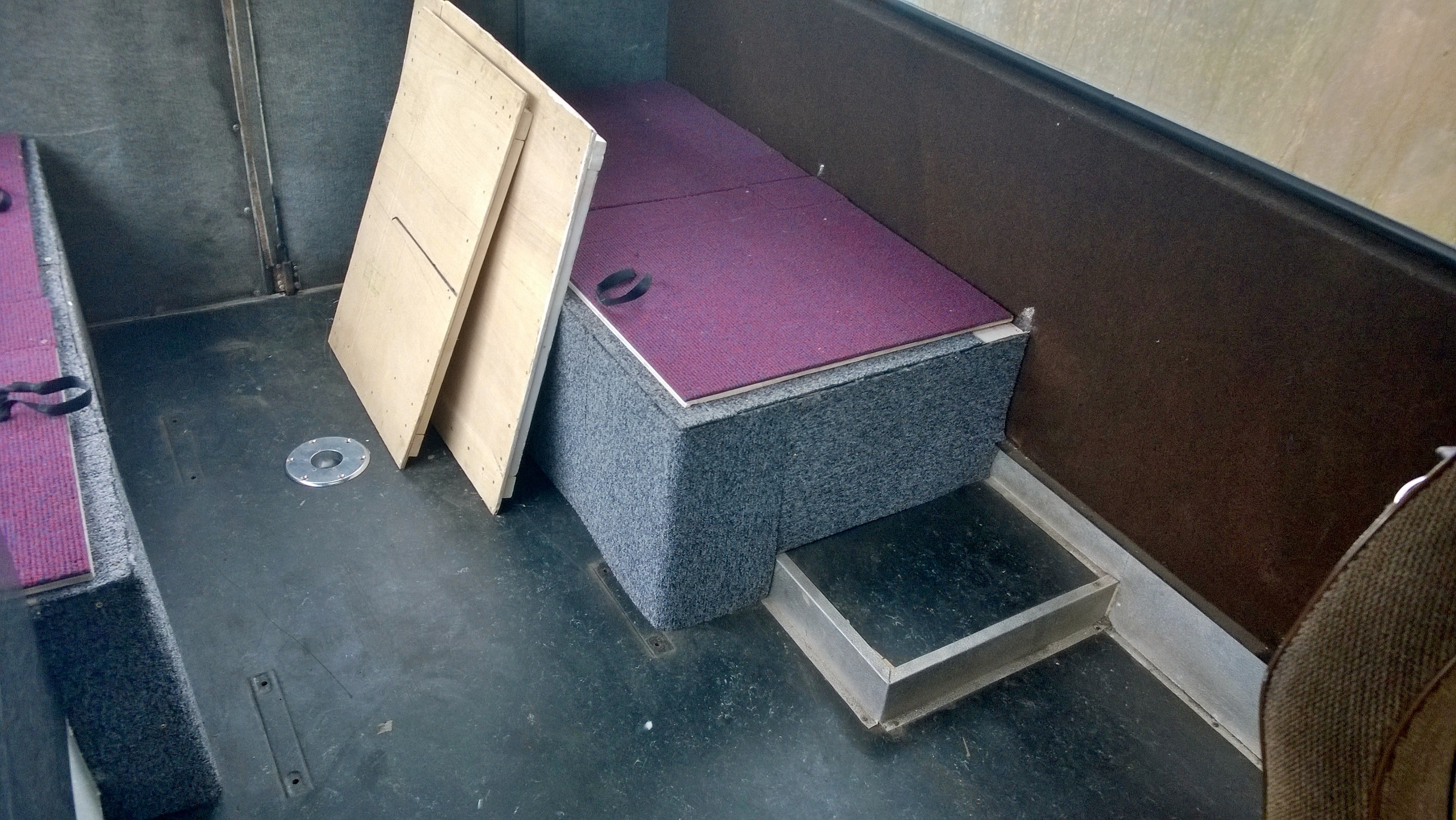

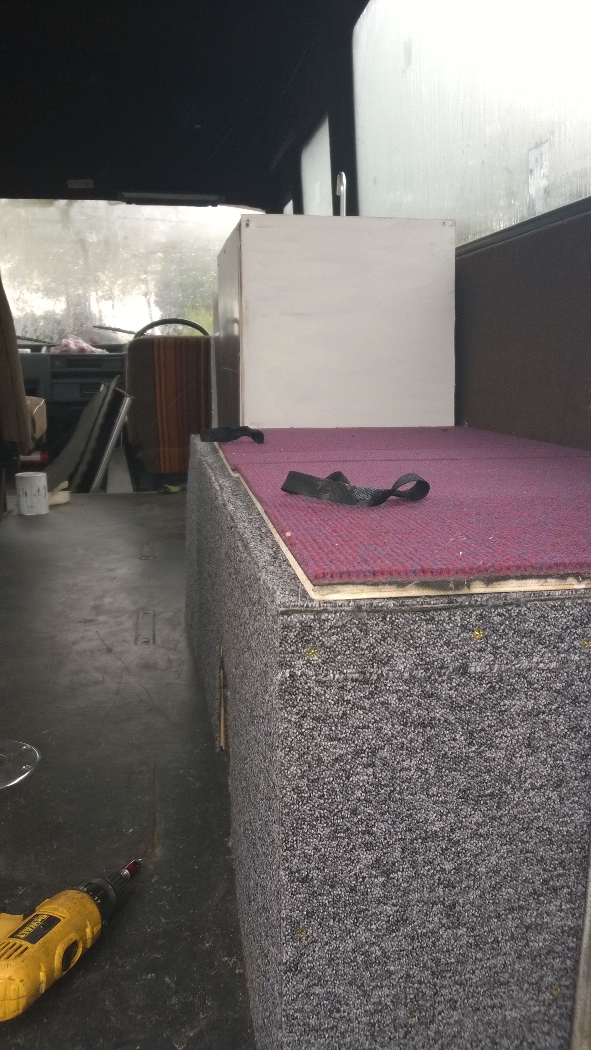

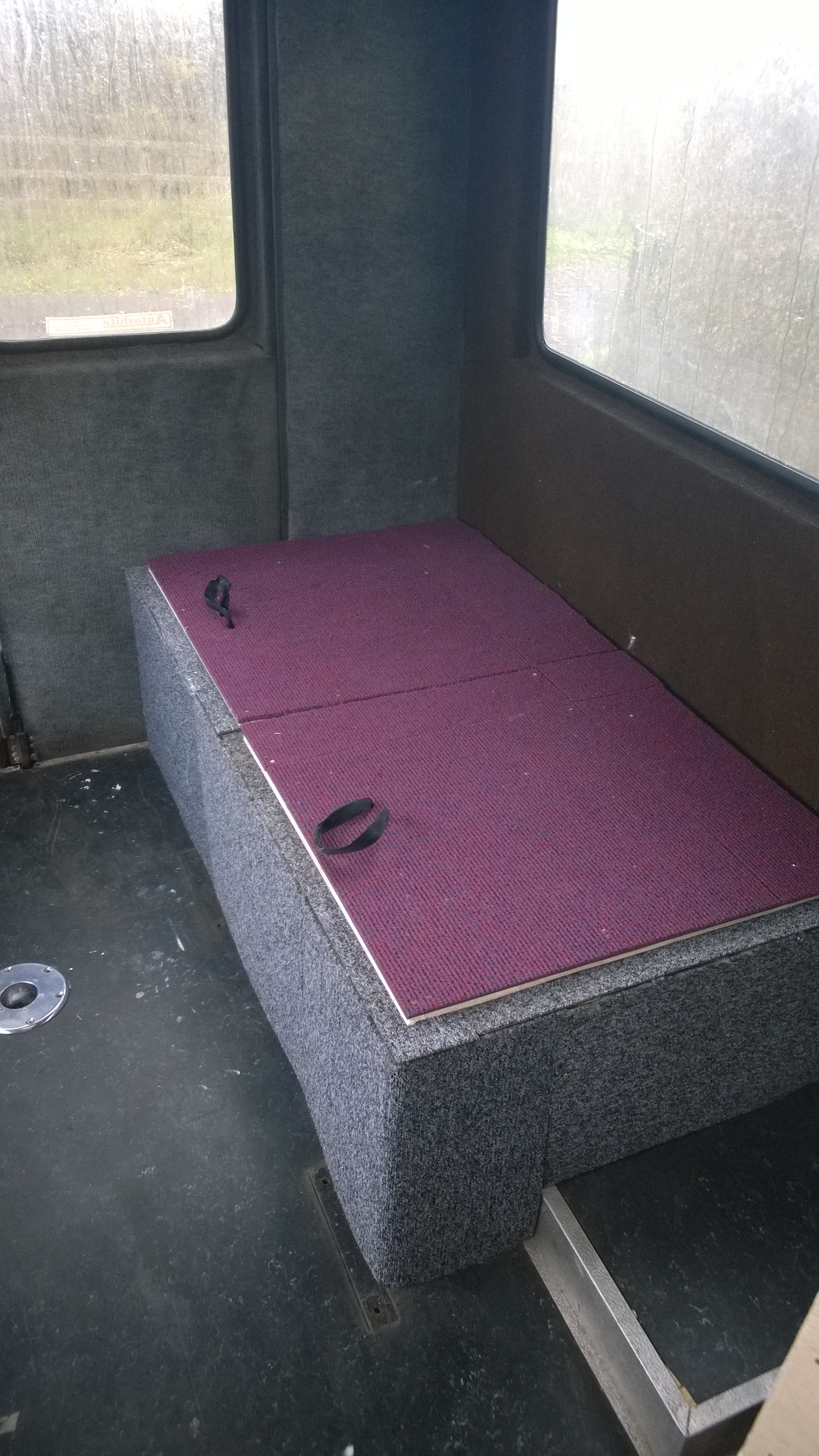

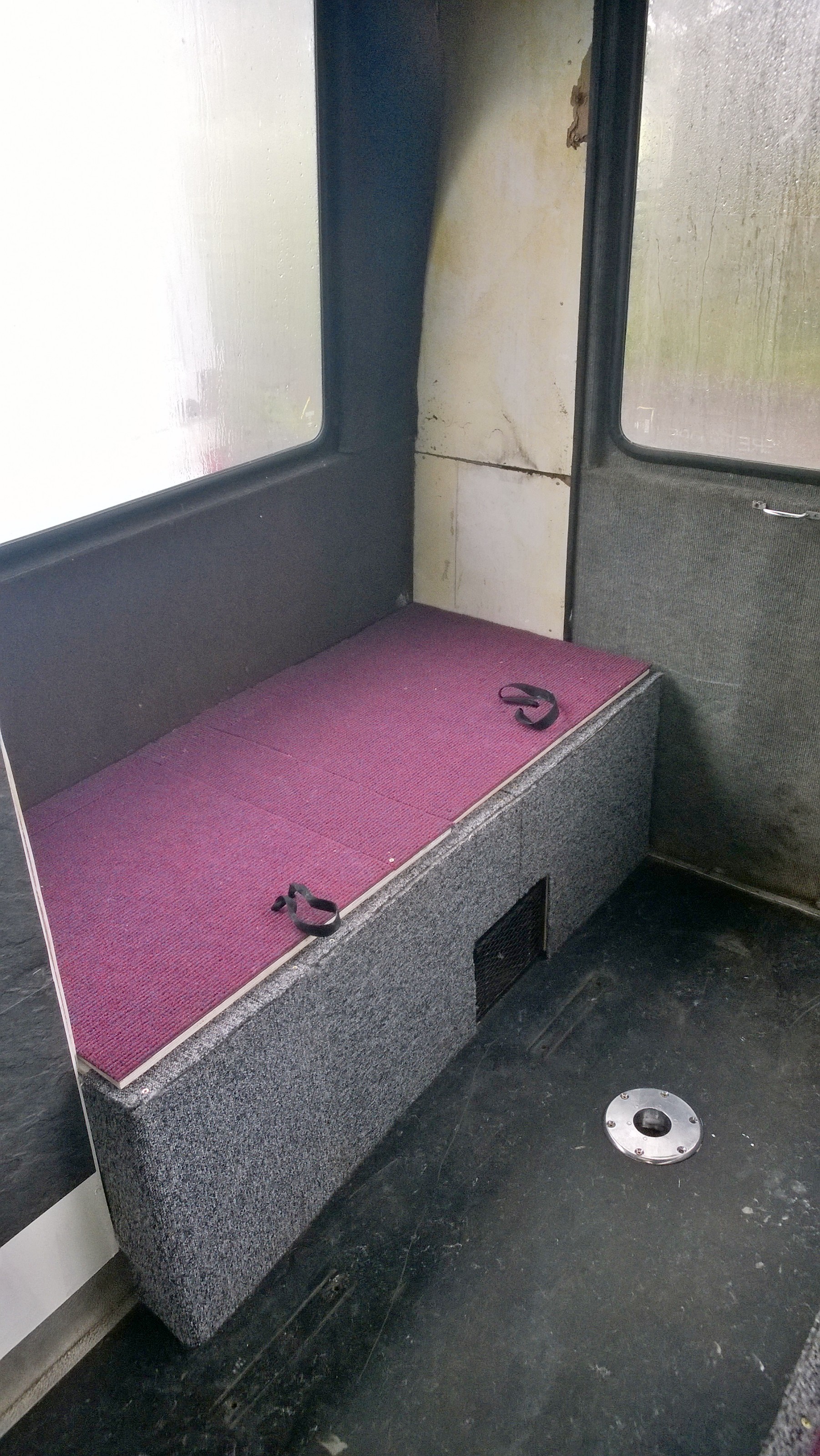

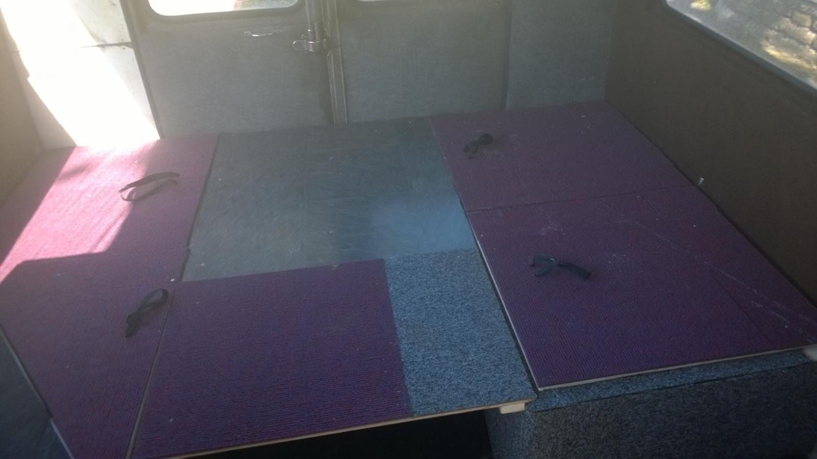

Final tweaks made, pictures taken and V5 in the post.
Total Bill including van was £852.32 (so £350ish). It is usable for weekends but will need insulating, more cupboards, windows tinting, cushions 7& covers, curtains, fridge, leisure battery and electrics for more. Oh and a 5 speed box :-)
Apologies for the shit pics but camera didnt like the sun.
