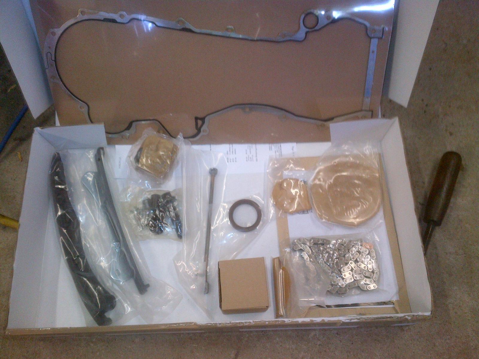

santa has been early this year and left me some goodys so I popped the red peril back in the air and set to it again.

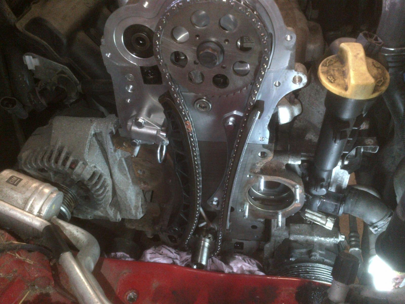

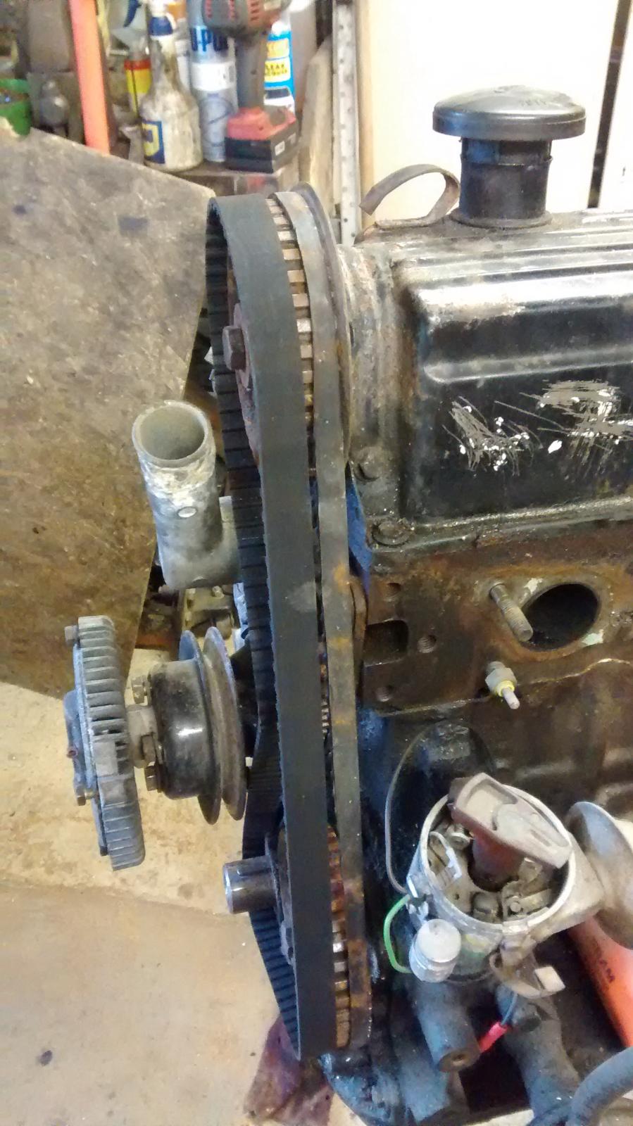

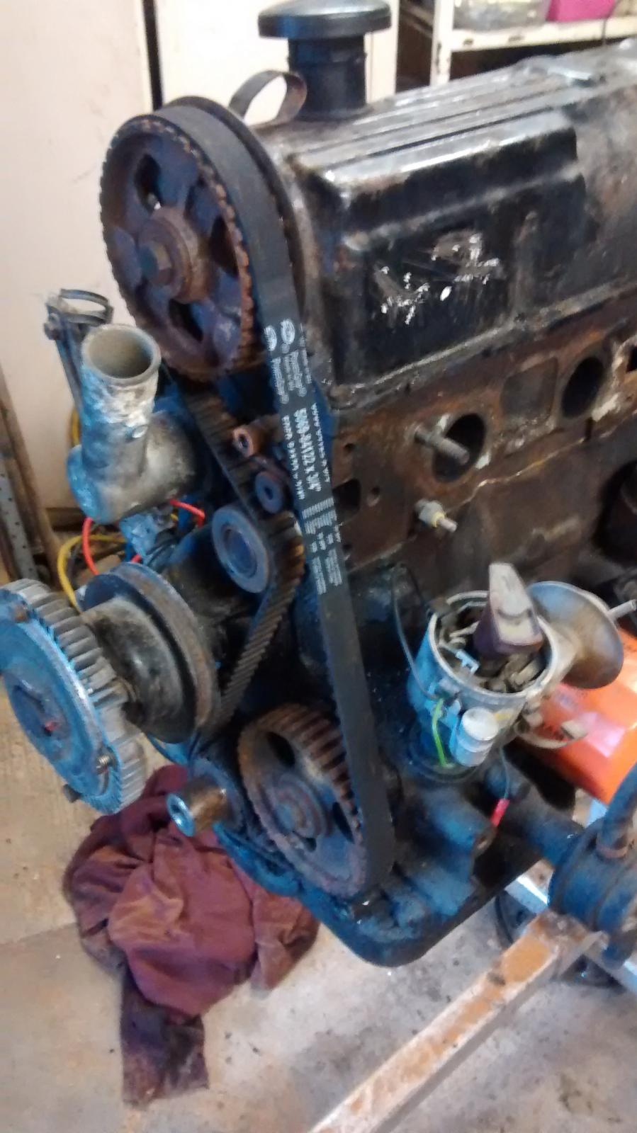

First job find the timing marks and after a quick google suggested the car gets timed with all pistons at half stroke I cut four pieces of wire the exact same length and dropped them down through the injector holes,
I then rotated the engine so all sat at the same height and then I used an allen key to lock the bottom end through the appropriate hole at the bottom of the gearbox.
Then I locked the cams in place through the caps either side of the head and removed the sprockets,

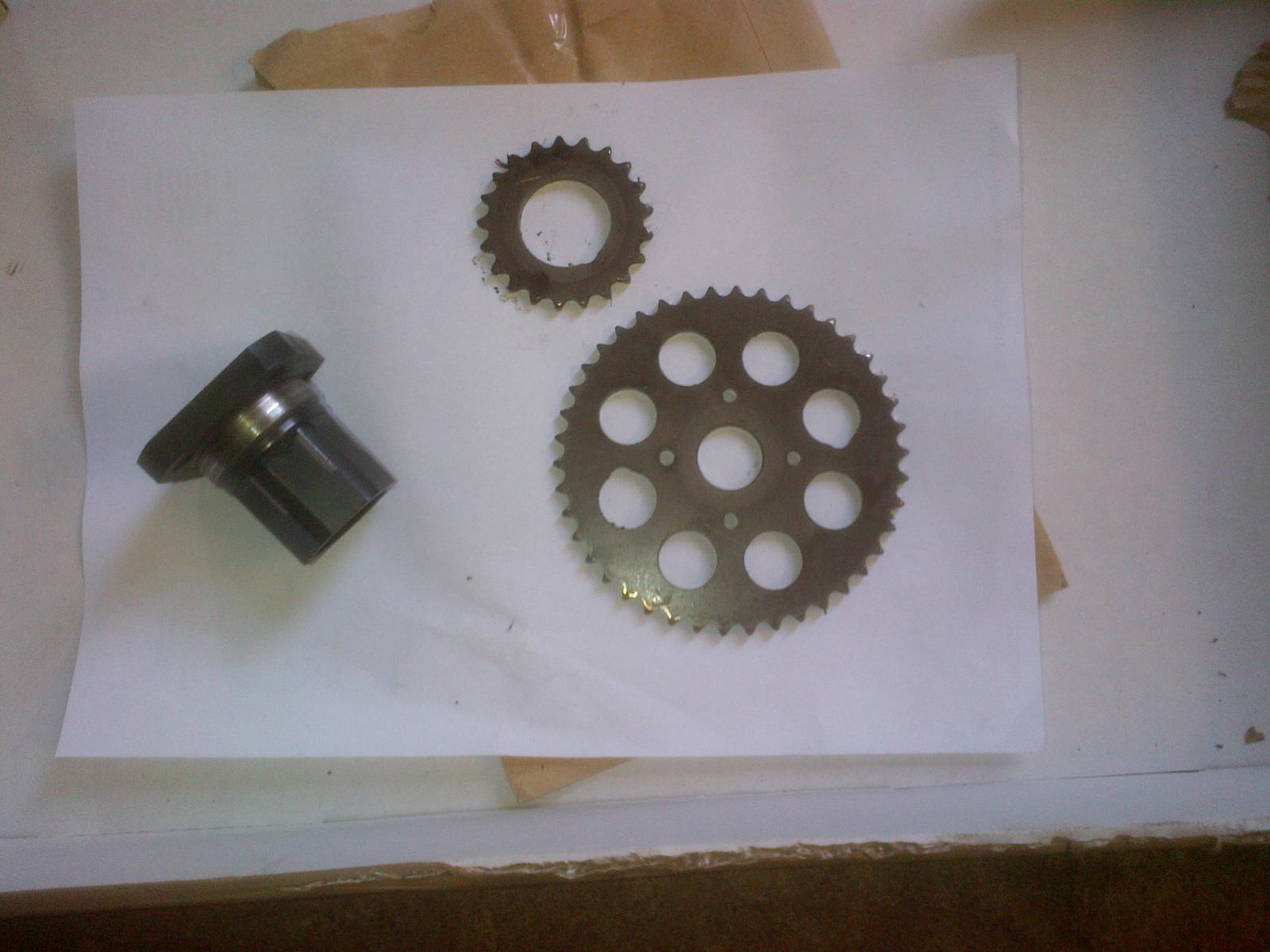

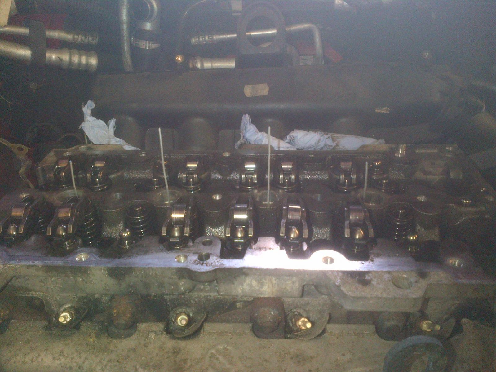

this was the alarming bit as the sprockets don't have any form of keyway to lock the sprockets in place :shock: Mr fiat must have left that bit for the yts guy to design.
four new rockers fitted with gasket ready to re fit the cams and rocker box setup,
oh I love shiny new bitts, after tightening the camshaft as tight as I could manage I refitted the whole cam chain kit ready to pull the plug on the tensioner
now one and a half hours later here is the engine fully rebuilt and ready for oil.

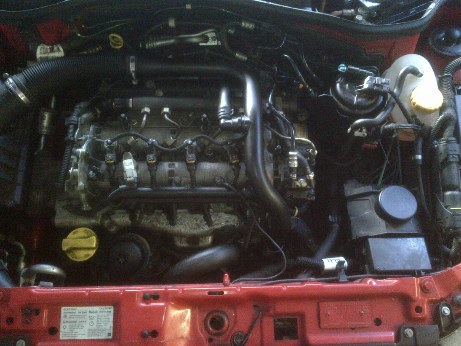

I then let the car down filled engine with oil and turned ignition to let the fuel pump run for a bit to prime the system,   after a bit of cranking and intermittent firing it bled itself and burst into life, the engine runs quite smooth and sounds as quiet as a diesel can be and once up to temp I took it for a hurl round the block,
I've never liked corsas but I have to say it drives pretty well and accelerates straight up to 80 without issue, the engine starts first turn of the key and I was happy for about the next four hours when I decided to move it  again, this is when my cheesy grin turned into a frown :-(   I turned the ignition on and when glow plug light went out I fully expected the engine to burst into life and purr as well as any diesel can but nope she cranked over intermittently firing until it started, once started it ran perfectly and would stop and start with ease,
one hour later and bollocks wouldn't start again, after checking all pipework for air leaks all I could find was a wet drip from this high pressure pump,

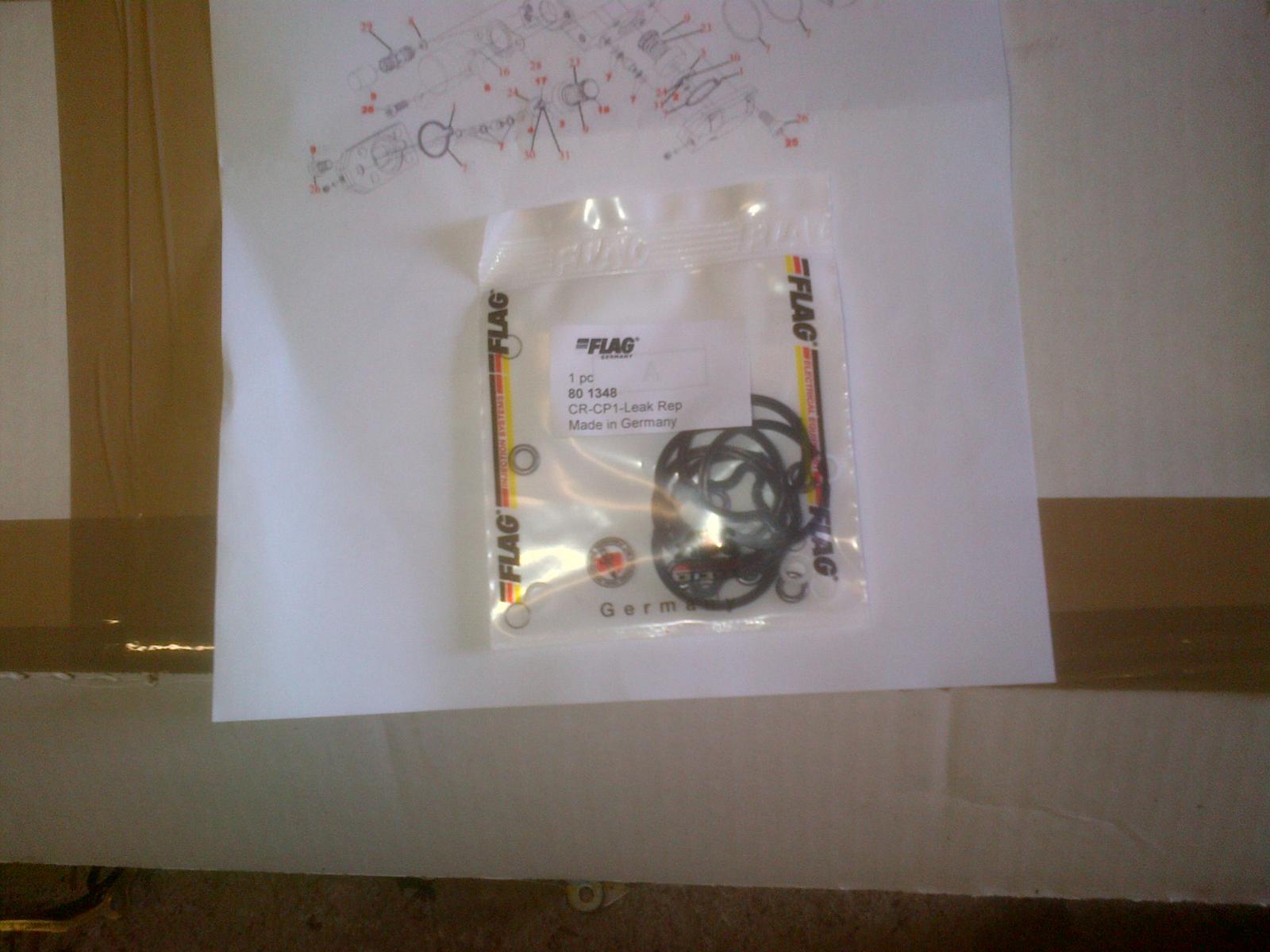

I have just gambled on a seal kit from   http://www.diydieselshop.com/113109965 so I shall rebuild that next and hope that is what is causing the starting issue.

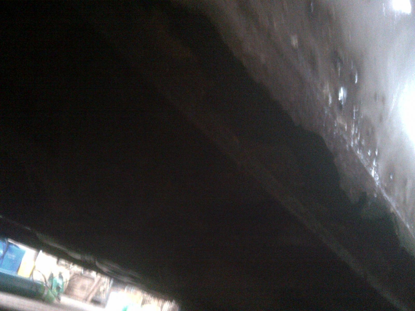

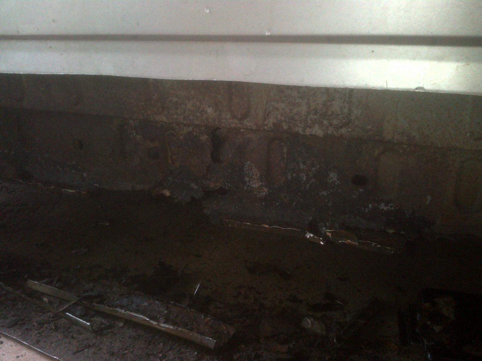

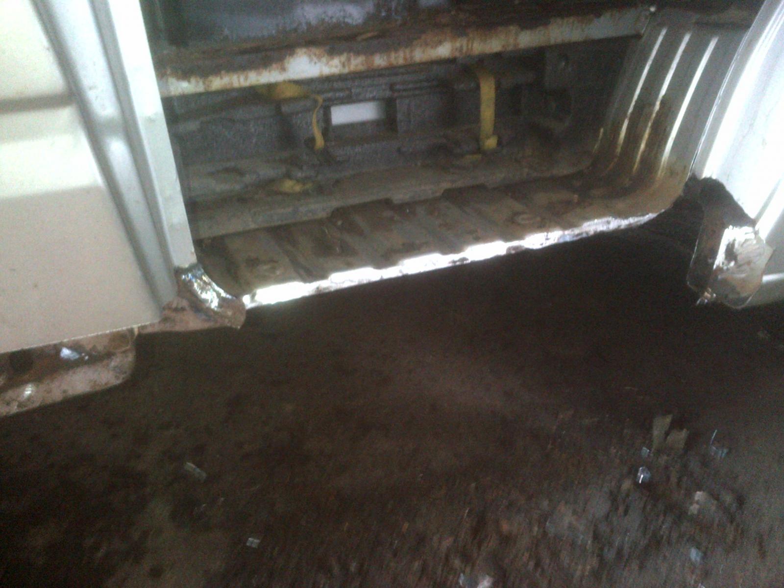

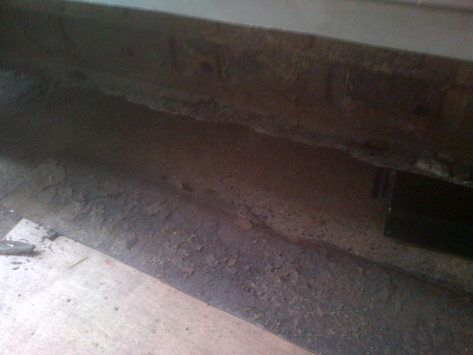

I had feared that the inner sill would also be goosed so lets see,
yes it is totally shot and wafer thin.
And what's more its much farther forward than expected, just look at that seat mount how the fook does that rust? its inside for fook sake.

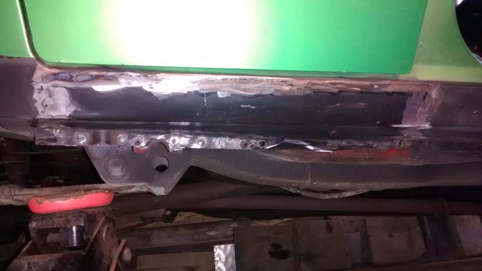

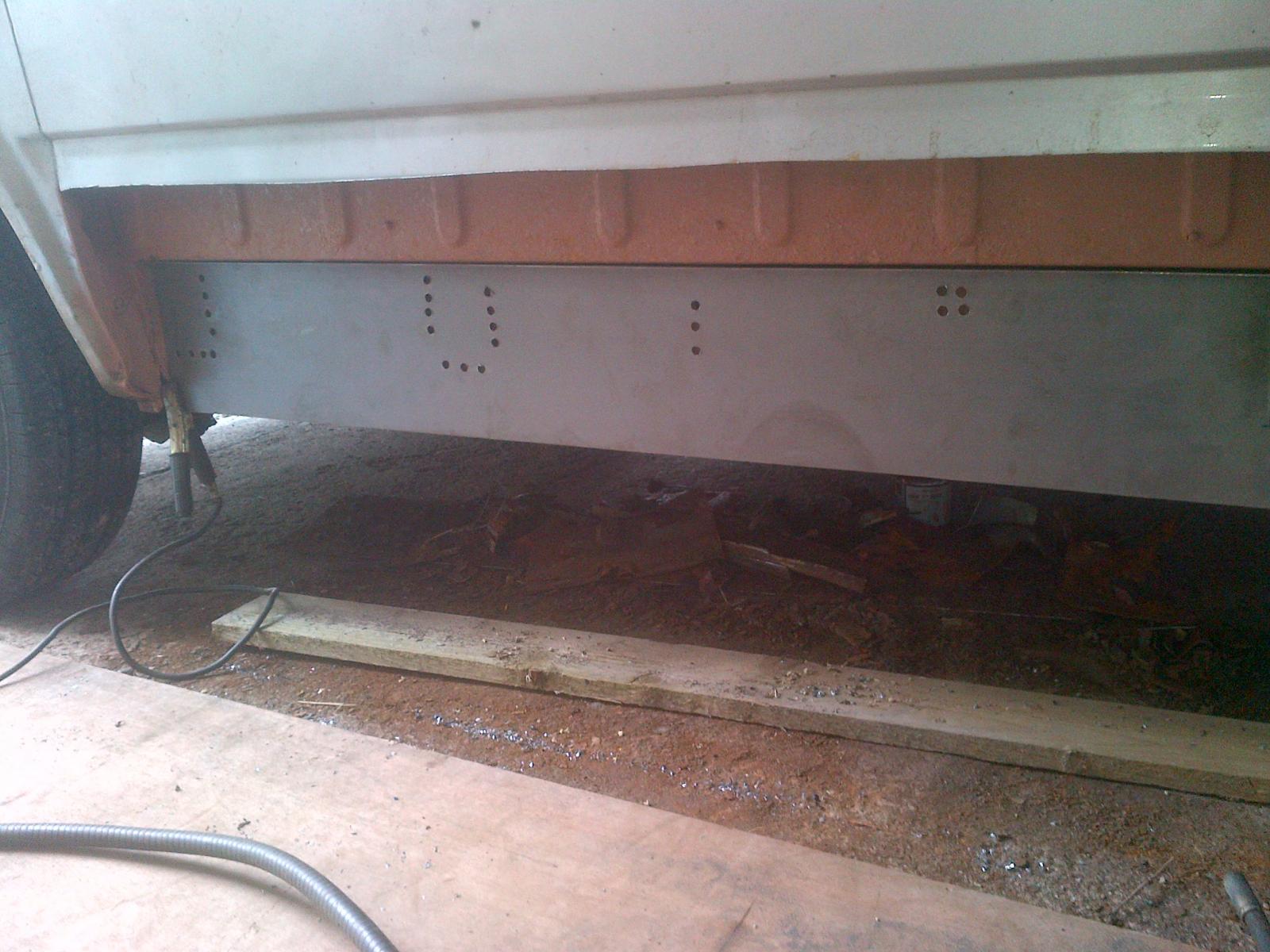

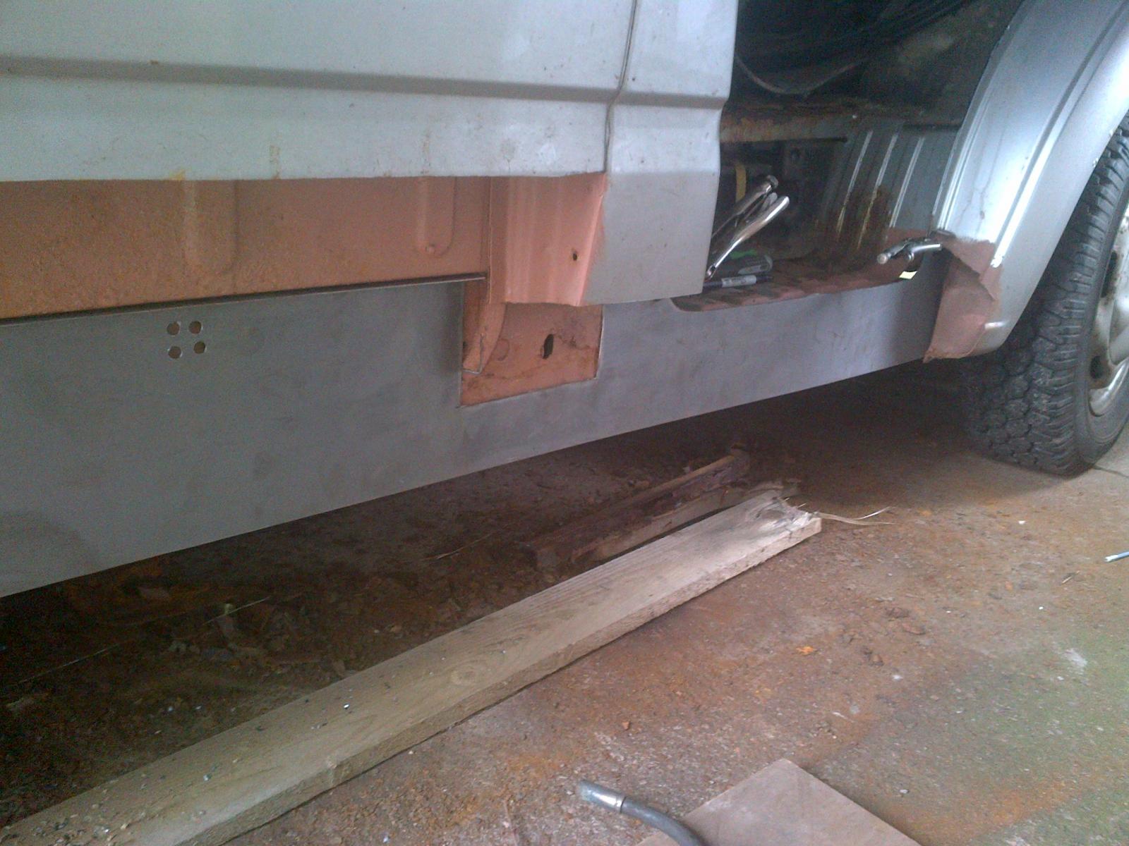

I bought some new sheet and shaped it full length of the inner sill,
folded a 3/4in along the full length and shaved bits of left right and centre until I got a snug fit.post-3747-0-73546300-1416866450_thumb.jpg
drilled a few holes and spot welded it all in place then full welded it along the top seem,
all that's left to do now is weld on outer sill and cut down the front arch to weld in place.

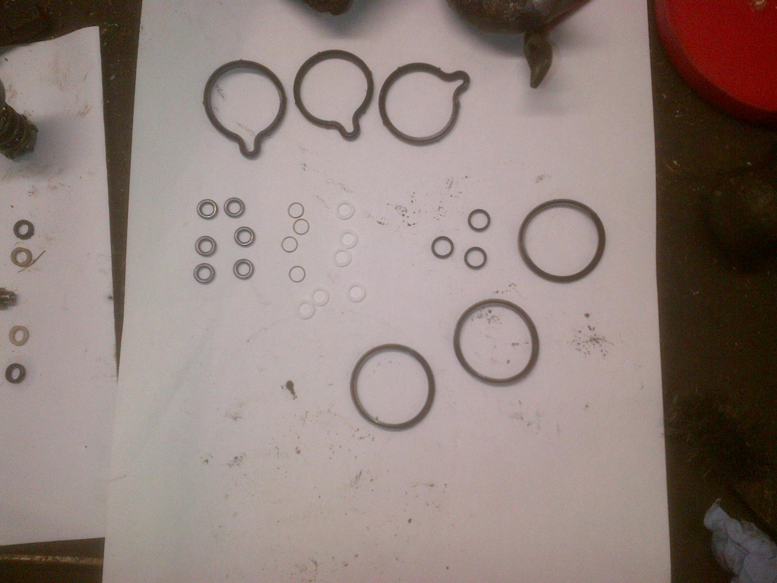

Well back to this corsa this evening and more new bitts,  another £20 gamble that this is the problem fingers crossed, its a tad cold so its taken me half an hour to get motivated.
here are the new ones laid out awaiting fitting

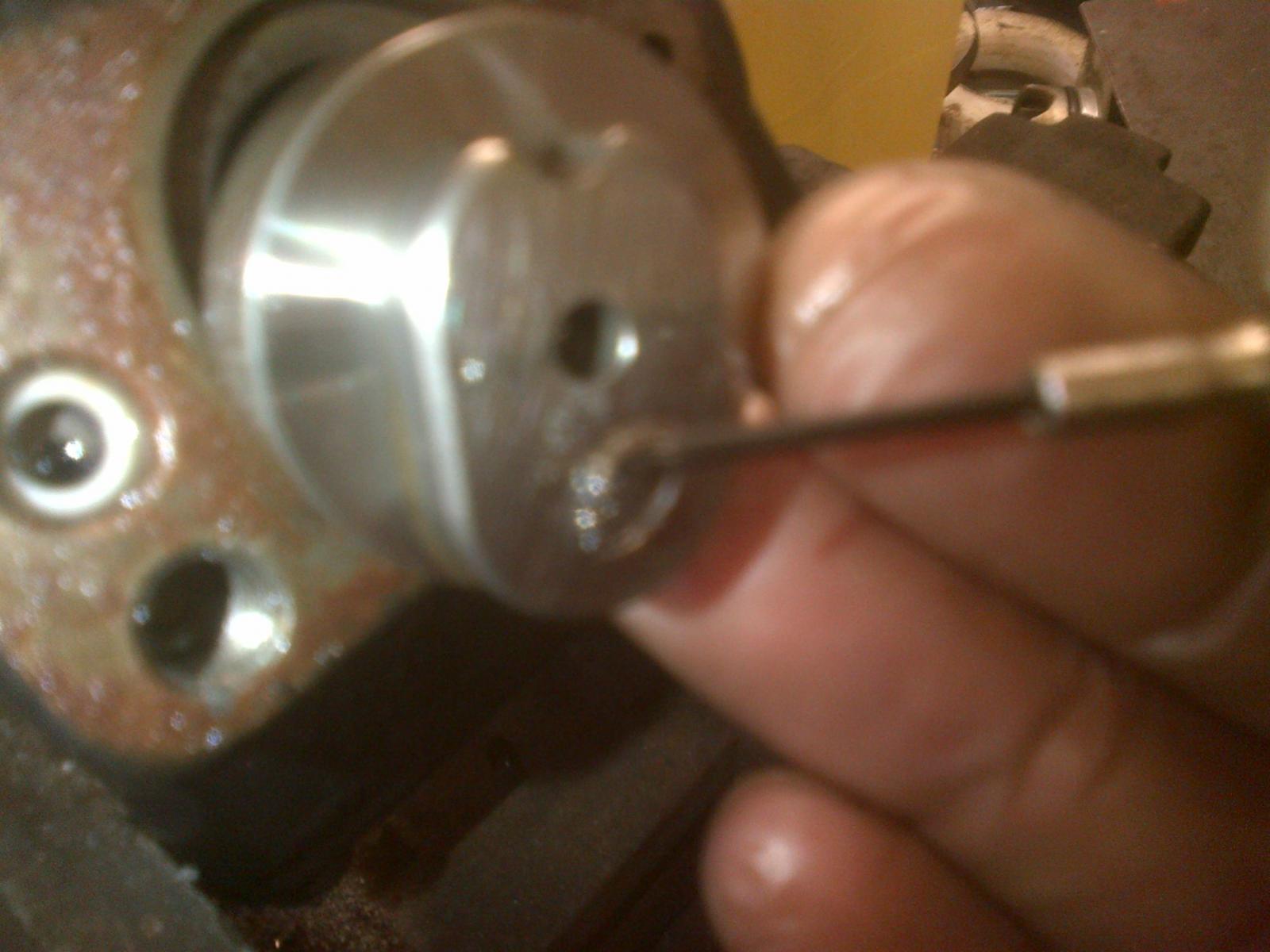

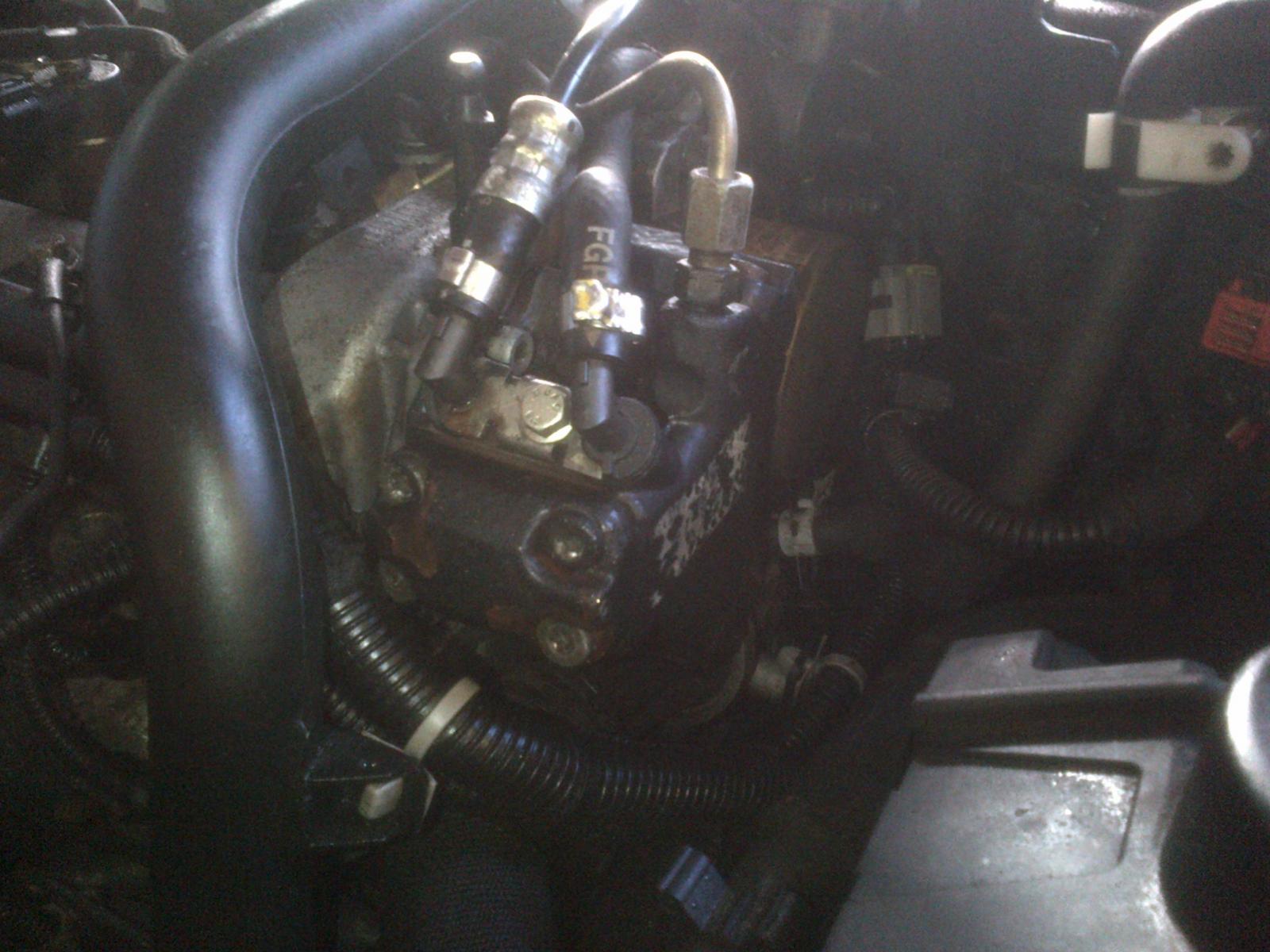

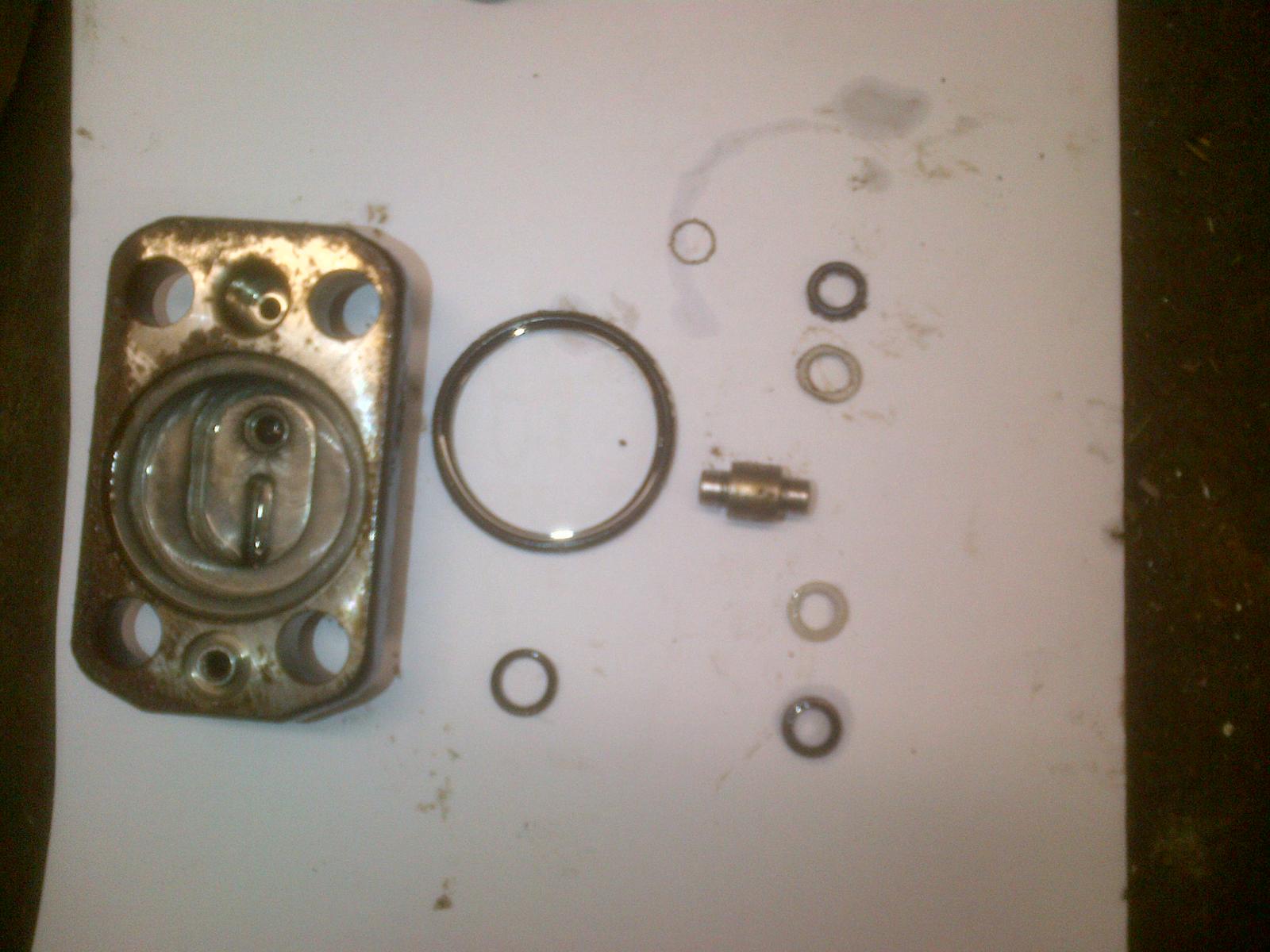

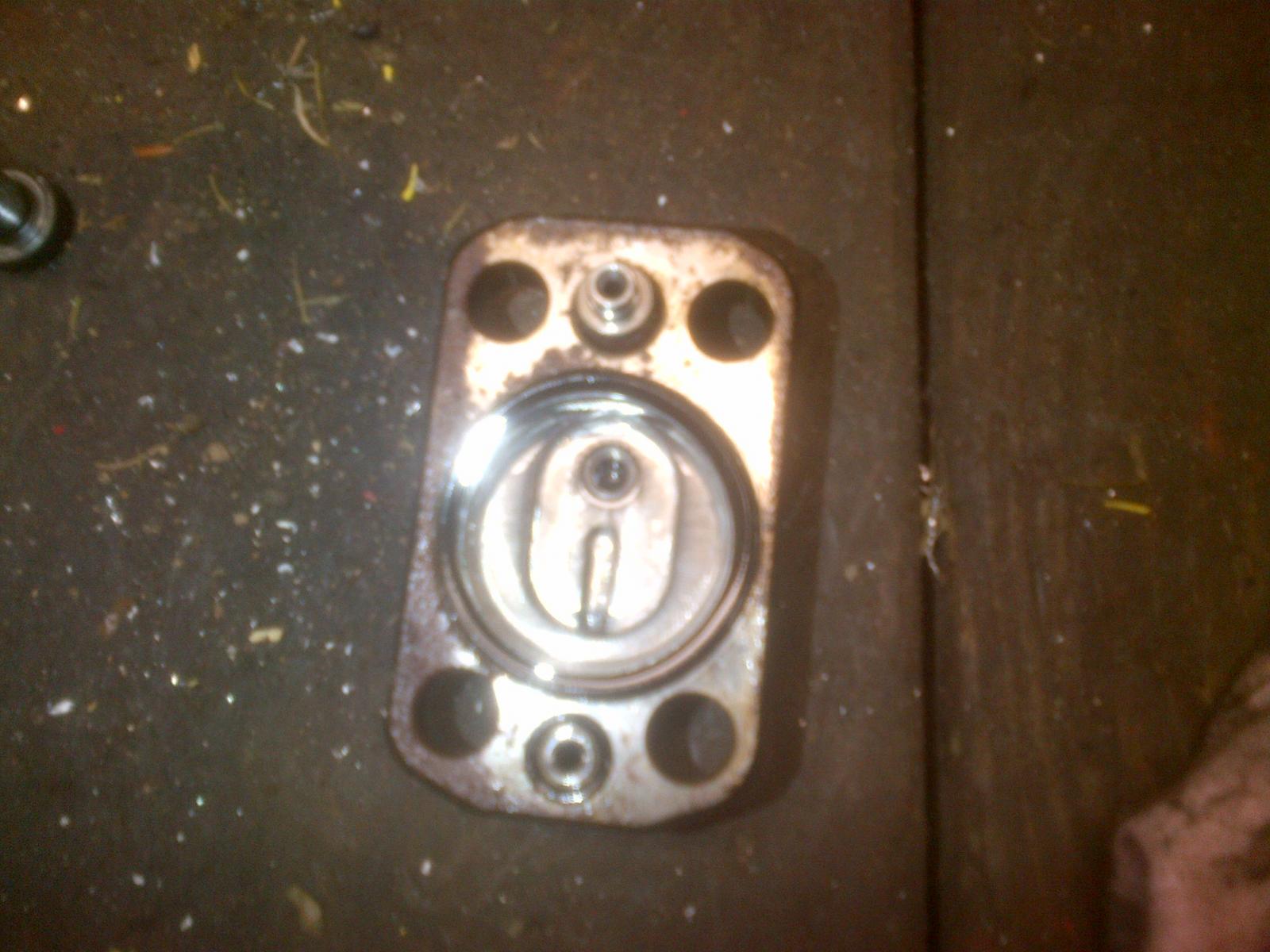

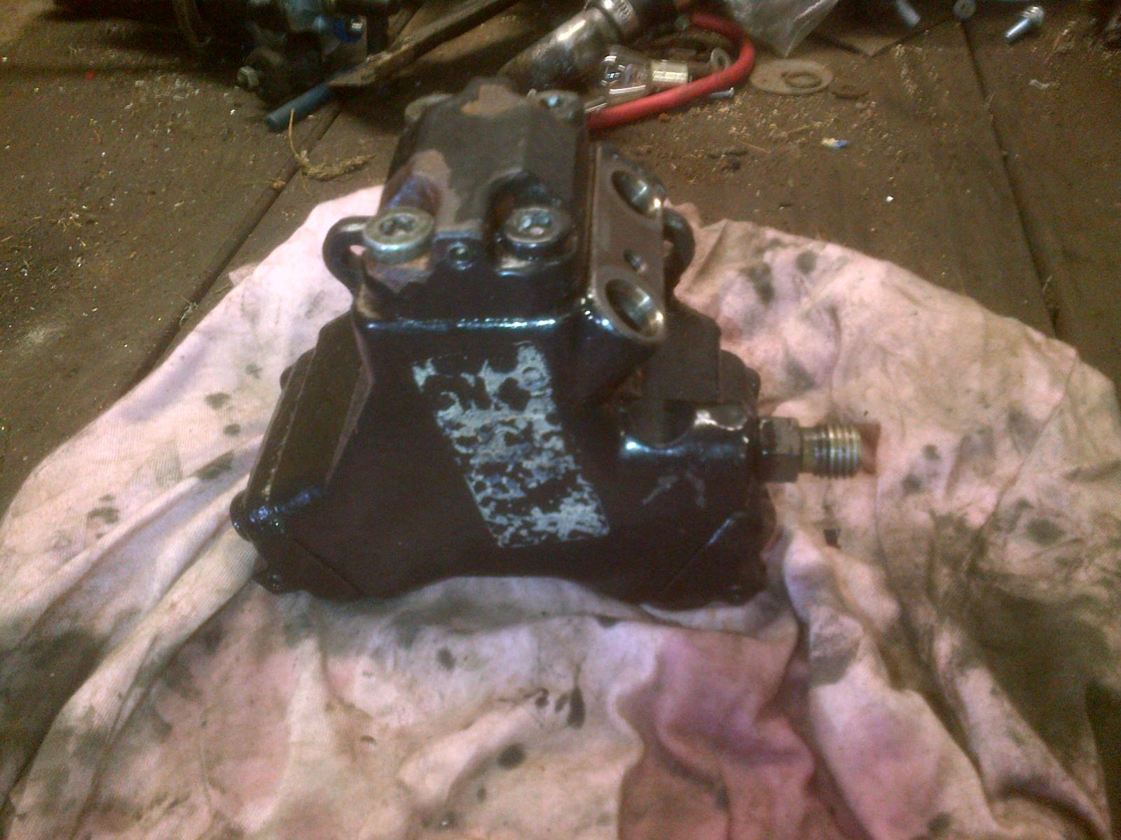

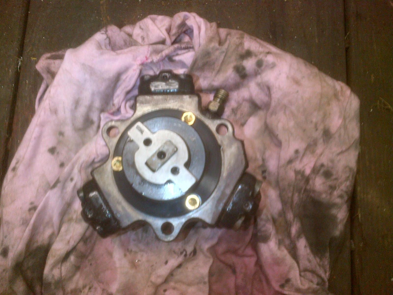

this is all new to me as I've never pulled apart a high pressure system before now so here it is removed yet again for repair,
I decided to only do one of the three caps at a time as I had no idea what would spring out.
this is what is inside the pump and under the middle centre valve thingy is the smallest spring I've ever seen,
and this little sealing washer is a tapered alloy and also thin enough to loose,
its hard to believe that under the cap is seven various seals, I fitted them with a small amount of grease to hold them all in place to ease fitting, bunged the cap back on and torqued it down as specified then moved onto the next one.
once I had done the first one the other two where a piece of pish and took half the time,  two cold hours later the car was back together and after bleeding it back up again I started it up and took it for a run round the block to warm it through,
it starts and stops as would be expected and since its frosty baws out side I guess I will wait until tomorrow to see if it starts again as I am not going back out this night.

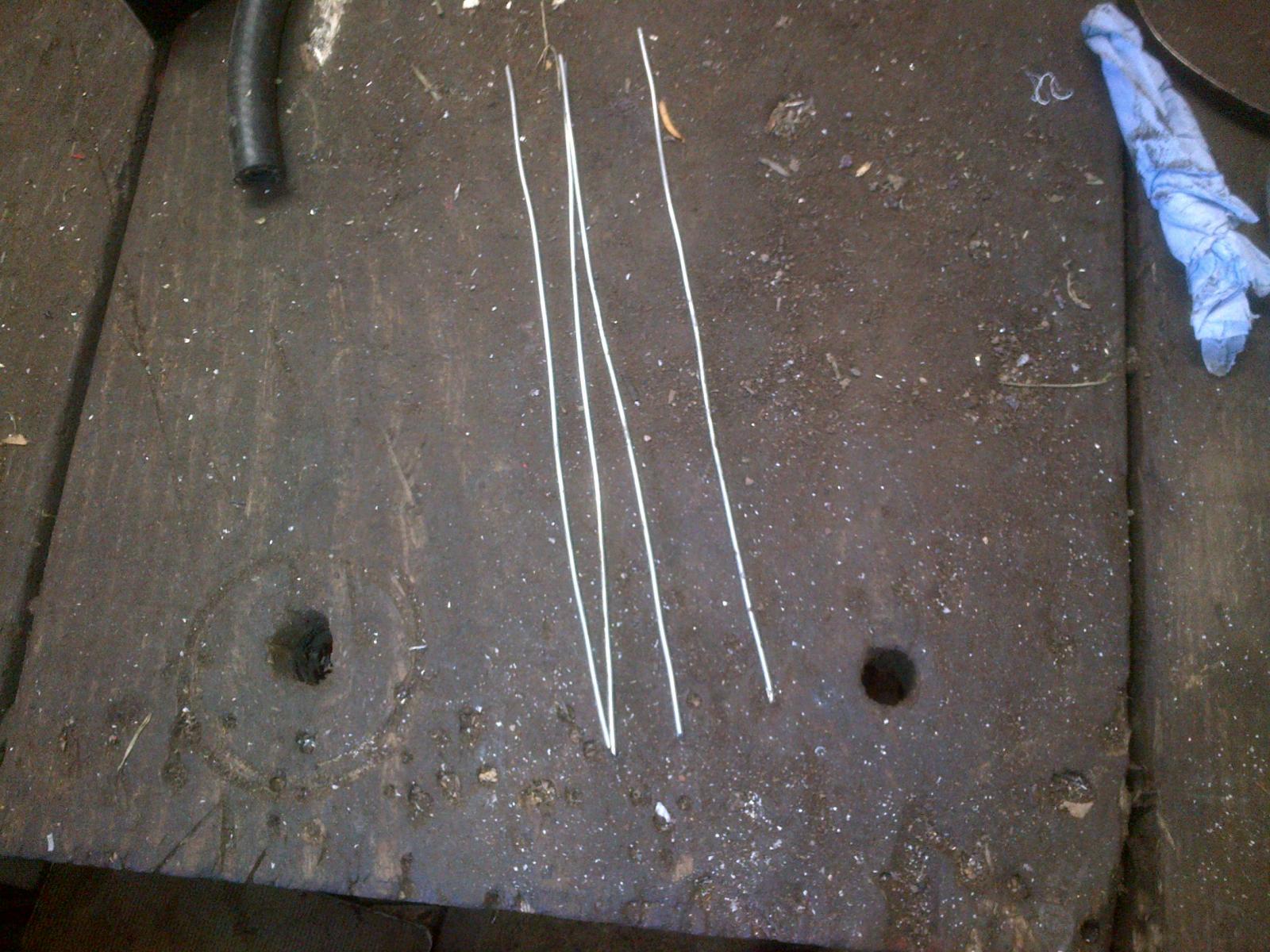

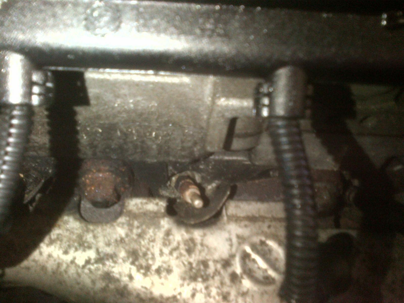

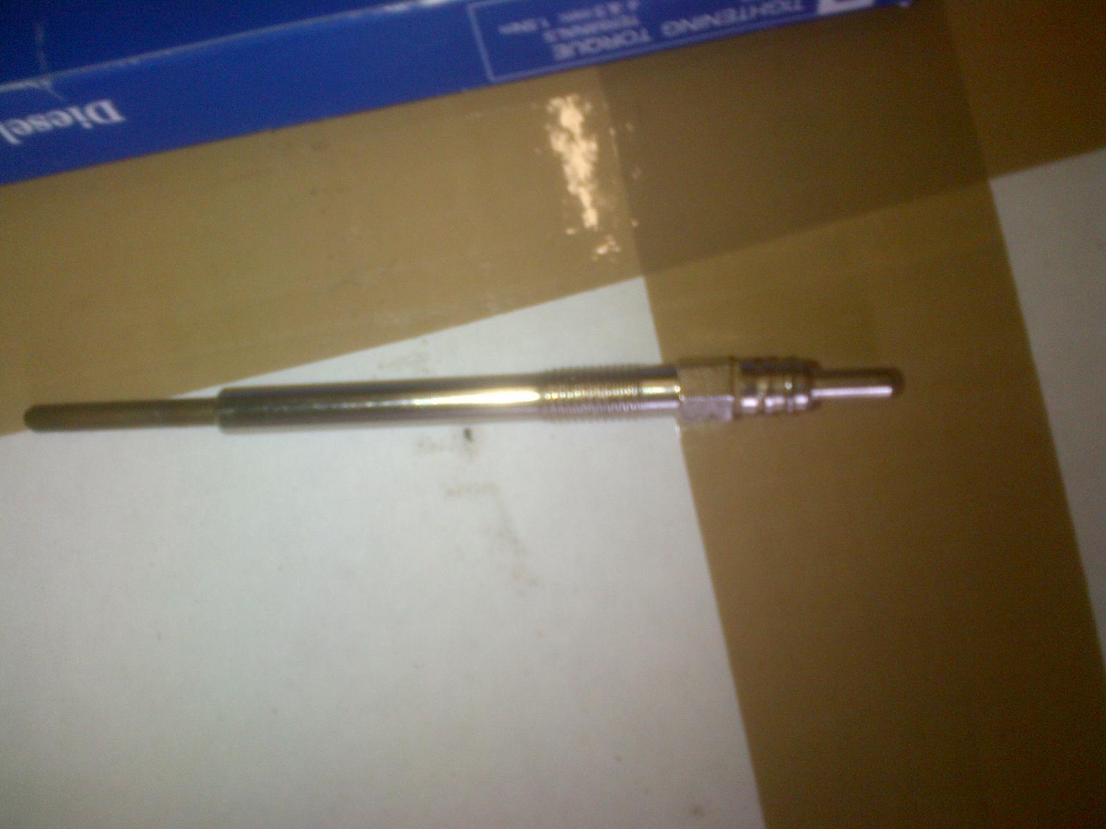

This looks like it will snap so plenty wd40 over a couple of days and woopie it screwed straight out.
very small so I recon the rumors of them snapping are not rumors :shock:
I just fitted the one new heater plug as I wasn't sure this was the cause of the starting trouble and the damn thing still wouldn't start without cranking it over for ages,

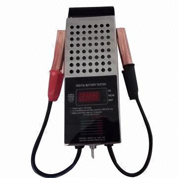

I couldn't understand it and after much head scratching I found it to be the battery :shock:   how can that be I hear you ask, well I can only assume that while it was cranking the engine there was no reserve amps to fire the injectors,
I tested the battery with one of these and it showed as good but week.
so I charged the battery for 48 hours and I was very sure that it still wouldn't start,  guess what it burst straight into life first turn of the engine :shock:  for the next week it started with no fuss then totally out of the blue started to play up again,
I took the battery into the motor factors for a second opinion and there tester said it was goosed, I stuck another battery on it and for the last 5 weeks the car  has been moved from pillar to post with no issues,
three things I've learnt
1 my battery tested is fookin useless :-(
2 the green battery indicator is a liar  :shock:
3 I have two many motors :-D

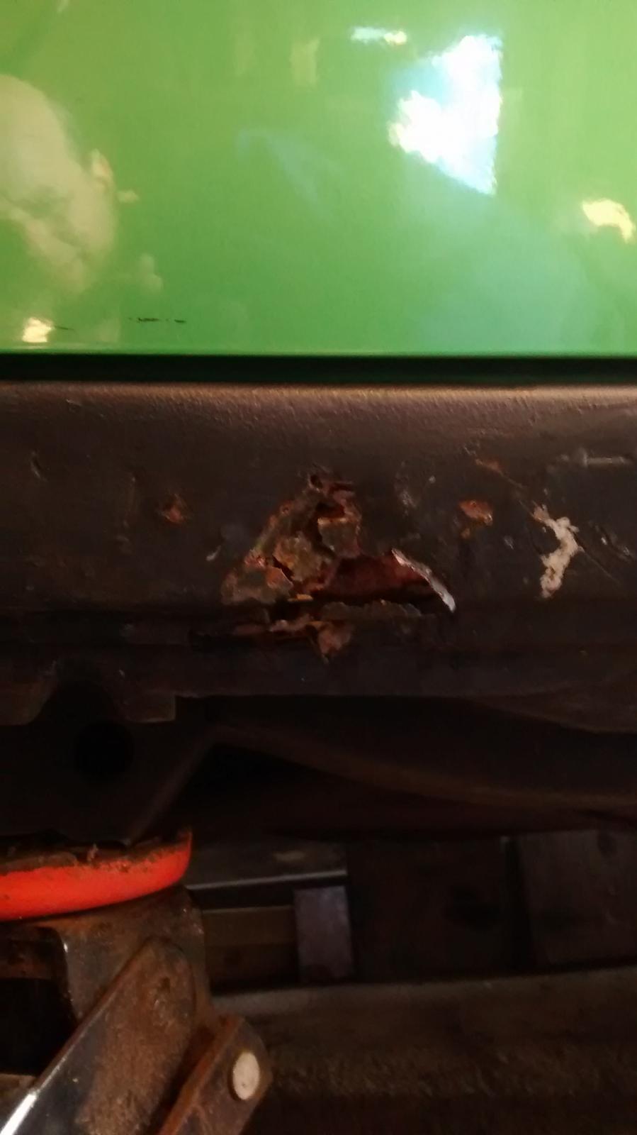

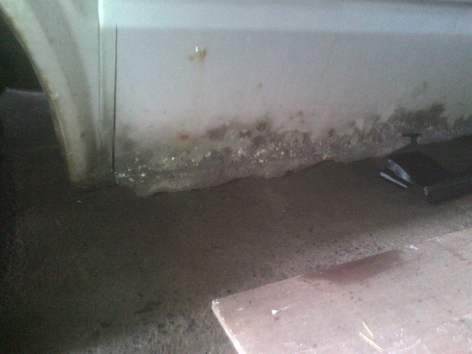

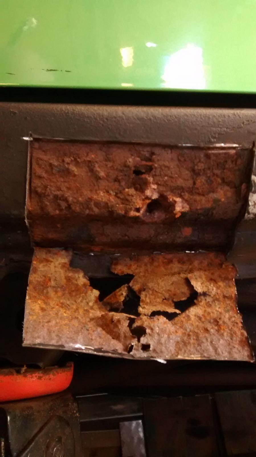

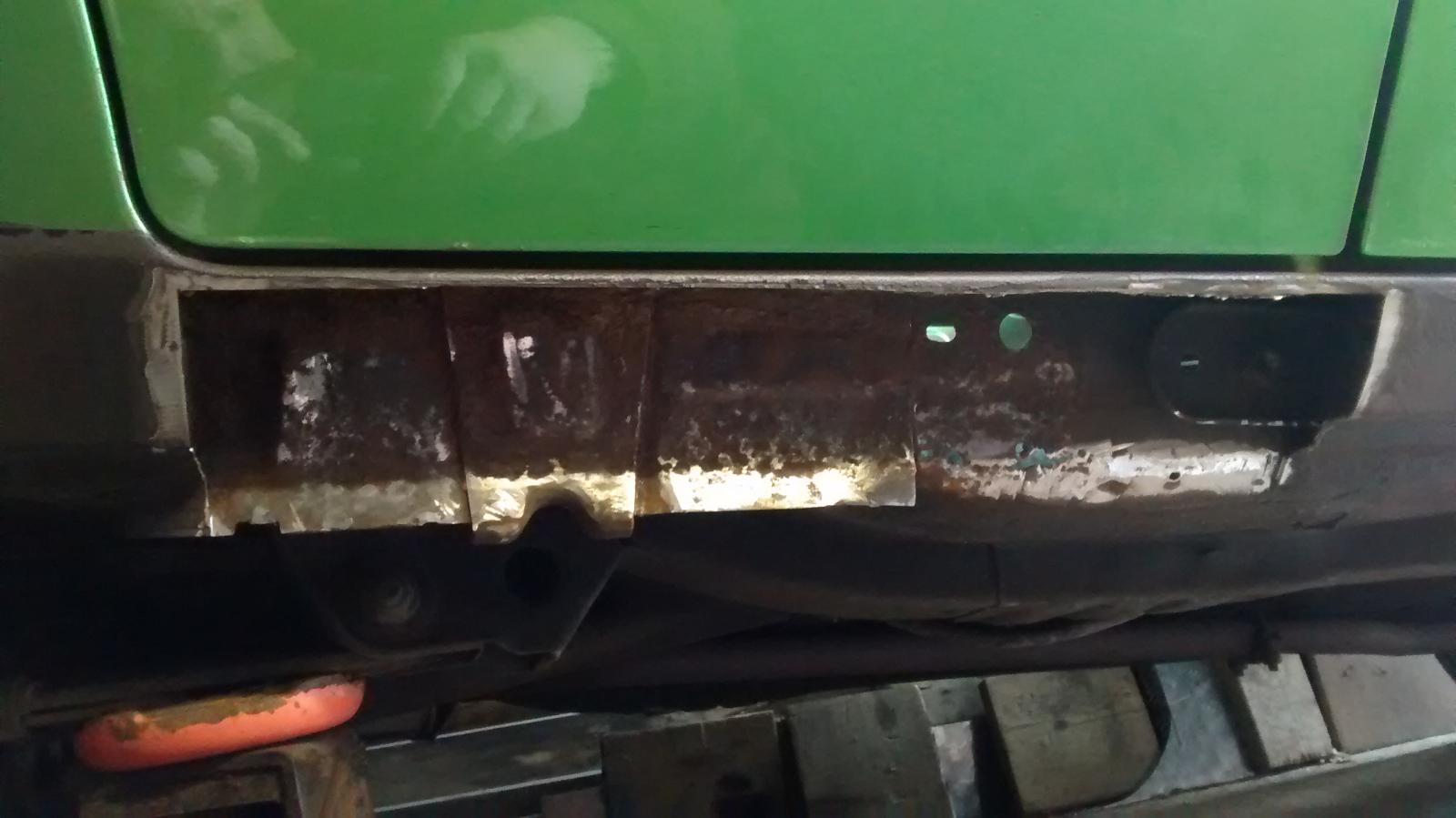

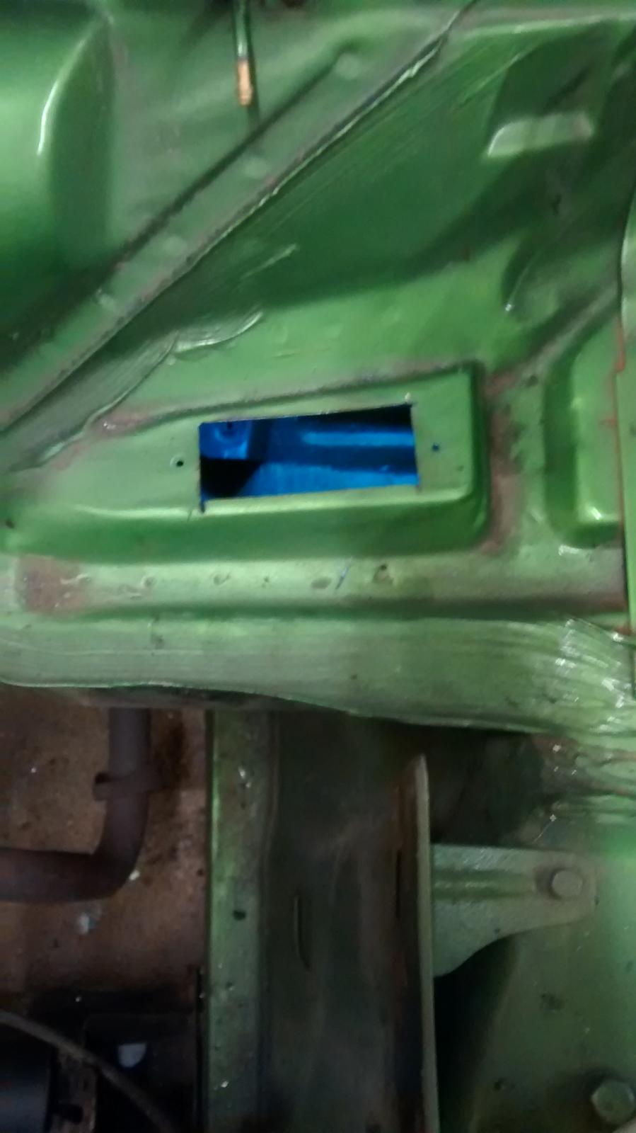

I noticed this hole on the sill so decided to cut it out and replace with new metal,
post-3747-0-18413700-1434747551_thumb.jpg post-3747-0-19772800-1434747582_thumb.jpg

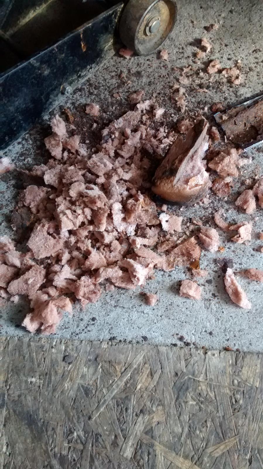

it was full of this old expanding foam so I had to scrape it all out as I suspect this is the cause of the rust,
post-3747-0-23551300-1434747606_thumb.jpg post-3747-0-68268200-1434747650_thumb.jpg

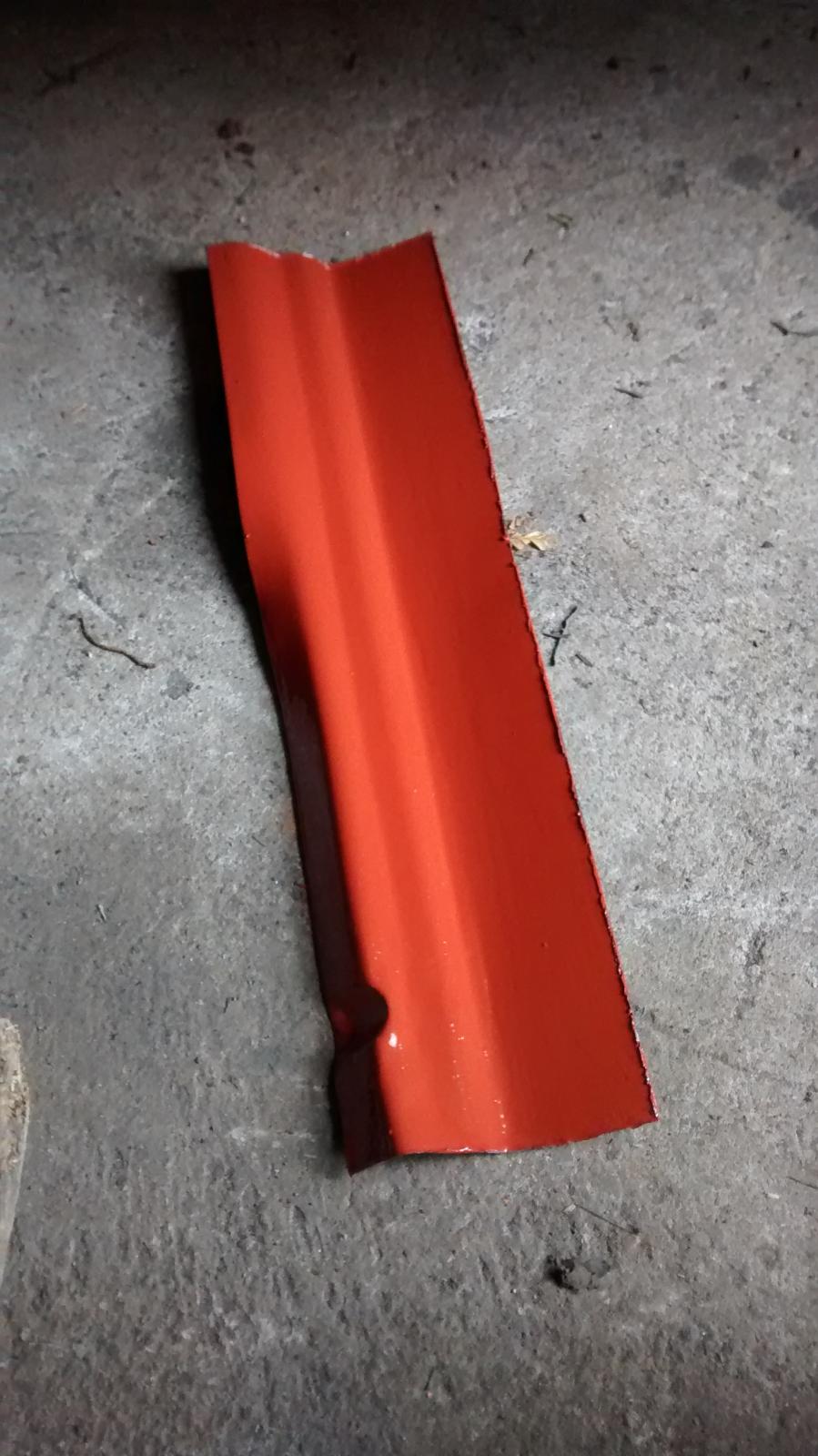

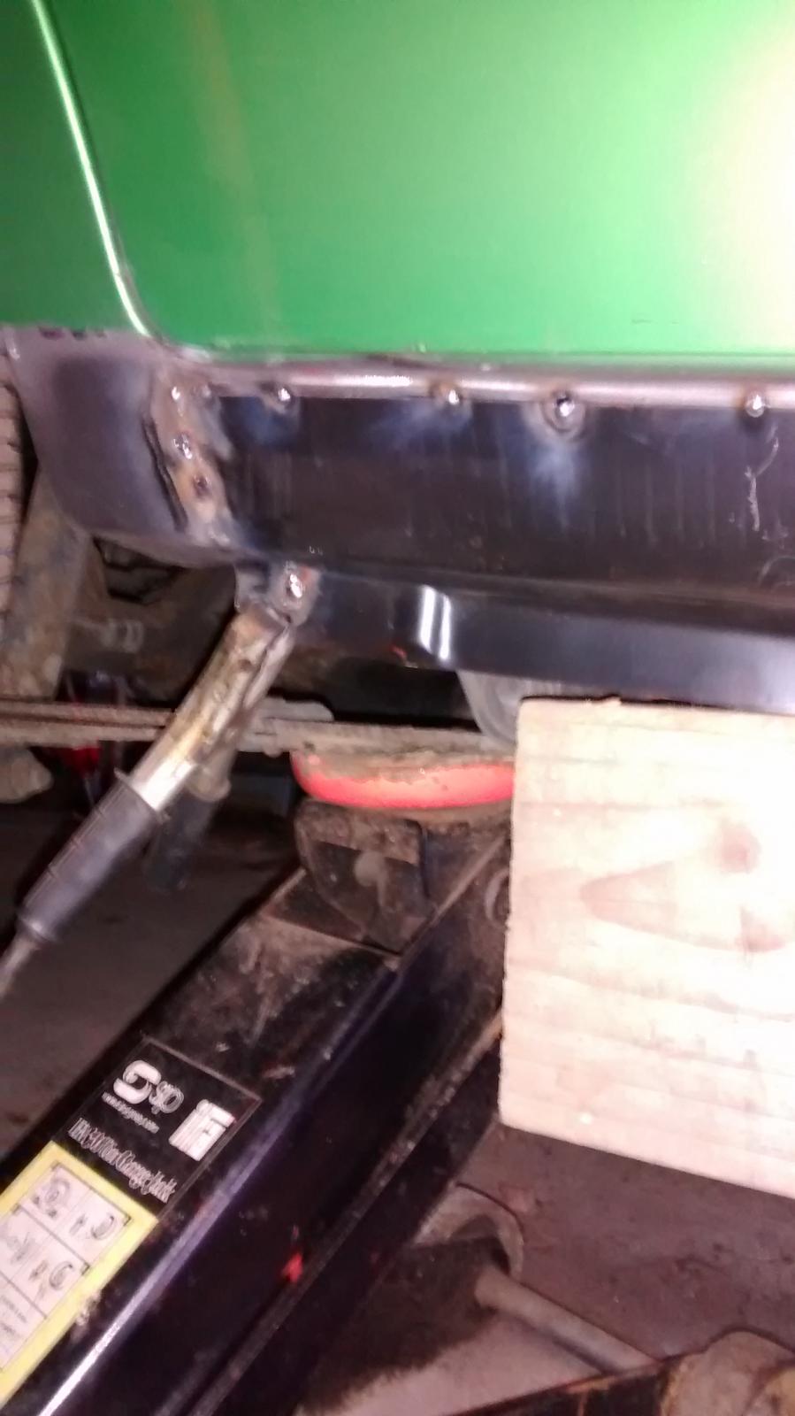

I cleaned it up with a wire brush on the grinder and gave it two coats of some proper old red oxide.
post-3747-0-72723500-1434747736_thumb.jpg post-3747-0-83503400-1434747847_thumb.jpg
cut up a full sill and used the back bit instead of removing good metal and welding for weldings sake.
post-3747-0-18098100-1434747868_thumb.jpg post-3747-0-09539700-1434747891_thumb.jpg
this hole in the sill was all that was stopping the bit of paper required from mr mot.

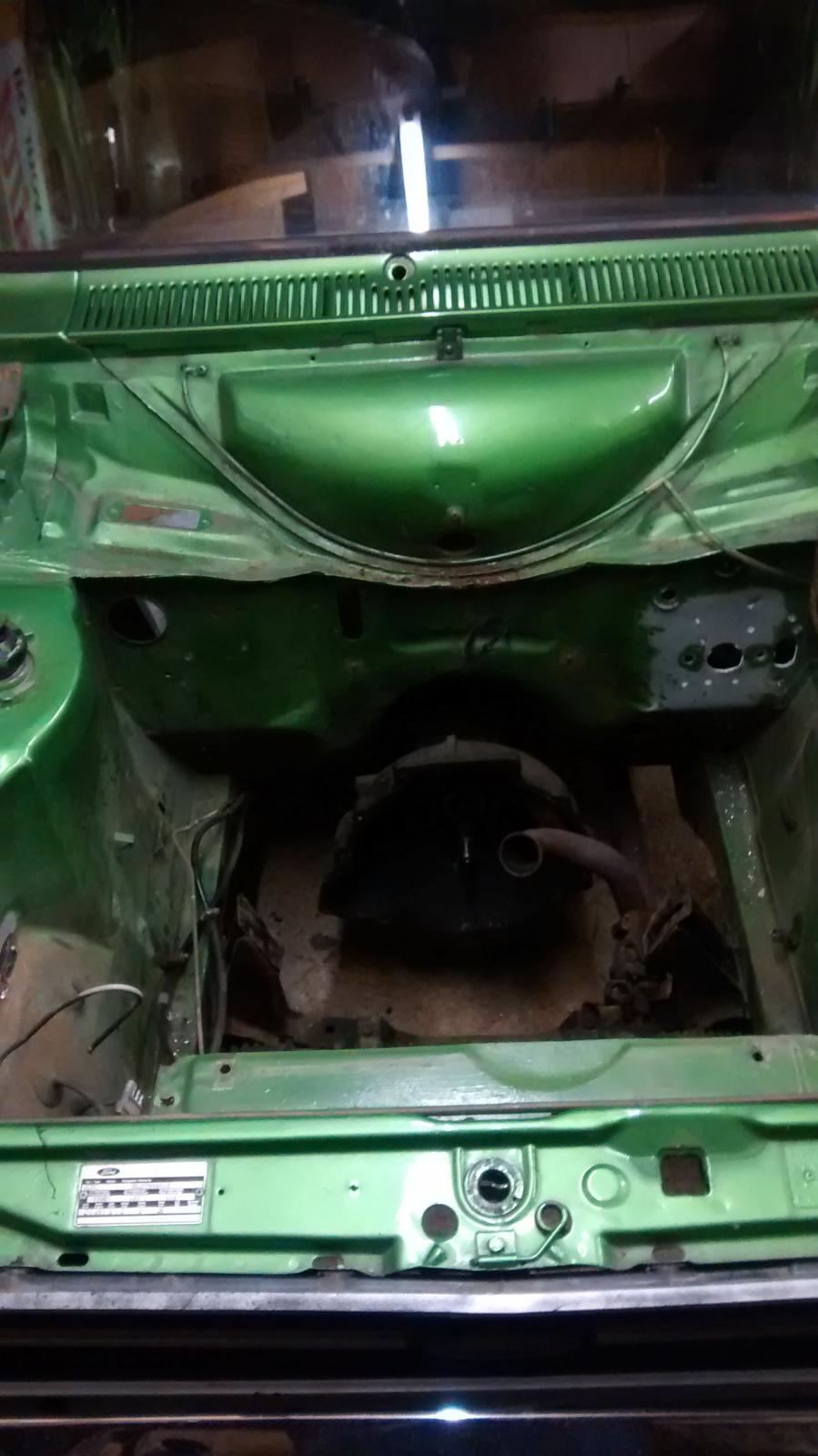

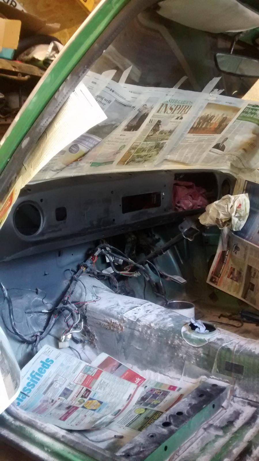

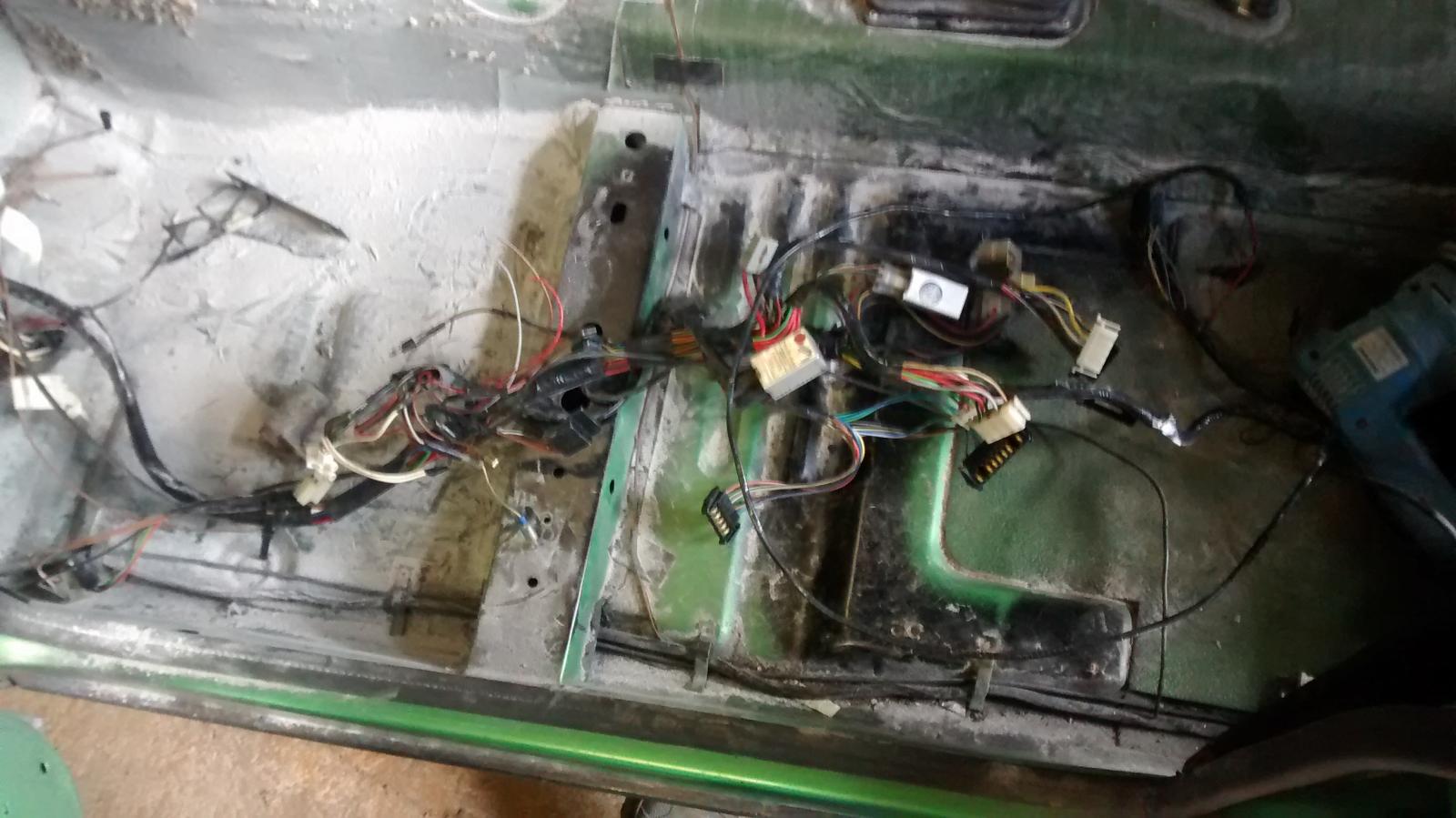

now that it was moted and paperwork in the post it was time to gut it and I drilled out the spot welds for the battery tray as it is on the wrong side,
post-3747-0-24705400-1434748802_thumb.jpg post-3747-0-72199800-1434748904_thumb.jpg

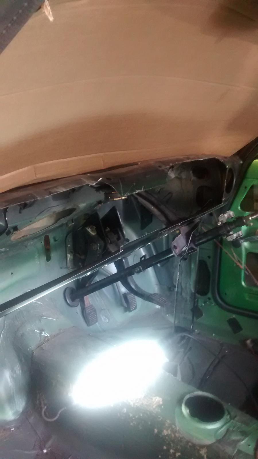

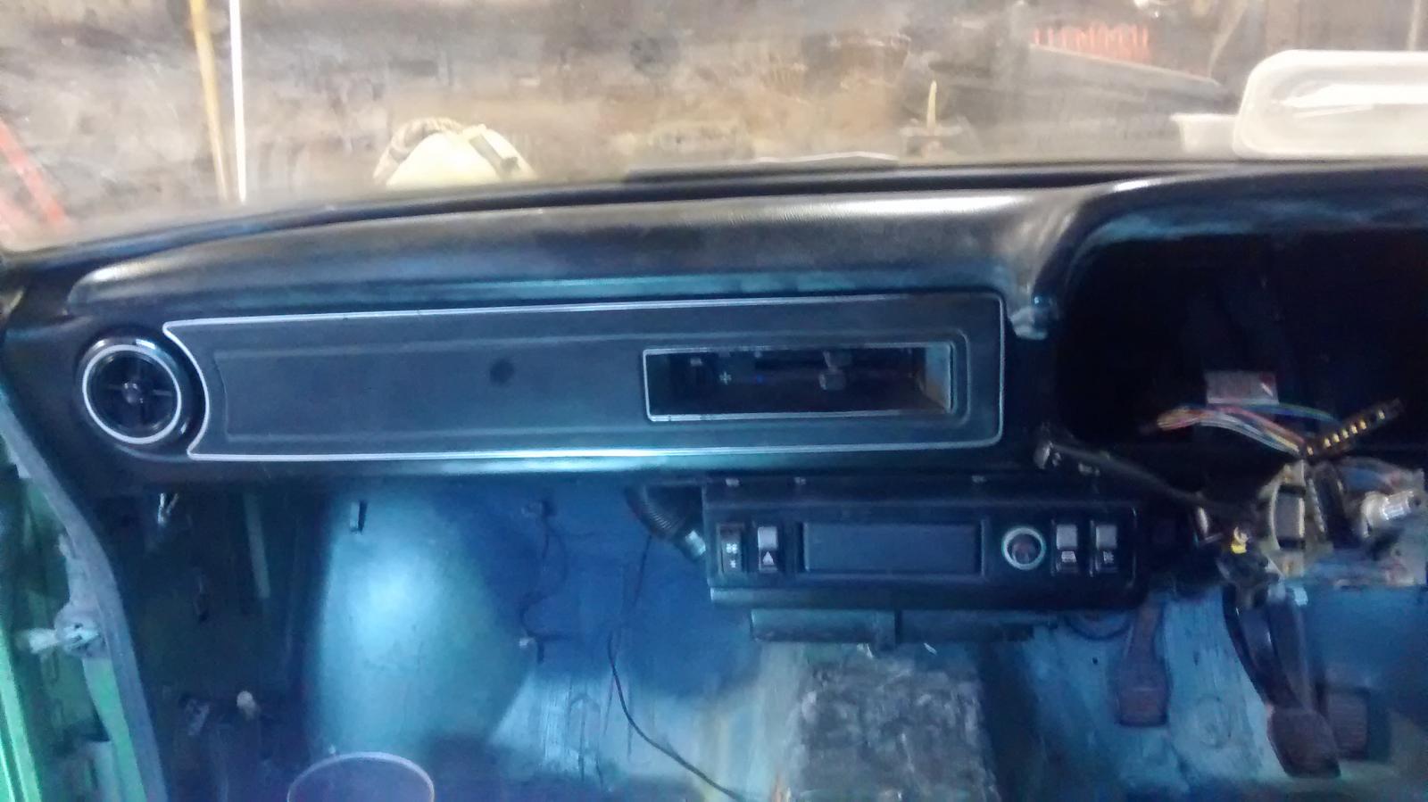

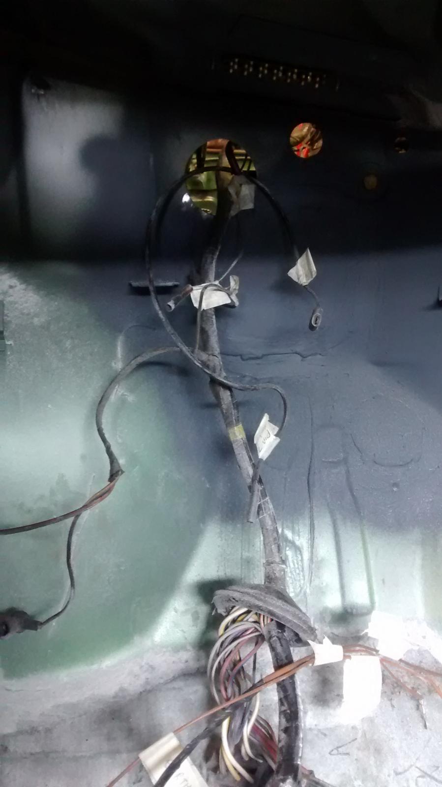

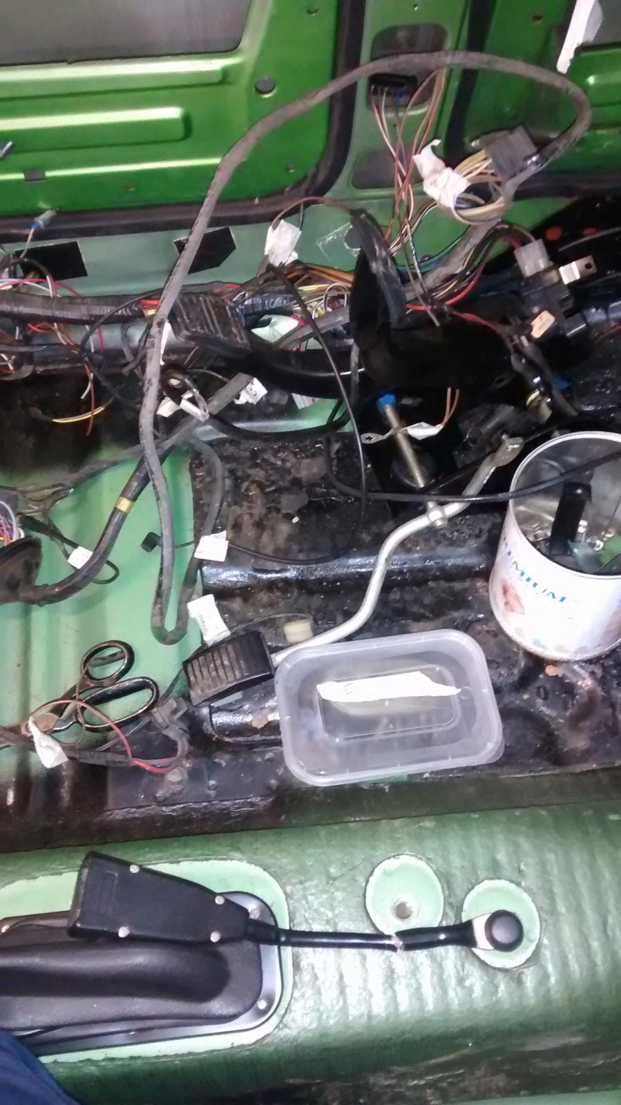

wiring loom marked up and removed, I couldn't find a right hand dash so time to set to it with the grinder.
post-3747-0-45959500-1434749008_thumb.jpg post-3747-0-09293900-1434749397_thumb.jpg

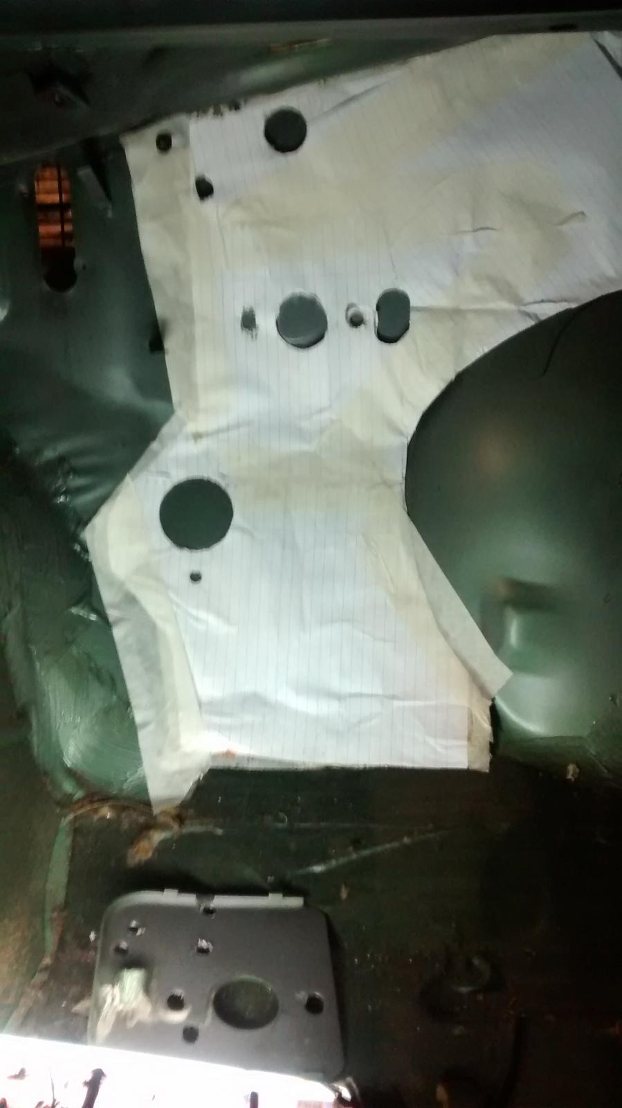

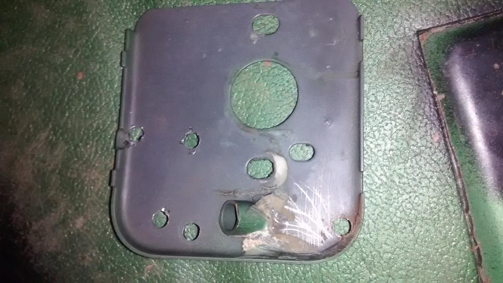

then I had to knock up a template to swap the holes from left to right and drill out the spot welds for the pedal box mount,
post-3747-0-97756700-1434749602_thumb.jpg post-3747-0-02929900-1434749649_thumb.jpg

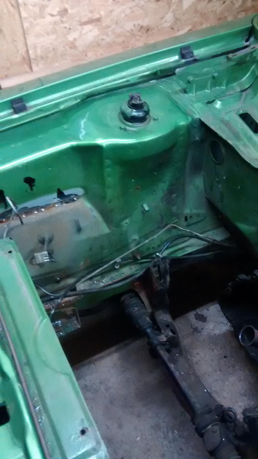

ford luckily placed the shaped indentations in the same place both sides to make life easier for me. then I stuck the template on back to front to mirror the holes.
post-3747-0-05769200-1434749860_thumb.jpg post-3747-0-98398000-1434750064_thumb.jpg

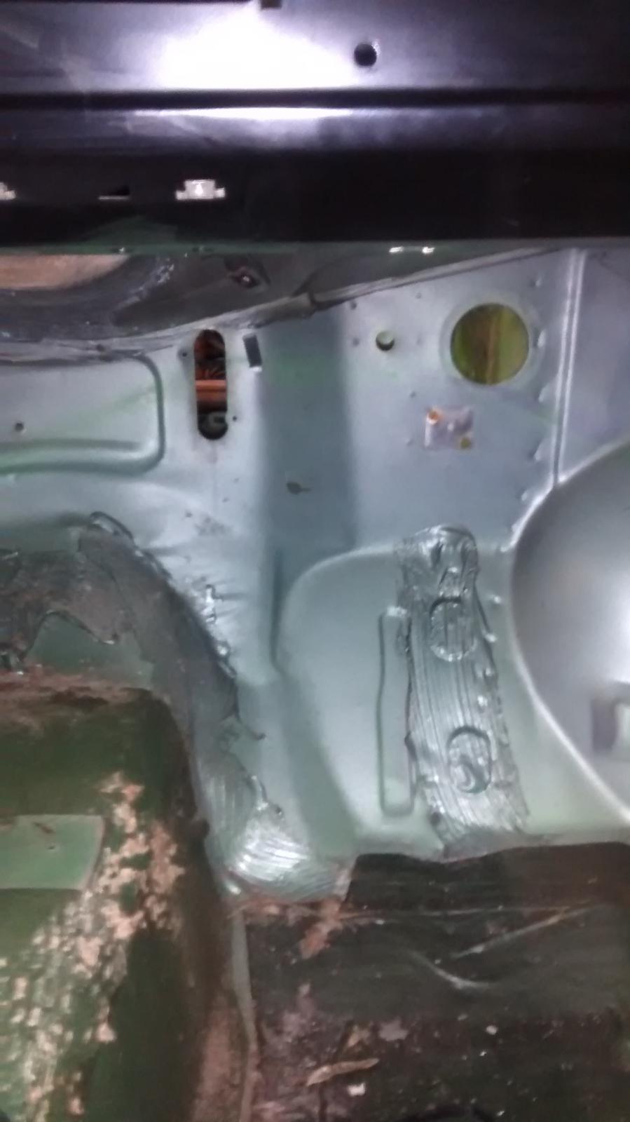

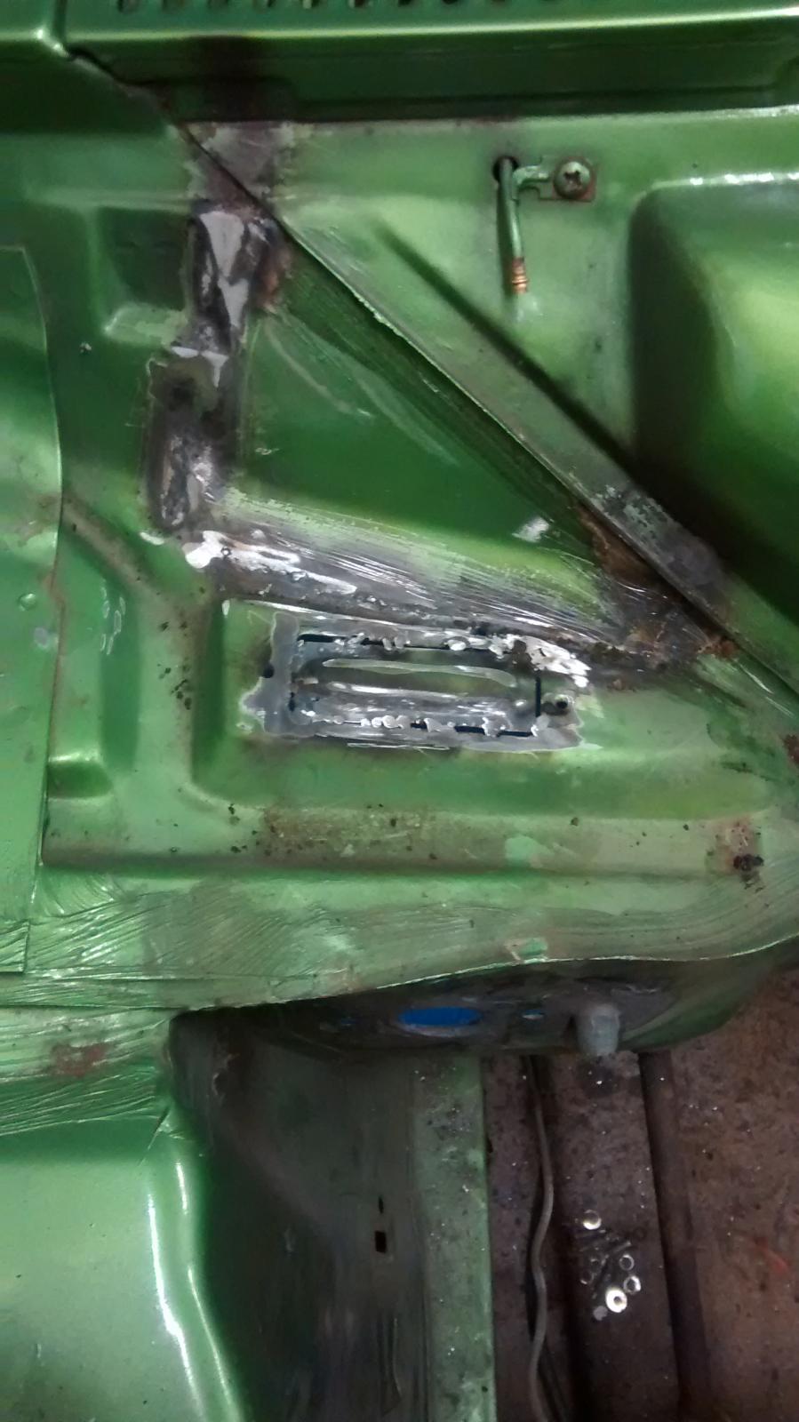

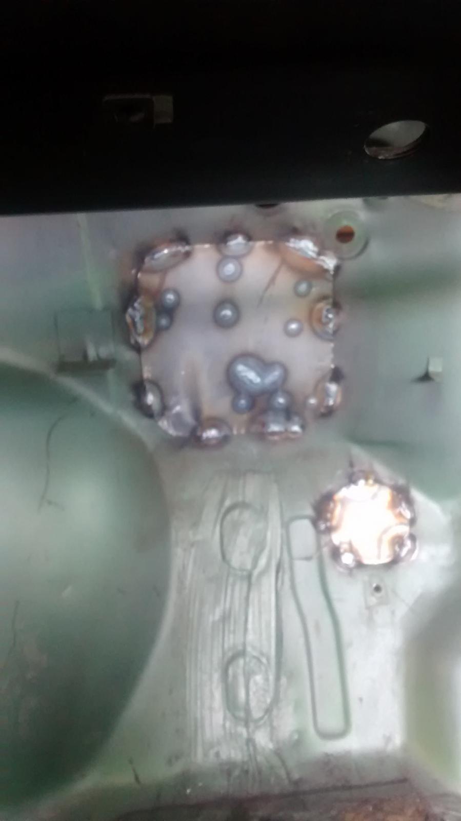

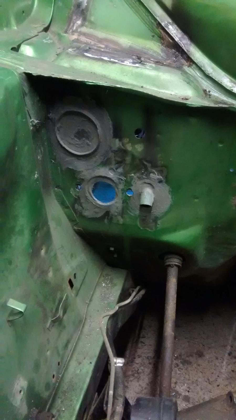

that left these holes so I simply plated over them and seem sealed round them.

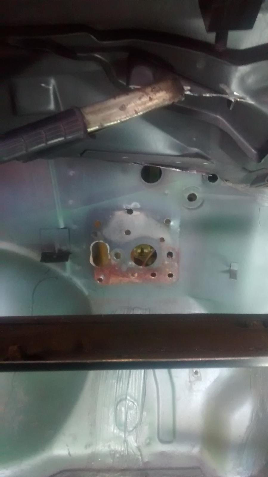

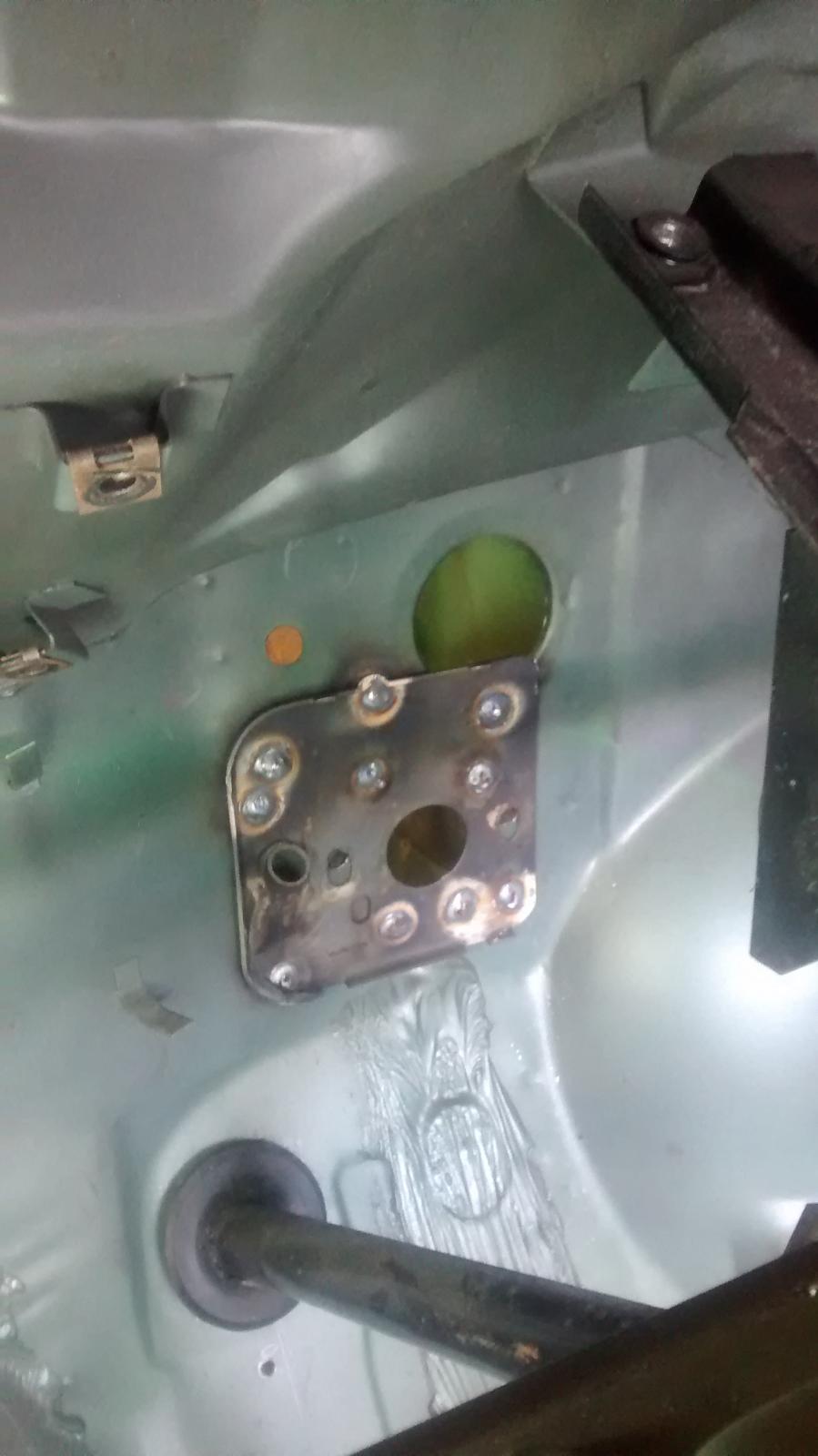

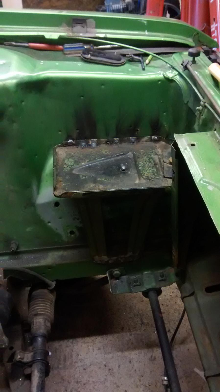

on the new drivers side I spot welded the pedal box mount into its new position.

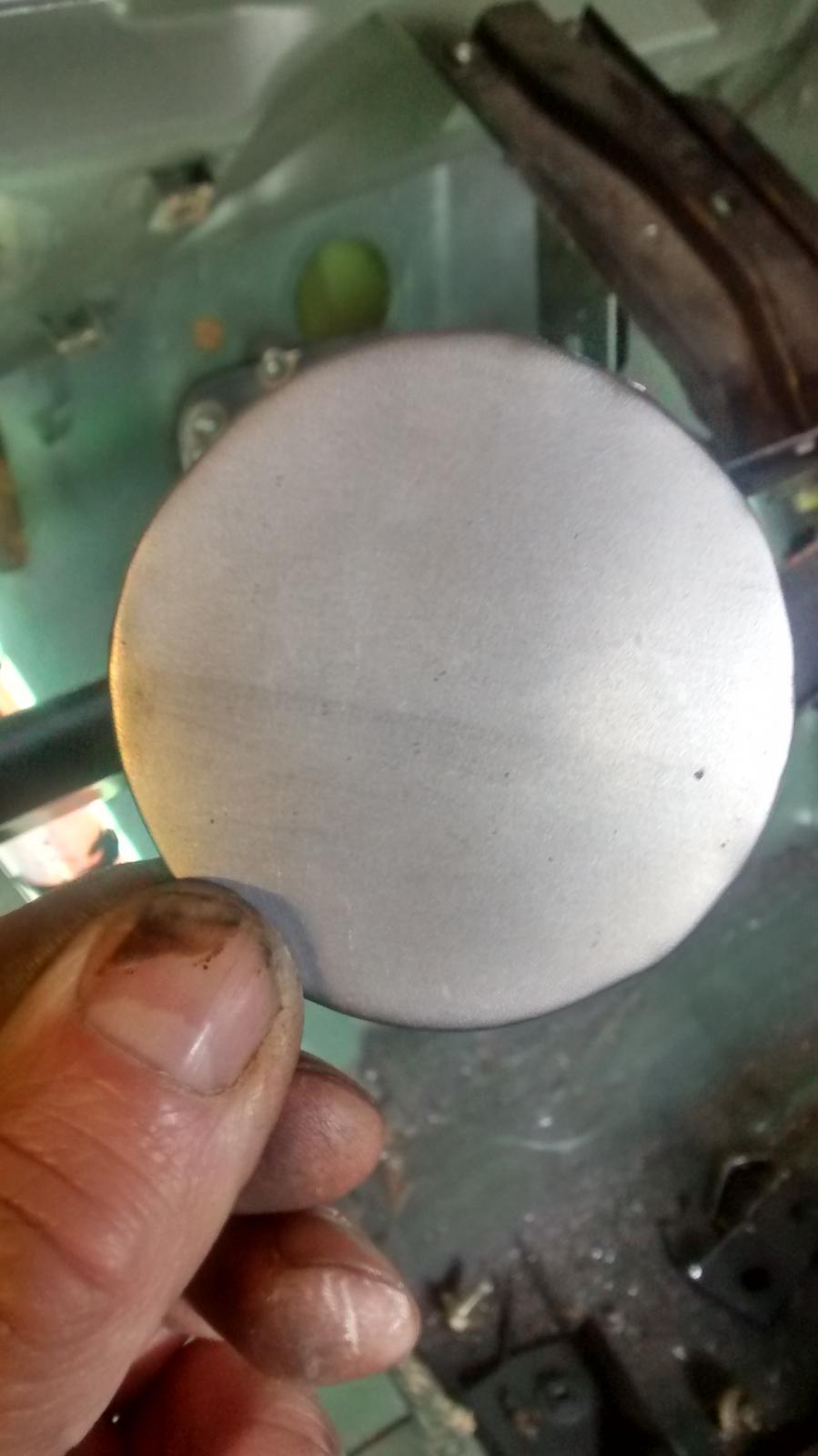

the old hole for the wiring loom was the exact same size as this spray tin lid which was lucky so I drew round it and chopped it out.
post-3747-0-66235600-1434752811_thumb.jpg post-3747-0-93034500-1434752835_thumb.jpgpost-3747-0-11184800-1434752864_thumb.jpg
welded in and seem sealed up

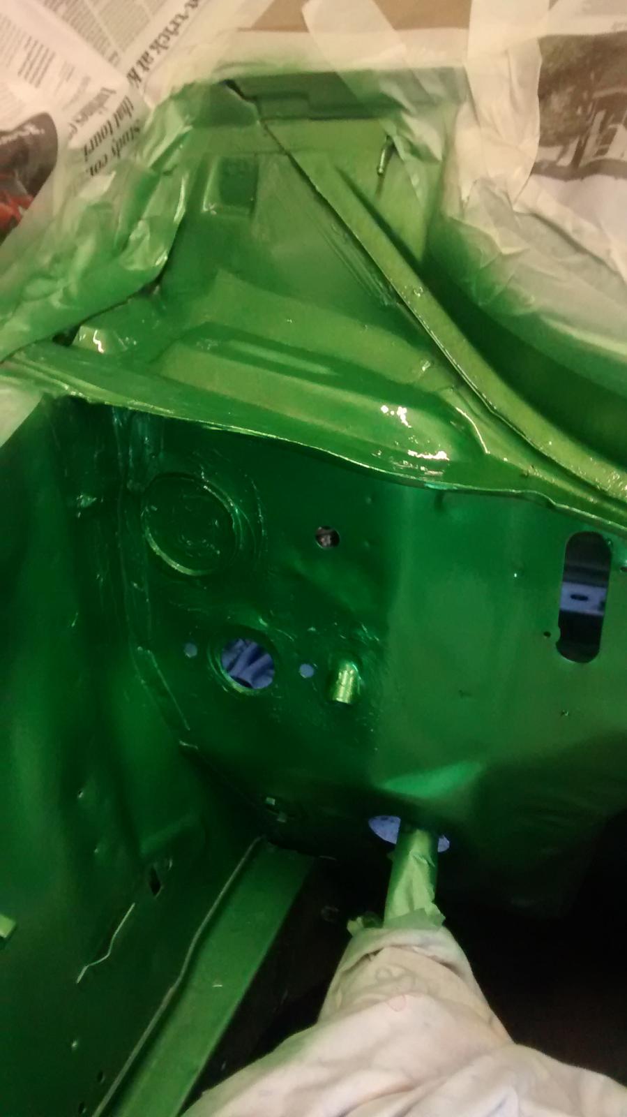

the fuse box had to be swapped from right to left as well.
then before paint the battery tray was spot welded into the now passenger side.

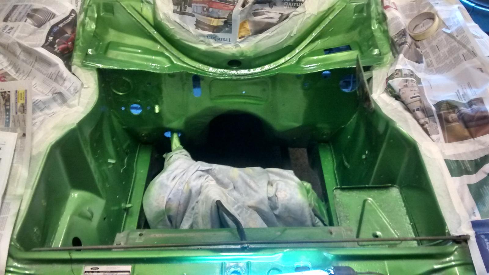

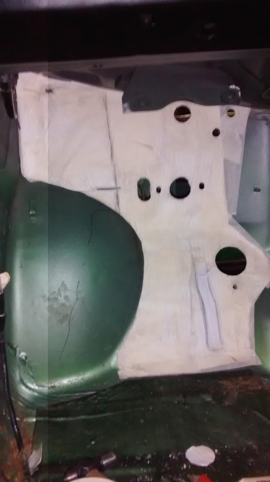

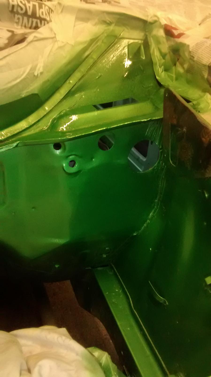

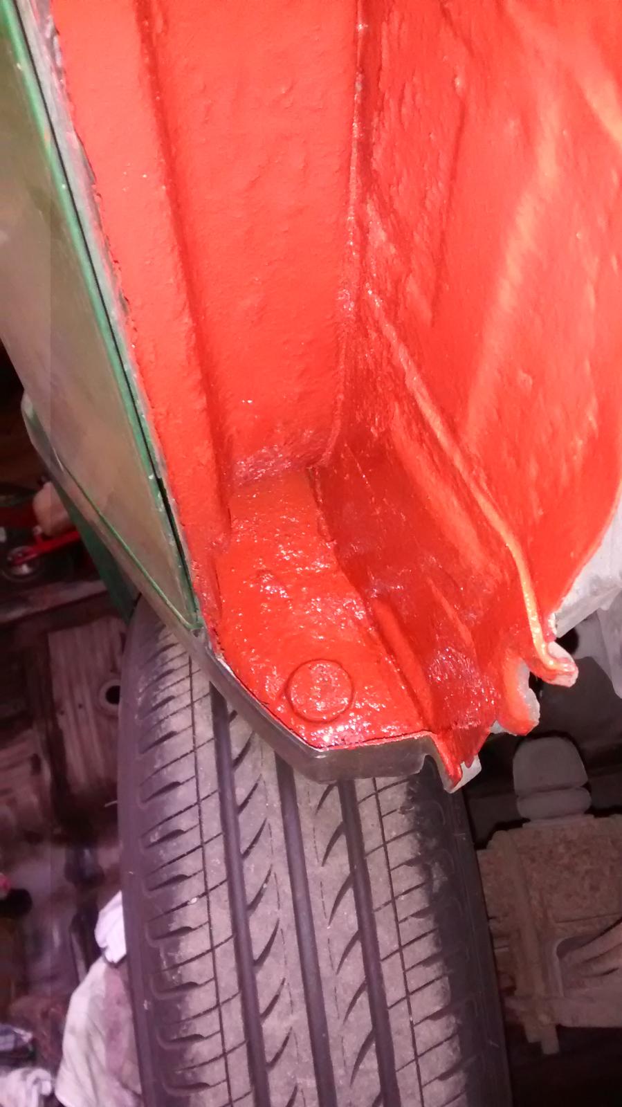

after some filler work I masked of the engine bay and readied for the rattle cans.
post-3747-0-97335800-1434753466_thumb.jpg post-3747-0-89442500-1434753491_thumb.jpg post-3747-0-24647400-1434753520_thumb.jpg

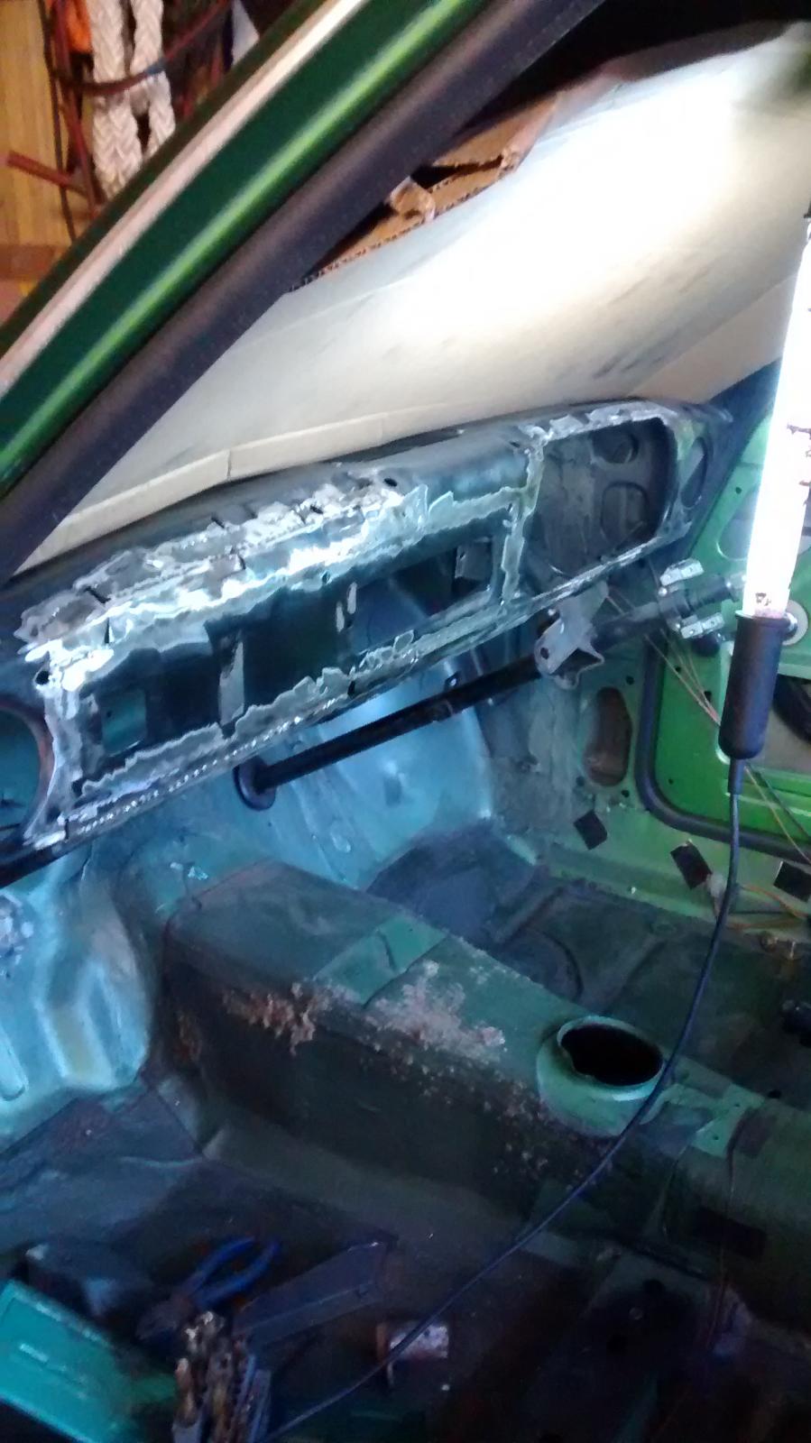

The dashboard was a bit of a challenge as panels are not available, what I did was cut out the clock binnacle then cut out the same shape from the other side, unfortunately the heater controls are not central so I also had to cut out the centre section and flip it over,
with much tinkering and spot welding this was the end result, then a light skim of filler and some satin black I was quite pleased with the end result.

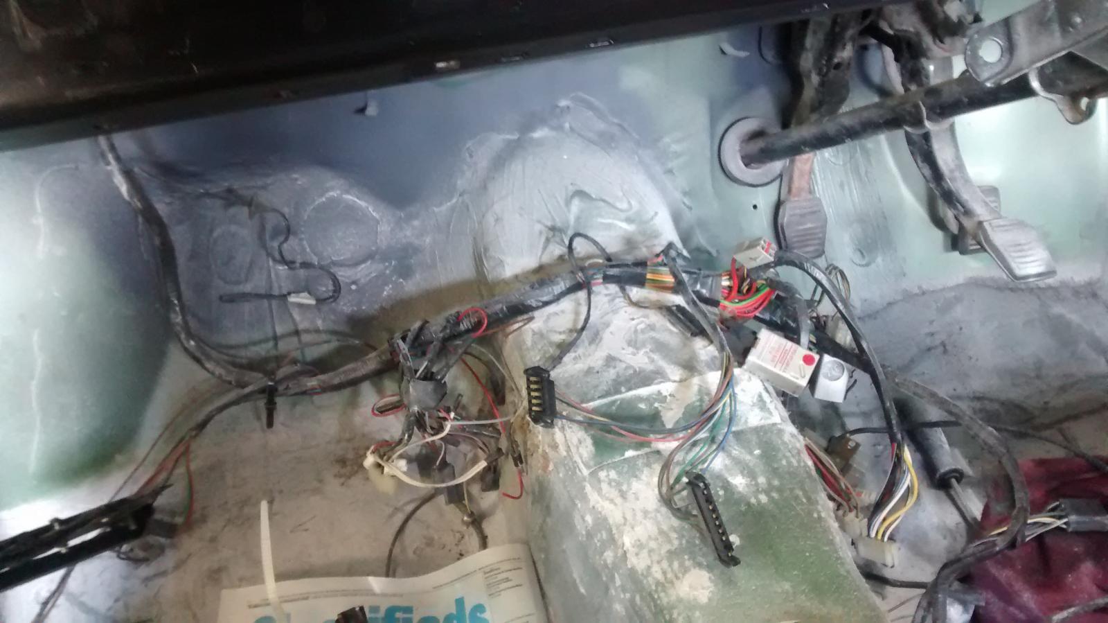

the wiring loom was then fed back under the dashboard by simply flipping it over so it was basically upside down and back to front.
post-3747-0-16805800-1434922668_thumb.jpgpost-3747-0-11842400-1434922712_thumb.jpgpost-3747-0-91565200-1434922375_thumb.jpg

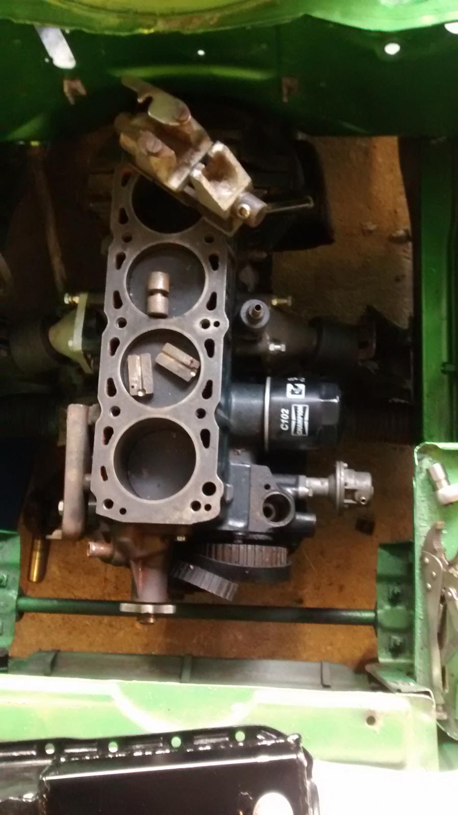

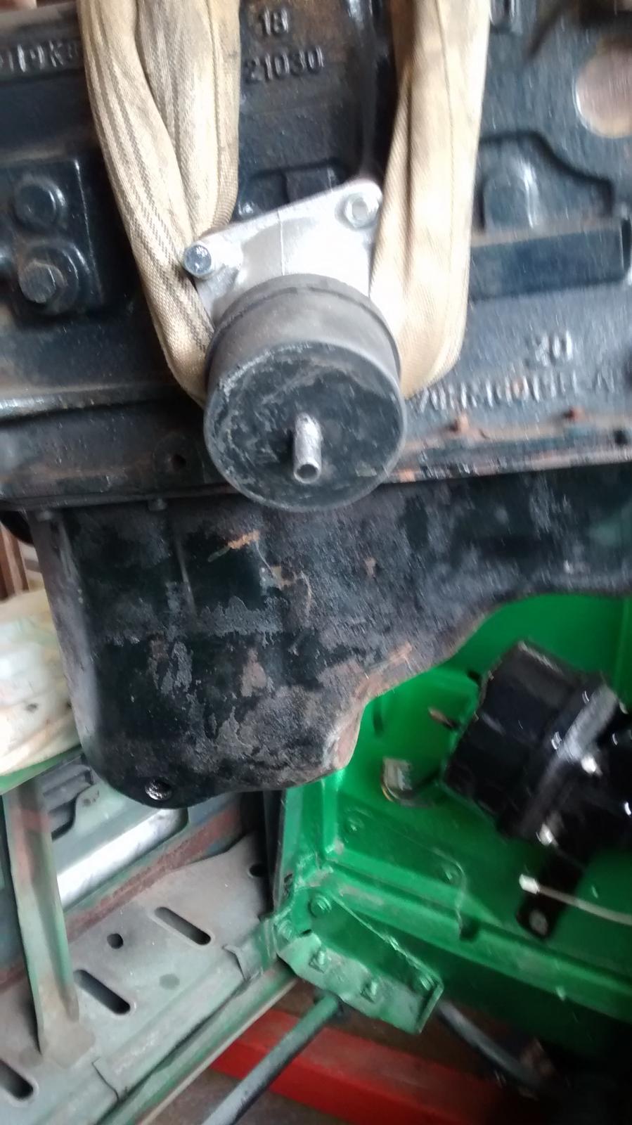

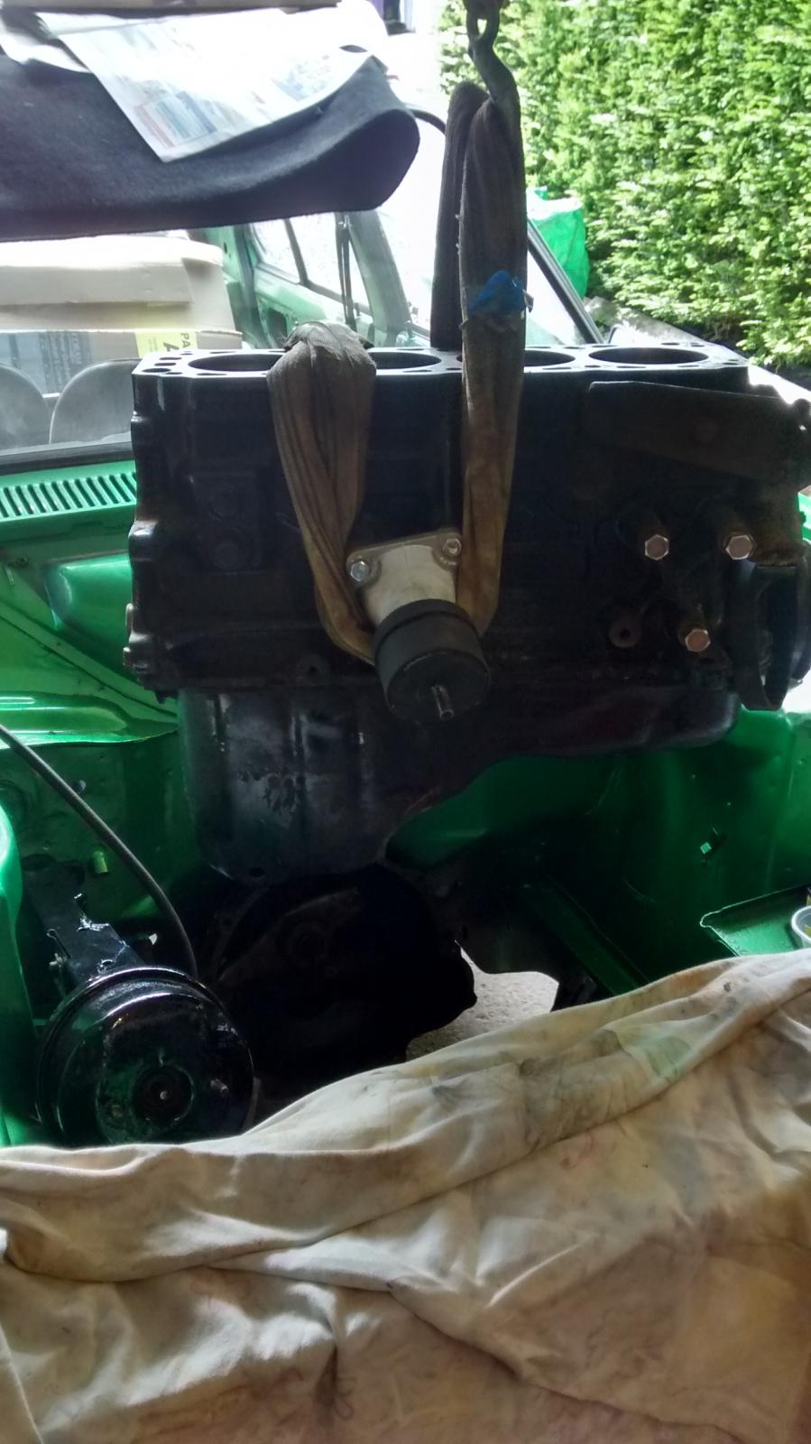

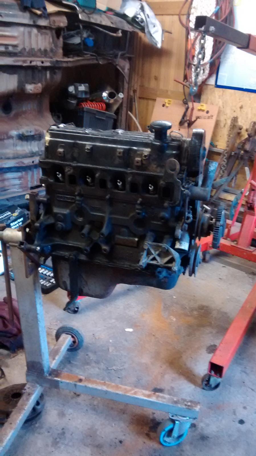

I then moved onto the engine fitting.
The engine of choice is the 2.0 pinto so a short motor was sourced through the bay of E then a complete engine surfaced so this was also collected along with a pair of heads, a gearbox due to starter motor being on the wrong side and also a tank for the audi.(will have to get back to that next)
I fitted the brake servo and then the engine bay was ready for the trial fit, thank god for hydraulics as these engines are a lot heavier than I remembered 24 years ago, the block was in and out half a dozen times to see exactly where the sump was fowling,
you can just see in the pics the dents in the sump after much hammer wielding,  (this is the sacrificial sump)
I left the engine in its hole then got on with making the brake pipes up while waiting for the correct sump to arrive.

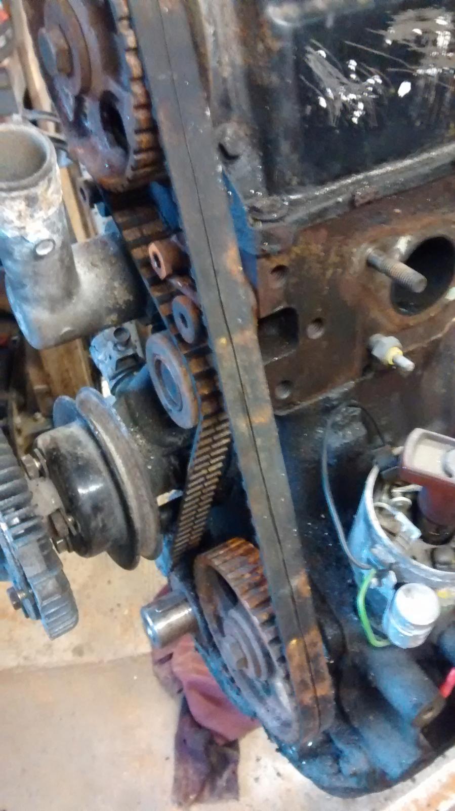

The complete engine is a runner so I stuck it on the stand to check it over and fit the cambelt and new sump.

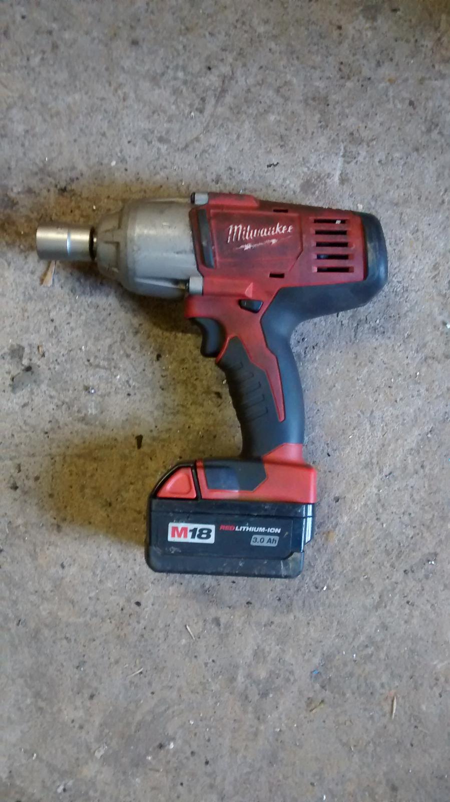

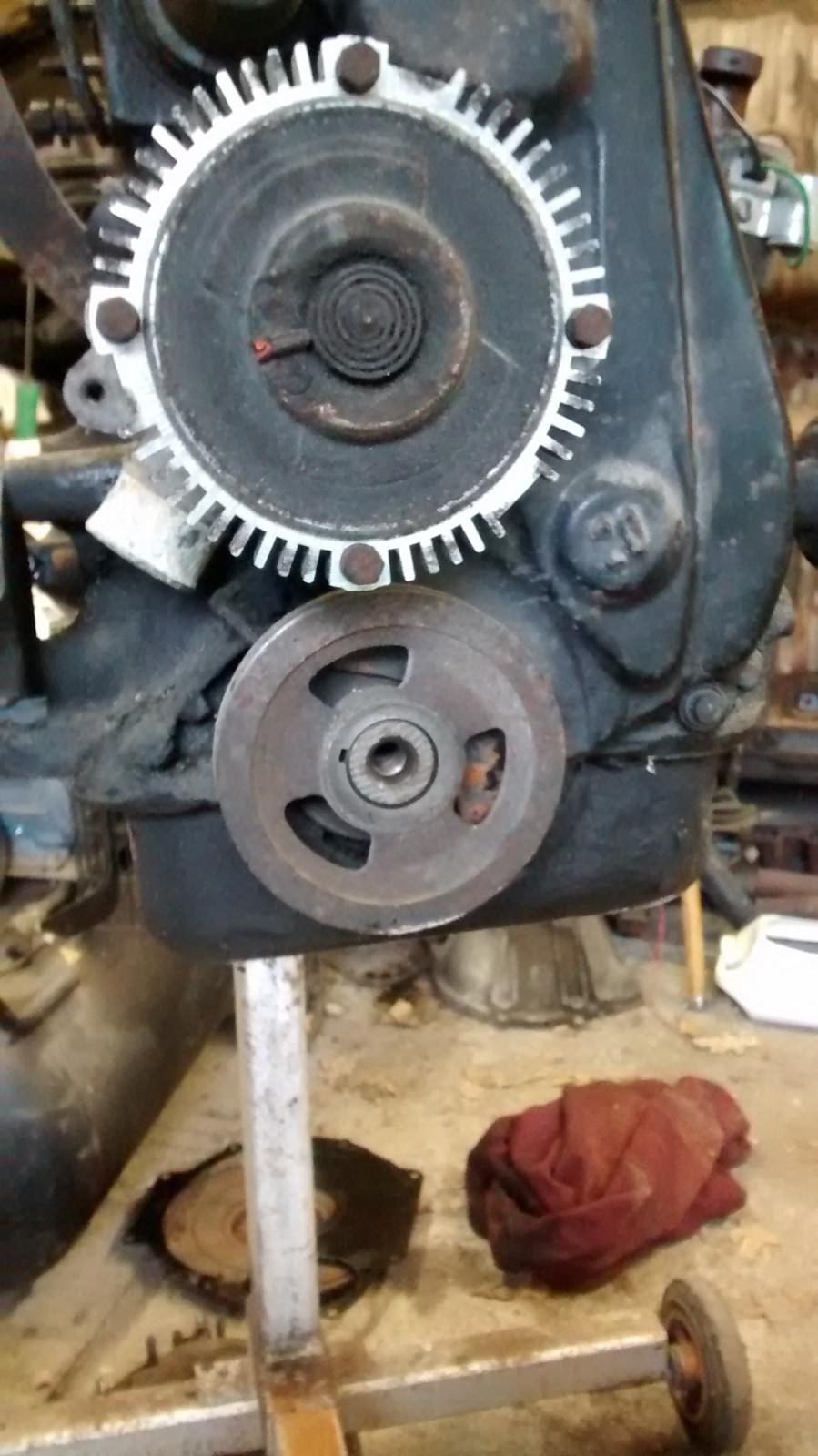

I tried absolutely everything to undo the crank pulley bolt and even the clark electric impact gun wouldn't look at it right then we had visitors pull into the drive so knocked it on the head.
While supping coffee and discussing the crank problem he pulled this out the boot and saved the day
after an hour or so I was free to get back to the job in hand and guess what I never had the right spline key to loosen the tensioner  Bollocks had to resort to the Subaru method,  Stanley knife right round the length of the belt then removed the outer half and slipped new belt half on, removed the last bit of the old belt and then pushed the new belt home, funnily enough the new belt is tighter than the old one so this should do to get it up and running before I get the right splined bit to check it.
post-3747-0-28927600-1434925166_thumb.jpgpost-3747-0-46113400-1434925199_thumb.jpgpost-3747-0-92339300-1434925227_thumb.jpg
