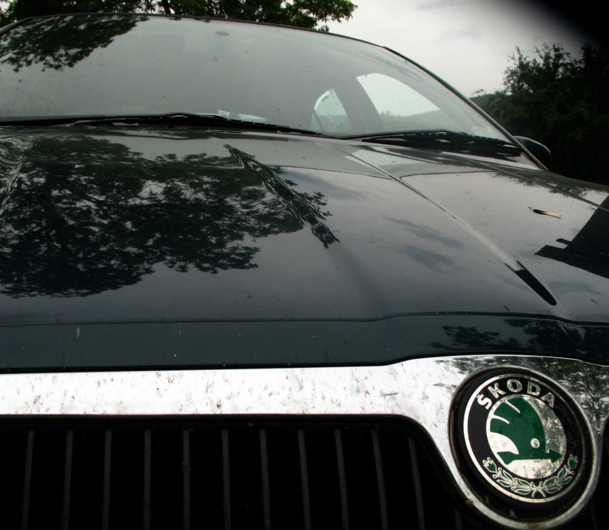

A big up to garbaldy for saving this shiter to do a bit more useful work. Octavia is earning its keep, proving 90s cars are a good combination of simplicity, reliability and practicality - if a little soul-less, as this bottle green thing is. No collection pics - it was an evening dash up the A1, turn left into the beautiful Scottish Borders and a good chat with mr garbaldy in the 10pm broad daylight, 30 litres of used veg tipped into the tank and a tedious hum back to Yorkshire with what seemed like 100 miles at 50mph through roadworks, to protect the workforce who were all in bed.

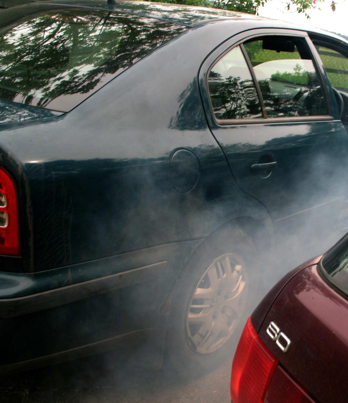

Annoyingly, the headlamps went out every time the electronics were rebooted so I soon learned how to pulse the power in 4 second fits in order to cruise at a sensible speed. Reconnecting the temperature sensor stopped the glow plug relay from clicking on and off in a state of confusion and made every dial fully operational. As I'd been promised, the brakes were iffy, limp mode cut in when you squeezed the loud pedal in fourth or fifth and once onto North Yorkshire's finest trunk roads the off-side front damper lost what oil remained. Modern rising rate springs which are on the stiff side turn out to be surprisingly good at resisting the urge to bounce a car off the road, when the shocker has totally gone.
Cursing the complication of the variable turbos fitted to newer shite like this 2000 year Skoda, I read up and found that a couple of hours soaking in Mr Muscle foam usually rids them off their stickiness - which forces the ECU into its limping safety mode (max speed 75-80). It involved undoing two nuts/bolts on the EGR pipe which on this car looked very rusty so I dabbed some veg oil and coppaslip and left it for a fortnight to soak. In that time, my style of driving seems to have improved matters no end and limp mode is now a rare occurrence - yippee! I suppose I should blank off the EGR, but this car is a tool to see me through a period of ridiculous poverty, so I'll continue to make it breathe its own veg gases out of sheer bloody-mindedness. Hesistant and smoky starts from cold suggest the timing's a little out or compression's a little down on one cylinder - must take to a man with a poota and interface cable - but it does help remind you it is an oil-burner, sounding a little like a Class 37 on a winter's morning. Lack of glowplugs never helps with veg, switching them on by re-disconnecting the ETS improves matters but is a proper hassle - this can be programmed via VAGCOM, I think.

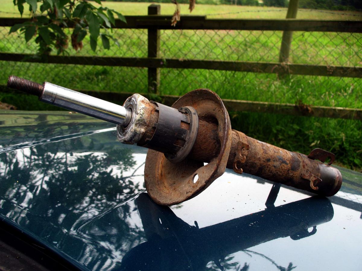

With no structural rot, four newish tyres, a recent test, recent service, new front pads, glow plugs, an air mass meter, new cambelt in 2013, front springs and no doubt all the other stuff a car with over 200k will have had, it's an indicator of how crazy our system has become that it was on its way to the scrapper. The leaking damper was caused by a lazy mechanic - the shaft had been badly scored with mole grips, he obviously couldn't be arsed to fish out an allen socket to stop it turning. But he had copper greased the pinch bolt, expecting it to be coming out again. A pair of good s/h ones a mate fished out of his shed now makes it ride and handle as it should.
There's so much room in the back I managed to fit in a couple of 205 litre barrels without a squeeze, it's averaging 54mpg according to the computer running on waste veg/misfuel (and is driven actively in hilly country), handles and rides perfectly well and even the brakes work properly now the front discs have been cleaned up - again, that lazy-arsed mechanic. When your back's against the wall, cash-wise, you really don't mind boringly good cars -  even if only three windows work, one rear door handle needs looking at and the radio's off. I hate the sad drone of most straight four engines, so must sort out a radio.
Junk like this needs saving so we all have shite to wank over in the year 2028.
Well done, economy motoring at it's finest* !

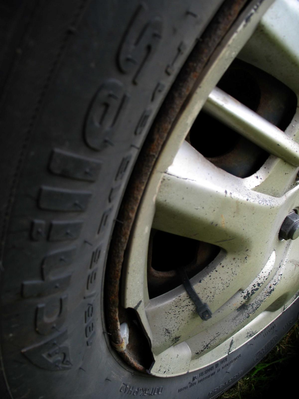

Must put those 'Achilles' Chinese tyres on the front - they're a little loose on the rear. What a perfect name for Chinese tyres!

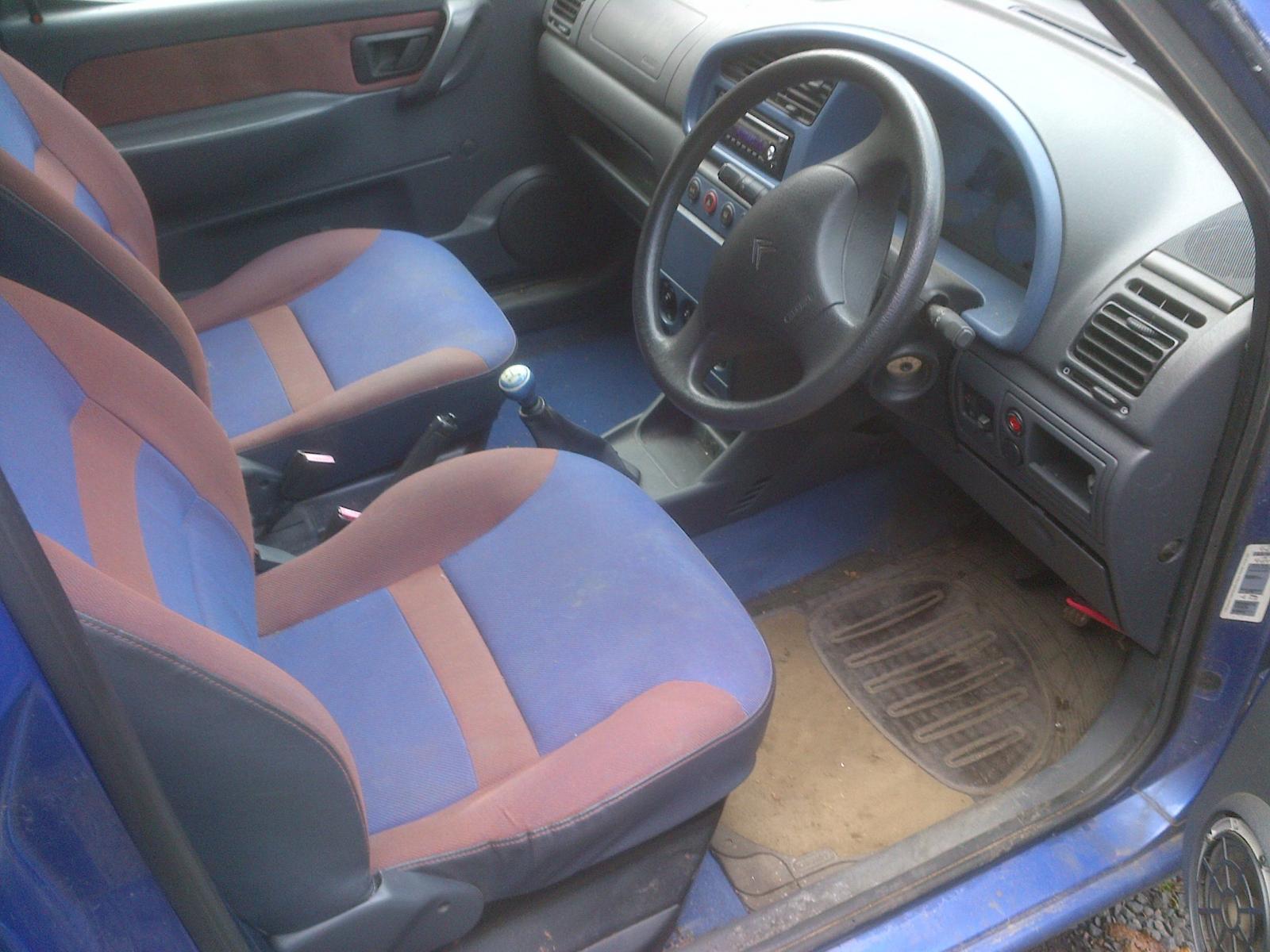

Well not sure if I've done the right thing here but I have bought it, will collect and take pics tonight for your viewing pleasure.
I shall follow with interest. Can't quite decide if a Bertilingo is the ideal vehicle or not. My f-i-l likes his. I'd like an early 3-door with the folding roof.

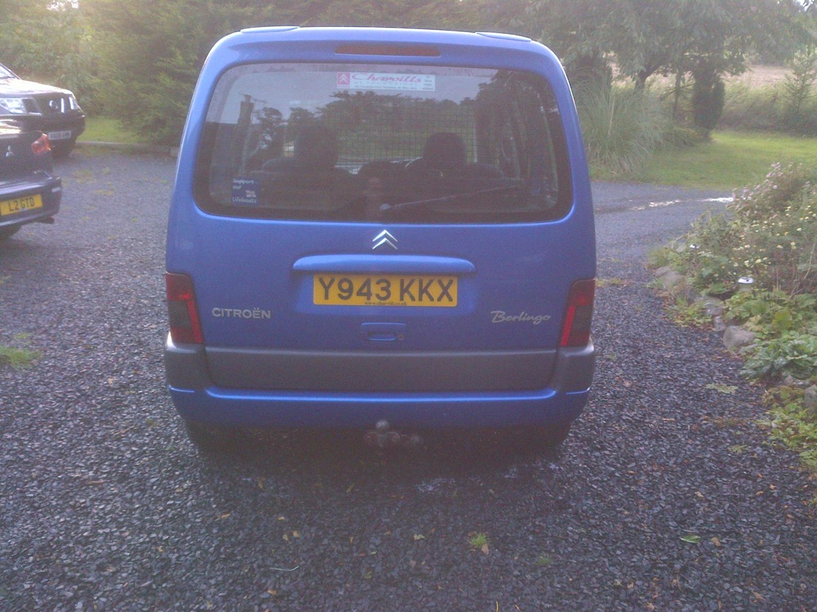

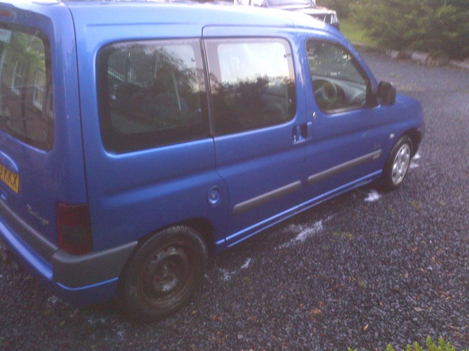

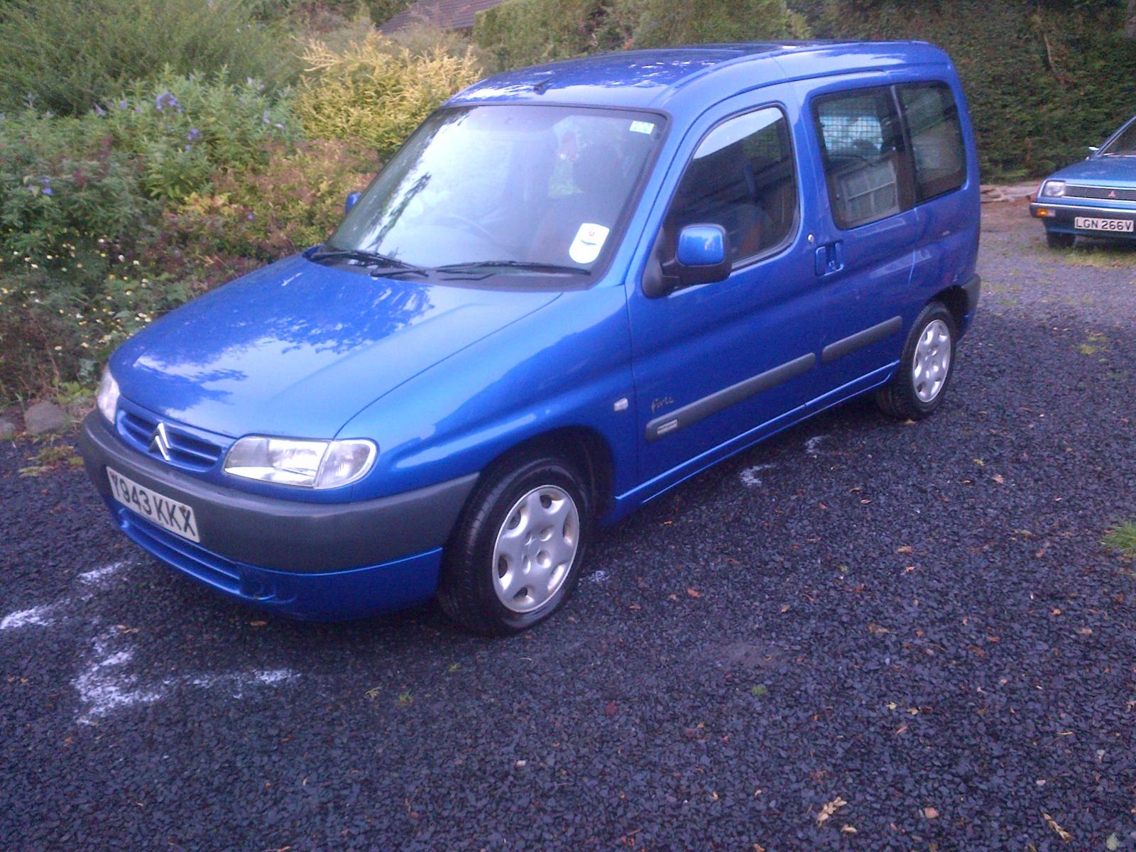

Well I jumped on the week in A&E fired up the two smoke powerhouse and buzzed down to collect this new purchase,
paper was swapped two smoker was dumped in the back and I was back home within 20 minutes :-D

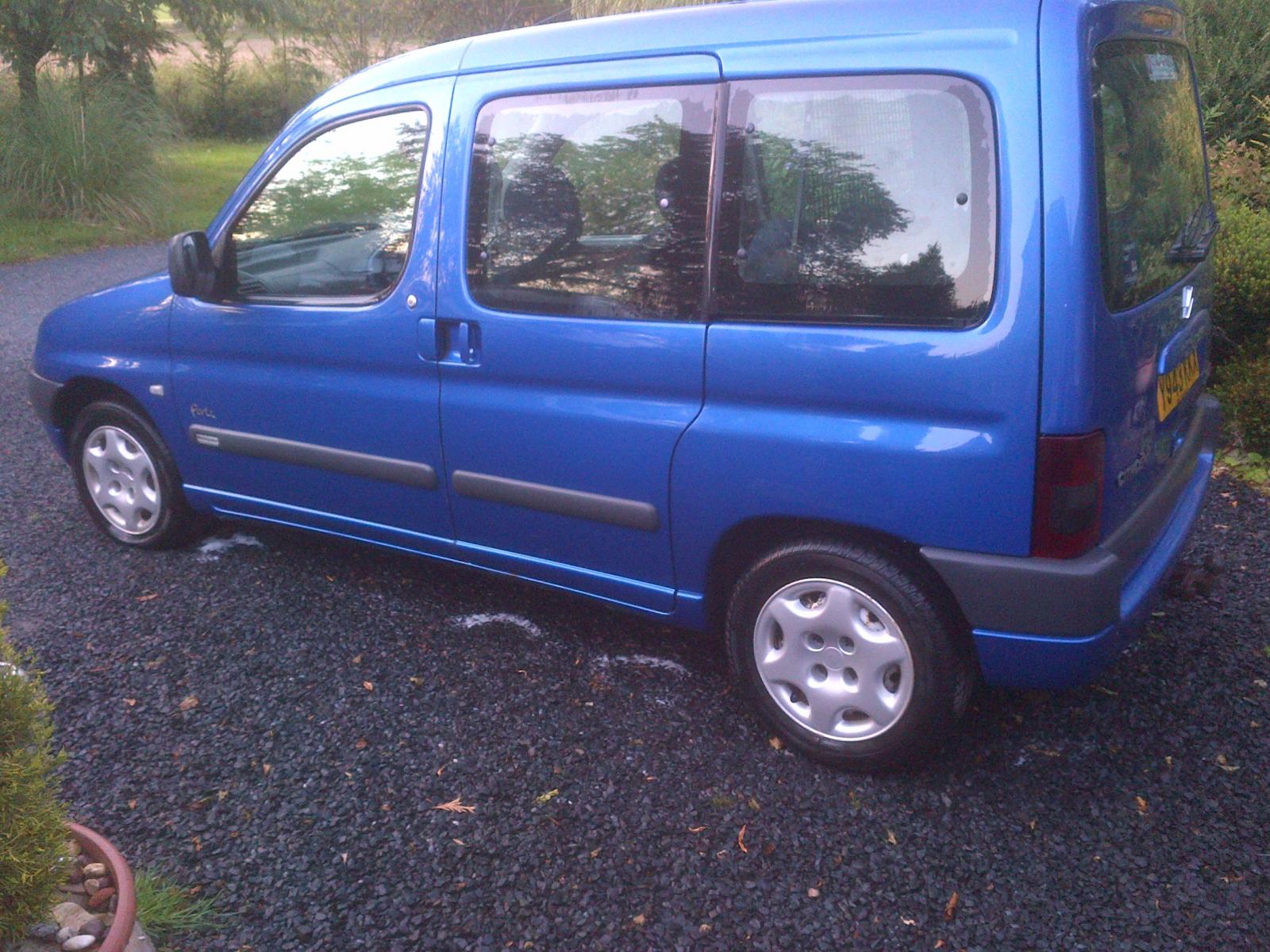

so here it is in all its French glory and after a quick wash to remove the patina (moss)
wheel trim is in the back along with the spare and a new tyre.

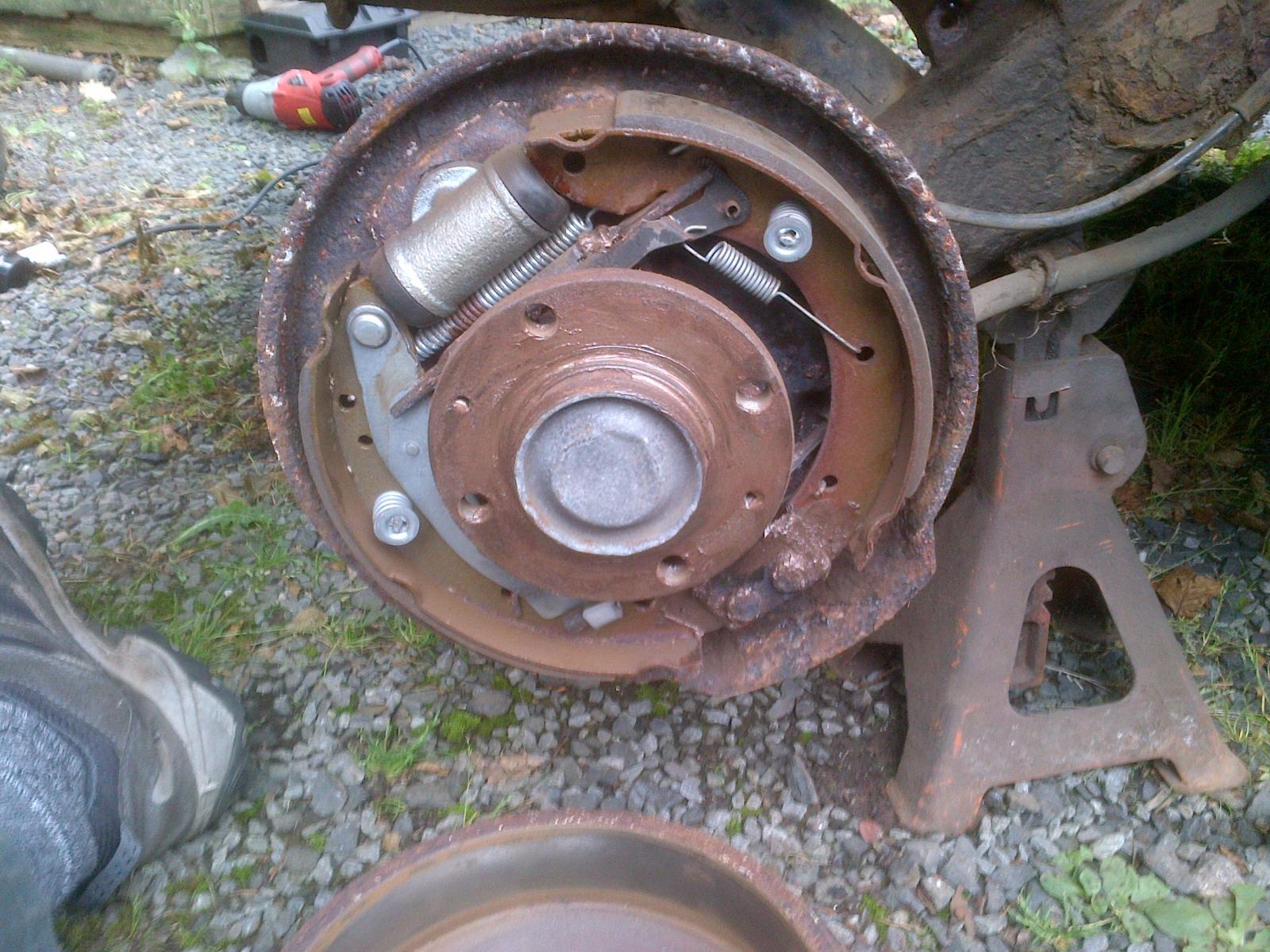

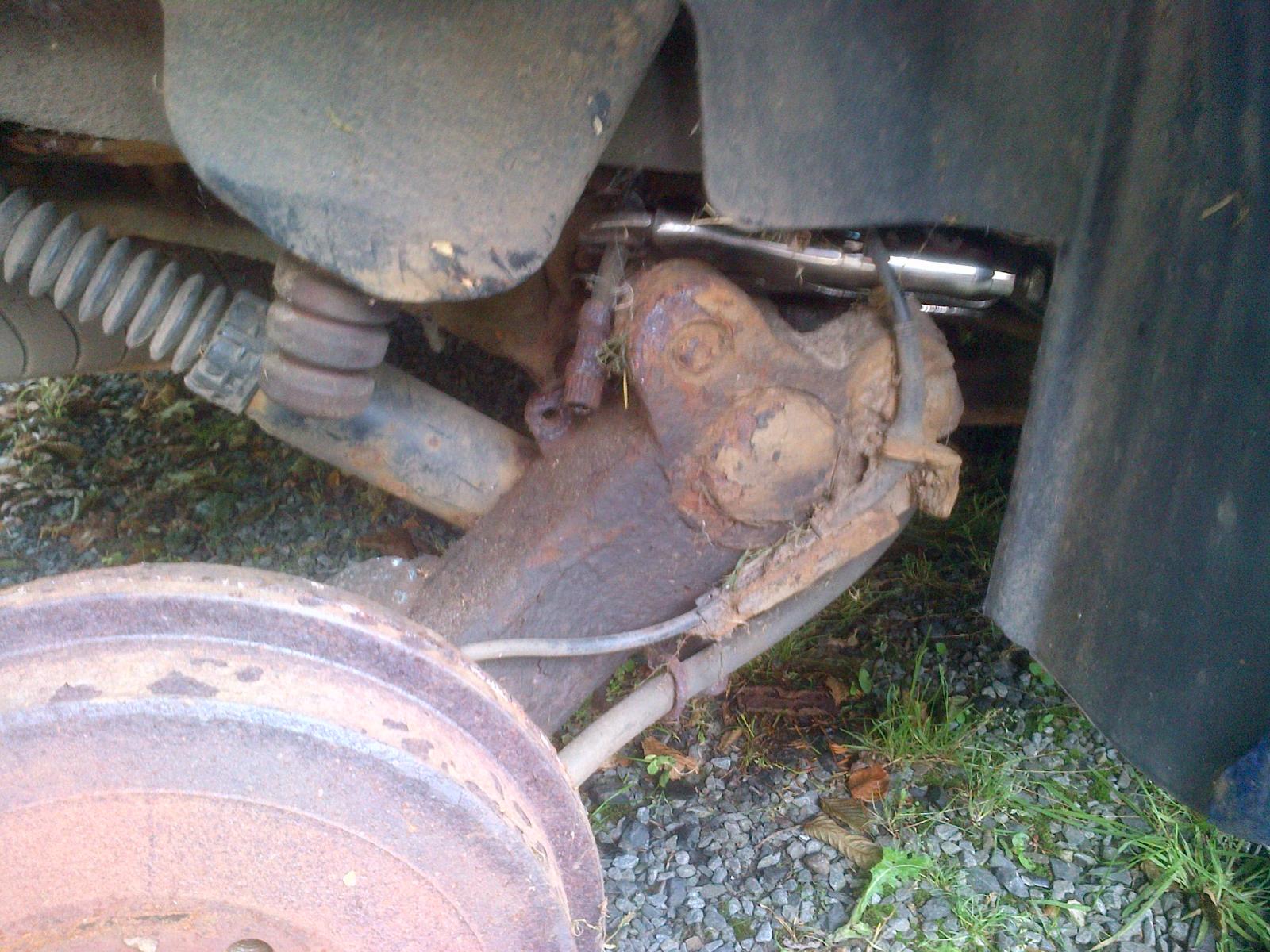

Well I decided to investigate the lack of braking power and to my surprise I found this to be the cause. anyone spot the problem?
so I popped the wheel of and bonus free mole grips
so I made up a new length of brake pipe and one new wheel cylinder later and blingo the brakes work spot on,
once finished then I checked the other side and it too had rusty brake pipes so I made up another.

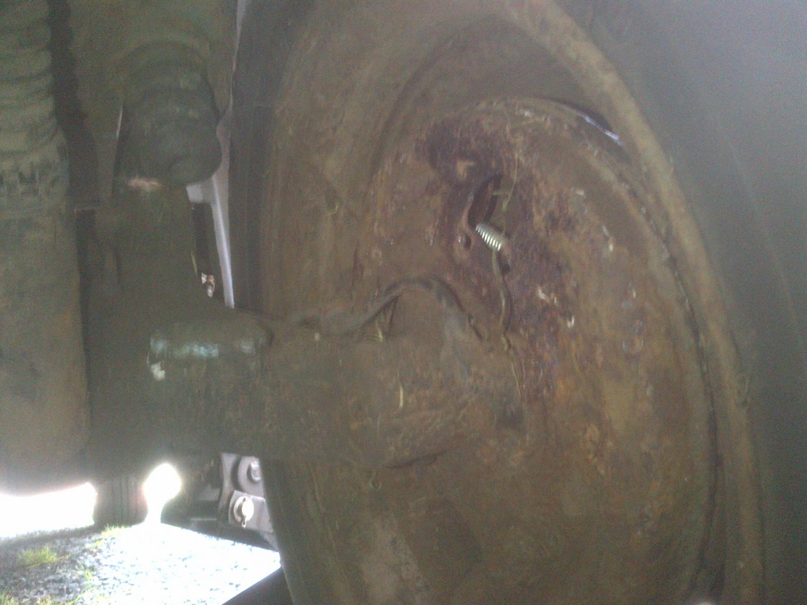

after the back was fettled I moved onto the front and since both front brake pipes where also rusty I let the jack down and buggered of for a play in the jago instead.
metal brake pipes are the work of the devil so I will attack it the morn now.
SHit!!! Thats amazing!
Yeh that's some bodge,
so this fine night I decided to fit the front brake pipe and I found more bodgery :shock: (forgot to take pics though)

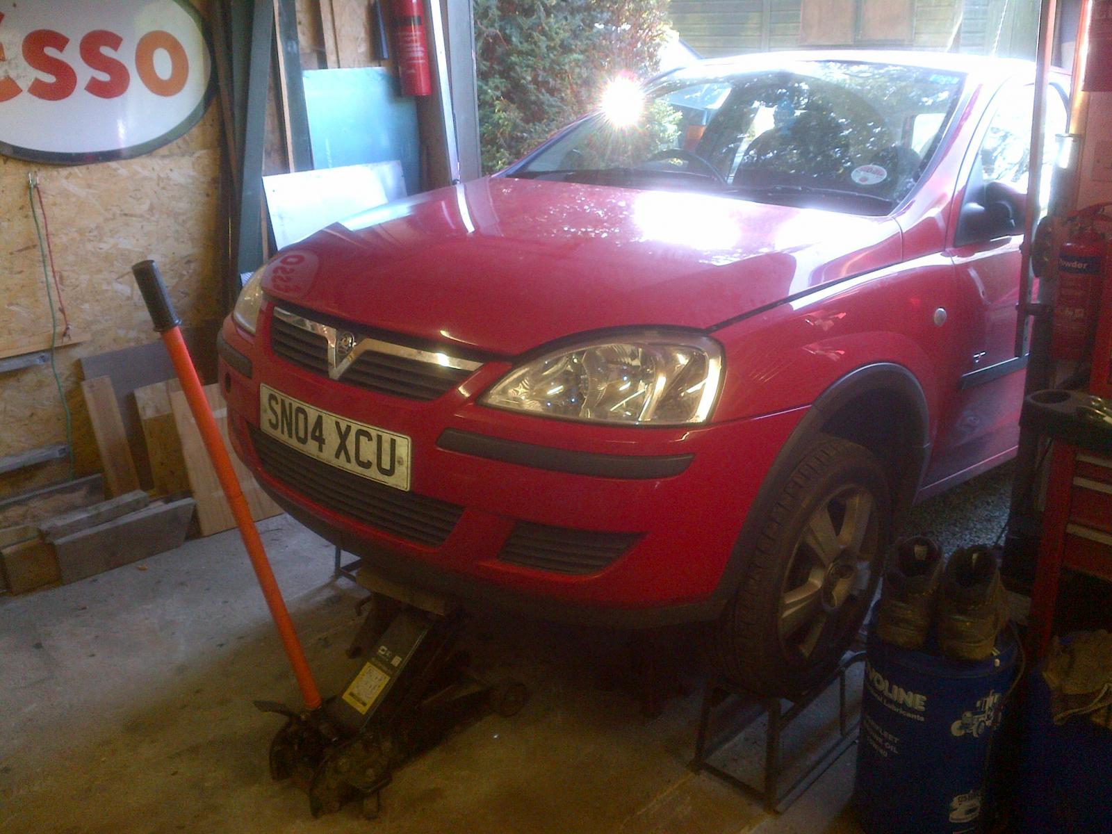

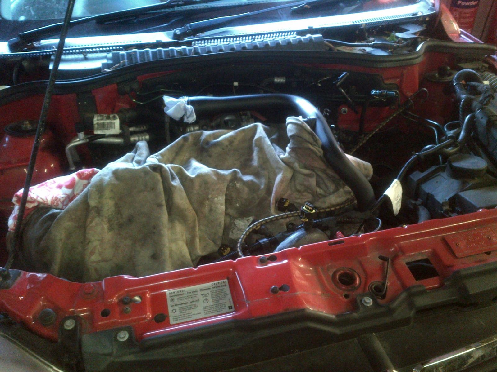

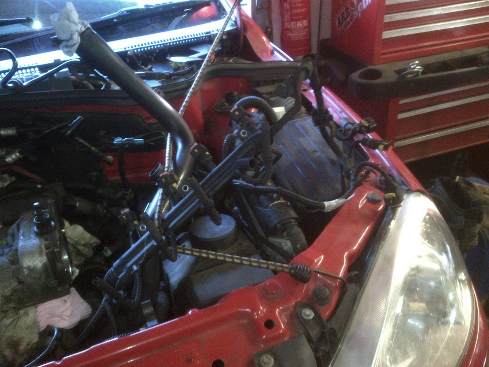

So decided to have a looksy at the new project,
since winters here I thought I would stick its nose into the garage so I could stick the heater on to keep warm.

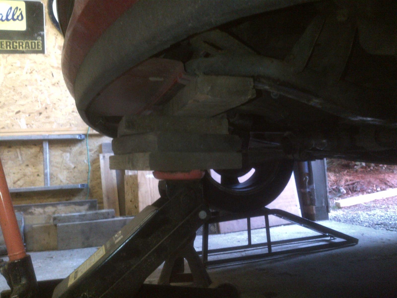

typical the jack doesn't even like the cold and failed to lift high enough, a few bits of tree soon sort that out.

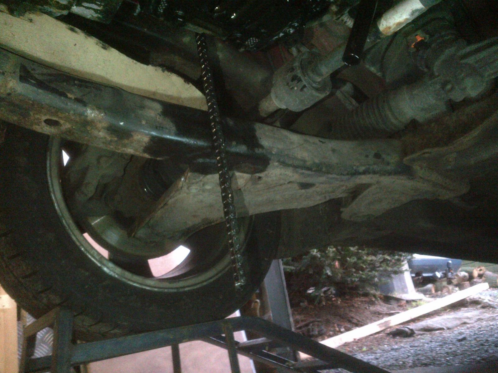

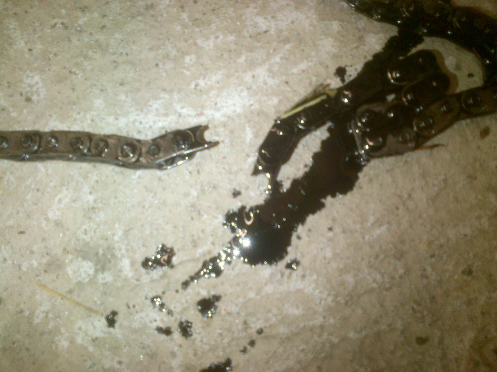

some spanner twirling later and the sump is of to show that its got worms.
yup it looks like its snapped,
I did ponder trying to take the link out and re rivet it to see if we have piston valve interface but thought better.

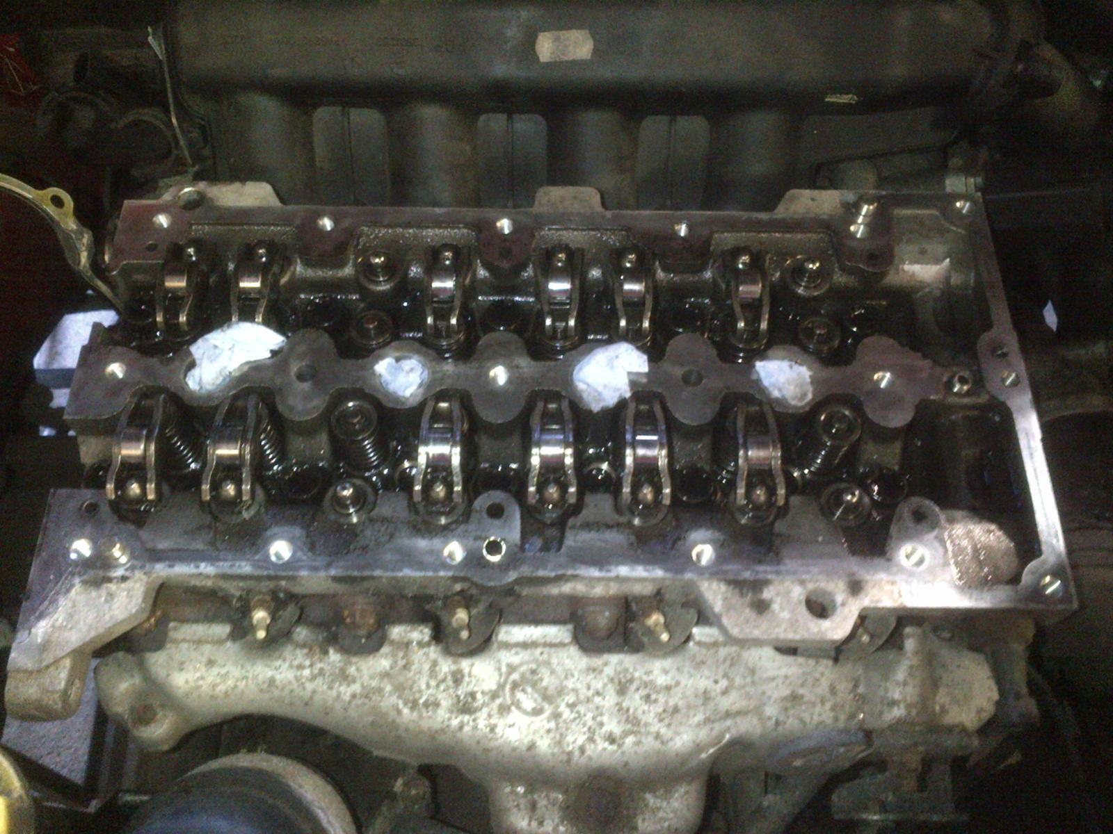

time to wip the rocker box of now and check for further damage, bungee cord comes in handy for getting crap out the way and saves daughter or misses complaining :-D

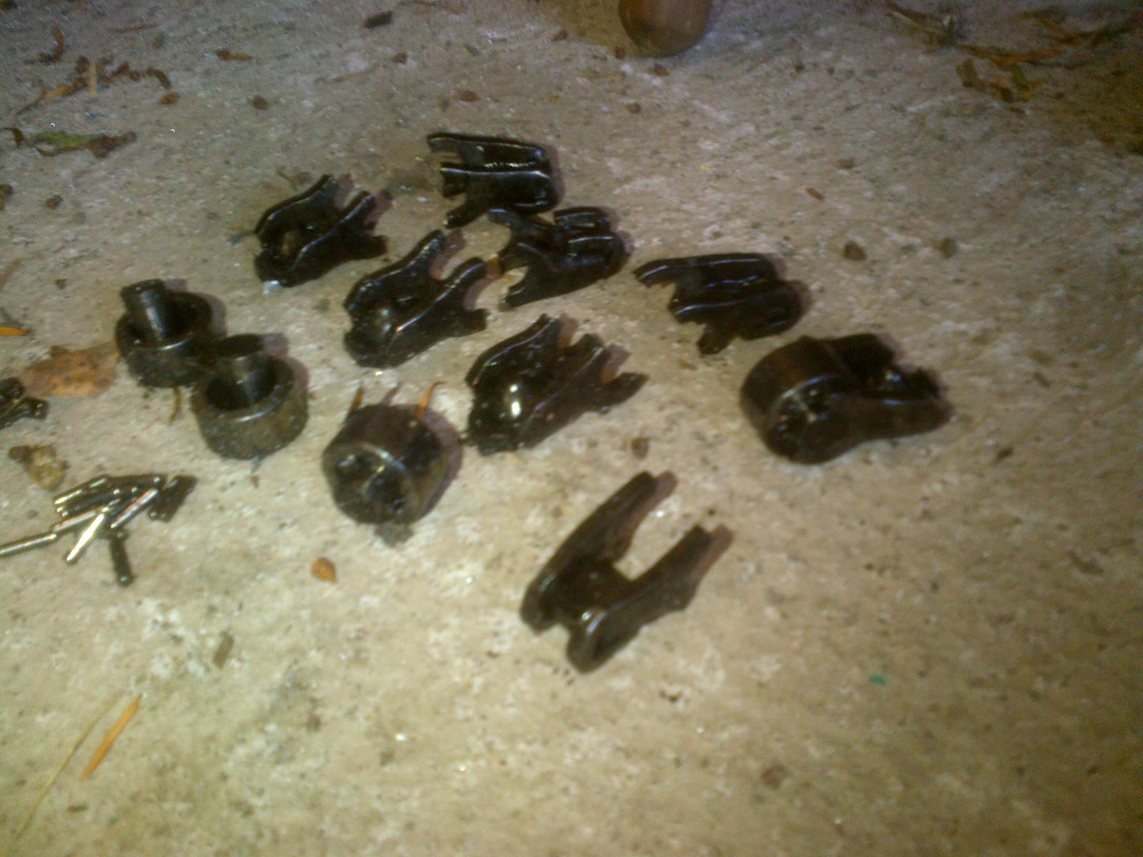

half an hour later and can you spot what's missing.
here we go four broken rockers, all valves appear to spring shut with a nice reassuring thud once flicked down.
 I think I shall have a gamble and order the cam chain kit plus four rockers and hope we have no bent valves.
so I shall tuck it up nice and warm until parts come, wouldn't want it catching a cold.

well I have took the plunge and ordered four new rockers at £21 and a cam chain kit at £52 some toothpaste sump gasket at £8
Its a bit of a gamble as I really don't want to be removing the head for bent valves but im pretty sure if the engine is goosed the corsa will break for more than what I've spent so far.
Forgot to say that this is a 70 k corsa 1.3ctdi with full main dealer service history, if fiat had used a belt then it would have been changed at 60k and a quick google suggests this is a very common thing with cam chains, especially this engine :shock:
Don't know if it's the pictures but that camchain looks pretty weedy, like a pushbike chain!

 yes it is pretty weedy I would say a pushbike chain is stronger.
