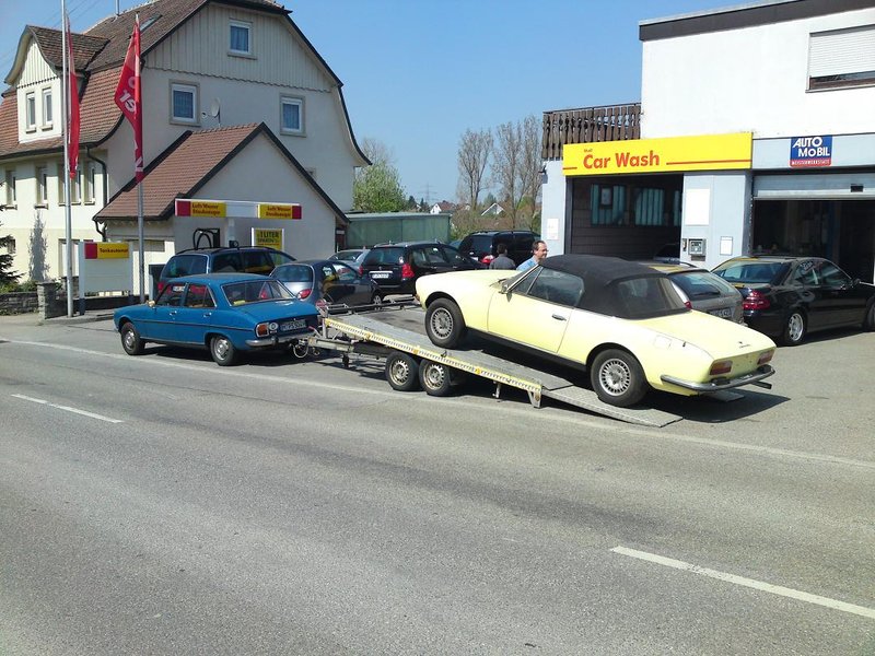

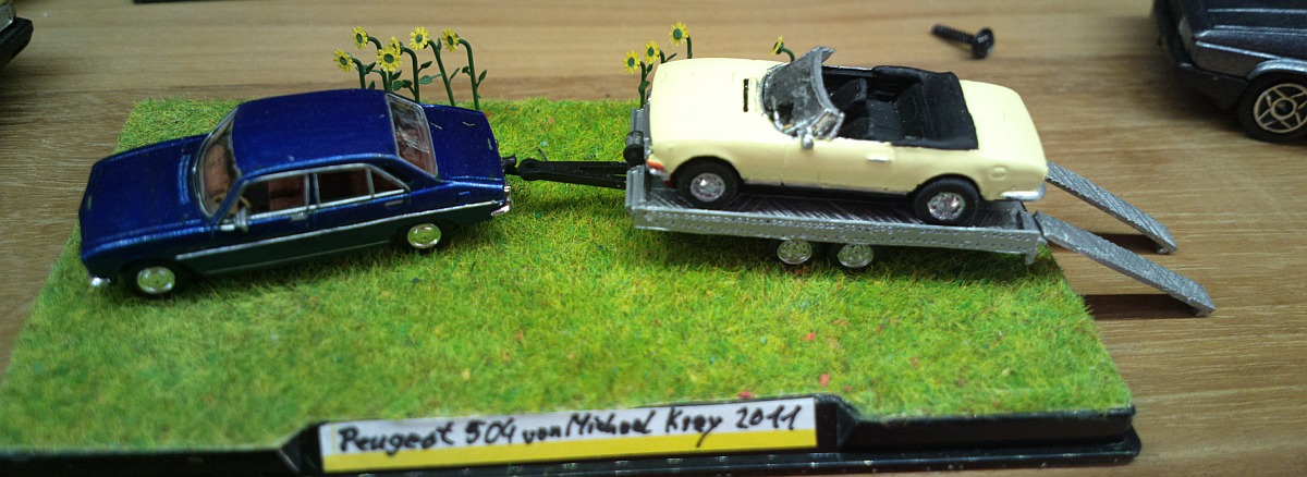

My personal favorite is the 1:87 model of my blue 504 out on an collection trip all across Germany getting the yellow 504 V6 convertible.
The tow bar is not mentioned in the car papers and max. tow weight is 1.1 tons anyway. Some truck drivers got pretty upset for no reason, what's wrong taking a ramp at 30km/h uphill on the Autobahn? Saves fuel!
