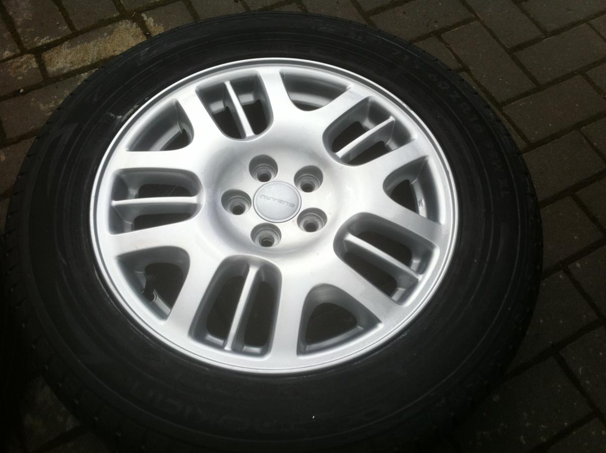

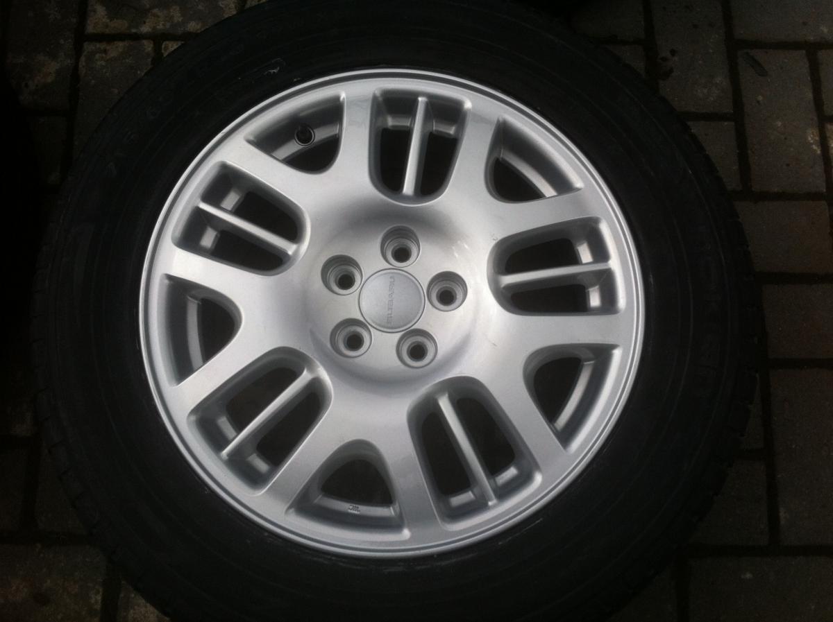

I have a set off the Outback currently being refurbed by Wheel Clinic at Northampton, costing £45 a wheel, they were well scabby after 12 years but no scuffs (215/60 x 16 sensible tyres helps), so we'll see what the finished product is like soon, i normally would have paid LapTab whatever they wanted but i no longer drive the car transporter so don't pass the place nearly every day, fuel for two trips would have put another £60+ time on the job.

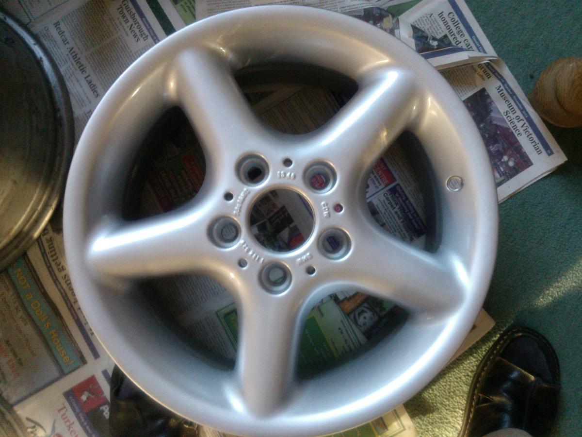

Results for rattle can and lacquer, as done and 18 months later. In 2nd pic I was getting tyre details but all the wheels still look like that, unchanged. A big factor in doing them is wheel design, these are smooth and simple, a lot are major PITA.
It can be a pain it you're doing them on the cheap and they still have tyres on, duct tape is about the only thing that sticks to tyre sidewalls to mask them. Deflating the tyre helps so you can get the tape tighter into the bead. Simonez 5 Wheel paint works well with clear laquer.

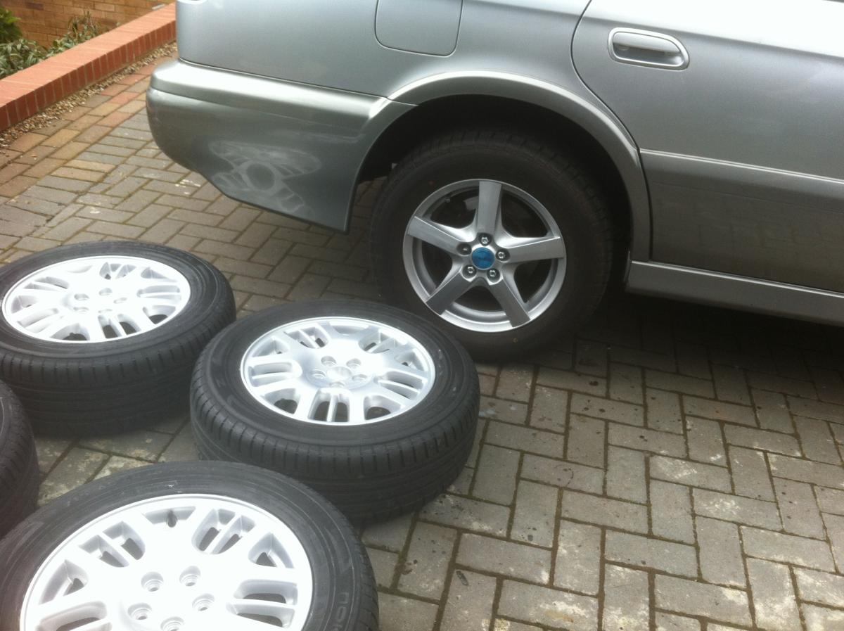

Well, picked the wheels up today from The Wheel Clinic Northampton, very good job, well pleased, he bunged me new tyres on when i collected too.
