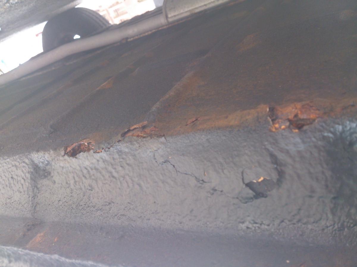

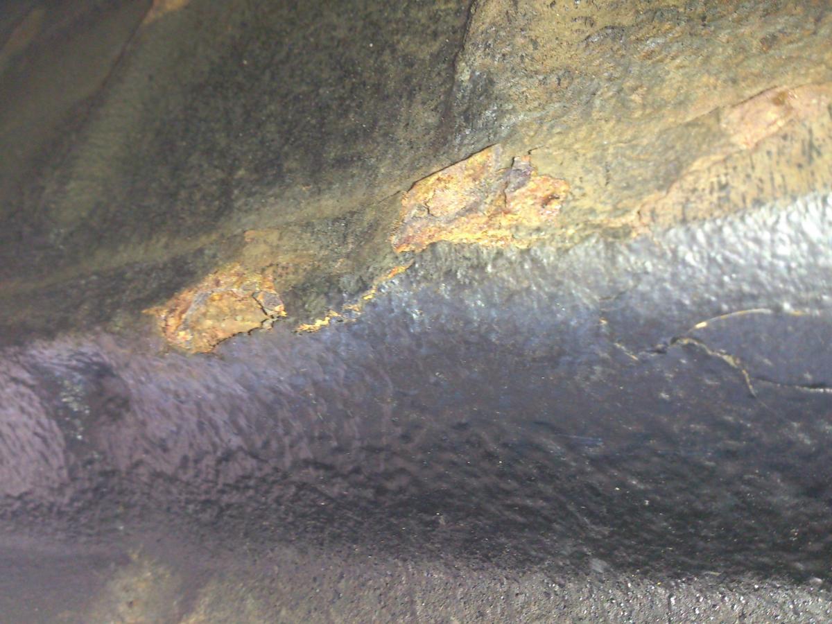

Hi,
Went to look at a car today (BMC) Nice but just a few reservations over the sill on the driver's side. Please have a look and tell me what you think. the door panel gaps are even and the door shuts fine but it is a bit crusty along this seam. It wasn't my car to poke around so couldnt do much more than what you see.
Floors themselves look absolutely fine.
Can these be patch welded or am I looking at a £600 job here?
Thanks for your help.
I don't have x-ray vision, but last time I poked sills like that with a screwdriver I ended up with a pile of ferrous oxide/filler/underseal and a scary looking hole.
You may be luckier, but is it worth the gamble ? How cheap is the car in question ?
They look utterly f*cked. Start scraping the underseal off and you will find a lot more crustiness FO SHO.
In my vast experience of rusty cars I can 100% confirm that this sills will be made of brown and air under that under-seal.
They are right.  Always much worse than it looks.  Everything can be fixed with enough time effort, money and insanity.  Welcome to Autoshite.
Thanks I feared as much. It's a well cared for BMC 1100 with FSH. £2k.
Oh dear, so £600 a side about right?
They are fucked. fact. They will be more fucked than you expect. It will make you want to cry, then get angry, then drink beer.
But its a BMC, what did you expect?  :-D
If its a dolly deal, buy a welder.
£100 a side if you buy your own welder, wire and gas... And learn how to weld.
Impossible to say really. Welding will always cost more than you expect, as more rot will nearly always be discovered. A quick plating job will only need redoing properly again a few years down the line.

Back 'in the day' there were many cars around that could be fixed with new sills.  Countless.  But 1100/1300s were different.  If they needed new sills, we'd reckon they needed a whole lot more rot fixed as well, generally structural and hard to do.  Of course, this could be wrong, this one might just need that area attended to.
Whatever you decide, it can all be done and has been a lot of times before.  But it does sound a bit expensive.
Expect to be doing sills and edge of floors.
Then more
If the rest is REALLY nice maybe with taking on. Not very likely.

If it was me I'd look for a better car. given that its an 1100 you can bet that if the sills are gone that's going to be the top of the iceberg. the sills look like they are held together by the underseal.

TBH it looks like somebody knows the sills have the structural integrity of a ryvita and have covered them with a lot of underseal.
If they are as bad as I suspect they are expect the inner sills and floor to be affected as well.

Always worse than it looks, especially when Mr Mig has been busy already, unless in capable and experienced hands, both from a welding pov and old car pov. You never know for 100% sure until you've started the job. Is the rest of the car perfect? If so, you may have the upper hand in a deal if you don't treat the seller as a shyster, unless he is. Explain the car is very likely unift to be used on the roads (sills integral and vital to the car's strength), he no doubt knows the car is needing hundreds spent. If you can buy cheap enough (under a grand defo) and you like it, then there is the possibility of a good buy. Make sure someone who knows has a thorough look elsewhere, too. They can rot, apparently :mrgreen:

That looks like the closing panel between the sill and the floor.  Mine had recently had new outer sills when I bought it but the closing panels are older (possibly the originals) .  I pulled 90 per cent of the nearside one off by hand and chiselled the rest off.  They arn't expensive panels to buy and if they are the only bit that's rusty then the car won't need painting once they are welded on.
Pull the rear seat out and the carpets up and check the floorpan and boot floor carefully.  If the seller objects then walk away,  nobody could own an ADO16 and not understand why you would need to check these areas.
