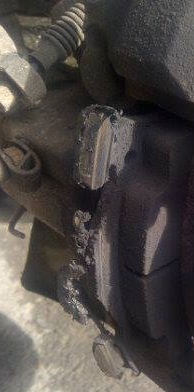

Asimo Posted March 17, 2014 Posted March 17, 2014 It looks like the pad was restrained from escaping completely by rubbing against the inside of the wheel. It hasn't damaged the wheel has it?
dollywobbler Posted March 18, 2014 Author Posted March 18, 2014 I do hope not. That wheel is on the back now. 250 mile drive was an absolute pleasure. Who needs more than 71bhp? I really am very glad to actually have a nice BX. Later today, the drive home commences. KruJoe, Shep Shepherd and catsinthewelder 3
