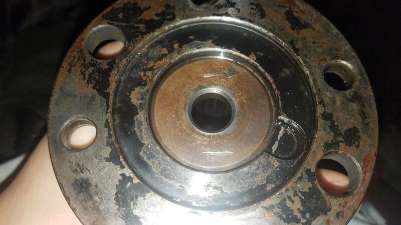

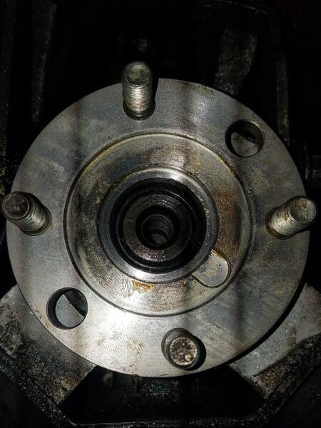

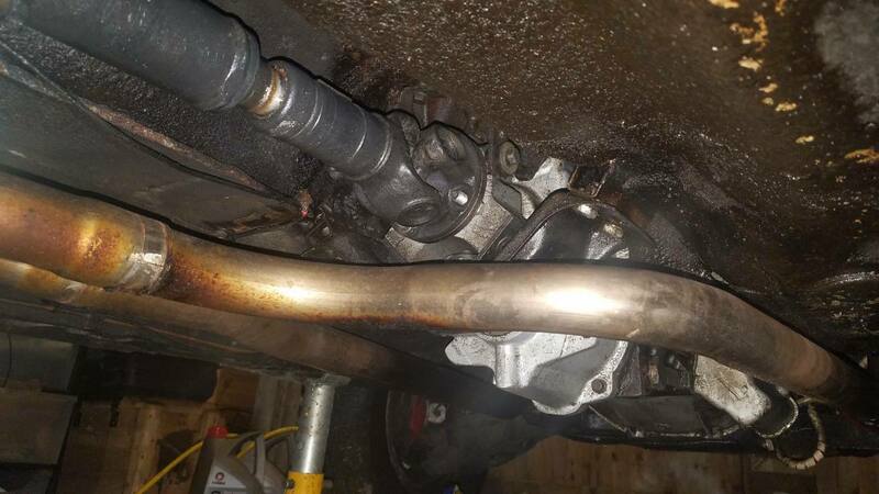

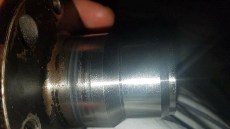

Well...actually I can. The leak has always appeared to come from the main shaft output seal, and spread around by the rotation of the propshaft. Yet that was the very first thing I changed, with no improvement. After that I pulled out the oil pump to find a small nick in an O ring, so figured I must have found it there, but no.
 Pulling off the output flange I started to examine the surface closely, to see if that was damaging the seal.
There's a visible mark, but it's more of a polish than anything I can feel, so I'd be really surprised if this is the cause. The flange is secured to the output shaft with an M12 bolt, with a tab washer and bush between it and the flange.

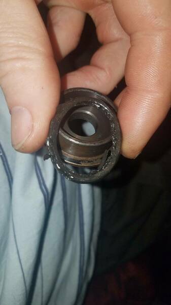

On the inside of the bush, I now realise there is an O ring, which has clearly seen better days!
I think it's got to be worth a try to replace this, and obviously the rear main seal too, before going to the trouble of exhaust off and engine lowered, just so I can get the gearbox out. Given that a new flange is only £25 I'll probably replace that too, to give a perfect sealing surface.

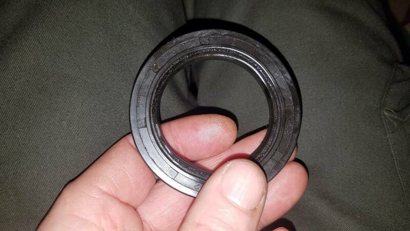

When I last changed the rear main seal, I couldn't find anywhere listing the correct one - all R380 seals I could find were for the much more common 4x4 'box. So I simply matched up a suitable seal from the housing and shaft dimensions.  I'm now wondering whether I've made a mistake...
My Google skills must have improved in the meantime, as I found one with little problem this time! This was the old seal...

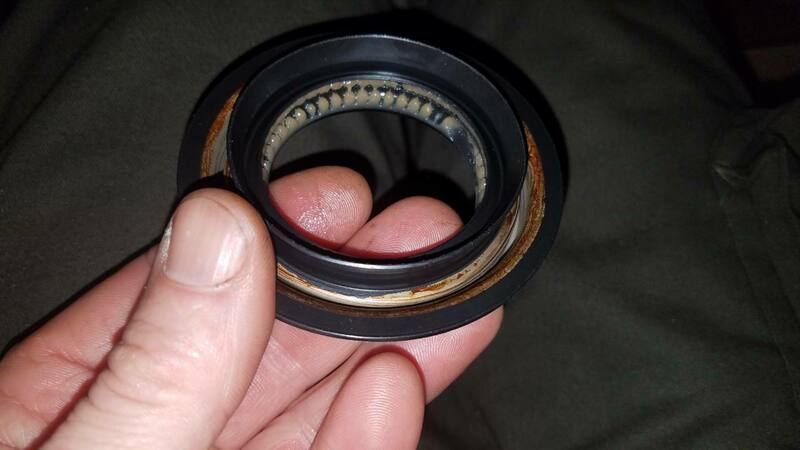

...and this the replacement.

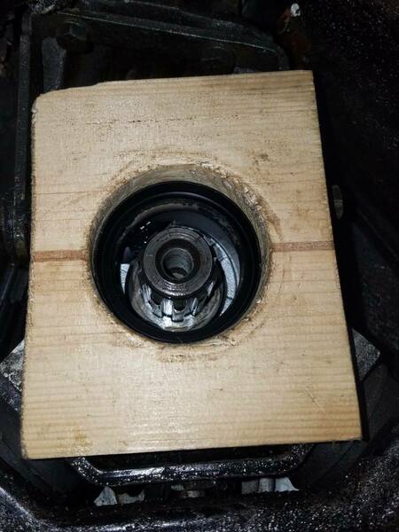

A double sealing lip, and an extra, non-sprung lip facing outwards, presumably as a dust guard. I didn't take into account the speed of the output shaft, which could be close to 20 metres per second at the shaft/seal interface.

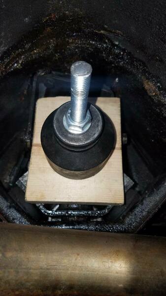

With this extra lip, I couldn't use a socket to draw it into place, so I cut a crude wooden spacer to protect it.
Then used a socket and threaded rod to make sure it went in square.

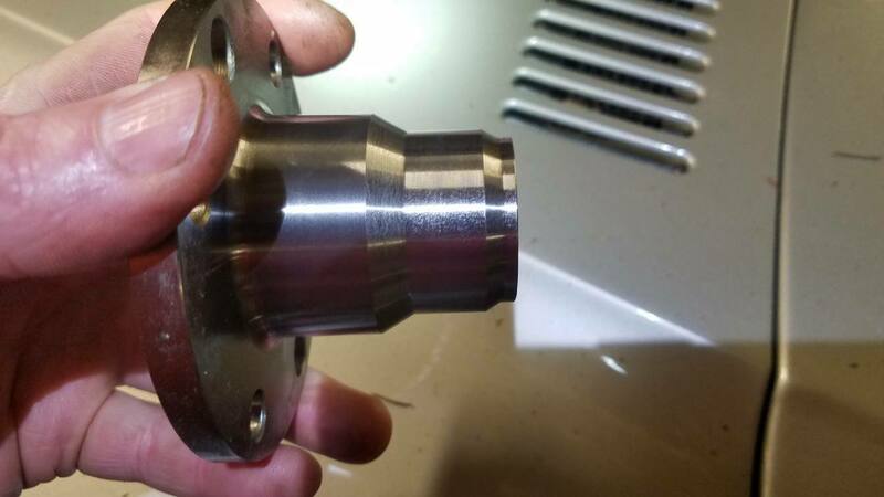

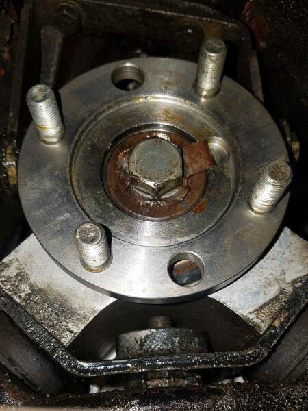

Next was my shiny new flange!
For a moment I thought the internal spines were different, as I struggled to get it to engage - fortunately it was just my ineptitude, as it went in nicely once I aligned it right. The new O ring was lightly greased, and places between shaft and flange.
All tightened up, and locked in place with a tab washer.
You'll notice I've been tight and reused the tab washer; my logic was that I've bent over a previously unused portion, so no different to a new one. I'm half expecting to have to take the gearbox out anyway, if this doesn't fix the leak.

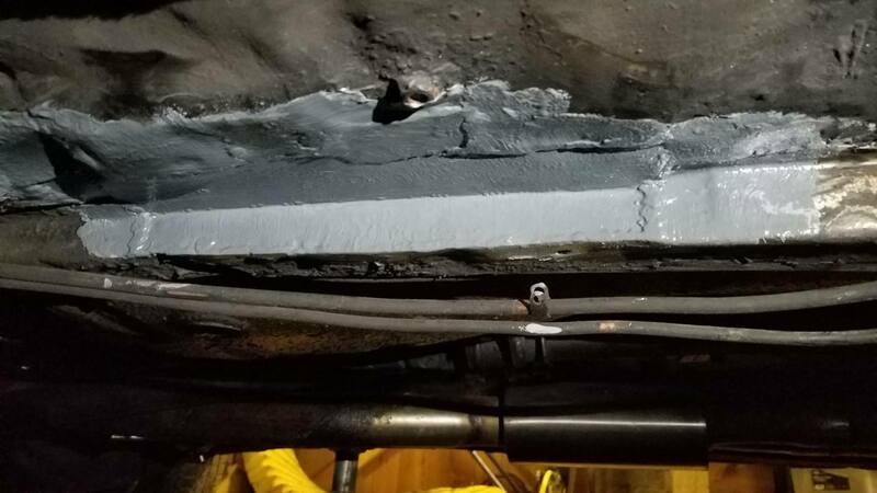

Oops. Never prod at it!
This is part of an old repair, from 1999 IIRC. At the time, a large section of the floorpan was replaced - in fact I think it was the last time I paid someone to do any welding on it!
I noticed a bit of a crusty area while I was underneath, and you know how it goes! Ended up cutting out a fair bit of the old patch, and the side wall of the chassis rail to get back to decent thickness metal.
Long term I'm still thinking of getting the shell dipped in the next 10-15 years or so. At which point, depending on how bad they are, I may go for new floorpans and chassis rails. It'll do for now!

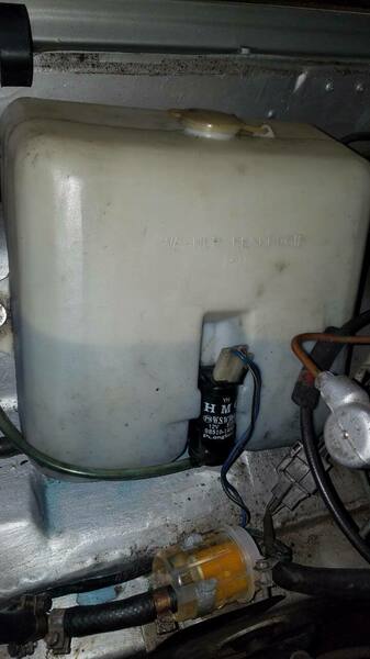

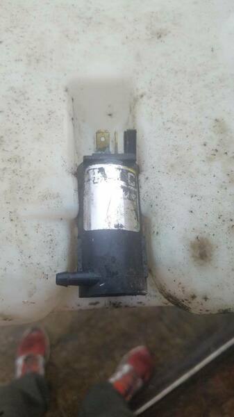

I've managed to locate one in Dubai for £11! Not sure what postage will be yet, but let's see what the dealer comes back with...

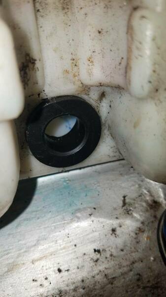

I also need the grommet too, as that is badly perished and was starting to leak.
You can see from the shape of the pump that it needs to be close in size to hold it in place.
Bodge solution may be to fit a hose stub into the washer bottle, and a universal pump if OE is too costly.

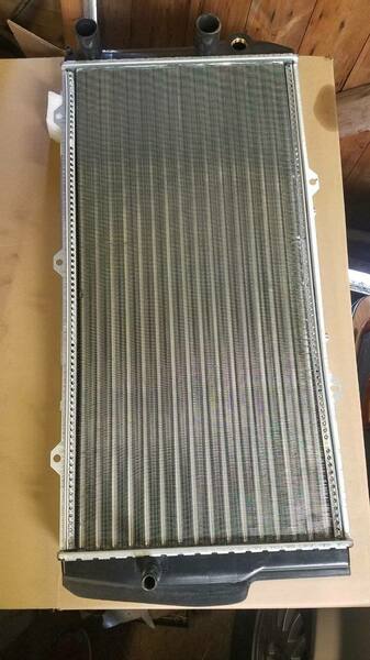

The radiator is a hefty one, from an Audi 200 Turbo, and is the double pass type so something like 10-15% more efficient for a conventional type of the same size. This link explains better than I can but the coolant basically flows in a U shape, so each molecule of water effectively flows through the radiator twice.
https://help.summitracing.com/app/answers/detail/a_id/5279/~/what-is-a-“double-pass”-radiator%3F
I'd like to claim that I chose it for that reason, but in reality it was the biggest which fitted between the chassis rails, and handily had both inlet and outlet on the same side, making plumbing easier. The downside is, and one which I didn't realise until a couple of years ago is that the extra restriction to flow requires a more powerful water pump. I think what is happening is that at low speeds, the pump is barely circulating enough water to transfer heat effectively. It seems worse in recent years, and I wonder if that is down to the higher gearing I've fitted meaning the pump is now turning more slowly for any given gear/road speed.

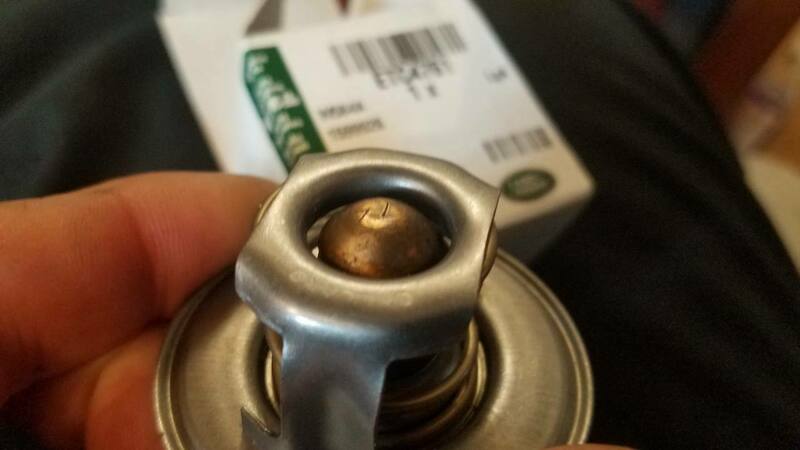

The other item I'll be changing is the thermostat for a lower temperature one. I know this won't make the cooling system more effective - it'll just be fully open sooner, but it will reduce underbonnet temperatures. *If* the cooling system is capable of dealing with the heat! I've gone for a 74°C version rather than the current 82°C; if it makes the engine run too cool then I'll just swap back again.

Today I had a package arrive from Dubai - impressively quick delivery from the other side of the world, and not hugely expensive.
As well as the washer pump I needed, I had a browse around for other part numbers I might require....

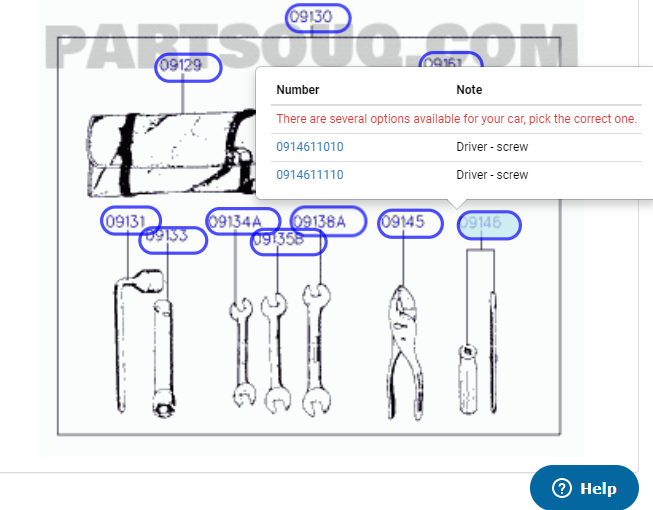

On 12/17/2021 at 3:13 PM, anonymous user said:
Would have expected a screwdriver in there
On 12/17/2021 at 9:47 PM, mat_the_cat said:
You're probably right, but I think the chances of finding one now are slim to none!
Hmmm...
Result!
Still used on modern Hyundai & Kia models. I know it's daft when any old screwdriver would do the job, and probably better quality! But only 4 quid so why not?
Also in the package was the pump...
...as well as a grommet, and the bonnet support rubbers.

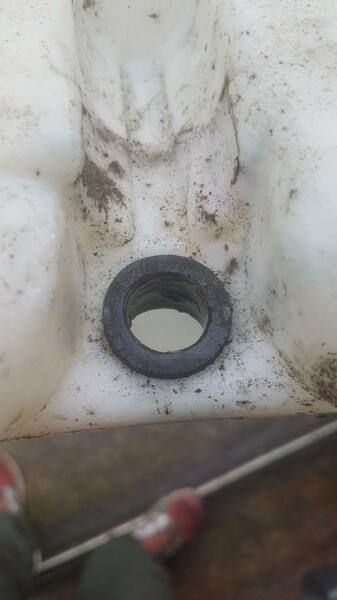

Grommet was fiddly to fit into the tank, and kept popping inside.
You can see the staining from the previous leak.
New pump fitted and all working :-)

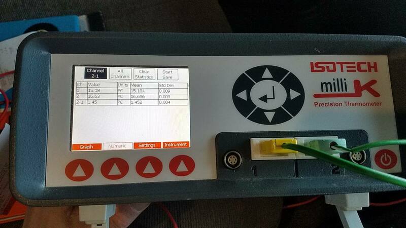

to prove the cooling issues, you would do well to measure the temperature of both the top hose and the bottom hose at the same time.
If the temperature differential is more than about 10c, then you have a flow issue.  If it's less than that, the radiator is undersize (which is unlikely)
It's quite possible that the return water is 25c or more cooler than the top hose, so at that point you've proven that the flow is poor.
That's been my plan for oooh, the last year or so!And I really have no excuse now, as the new business we're running has some quite handy kit :-)

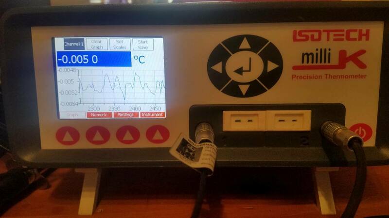

Overkill for this, but it would be useful to quantify any changes.
2 minutes ago, mat_the_cat said:
Overkill
measuring to 3 decimal places of celsius.  D'ya think!
Even the calibration equipment I used to use at a test house 20+ years ago, which was calibrated back to national standards at Teddington was only accurate to +/- 0.2c.
:-P
But given that I'm going to be sticking in a couple of cheap type Ks into it, I'll be lucky to get 0.5°C accuracy (which with my calibration head on seems huge!) I have to mentally recalibrate my brain to accept 'good enough' for the task in hand...
  • 3 weeks later...
Let the measurements commence!
And the results were most strange. I double checked my arrangement of thermocouples, and am certain I've got top and bottom correct. But this is what I get (note, I took the thermostat out a short while ago, just to see if that had any effect. None, apart from a slower warm-up).
So the radiator *outlet* is actually hotter most of the time, apart from at idle (the two peaks near the beginning, and the one at the end). The smaller peak at around 2000 seconds is where I drove a bit more briskly, and didn't really notice anything on the gauge - to be expected, as that is taking its reading from the engine outlet, i.e. the top hose which doesn't rise as much as the bottom does.

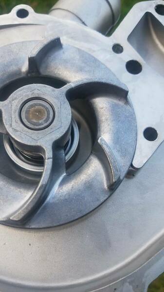

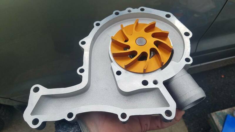

From this to me it suggests that the coolant is actually flowing the opposite way round, i.e. into the bottom of the radiator, cooled a bit (in normal running), then back into the top of the engine! A quick bit of Googling, it it dawned on me (or so I thought at this stage...)
My belt layout is as the Series 3 diagram on the right, spinning the pump clockwise, but I think what I've done is use a pump as fitted to a Discovery serpentine belt model, which drives the pump from the back of the belt - hence designed to be spun anticlockwise. So it looked like I'd be experiencing reduced pump efficiency. When the engine is spinning fast, it just about manages to pump some coolant in the reverse direction through the rad. At idle, there's nothing, and it even looks as though the thermo-siphon effect is dominating slightly, as the top hose gets slightly hotter and the temperature rises swiftly.
 Then I had a look at the picture I'd taken of the currently fitted pump.
Remember this is spinning clockwise as viewed from the front of the engine, hence ACW from the impeller side. And opposite to its design rotation - or is it?! To the best of my knowledge, those impeller vanes are correct for spinning ACW as viewed, drawing coolant through the impeller from the hose stub at the top of the photo, flinging it centrifugally outwards and into the block. In which case why does mine appear to be working in reverse?
Think I'll sleep on it, and maybe try pinning the pump with a drill in both directions, with the hose disconnected so I can see what's happening.

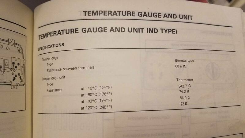

Lastly, this was probably a bad time to see this comparison table...
