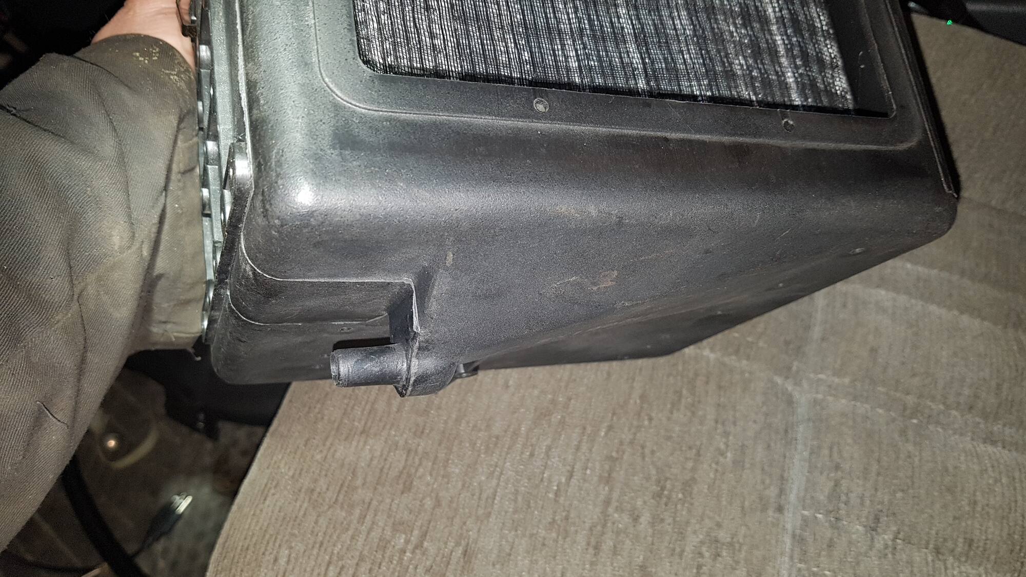

The new evaporator has arrived, and initial signs are looking like it could have been designed for the job! I've matched up and bought what I think will be a suitably sized expansion valve, here fitted.
This leaves both feed and return pointing towards the slot already cut into the casing.
Also moulded into the casing is a drain pan, to catch the condensate.

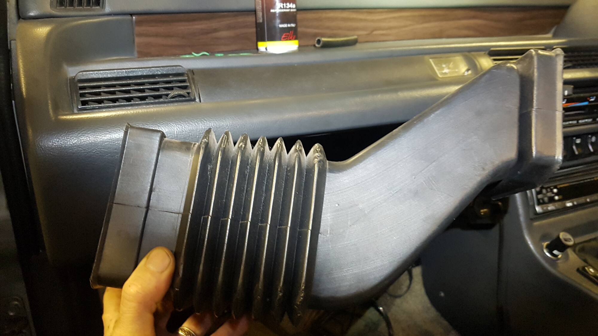

So the air will simply blow out of the existing blower unit on the left, and into the evaporator on the right.
I should be able to adapt the original ducting to suit. On the outlet I'll do the same to connect to the heater matrix casing, but before I do that I'll have to connect up the refrigerant hoses to the bulkhead unions.
See what I mean about being made to measure? Outlets pointing in the right place! Sure, it'll be fiddly to connect, but all looks doable :-)

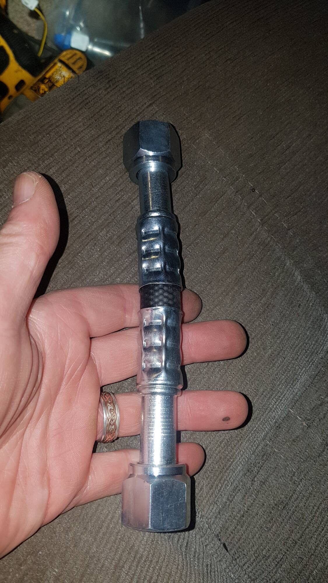

Then I made up the first of the two hoses - a dry run before crimping, just to make sure.
All well and good at this stage, although I can't actually see what I'm doing so have to stick my phone up under the dashboard to take a photo and see how it looks!
Encouraged by this success, I crimp up both hoses, and this is where it goes downhill.
The larger of the two hoses is both too long, and not flexible enough to cope with the offset between bulkhead fitting and evaporator.
I can't move the evaporator any further away from the bulkhead, or indeed in any direction! Even if I welded up the bulkhead, and moved the fitting upwards, the combined length of the crimp connectors alone, even without the hose, is around 20mm too long.
So the only think I can think to do is sacrifice a couple of 45 degree fittings, shorten one, and cut the ferrule off the other. With a bit of flap disc action, one fits inside the other.

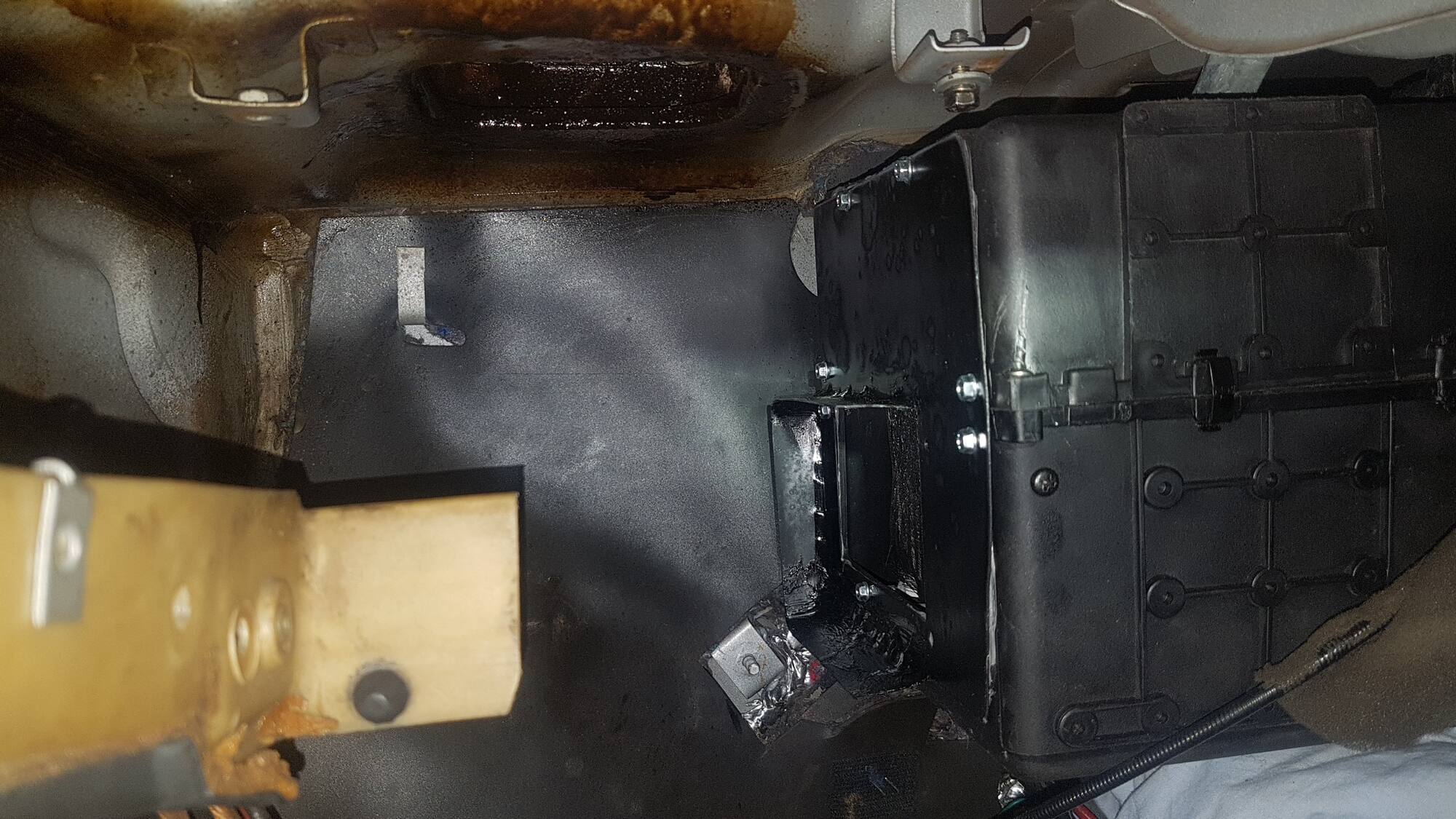

Final task for the evening was to wrestle it all back under the dash, and loosely connect it up to see where I need to weld it.

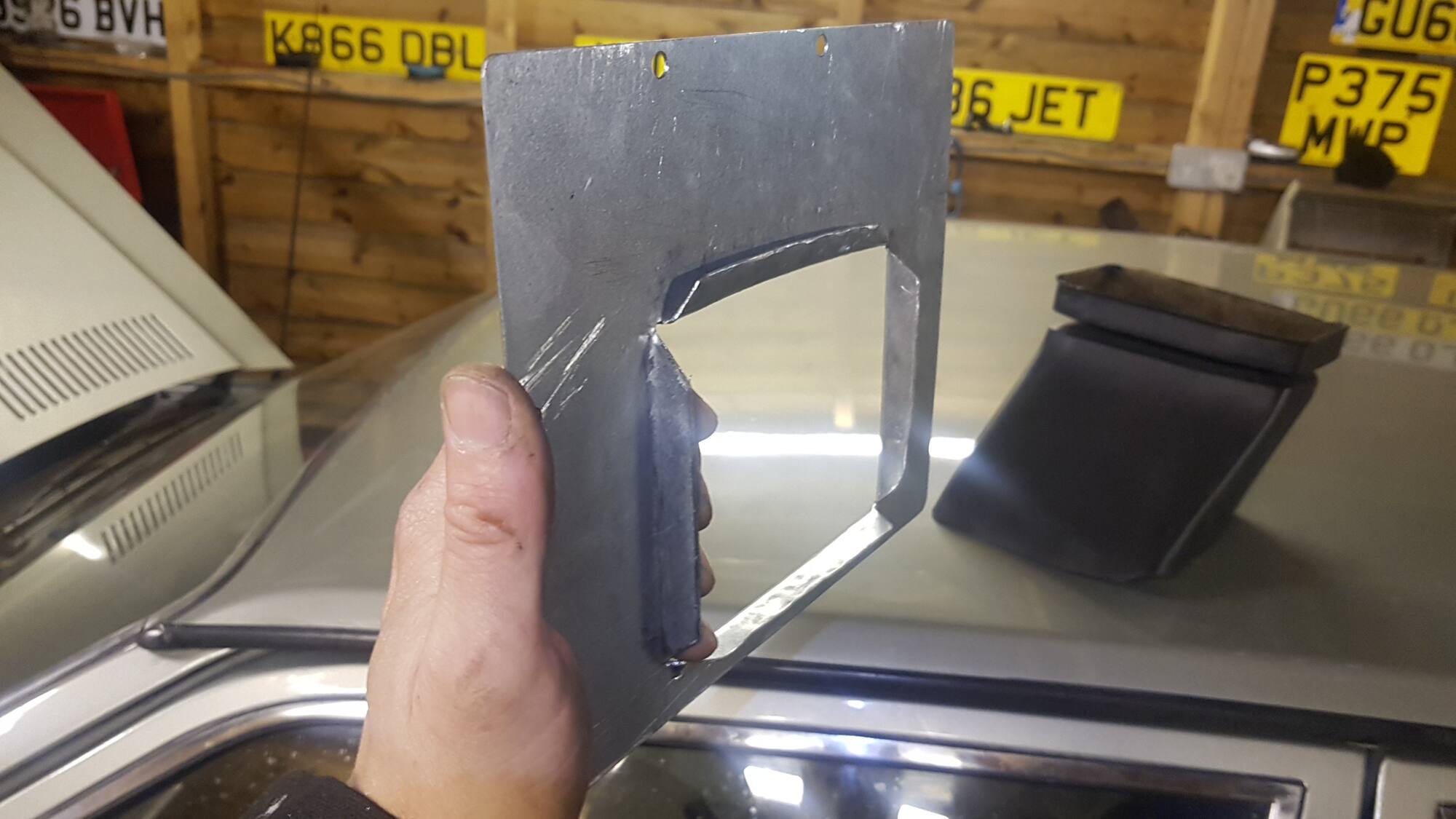

YES!! Now just the simple task of welding it in that position, and hoping that my welds are good enough to withstand AC system pressures...
I welded it this afternoon, and had a splattery moment when I first started. Ground it back, and it looked like this :-( (decent weld below it).
I can only think that the air in the shroud gas line was being purged by the Argoshield gas initially.
I buzzed over it again, and all was fine, but I went over it all with the flap wheel just to check! Temporarily connected it back up again to check, and it's still all orientated correctly.

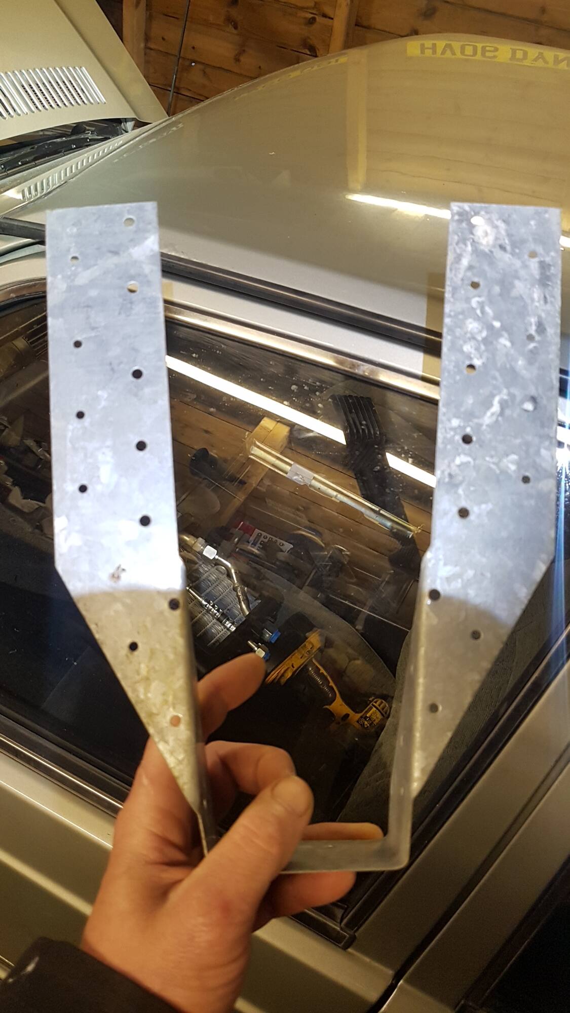

Thanks, but seeing as I'm planning to hold the thing in place with a cut up joist hanger, I hardly think they would approve of my bracketary...

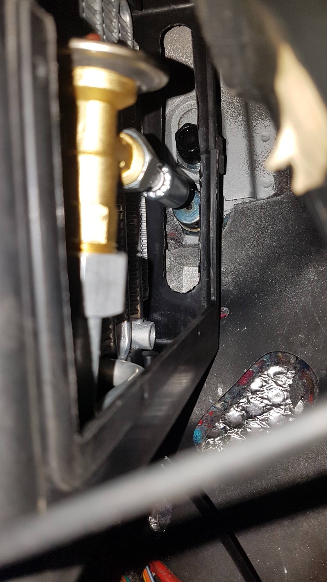

Before I could fit it I had to fasten the expansion valve temperature sensor to the evaporator outlet.
This controls the flow of refrigerant based on the temperature of the outlet, closing it off if it gets too cold, i.e. the refrigerant is condensing in the outlet rather than the heat exchanger. I think I've sized it appropriately to the system, but will wait and see. The temperature sensor is wrapped in foam insulation to make sure it picks up the temperature of the pipe, rather than the airflow.
Onto brackets now, and look away now Project Binky fans!
Easy to cut up and form into restraining straps, and already galvanised!

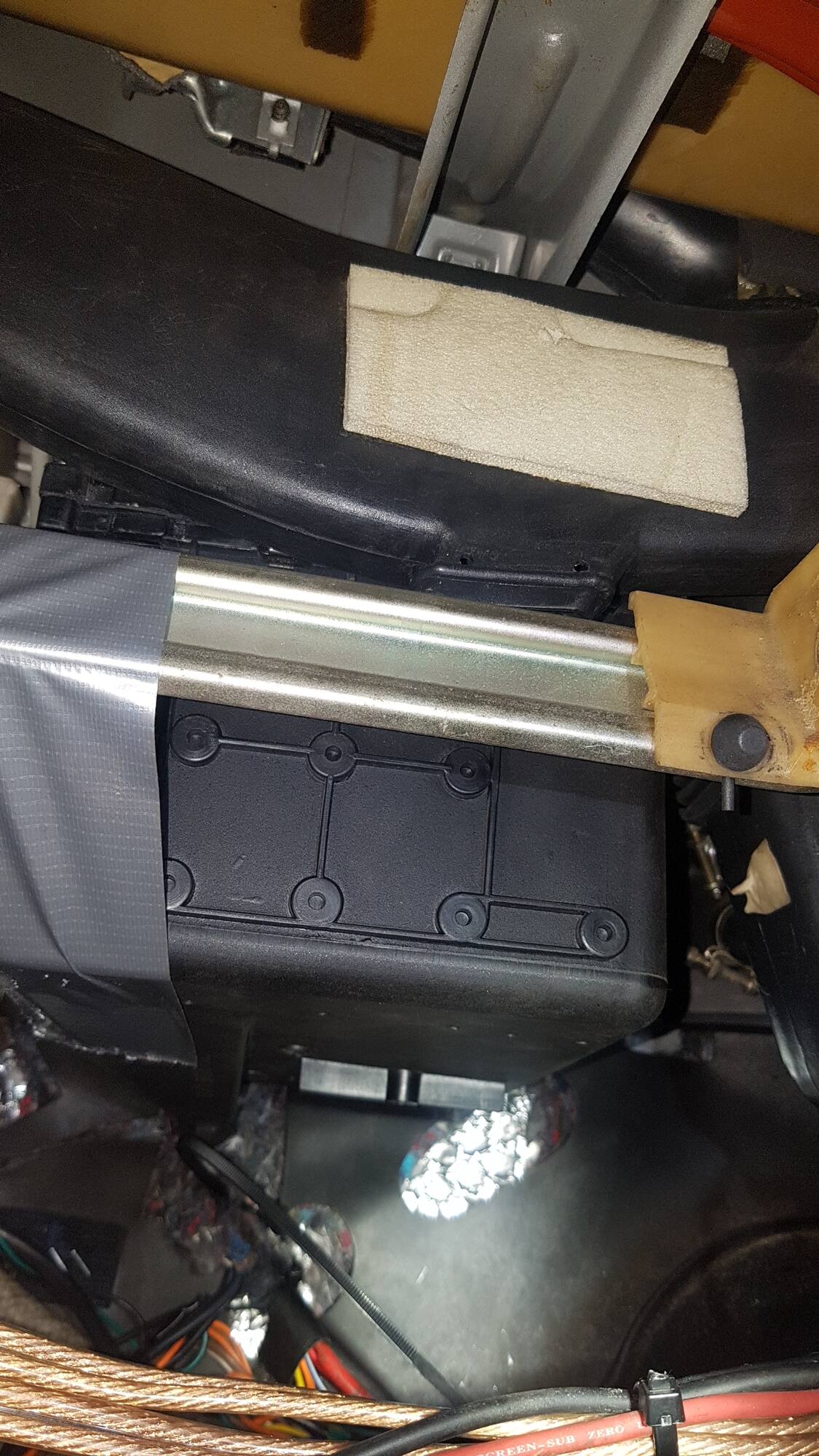

There's one strap at the top, one at the bottom onto the rail below the glovebox, plus the rigid refrigerant line means it's already held securely. Once I sort the ducting it should be held even more firmly, depending how I make it (still TBD!)

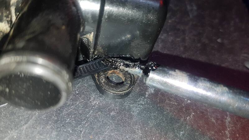

So out it came, and off came the heater tap. It looked like the cork gasket had disintegrated, which had been used when I'd had a new matrix made. There was also some damage to the sealing face of the two, which I filled with epoxy before filing flat again.
I cut a new card gasket, and given the sealing face damage, smeared it with sealant before refitting.

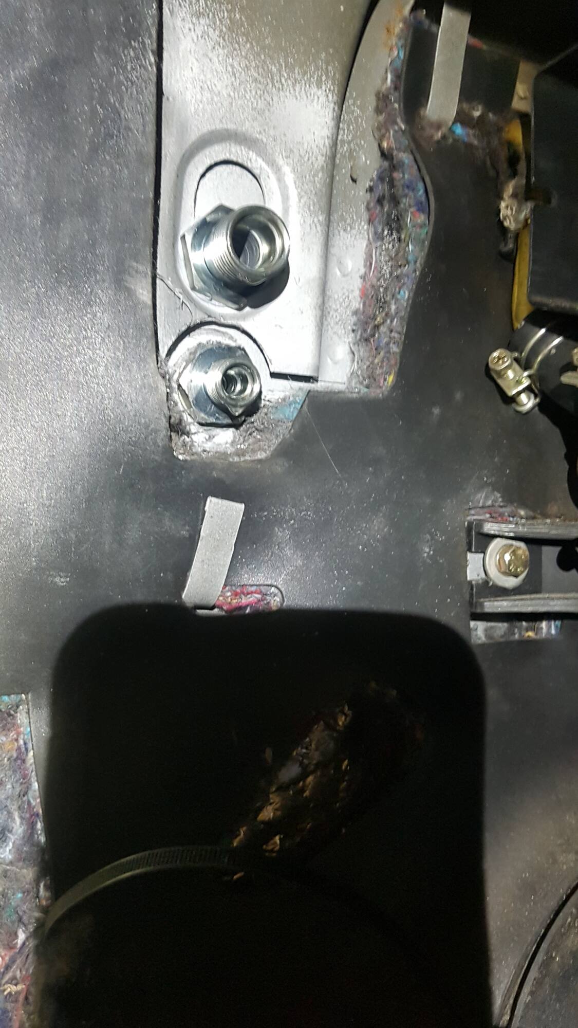

I could then attach the bulkhead unions with new O rings - I don't know why I didn't think of doing it this way before!

Note the threaded boss at the top of the picture, which Hyundai thoughtfully put in for my benefit :-) I've no idea what it was designed for, but I'm really wondering whether by chance I've ended up fitting it in a similar manner to the factory system.

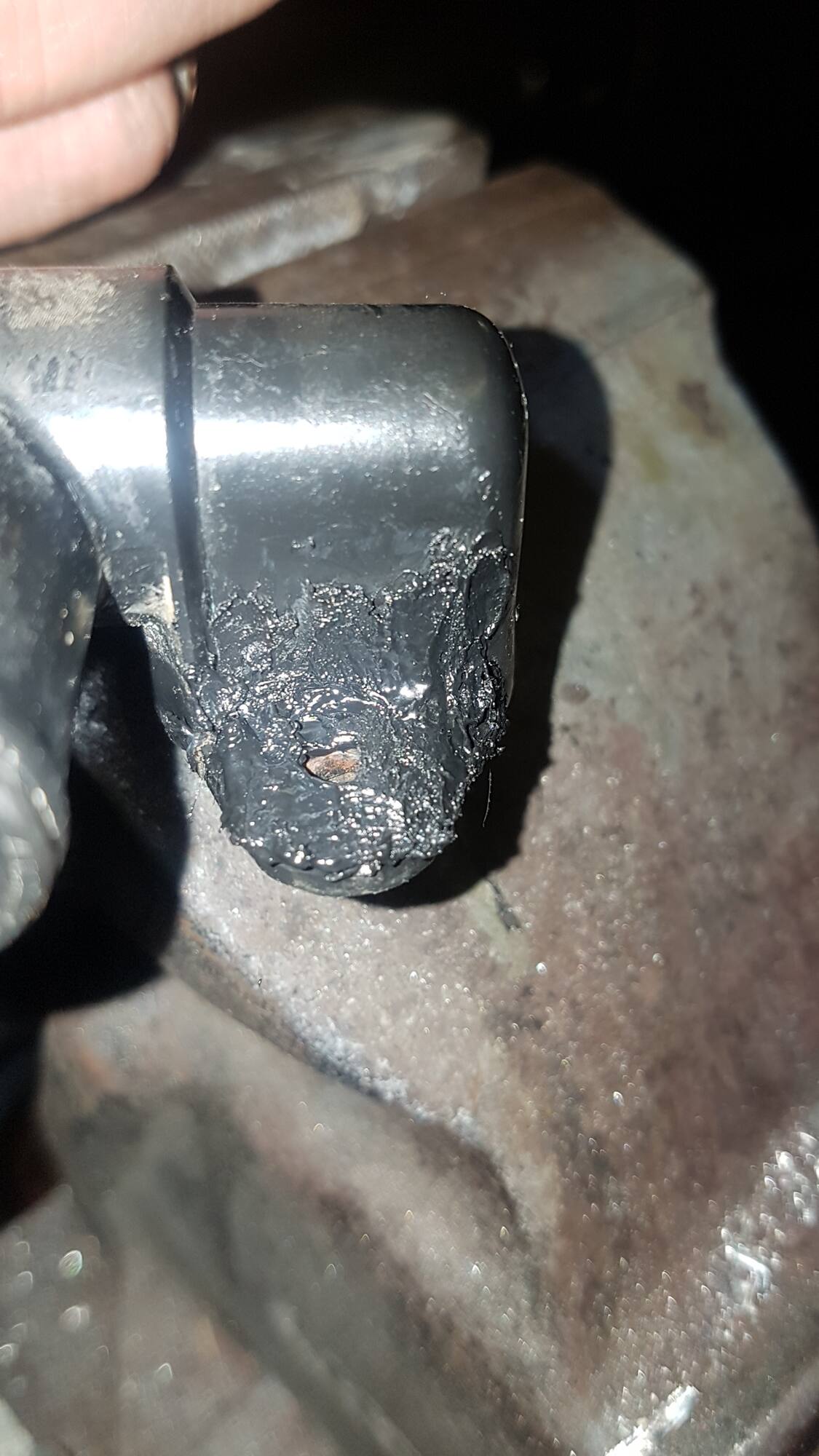

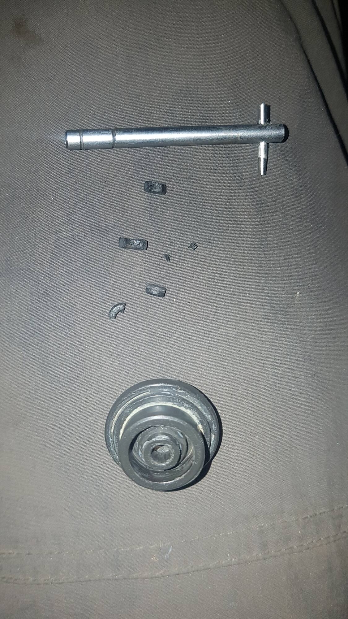

This is the remains of the shaft seal when I finally got it apart! It sat in a female groove on the inside of the housing, and although looked in one piece intially, soon broke up when I started poking at it. Fortunately, I had a suitably sized spare so it could go back together.
All lightly coated with silicone grease.
I then leak tested it again by immersion, and happy to say no leaks visible :-) It was 2am by this point though, so re-fitting can wait until today!

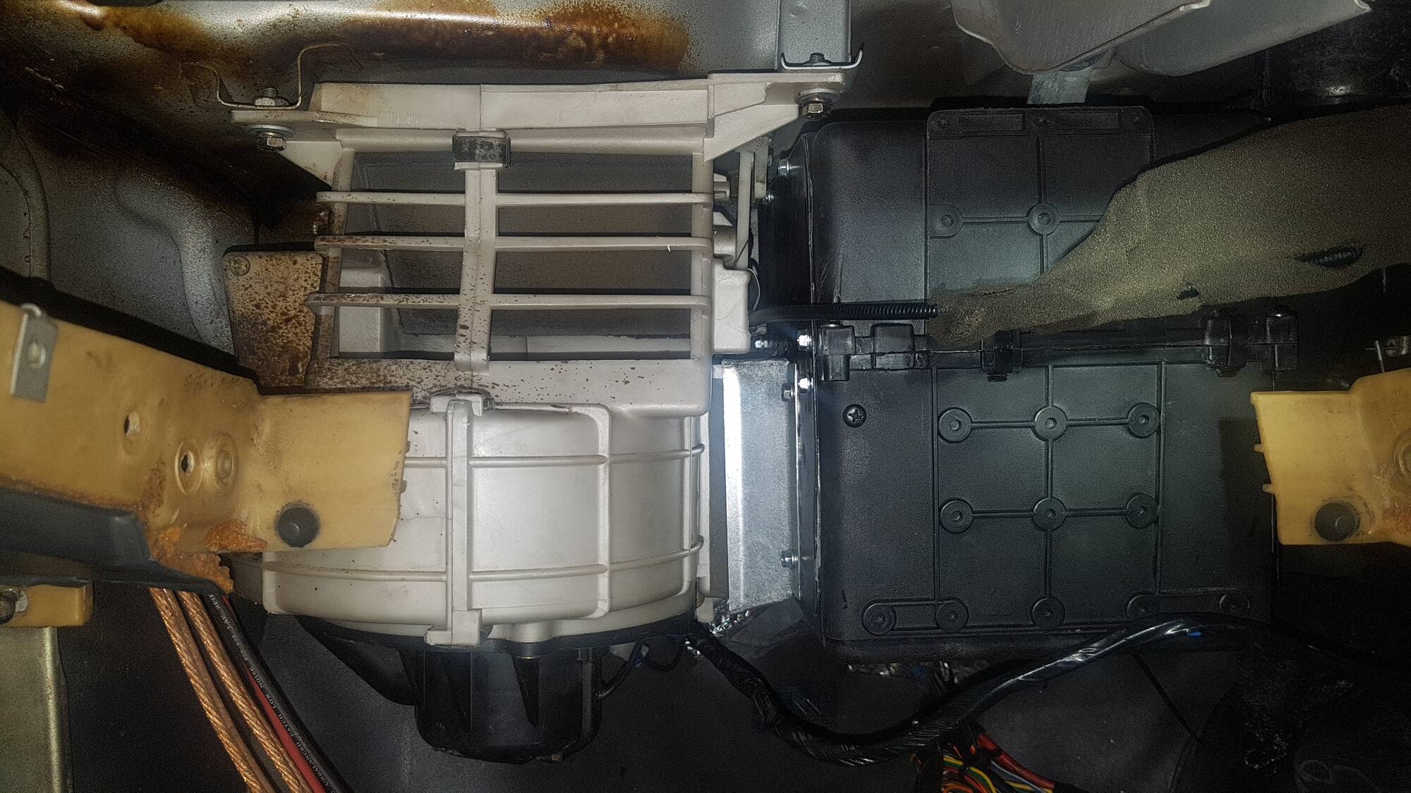

Finally, I've got to the stage where all the function parts of the AC system are installed, plumbed in and wired up. All I need to do now is leak test it, and fill up with gas!
The last few steps were to connect up the blower motor to the evaporator inlet, which was a simple job of a sheet of steel with a flange welded to it.
As I have to slide in the motor casing from the front, I've had to make up a removable flange, to allow the motor to slot in and out.
Then in with the motor, and connect it up.
Just enough clearance to allow the recirculation flap to operate, fortunately. Turning the blower motor on fired air through the system for the first time, with no evidence of leaks.

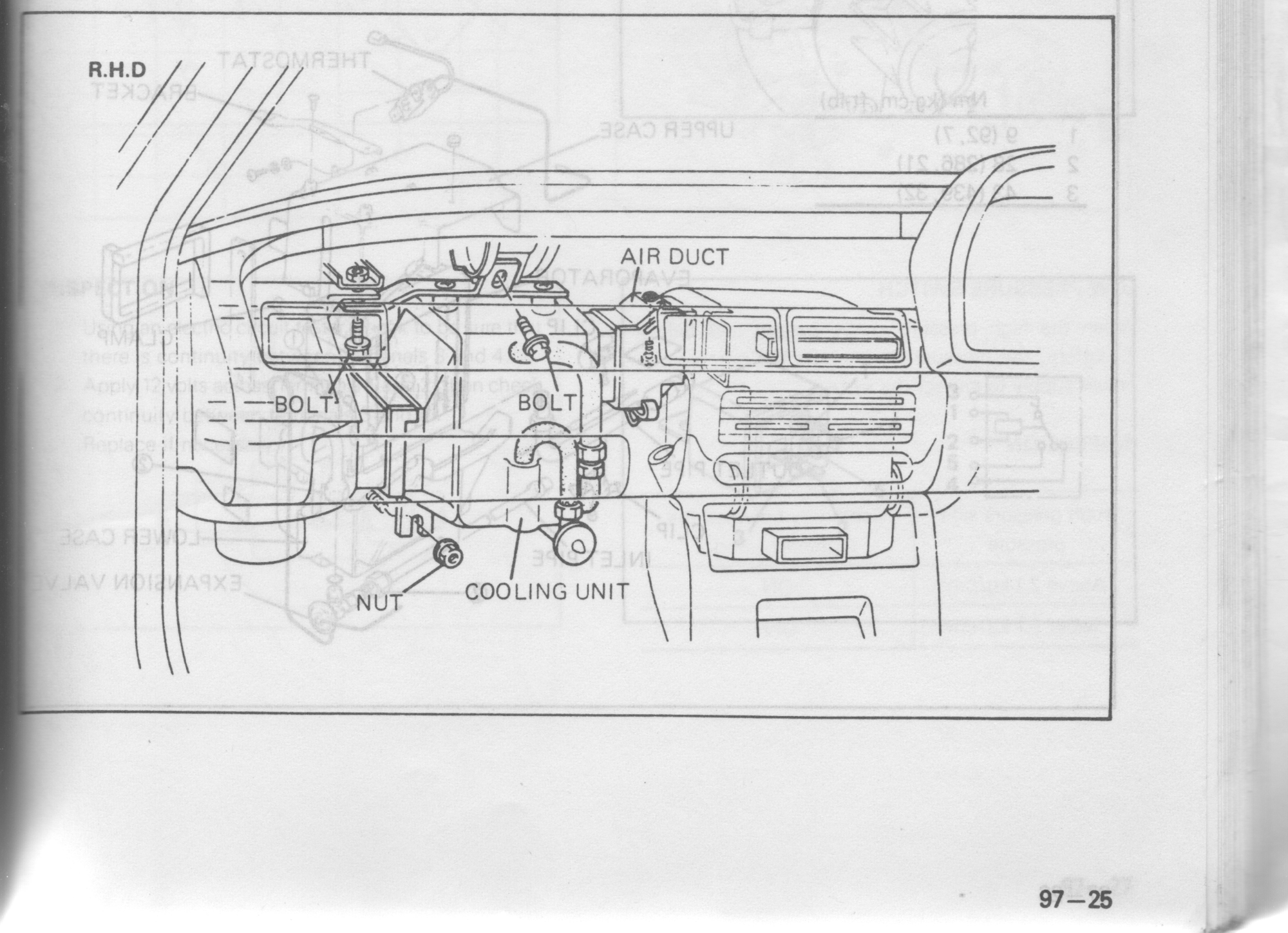

I got my hands on a scanned copy of the manual, and by complete guesswork have mounted the evaporator in an identical way!
Also of interest was the performance test.

although it appears the tap is watertight, it seems as though it's seeping from the hose joint.
Nope, it was the heater tap again! Despite passing the air pressure check and looking OK initially, once the system warmed up it started leaking again, and dripping down onto the hose. I have to confess that in my haste to get it working again I didn’t actually calculate what size O ring I needed, just picked the most suitable from what I had in stock – 1.5mm cross section x 3mm bore, in nitrile rubber. Using this handy calculator:
https://ceetak.com/o-ring-calculator
I was able to work out that there was insufficient compression, so I think it was a marginal seal when cold, and as clearances grew/seal softened the leak started. 2mm cross section x 3.5mm bore (of which I have none!) should be a better bet. I’ve gone for Viton rather than nitrile, for improved high temperature performance so just waiting for that to arrive.

Granted, some folks were obviously less careful given some of the bodges we found over the years!  Still terrifies me how many times I've found a ground leakage issue "fixed" by disconnecting the earth wire...in a huge metal cased piece of kit, used in a damp shed with either an earth or wet concrete floor.
