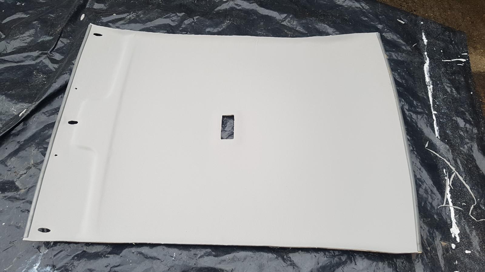

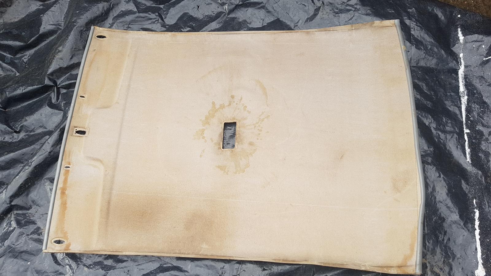

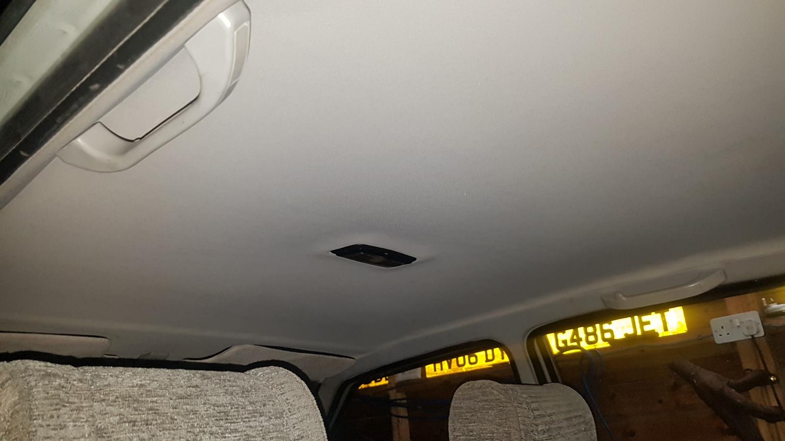

As I mentioned a while back, I've been meaning to replace the headlining for a while. The roll of material arrived a couple of weeks back, so I've made a start on the job. First thing was to RTFM - one of the few jobs which is still relevant to the original factory manual!
But what's this? I don't own a special tool 09853-31000!
So I had to make do with a gasket scraper, which worked pretty well. Old headlining was removed, in all its glory...
The stains around the centre are from when I attempted to re-glue the original material which was hanging down. It was previously owned by a smoker, as you can probably tell!
I then had to tackle the areas of rust, which although light had extended over quite a wide area. Bilt Hamber Hydrate 80 was the potion of choice.
Once this has dried I will stick some soundproofing sheet on there, to reduce any drumming. In the meantime I've glued the new material onto the headliner - looks about a million times better!
New headliner looks great. Amazing how much shit and grime manages to build up on the old ones, my Capri’s old one didn’t look too bad, but compared to the new one it was actually minging! It had also been a smokers car and had that nicotine yellow hue!
That's a good job ... How hard was it to do?
It was actually really easy - just peel off the old material (barely even adhering), spray on contact adhesive and roll out the new. Fiddliest part was removing the headliner from the car, but with this being a saloon it was fairly manageable. I did our Discovery a long time ago, and that was a huge, unwieldy sheet to remove.
Did you need to take a screen out to remove it though?  At least the Disco has a big back door.
That was my worry, but it fitted diagonally through one of the front door apertures. Would have been a major bind to take a screen out!
Job is now done, and really pleased with it :-) Those of you who've seen Dollywobbler's video will know how it looked before...
https://youtu.be/ifKoJkWObIY?t=67
And here is the 'after' photo:

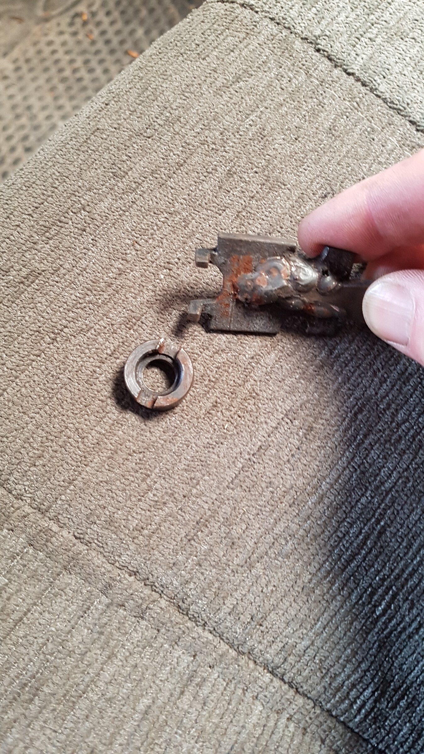

I've managed to tick off another minor job from the list - the gear lever gaitor. The original was some kind of plastic imitation leather, which as well as looking cheap had started to deteriorate.
Problem was, nowhere listed a replacement leather one for a Stellar, which is surely a massive oversight? I'd wondered about getting one made up, but  before I did so, on the off chance sent off an email to an eBay seller:
http://www.ebaystores.co.uk/thetuningshop
They couldn't have been more helpful, and looked though their designs to find the best match for me!
So, off with the old, using a home-made pin spanner to loosen the gear knob locknut:
And on with the new!
Not quite identical to the original, but looks quite nice I reckon - kind of OE plus.

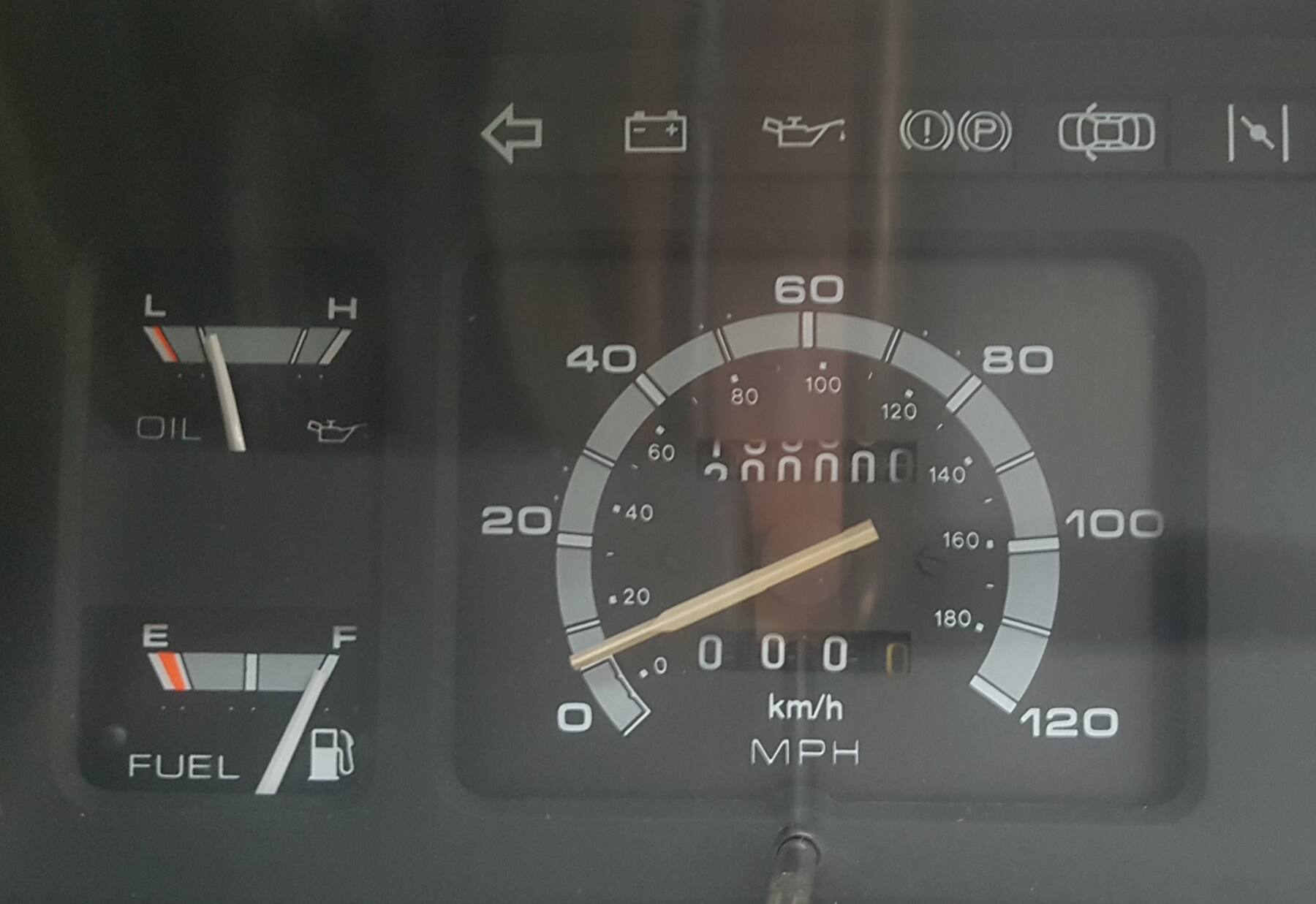

On the way back I spotted to take another photo of the dashboard; this time for happier reasons!
22 years of ownership and it's made the second milestone - unfortunately I didn't take a photo of the first 100k, but would have been within the first year I had it as I was doing 20k miles a year at the time.
i would think the "normal" section is ALL of the grey shaded bit and hot isnt till after small white line and into actual red bit
renner say normal is area between the two small highlighted arrows ?
It probably isn't a massive cause for concern, but it rises much more quickly than the original engine did - and with the Hyundai sender on the V8 I know it is running warmer when moving slowly. Plus, to fit AC I probably need to improve the cooling system as I'll be sticking a condenser in front of it!
possibly not as the fan(s) will be moar active with a/c
True, but will that be offset by the warm(er) air leaving the rear of the condenser? I dunno, it all just feels a bit marginal at the moment, but that's a gut feeling rather than measured.
is it possible to stick a proper thermocouple into the coolant loop hooked up to a digital read out to get an accurate reading of coolant temp to check if everything is alright?
its one of the things I like about my computer, I can keep an eye on ALL THE THINGS! :mrgreen:
Yeah, probably. I used to work in temperature calibration, so there's no excuse! I did measure it with an infra-red thermometer, but without knowing the emissivity of what I was pointing it out, couldn't rely on it.
as a rough idea with torque running on the spaceship temp a/c off = 88/90*c, a/c on 78ish*c

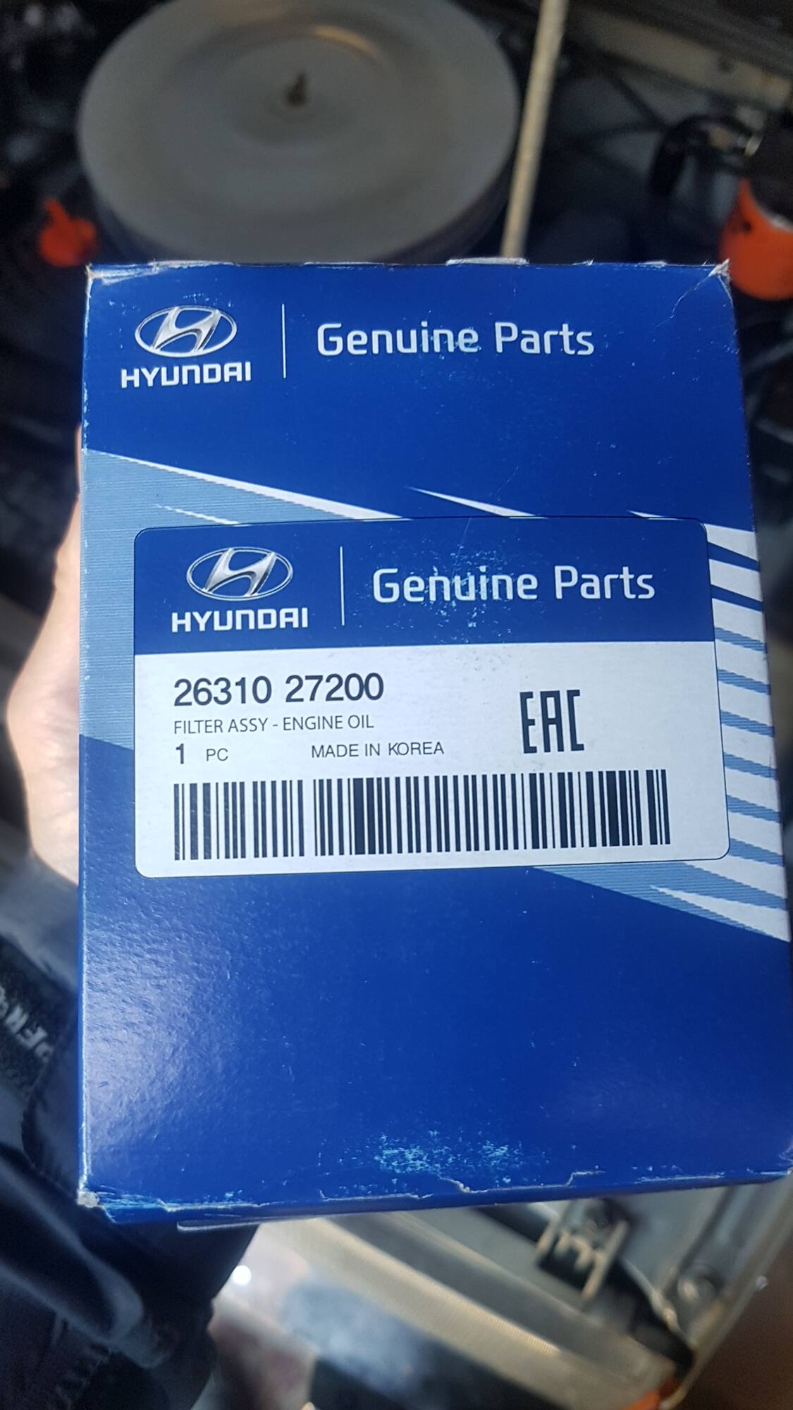

As the owner's manual says, always use genuine Hyundai parts!

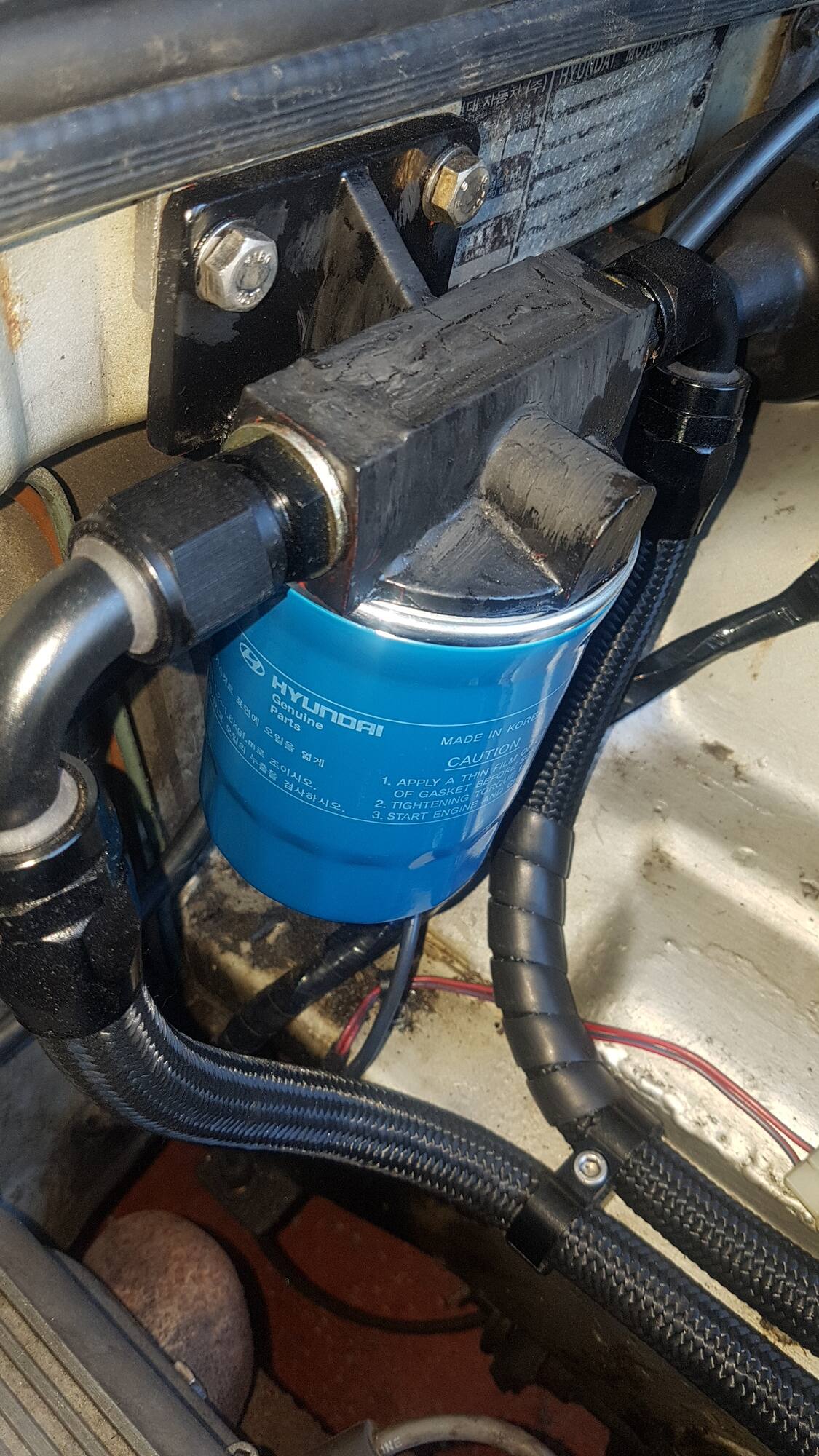

In an idle moment I started thinking that an OE filter would be a better bet than the aftermarket ones I've been using. Having seen the internal differences I always use them on the rest of the fleet, but no chance of an original Rover item for this. So I had the silly idea that maybe a Hyundai one would be suitable, and with a bit of Googling I managed to match up the specs. (I could have just fitted a genuine Land Rover filter, but where's the fun in that?!)
I'll have to book it in for a main dealer service at some point, for a laugh!
You'll be getting specially cast rocker covers fitted next with 'HYUNDAI' on them.  Just think of the car show conversations that that would cause amongst the know-it-alls ?
The thought has crossed my mind! But the cost puts me off, however the Buick and Leyland P76 versions of this engine have pressed steel rocker covers, which don't give away the engine's origins...
I'm keeping an eye out for bargains, put it that way!
What you need is a whole P76 motor.
How could you go wrong with 4.4 Litres of Rover V8?
