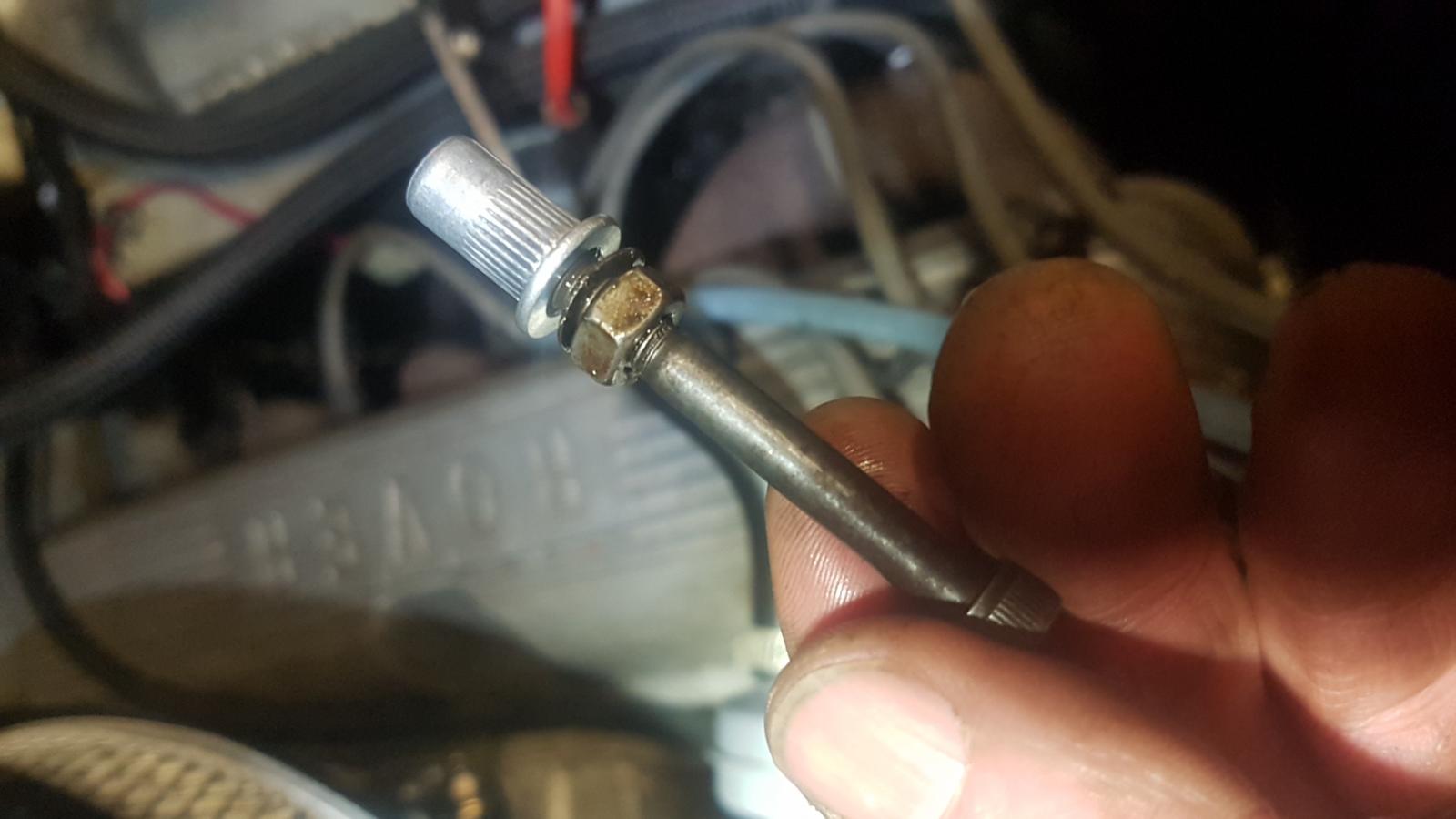

In the meantime I've been securing the new oil hoses, with something more rigid than P clips. First I had to install a few nut inserts, and as I don't have the proper tool, had to improvise with a nut, bolt and washer.
Just tighten the nut whilst holding the bolt stationary, and the insert expands to grip the hole.
I could then attach a number of clips to hold the hoses securely.

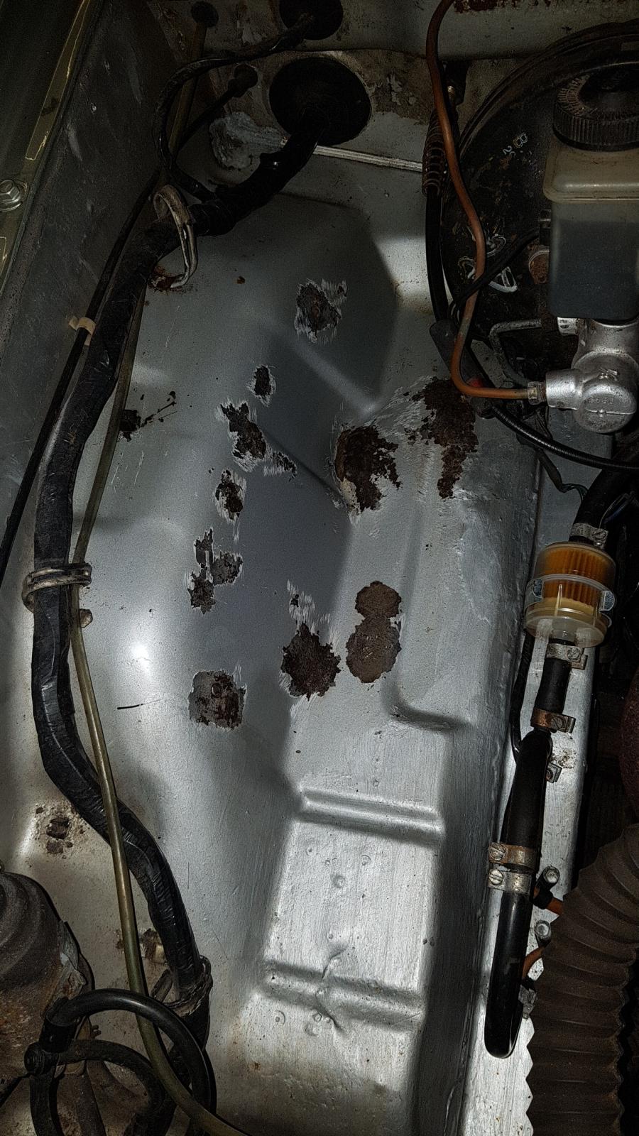

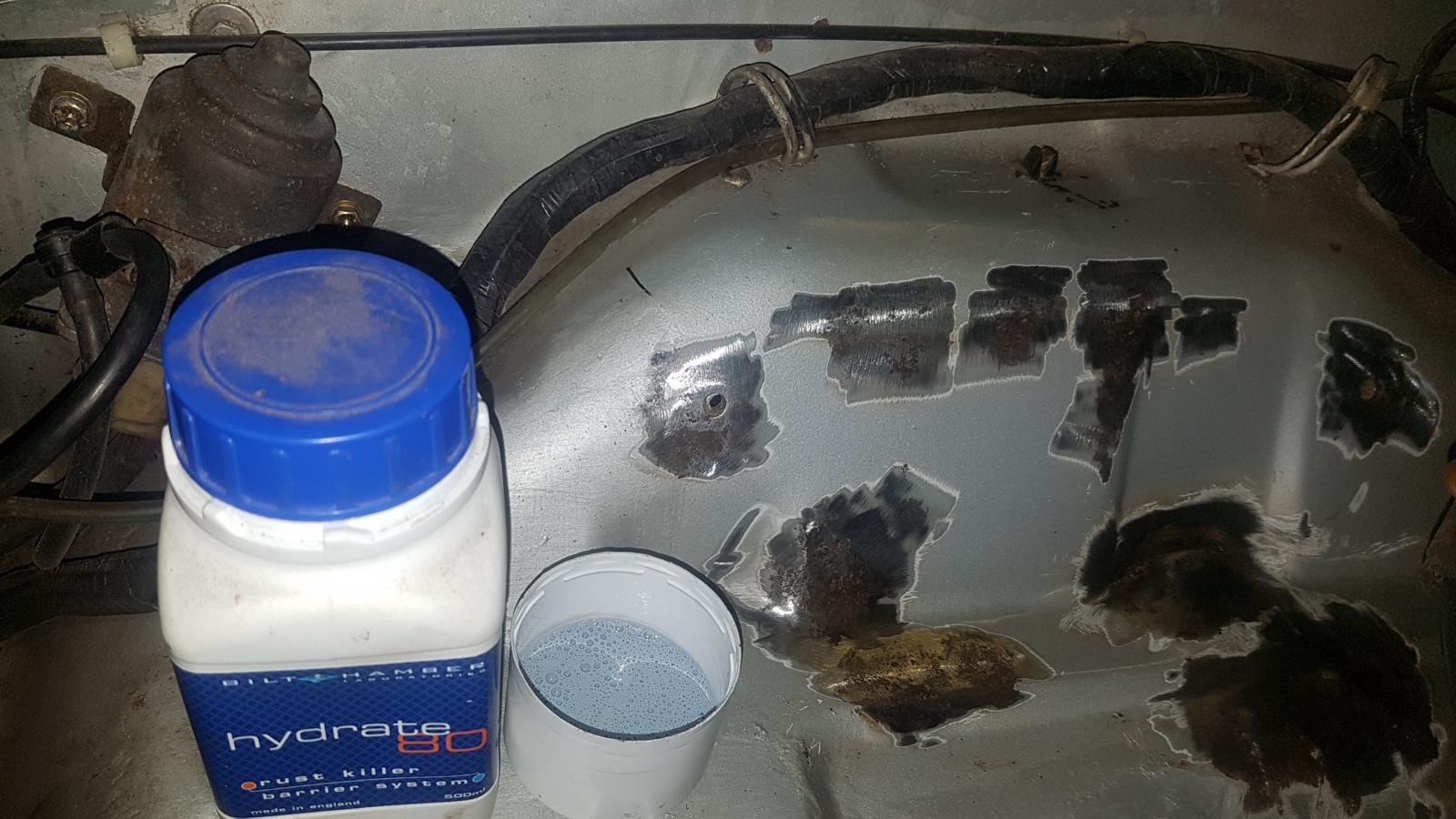

Behind the screenwash bottle I ground away the rust, although there was some pitting remaining.
I'm not too worried, as this is just a rough tidy-up job until I consider the engine install truly finished (AC yet to be fitted). At which point I'll probably respray the bay, but until then I'm bound to drop the odd spanner!

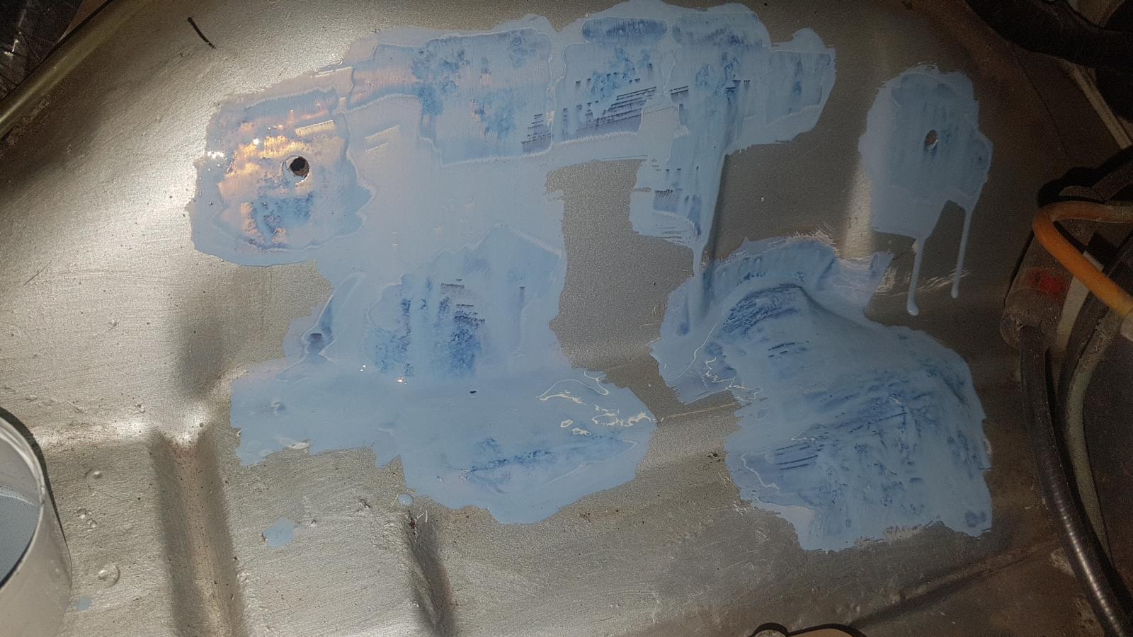

I used BH Hydrate 80 to (hopefully) deal with the pitting:
Then (brush) painted with smooth Hammerite - easy to touch up when I chip it!
Looks a lot better now, even if a long way from perfect:

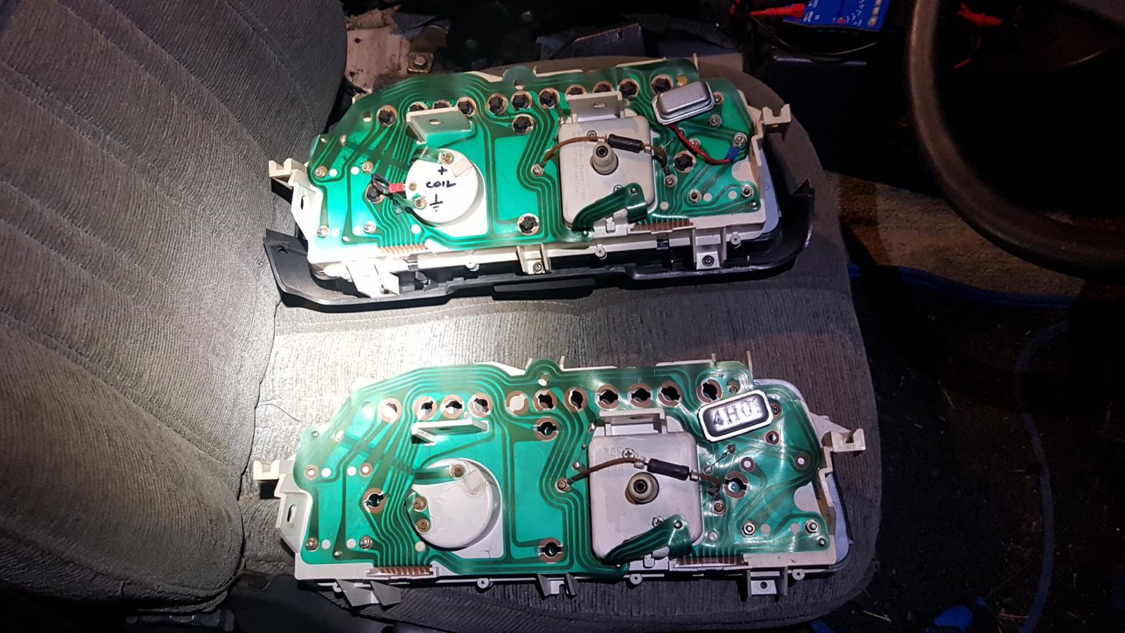

Bugger. It's not the float - that's moving freely and even disconnecting it the light still stays on. There's a permanent 25 ohm path to earth, so suspect part of the loom is shorting out *somewhere*. Off with the trim to trace the wiring!
After removing lots of bits, I've established that the loom is fine, but there is a problem with the dashboard.
It's had a few repairs over the years, but the benefit of being a hoarder is that I have a spare!
I've brought it into the (warm) house so I can try and find the actual fault, as I'd prefer to rectify that rather than just taking the easy option and swapping the whole PCB foil.
^^ I hope to lop off/join a couple of wires on my 'dodgy winker sw', by a swap over.

I can explain my thought process with something like this if that is useful. I'd first made the incorrect assumption that the problem lay with the brake fluid level switch, so checked that the float moved (yes), then disconnected the switch to see if the fault remained (yes). So I've very quickly ruled out a possible cause without even picking up a meter. OK, I've not actually proved it works, but I know for certain that a fault lies elsewhere)
The wiring diagram showed an ignition switched supply to the bulb (obviously OK) and a switched earth from the bulb at both the float switch (likely OK) and handbrake switch. It was only 3 screws to easily remove the centre console, and unplugging that switch proved there was no partial short inside when it was in the off position. Checking with a meter showed around 25 ohms resistance to earth at all times, dropping close to zero when the handbrake lever is up.
I then looked under the dash to see where the wire from the instrument cluster split to the fluid reservoir and handbrake. I could easily unplug the connector to the reservoir which made no difference, so the problem must be in the loom between handbrake and instrument cluster, or in the cluster itself.
I could quickly pull the sill trim off and visually check the loom for damage but seeing as that was all OK I wanted to pinpoint the problem further before stripping the loom covering. I snipped the wire between handbrake and cluster, and the 25 ohms to earth was measured on the section of the loom to the cluster. Disconnecting the cluster connector gave infinite resistance (as it should) so I then knew all the wiring was actually OK
Bit of a puzzle then, as I couldn't imagine what could cause a problem at the instrument end! The wiring diagram showed nothing but a straight link between the connector and bulb, but looking at it there was a diode between the brake and charge warning lights.
There is a diode test on most multimeters, showing the voltage across it in one direction (0.5V or so) and (should be) open circuit in the other direction. This one was showing a low voltage in both directions, indicating it was faulty, so I swapped it with a spare.
Repeat the test and what's this? Voltage across it in both directions! I then realised I'd left all the bulbs in circuit, so I was testing a current path in addition to that through the diode :oops:
Fortunately I had found the problem (although my diagnosis was at fault) and happily all works OK now :-)
Excellent improv without the proper tool, top bodgery.

You do have to make sure the nut and washer are lubricated, as otherwise the insert tends to spin. But works well if you are only installing a handful, as it's obviously slower than riveting them in.
Well, until you pull the handbrake on at least! At which point the charge warning light comes on too.
A quick look at the new diode shows I've only gone and soldered it in the opposite way round to the original :oops: Not yet rectified that but should be an easy fix!

I've re-soldered the replacement diode in the correct orientation, only to find the original fault has restored. This one has the makings of a head scratcher!
Avon have a new design of tyre that are A rated, I've got the SUV version on my RX, they seem quite good so far, can't comment on how fast they wear out.
I do like a good gremlin hunt like this. Especially if it's a car you know inside out so really has to work the grey matter.
I am a compete idiot!
The 'fault' I had is actually a feature, and one the car has had since new, and I just haven't noticed for the last 115k miles... :oops:
I established that current was definitely flowing through the diode (when soldered in the correct direction) but I just couldn't figure out WHY! In desperation I removed the diode completely, and all behaved as I'd expect. So I had to work out the function of putting it in the circuit, and whether removal was likely to cause problems.
So I then traced that the negative side of the bulb was connected via the diode to the charge warning light wire from the alternator, and the penny finally dropped. With the ignition off and the engine not running, the brake warning light is earthed through the alternator and hence illuminates as a test before the engine is started. Once the engine is running, one side of the diode is at ~12V, so the brake warning light can't be earthed in this way - only if the handbrake is on or the fluid level is low. As I almost always have the handbrake on until I start the engine, I'd never noticed that the warning light stayed on even if I'd released the handbrake! Until recently, when I assumed it was a fault. Never tried releasing the handbrake with the engine running to see whether it functioned normally!
Anyway, I've left the diode out now and all is well :-)
